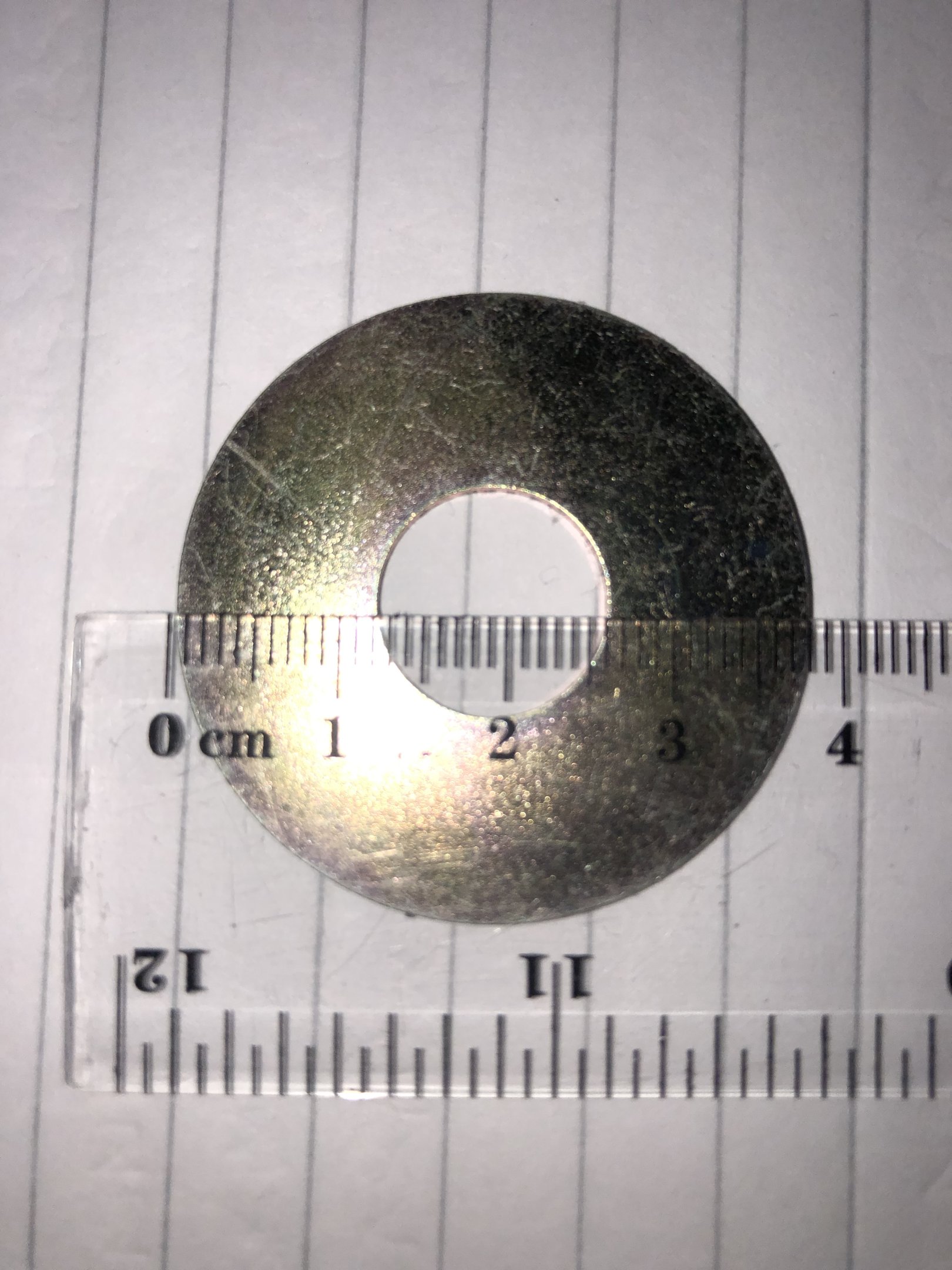

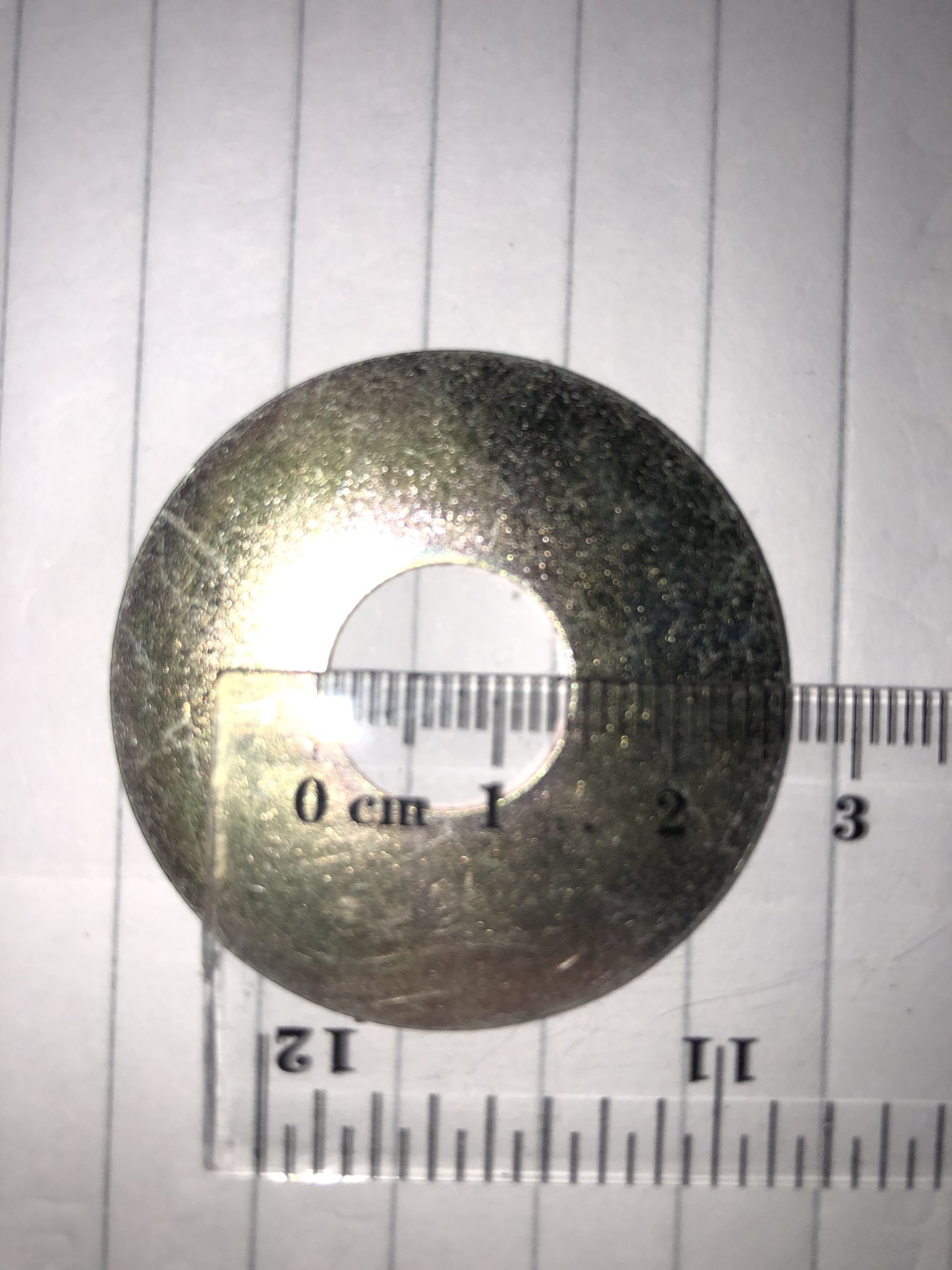

Fitted my second-hand powerflex dogbone and have realised it should have had two large washers on the gearbox mount end, thankfully I've only done 5 miles. What size and thickness should they be?
I did wonder this having read about their excellent customer service
These are the exact ones and are 1mm thick.
