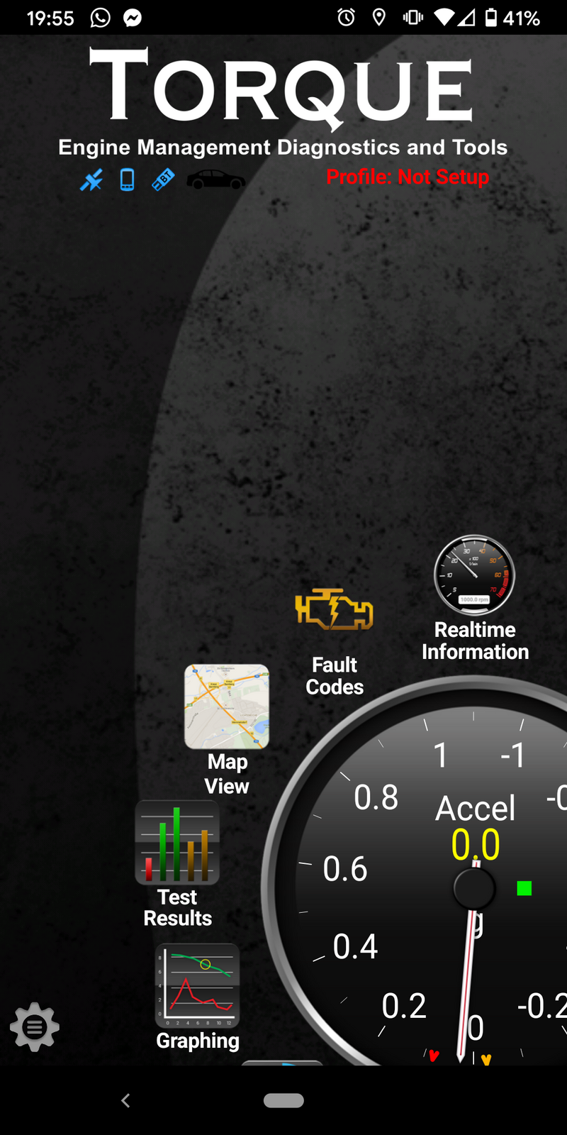

Got the bluetooth obd reader and downloaded Torque lite. Fair to say I dont understand a lot of the readings it gives or their relevance. Is there a guide anywhere as to what they should all be?
I can see it will be useful though, how accurate is the mpg average etc?

On the home screen, go on Realtime Information.
Mine loads up a page with dials on by default it has things like RPM, throttle and coolant temp.
Do yours look similar?

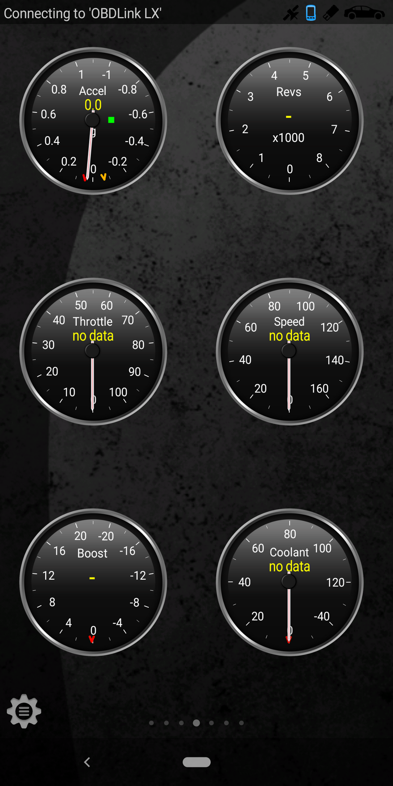

On my phone there is no home screen of preloaded dials, I had to put my own on. Also cant see realtime information, should I get torque pro instead

Could be different, mine is the pro

I dont understand half of the stuff that is recorded to be honest, hp but no bhp?
