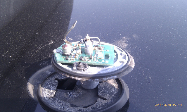

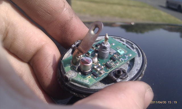

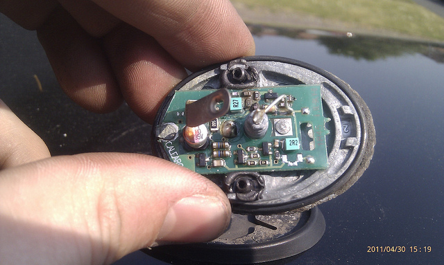

Right, i have taken my ariel base apart and it looks fine i think, i have sprayed it with electrical cleaner, havent been down the road to test it yet though
IMAG0413 by sbridgey, on Flickr
IMAG0412 by sbridgey, on Flickr
IMAG0414 by sbridgey, on Flickr
TBH mate it might look fine but its whats going on inside that counts... get a second hand one and try that or pay full wack at the stealers... ive never had one apart but if there are any metal contacts that touch another clean it with a bit of wire wool or wire brush/sandpaper.
Paddy_g46
mate, you are wasting your time! That is a complete un-serviceable part. All it takes is 1 little connector or component to die and thats it. Just replace the base.
sbridgey
  disco 4, 182, Meglio
i took it off to see if anything obvious was broken but it seemed fine, but as you say 1 connector can cause it too break just wanted to check for obvious things really, will get a new base at somepoint
