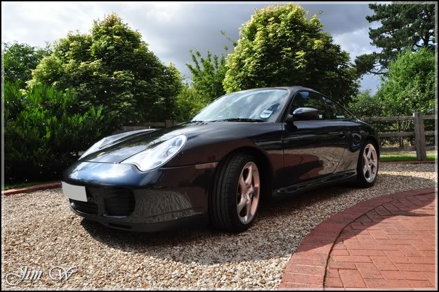

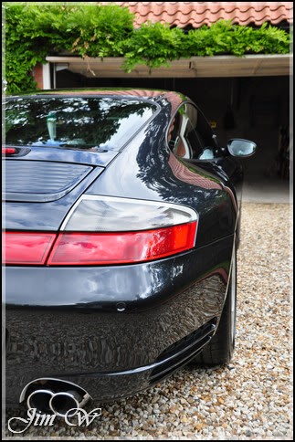

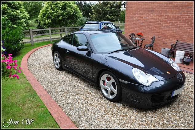

Starting with the Porsche.
Porsche Carrera 4 S – Atlas Grey.

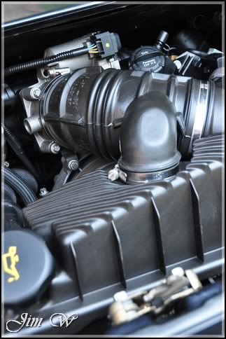

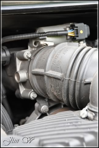

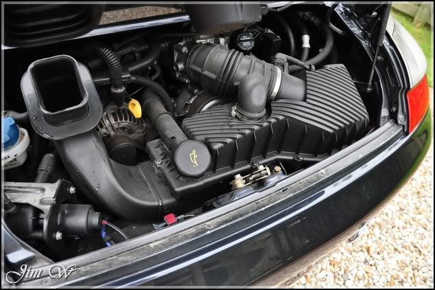

As there we no wheels to start on, I focused my attention in the engine-bay instead. AutoSmart G101 allowed to dwell before agitation and a light pressure rinse. Later dried and dressed with AutoGlym’s Vinyl & Rubber Care.

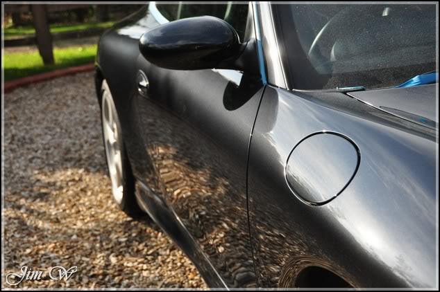

After the doorshuts were cleaned, I performed the snowfoam/two-bucket wash stage.
Second sign showing that the vehicle was already well looked after was the already in-place protection. Water was beading well and gave a great base to start with.
Third sign of a well maintained vehicle was the lack of build-up spotted on the clay bar in the decontamination stages. So far so good!

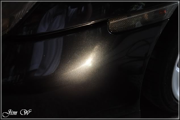

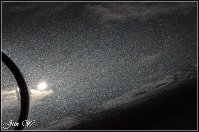

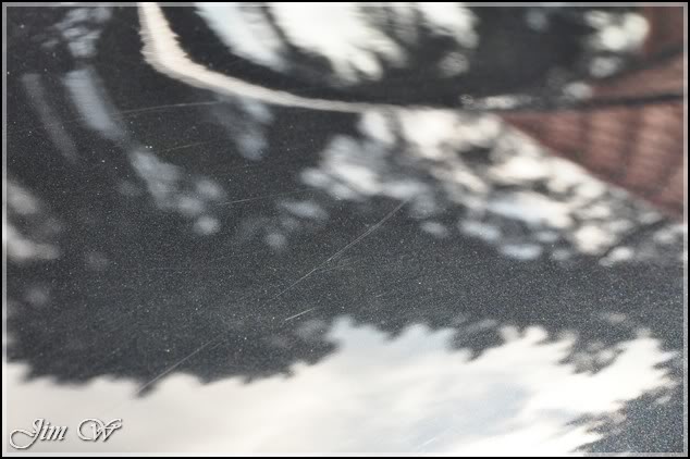

Early indications of defects:

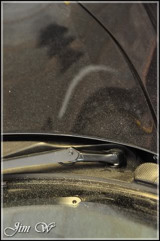

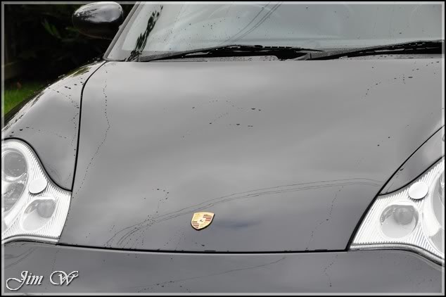

Seems to be some pretty deep marks in that bonnet:

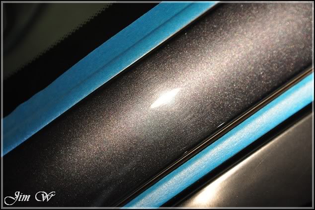

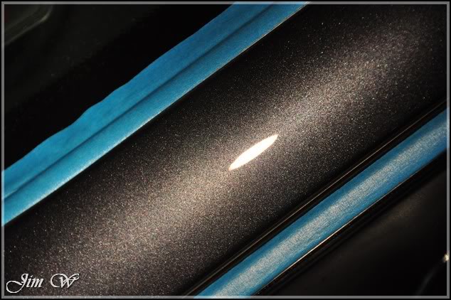

As per nowadays, I started with the small spot-pad work.
Green Light Cut Hexlogic pad used with 203s.
Before/After on N/S pillars.
Other smaller intricate areas worked in the same way.
Before/After:

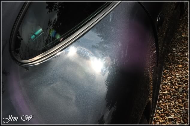

Sticking with the smaller spot-pad for the majority of the wings as a larger pad proved a little difficult to manoeuvre. 203s still cleaning things up nicely.
The second I reached for the larger Hexlogic pads, I had issues with the sticky Porsche paint. Throwing in a little Megs #7 glaze helped, but, it was a slow and tedious process.

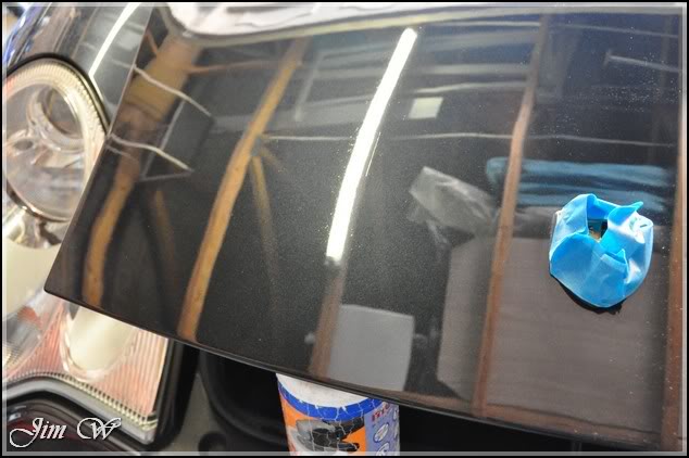

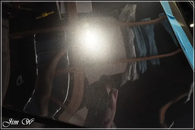

Time to look at those nasties on the bonnet.

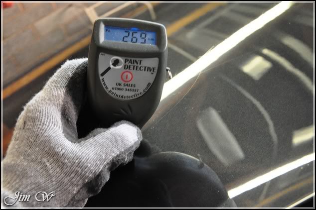

Paint thickness readings told me that the bonnet had been sprayed (probably down to stone-chip accumulation)

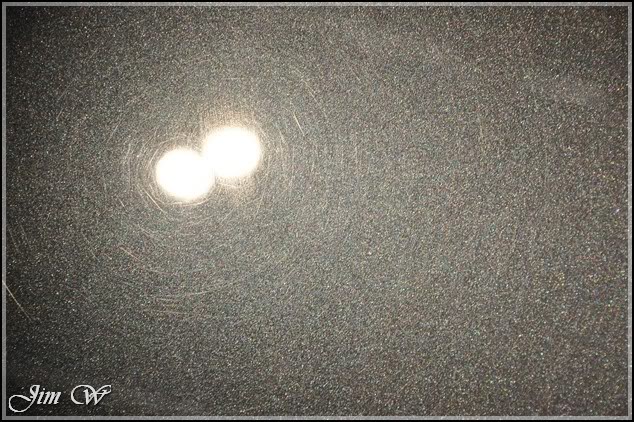

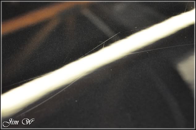

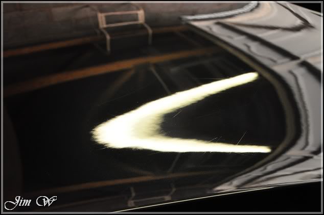

Giving a first pass with the Green Light Cut Hexlogic pad made little difference. Sure, it removed the ‘swirls’, but, it still looked in a bad way. More action needed.
Looks great from a far:

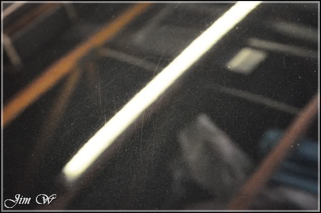

But in close:
These scores were pretty deep; I’d round them off as best I could, but I wasn’t confident they would be completely removed.
Mind you, plenty of paint to be playing with.
Changing my set up to a 3M cutting pad and Menzerna 85 RD3.02.
One of the scuffs seen above was massively improved:
Before/After:

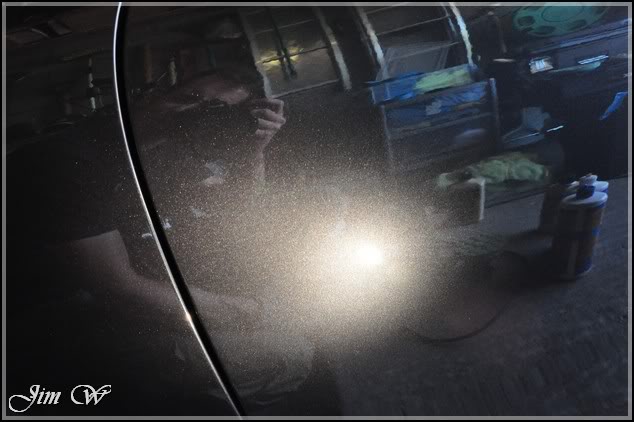

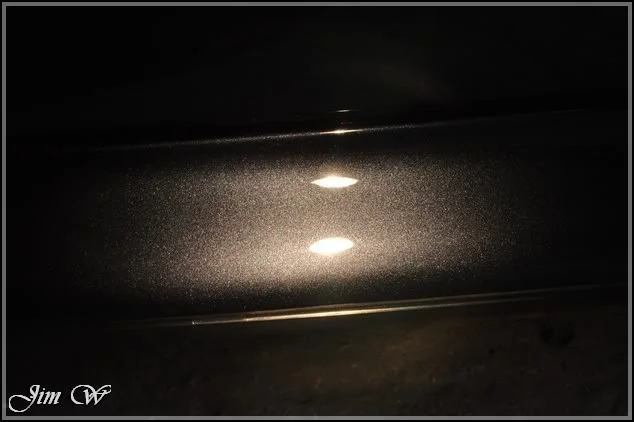

Before machine polishing:
After three heavy hits with 3.02 and a cutting pad.

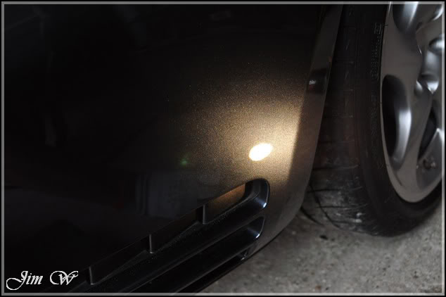

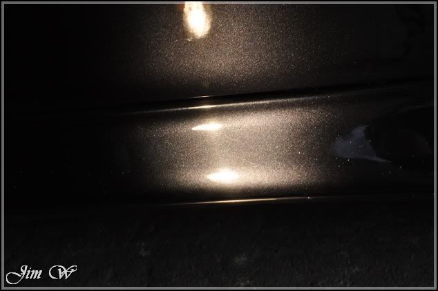

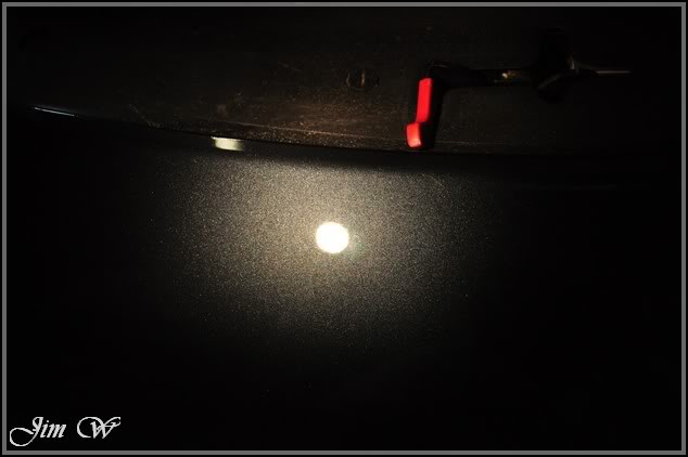

This paint was HARD. The score to the right of the strip-light reflection was far too deep. Lots of paint would need to be sacrificed to dig this one out.

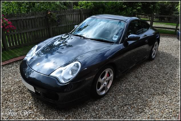

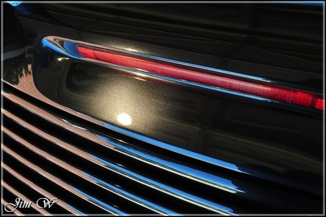

On a whole though, looking good:
Before/After three stage compounding stage:

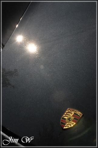

Bonnet refined with a 3M Yellow Polishing Pad and Menzerna 106FA.

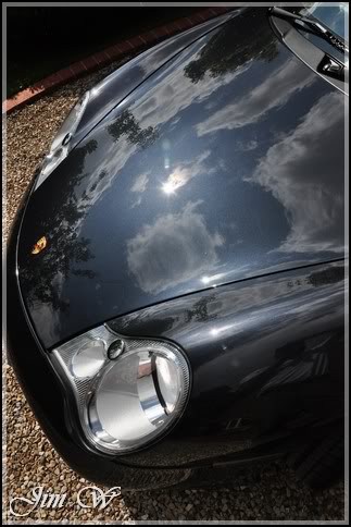

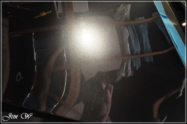

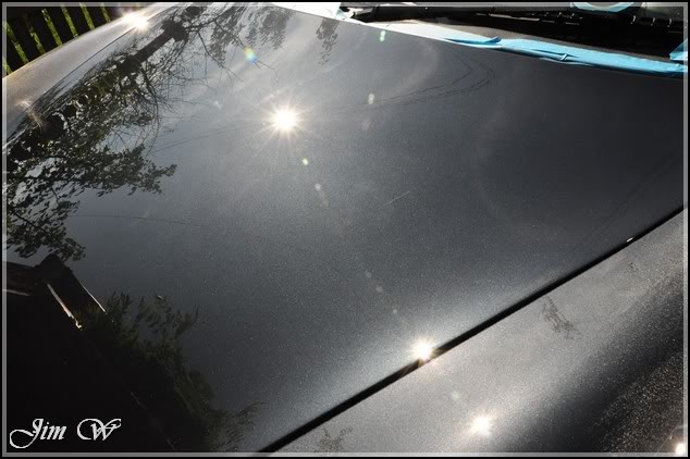

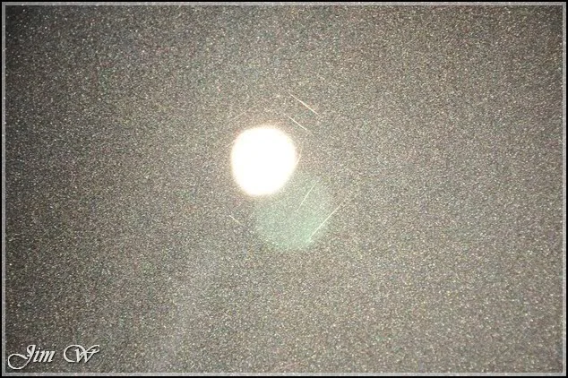

Good timing eh? The sun starts to shine. Perfect opportunity to run it outside to check my work.

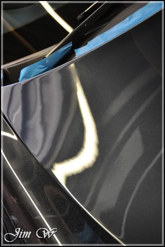

Deep mark still to be seen here:

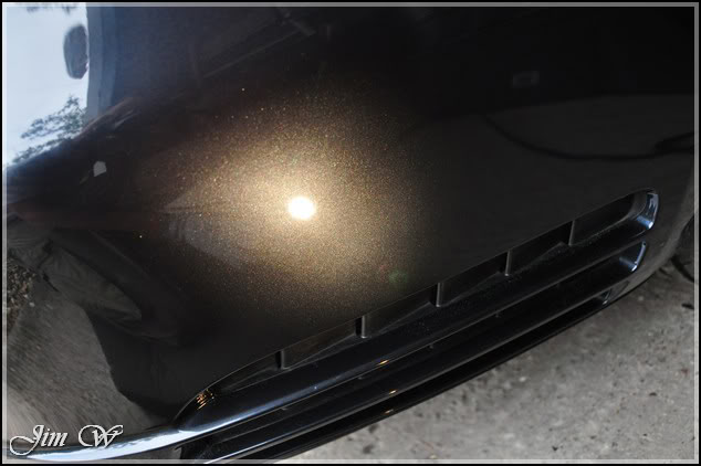

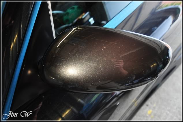

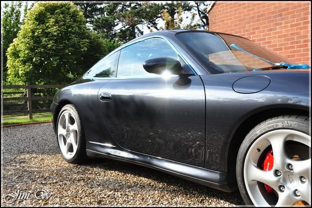

Moving round to the O/S, I went over the small pad work again (mirrors, A/C pillars and curvature on the wings).
50/50 between the wing and the bumper.
Much more depth being restored.

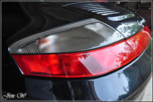

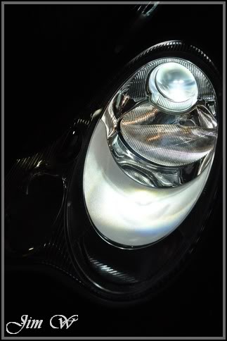

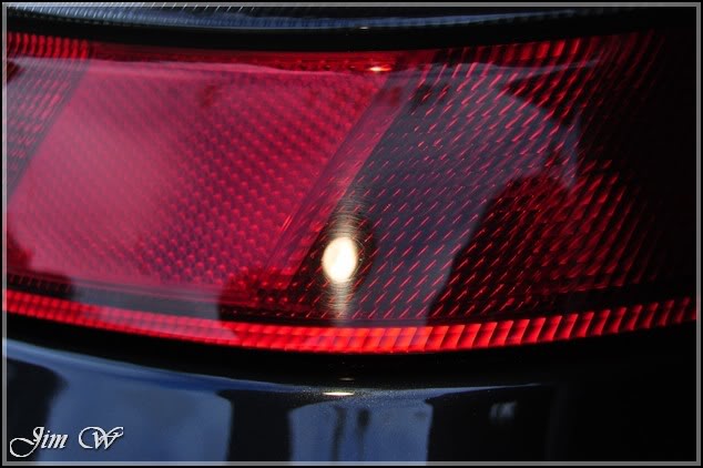

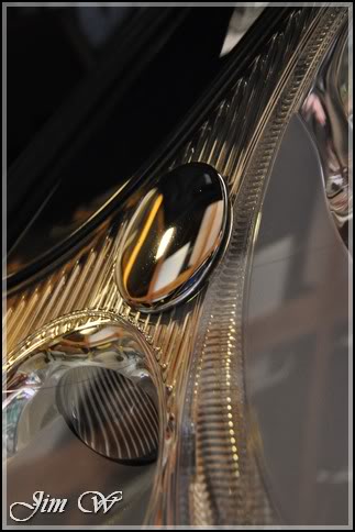

Headlights were dull and needed brightening:

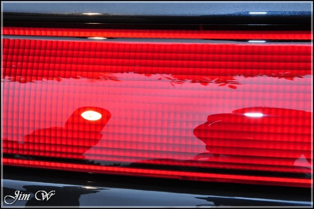

As were the tail lights on the rear end.

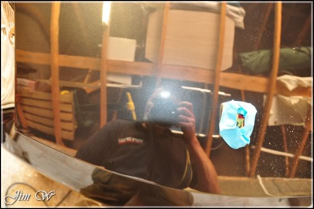

Pat dried with an uber plush towel. Vehicle Dryer then used again to remove excess water.
An IPA wipeover given to remove all polishing oils ensuring a squeaky clean base ready for the wax.

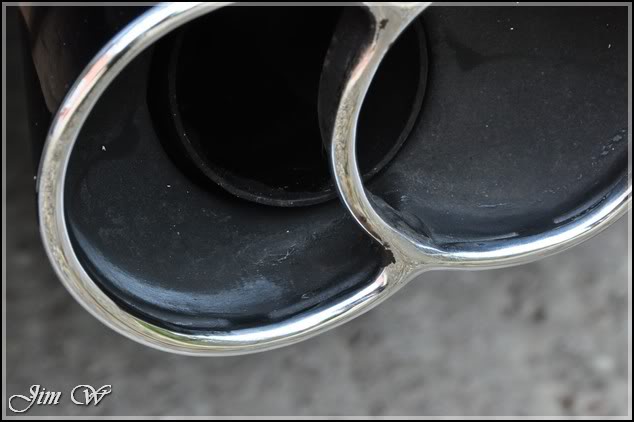

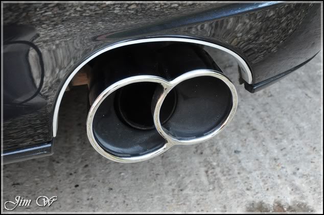

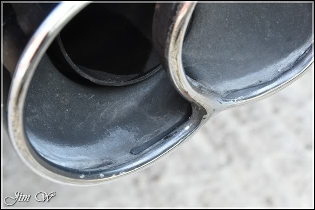

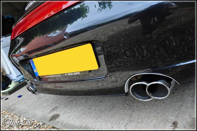

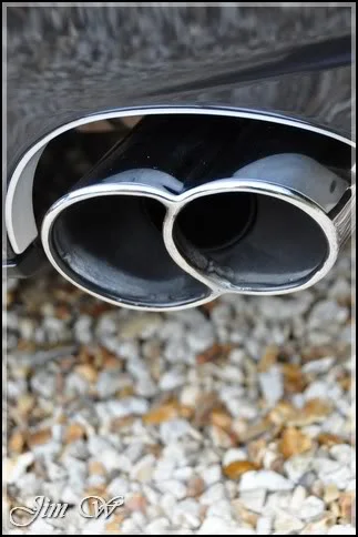

Exhaust tips were clean but suffered on the inner lips from pretty nasty build-up.
Before/Afters:
Autosol and Wire Wool used here. Finalised with a quick polish with Belgom ALU.

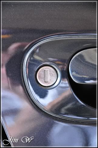

Some light toothpickery work:

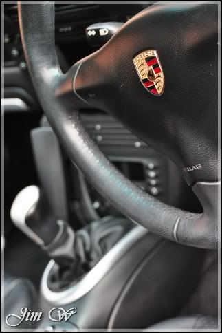

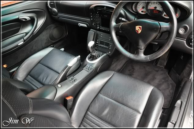

A light hoover and wipedown was given to the interior.

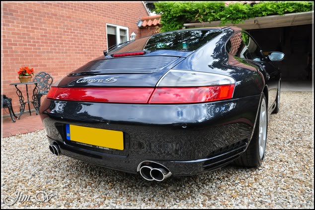

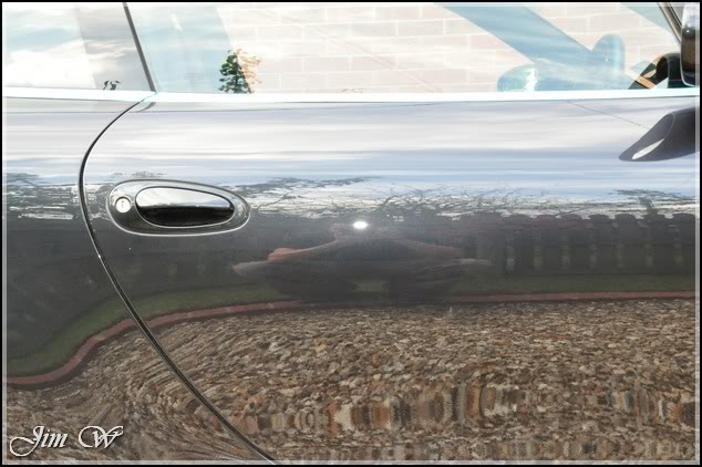

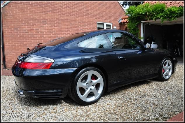

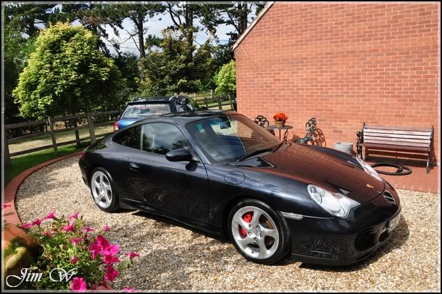

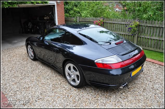

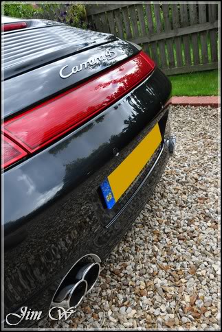

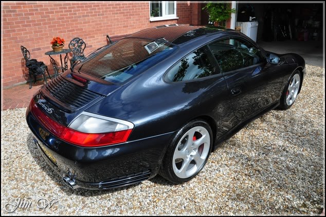

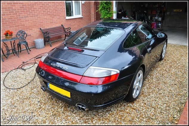

A final buff of the paint and we’re done.
Total time 15 hours.

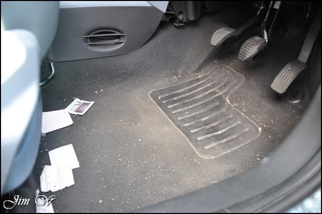

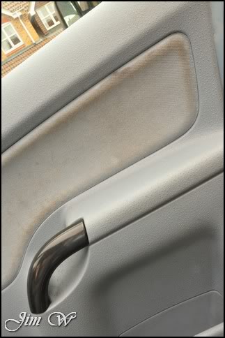

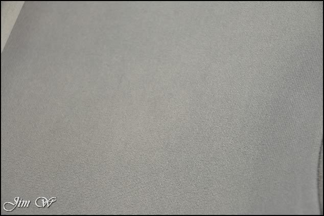

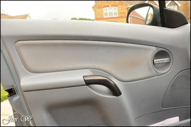

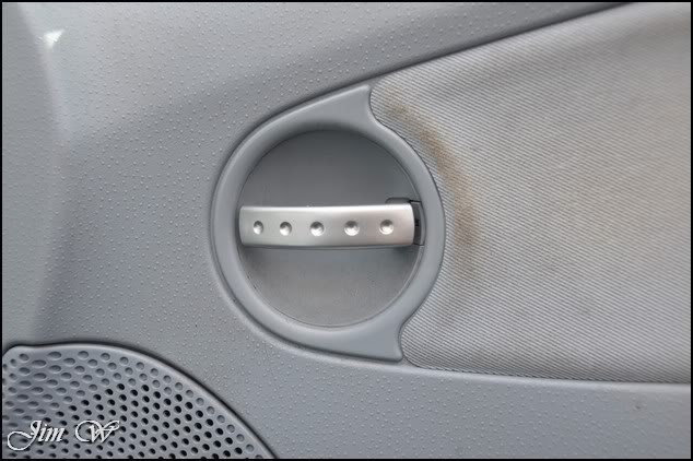

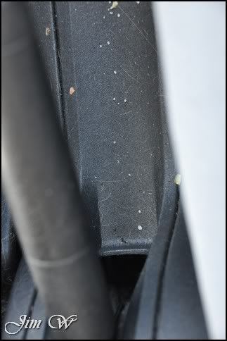

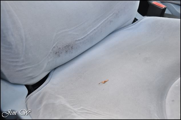

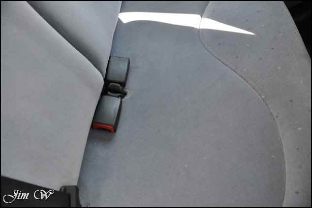

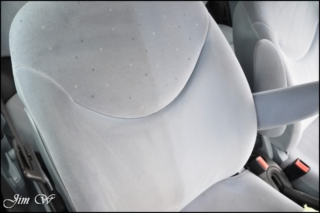

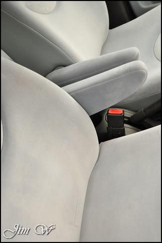

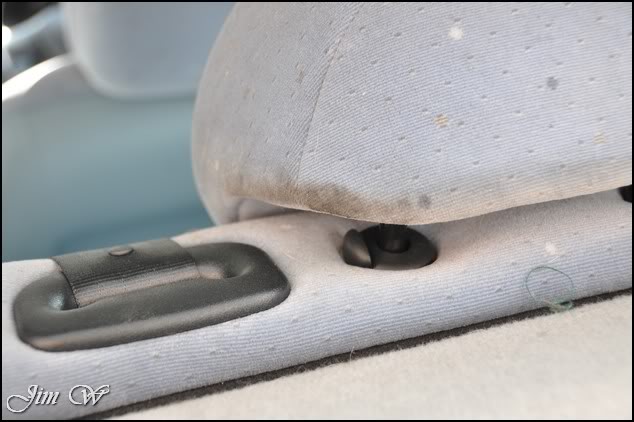

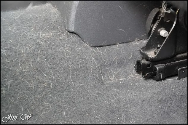

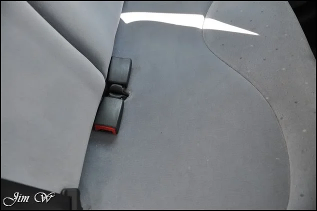

The worst areas being the upholstery, the dog hair stuck in the carpets and the material section on the doorcards.

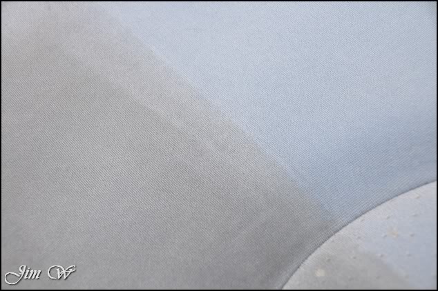

Starting with the wet-work, thus, given the cloth enough time to fully dry before collection later that morning.

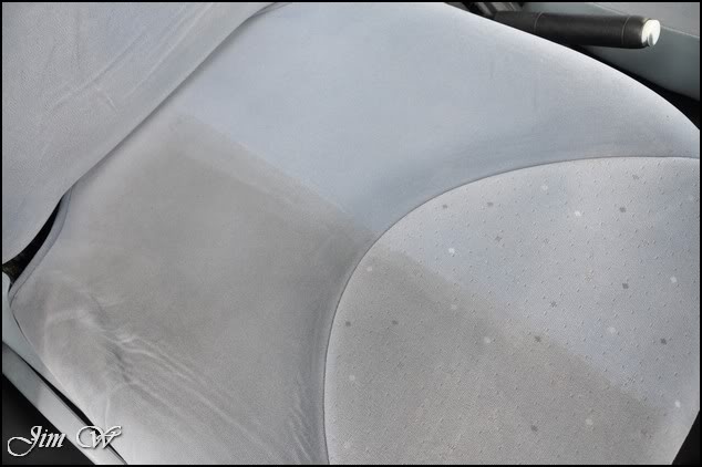

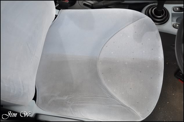

AS Bio-Brisk used in a trigger-spray to help clean the engrained cloth through the extraction stages.
A few 50/50’s:

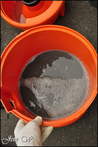

And the dirty water collection tank (living up to its name)
After each seat/section had been completed, a clean microfibre soaked in a warm Woolite mix was used to re-wet the area to ensure the seat dries as one (which helps avoid tide-marks!)

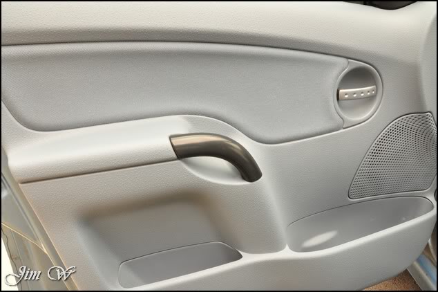

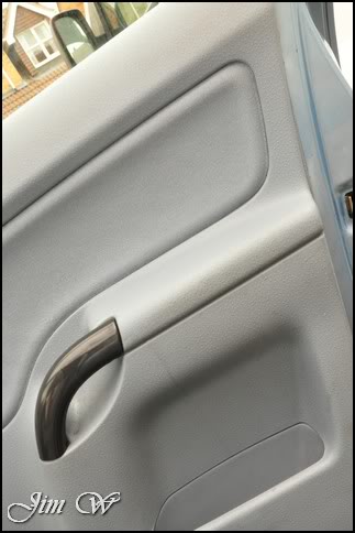

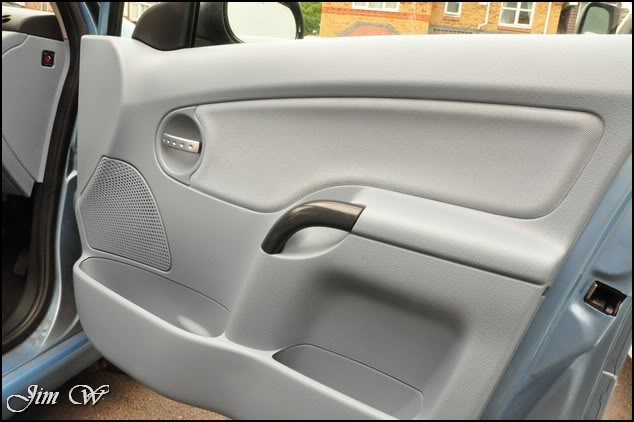

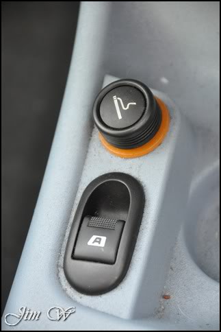

The material inserts on the doorcards were cleaned with Bio-Brisk and a few clean clothes..

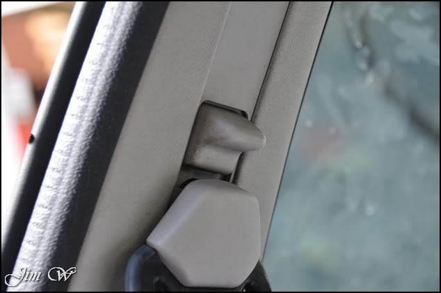

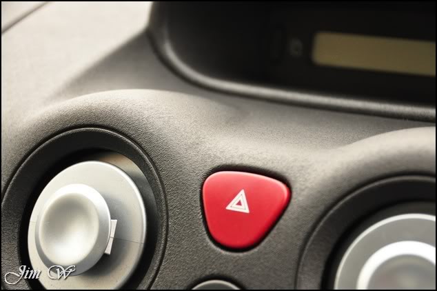

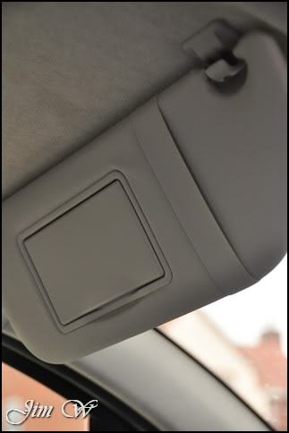

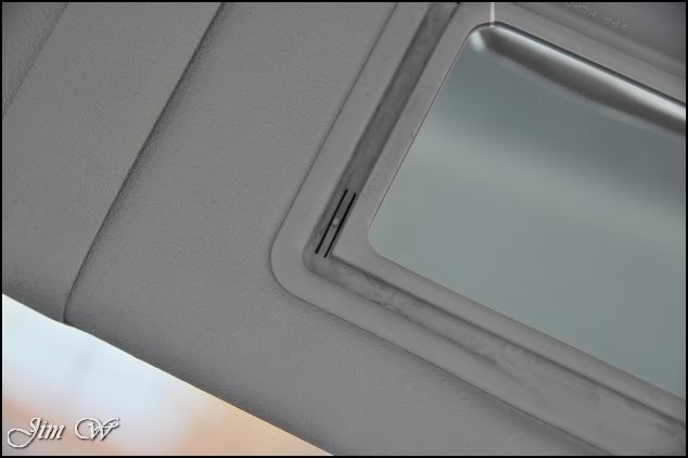

Plastics scrubbed up with AutoSmart G101:
Interior windows cleaned with 3M Glass Cleaner.

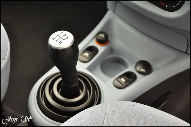

Hoovered and tidied on the edges.

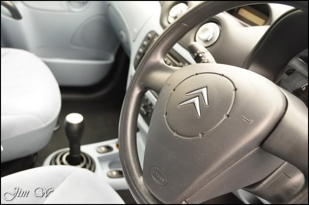

….finished!
