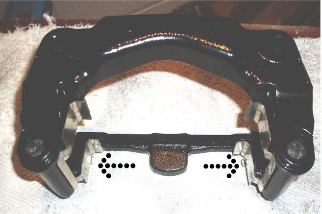

did you remove the pad shims when you installed the DS2500's??? (small stainless steel plate at either end of the pad carrier)

Now about these shims you're talking about Fred, are they the black metal piece that come stuck to the back of the pad material? Do they need to be pryed off?
Its a very thin piece of metal attached to the underside of the caliper
And for these pads they need to be removed?

These are what Freds referring to .

Ok, finaly got around to checking my shims and found there are none installed. Is this something I should get put back on or are they supposed to be removed?
