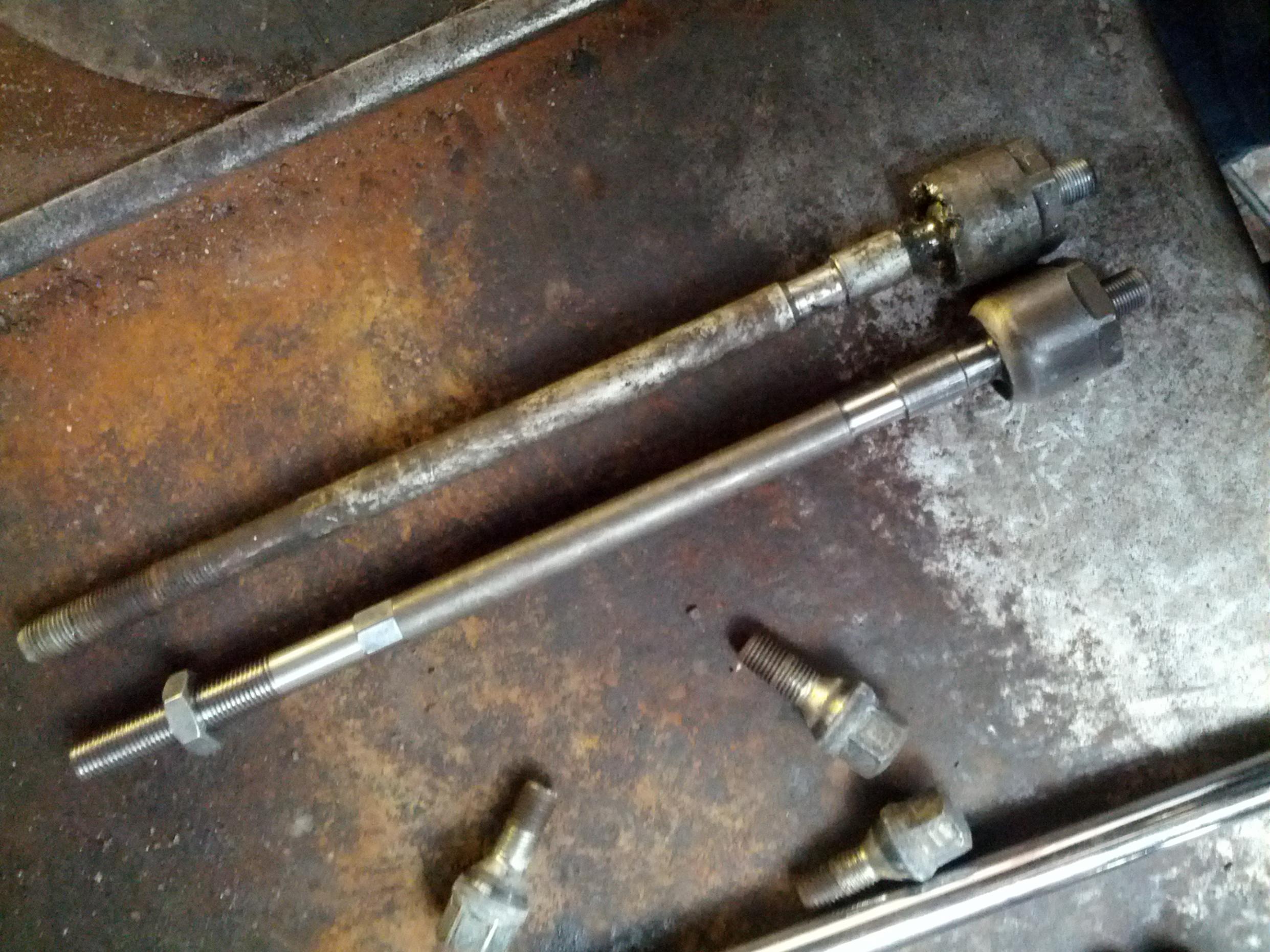

and as the attached image shows, the rods are EXACTLY (to the mm) the same length as the original cup ones
I also fitted some new track rod ends as well. I cannot explain how much tighter the car feels - massive massive improvement on the old arms.
So there you go, no need to buy inner track rods from Renault anymore :)

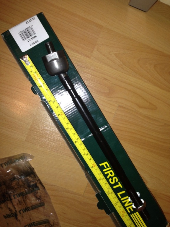

Another option is Firstline from micksgarage.com £12 each iirc
