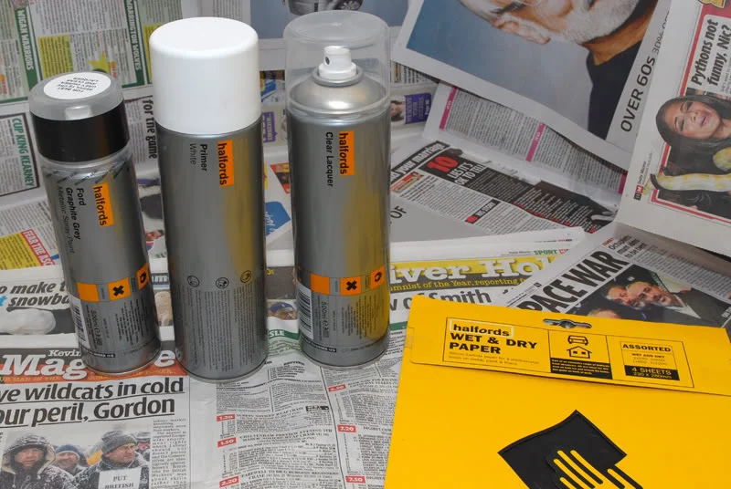

Tools:
Apart from the diamonds themselves, this was what I used:

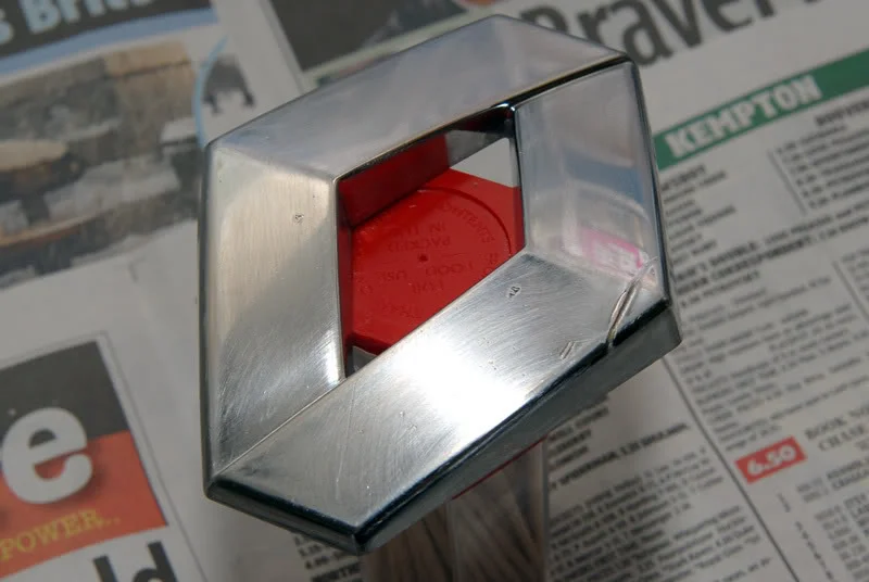

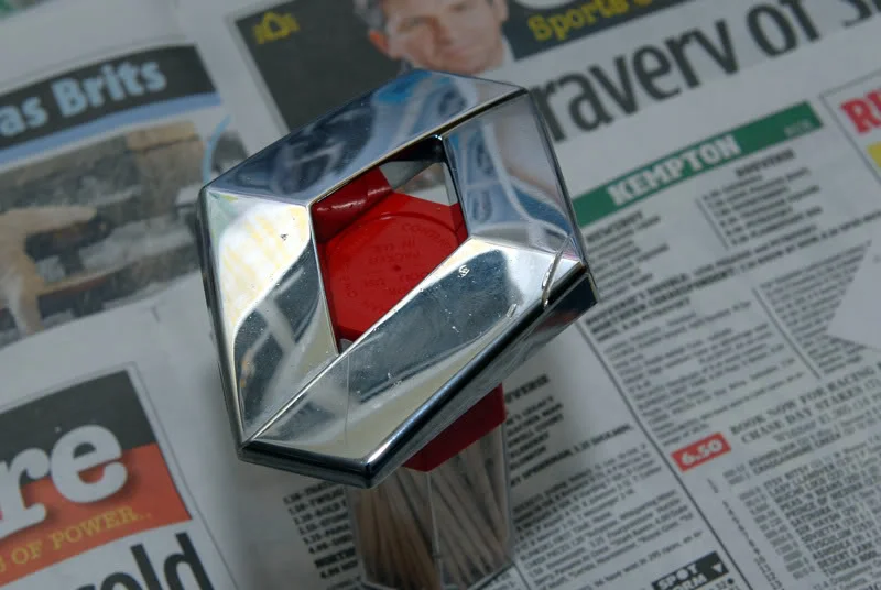

The front diamond in original state:
Step One: Prep the diamond for priming.
The diamond was sanded down using P600, then P1200 sandpaper.

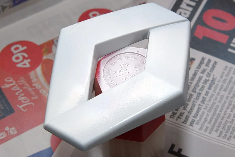

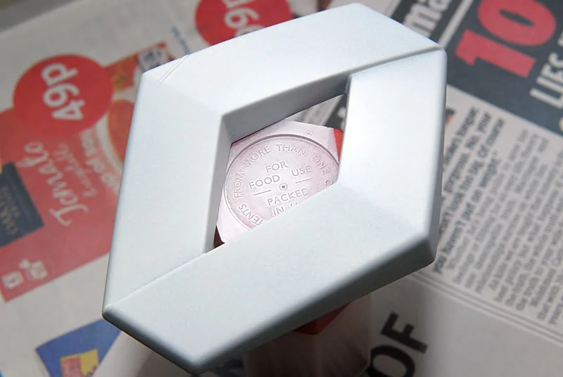

Step Two: Priming the diamond.
The diamond was sprayed lightly with white primer:
Step Three: Leave to dry.
The diamond was left to dry for 30mins:
Step Four: Repeat previous two steps!
I chose to use two coats of primer, so as above :)

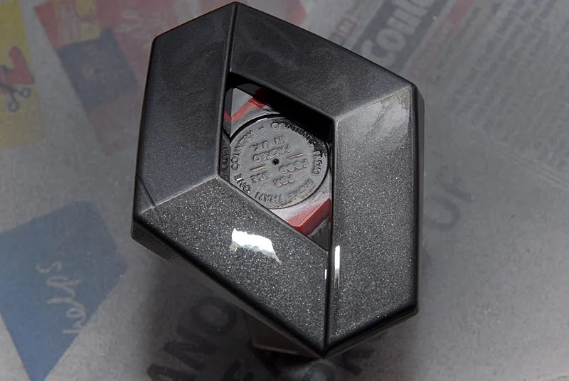

Step Five: Spray graphite.
Using the same technique for spraying the primer, I sprayed the diamond in ford graphite grey, and left to dry for 60mins:
Step Six: Repeat step five! :)
Again, I chose to use two coats of colour. So I sprayed again, and left to dry for 60mins again.

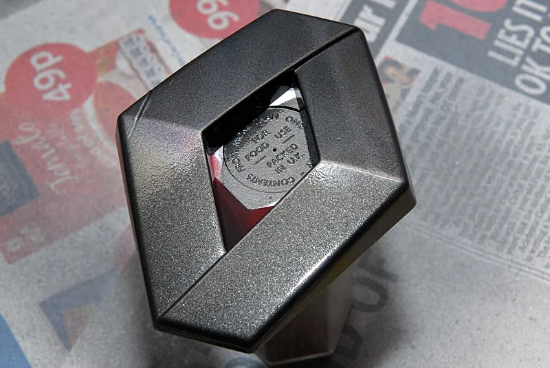

Step Seven: Lacquer coat.
Once the graphite grey had dried nicely, I coated the diamond in a clear lacquer:
Step Eight: Leave to dry.....

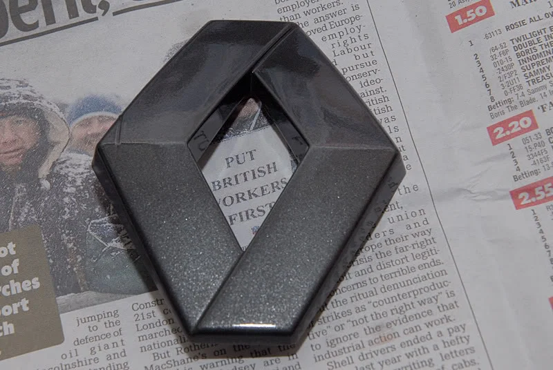

This is a photo of the diamond 60 mins after applying the clear lacquer. It looks the dogs! (in my opinion!)
This will now be left for a few hours, after which I will apply another coat, which will then be left for a few days to cure :)
