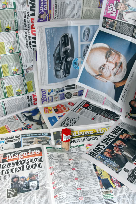

I first setup a 'spray shop' in a corner of a room (well ventilated!!)

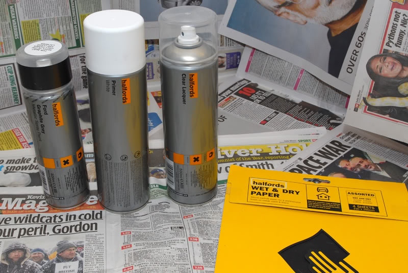

Tools:
Apart from the diamonds themselves, this was what I used:

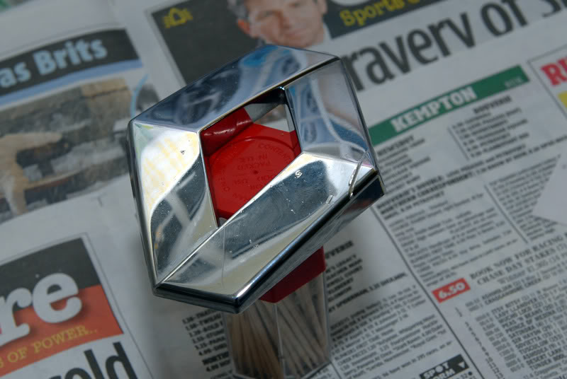

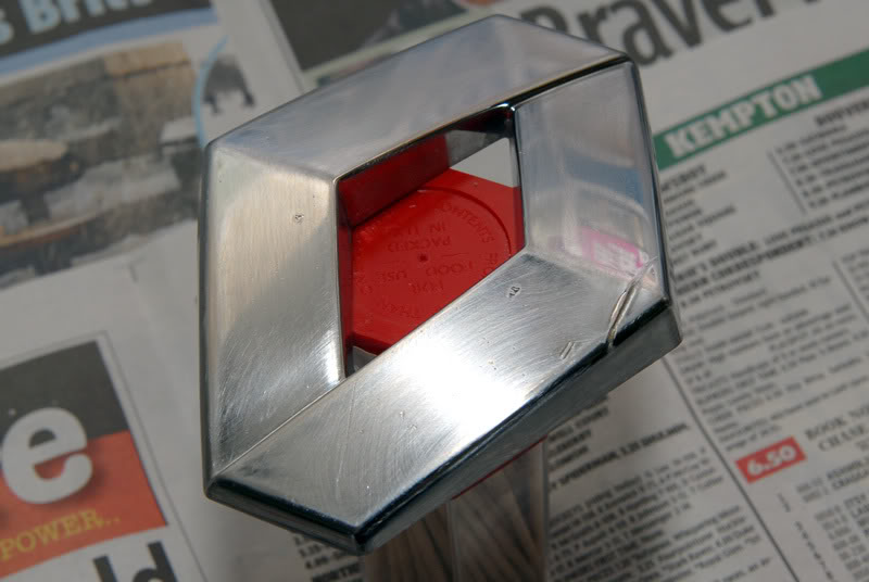

The front diamond in original state:
Step One: Prep the diamond for priming.
The diamond was sanded down using P600, then P1200 sandpaper.

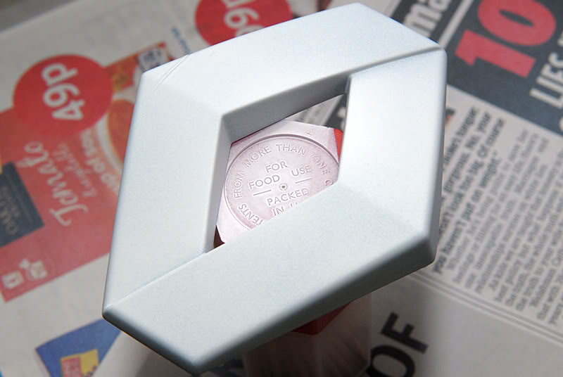

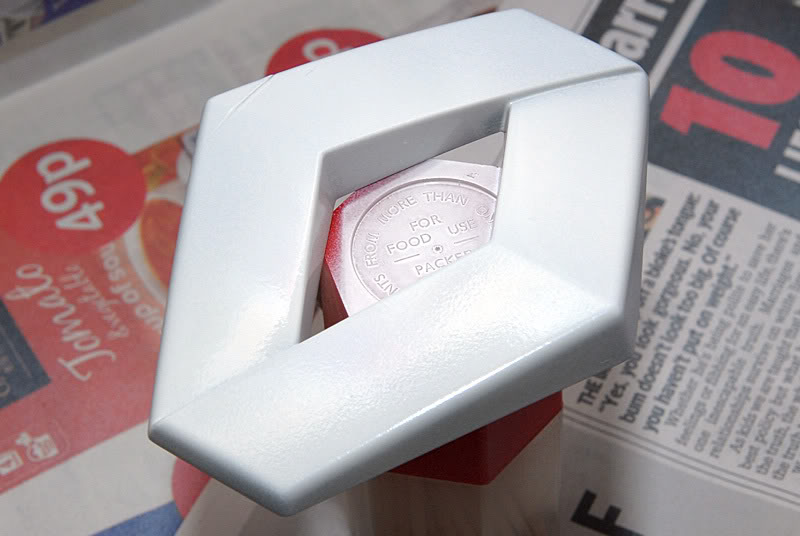

Step Two: Priming the diamond.
The diamond was sprayed lightly with white primer:
Step Three: Leave to dry.
The diamond was left to dry for 30mins:
Step Four: Repeat previous two steps!
I chose to use two coats of primer, so as above :)

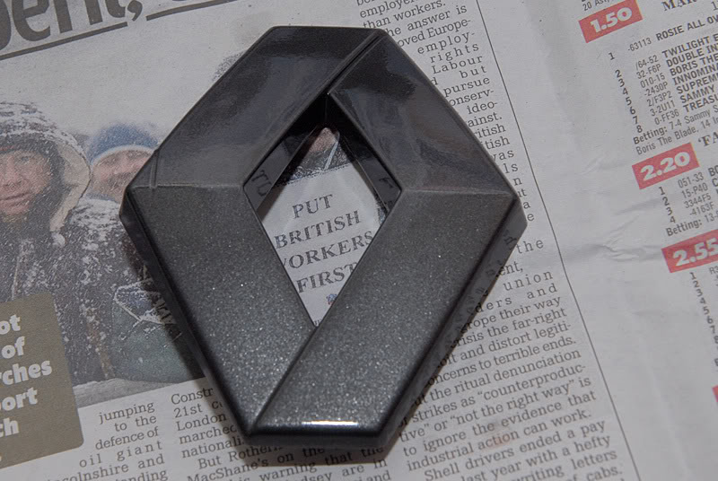

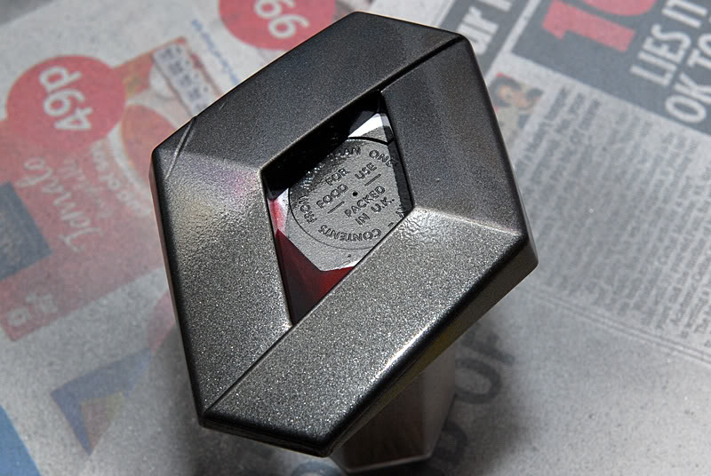

Step Five: Spray graphite.
Using the same technique for spraying the primer, I sprayed the diamond in ford graphite grey, and left to dry for 60mins:
Step Six: Repeat step five! :)
Again, I chose to use two coats of colour. So I sprayed again, and left to dry for 60mins again.

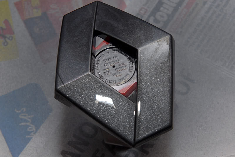

Step Seven: Lacquer coat.
Once the graphite grey had dried nicely, I coated the diamond in a clear lacquer:
Step Eight: Leave to dry.....
This is a photo of the diamond 60 mins after applying the clear lacquer. It looks the dogs! (in my opinion!)
This will now be left for a few hours, after which I will apply another coat, which will then be left for a few days to cure :)

Few marks on that boss!
The rear one is a pain in the arse to get off, someone should make a guide for that (I can't be bothered).
Yeh I couldnt be assed to touch up the scratches before I sprayed lol.

might have been good idea to use plastic primer fella ... as you might find after a while it starts to flake/chip off
but looks the dogs ...

Why didnt you sort the massive scratches out! lol. Looks a good job though :D Would probably do a couple more coats of laquer though.
  Mk1 Clio F4R'd
Nice guide. I see you have a mark or scratch on the side of the diamond. You could have used filler primer, layer it up and sand it down to make it all smooth if you wanted it perfect. Nice colour though, think i'm going to do my wheels that colour :D
Yeh I was going to use primer etc to fill the scratch. But tbh, its not that bad now the spray has filled it in a bit :)
