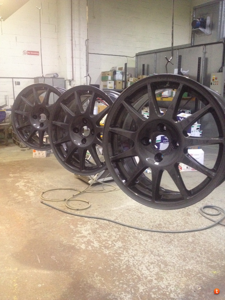

Yeah he's a bit of a moody sod at times haha. He don't like doing some wheels, Some Wheels are a bit of a nightmare because of the cheap alloy that's used, like bbs rep wheels always degas (gas that escapes from the alloy) even after going through the oven first. Makes pop marks in the paint every time.

Sorry if i am late on this one but for anyone else Kineton Coatings are good!
Off my GTST
