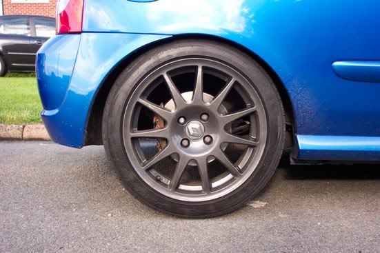

to this
serioulsy mint!
:cool:
freds work, :) imo powder coating is ALOT better than the O.E paint they come with....

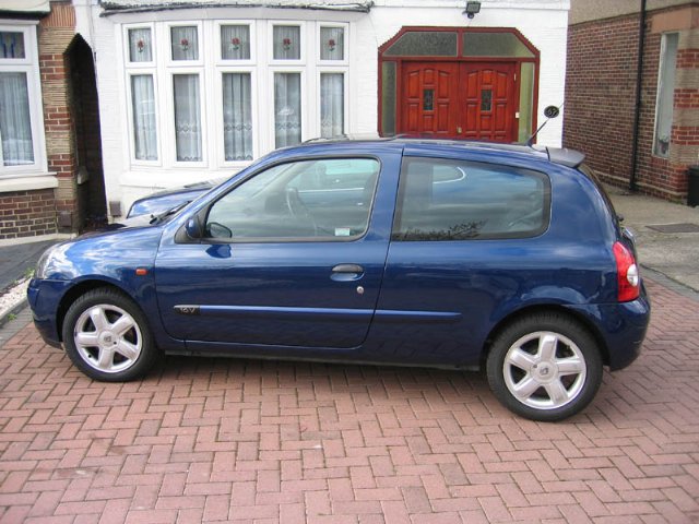

I've been after a refurb + power coat on my wheels for a while, thinking of getting it done in the new year but can't think of the right colour to go with the car (see below)
Any ideas?
Any ideas?
keep them the same colour mate, or ummm maybe black?
