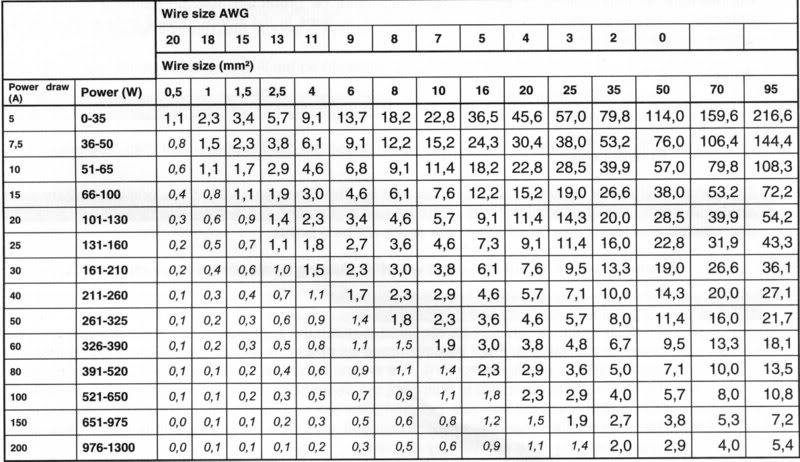

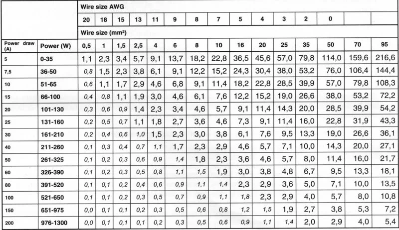

Heres a cable chart based on Performance
To work out your amps power requirements the easiest way is to simply add all on board fuses together, so an amp carrying 3 X 40amp fuses would have a max draw of 120amps, if working out a main batt to boot power cable simply add all on board fusing from each amp to give an overall max draw, then simply fit the correct guage cable for that given length.....
