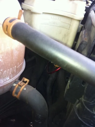

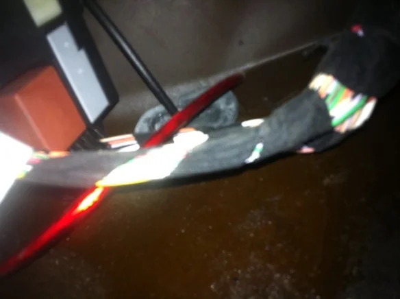

Hey bud if you're still stuck I took some photos for you (I'm uploading them of iPhone so sorry if this goes wrong!)
It comes out just underneath the bottle but couldn't get a closer picture!
Hope this helps!
Tom

spot on! that's really helpful thanks!

Thanks all for your help. I unclipped the power steering bottle and pushed the cable through from the cabin taped to a screwdriver. Unfortunately it took me an hour to get it untaped on the other side with one hand in a tight hole. I earthed it onto one of the lashing eyes in the boot at the back. This should be ok?
