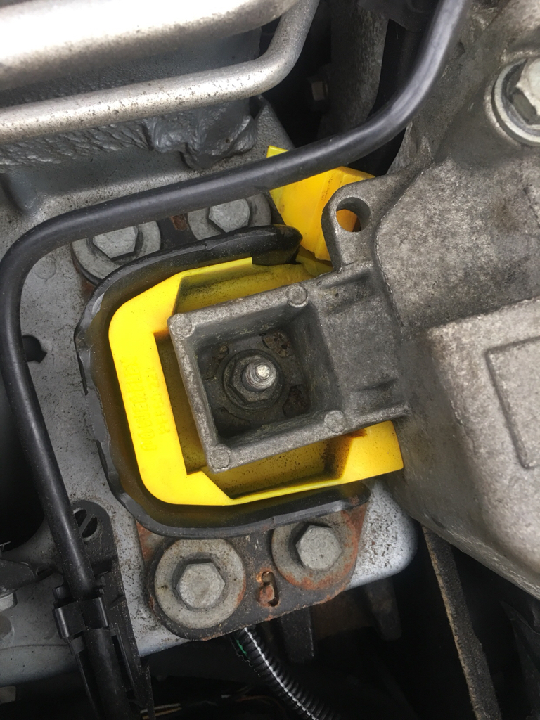

Guys any idea why this would happen?
  Clio 172 ph2
Guys does this look right the nyt the thread at the bottom basically doesn’t have one so how do I loosen the square looking bolt to get the Bush in?

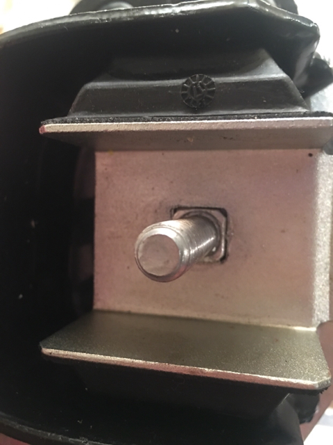

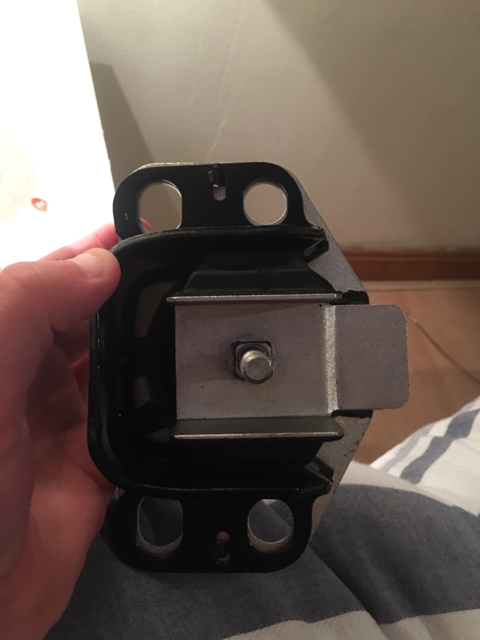

Lol, just seen it was missing the other part of the insert. Doubt powerflex will replace, only quickly glanced that day

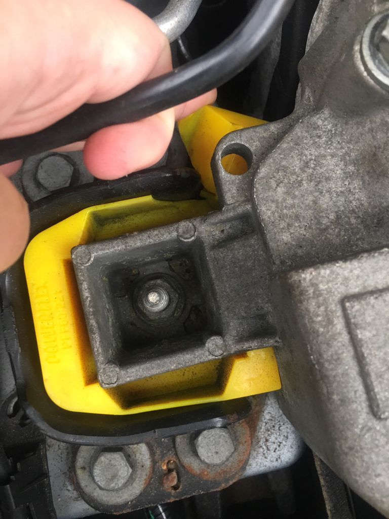

Give the plate a sharp tap, it`s only an interference fit.
