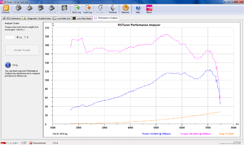

Does this look right?
Any way of telling what bhp my 172 is?

You have seriously over estimated the weight of the vehicle which has completely thrown the calculations out.
The power is calculated at the wheels with RS tuner, which is normally about 140bhp for a 1*2, you need to convert it from kW to BHP though, a google search will lead you to a conversion tool.
Also the massive dip at around 6500rpm looks really wrong to me
  MK2 172 FF
lol, what does it weigh?
i was going on the 1490kg plus 80kg (my weight plus clothes and trainers) = 1570kg
  MK2 172 FF
Kerb vehicle weight
1035 kgs
Gross vehicle weight
1490 kgs
ClioSport weighbridge tested vehicle weight
1093 kgs (with alloy bonnet)
1100 kgs (without alloy bonnet)
These measurements were taken from a car with a full tank of fuel and do not include the driver
Its the "kerb weight" we were after, which is 1035kgs...
Thats what manufacturers quote and when people talk about the weight of a vehicle, this is what they mean.
