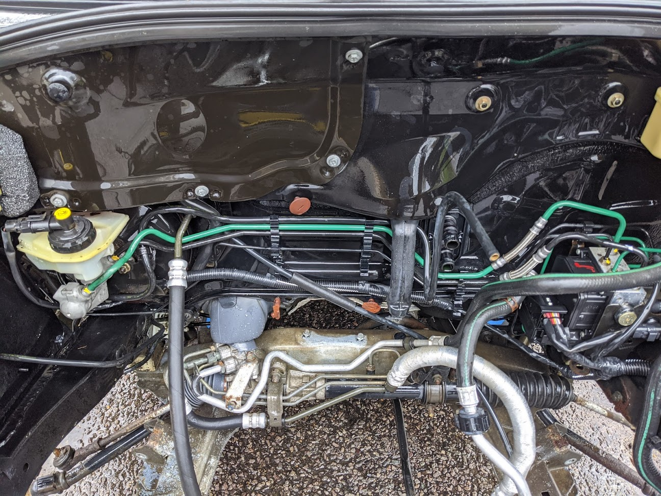

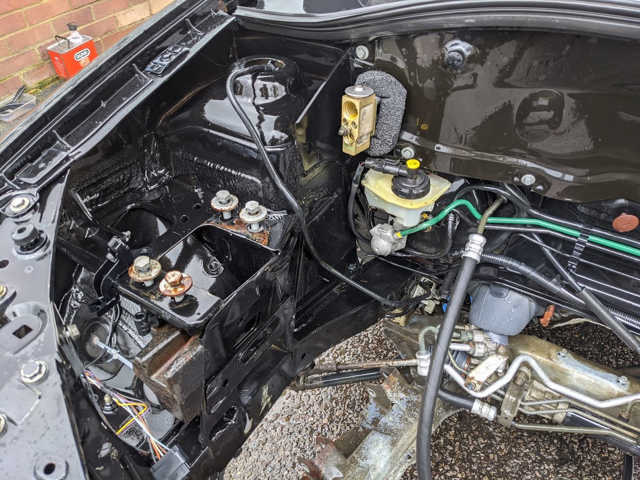

Sorry, can't be much help with your leak but wondered if these shots would help you to see where rack pipes are located - bit of a bugger with that iron turd in the way of everything.
