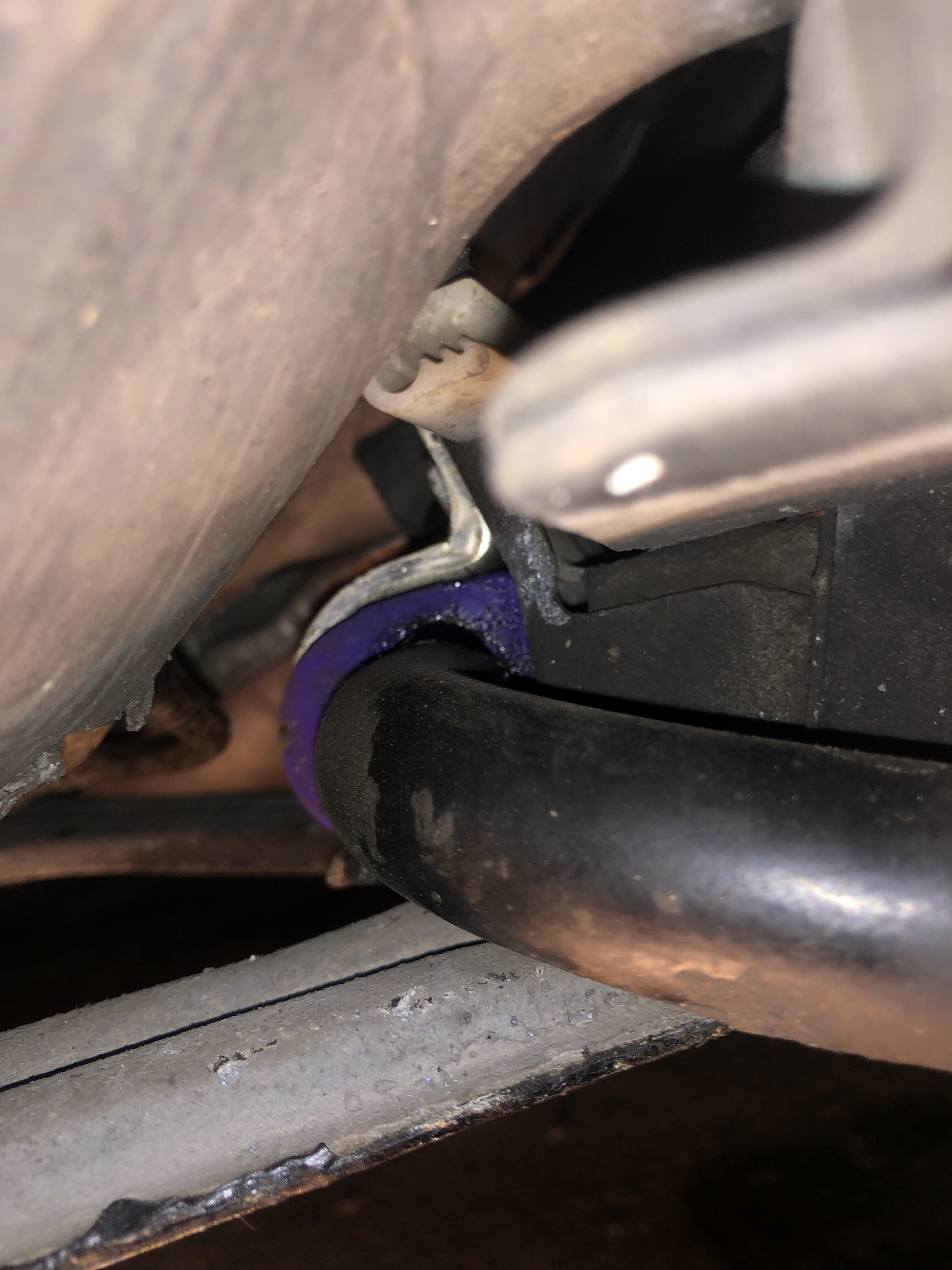

Not easy to see but there is a clear gap between the bush and the arb. The bushes are less than a year old and due to Covid have covered less than a thousand miles. The clamps are also new and the car is jacked up if that makes any difference. Any input appreciated.

Not seen it before. It almost looks like they've melted at the top.
They're a pain to do, so gutted for you.
What kind of grease did you use on them?
I didn’t do them, I’m well aware it’s a nightmare so wouldn’t attempt on the drive. They come with their own grease as you know so he used that??
Probably wrong sized bushings but regardless they'd need to be changed, not the best of jobs if you don't have a ramp
I remember seeing a thread in which the powerflex bushing had to be cut down as the bushing itself was too big for mount.
Looking at your image, the left side had too much material and he had to cut it down
I had to cut mine down to fit them, but I trimmed the outer side down by a couple of mm (At least), and it was still a very tight fit. Not a job i'd want to do again any time soon, along with the powerflex power steering rack bushes.

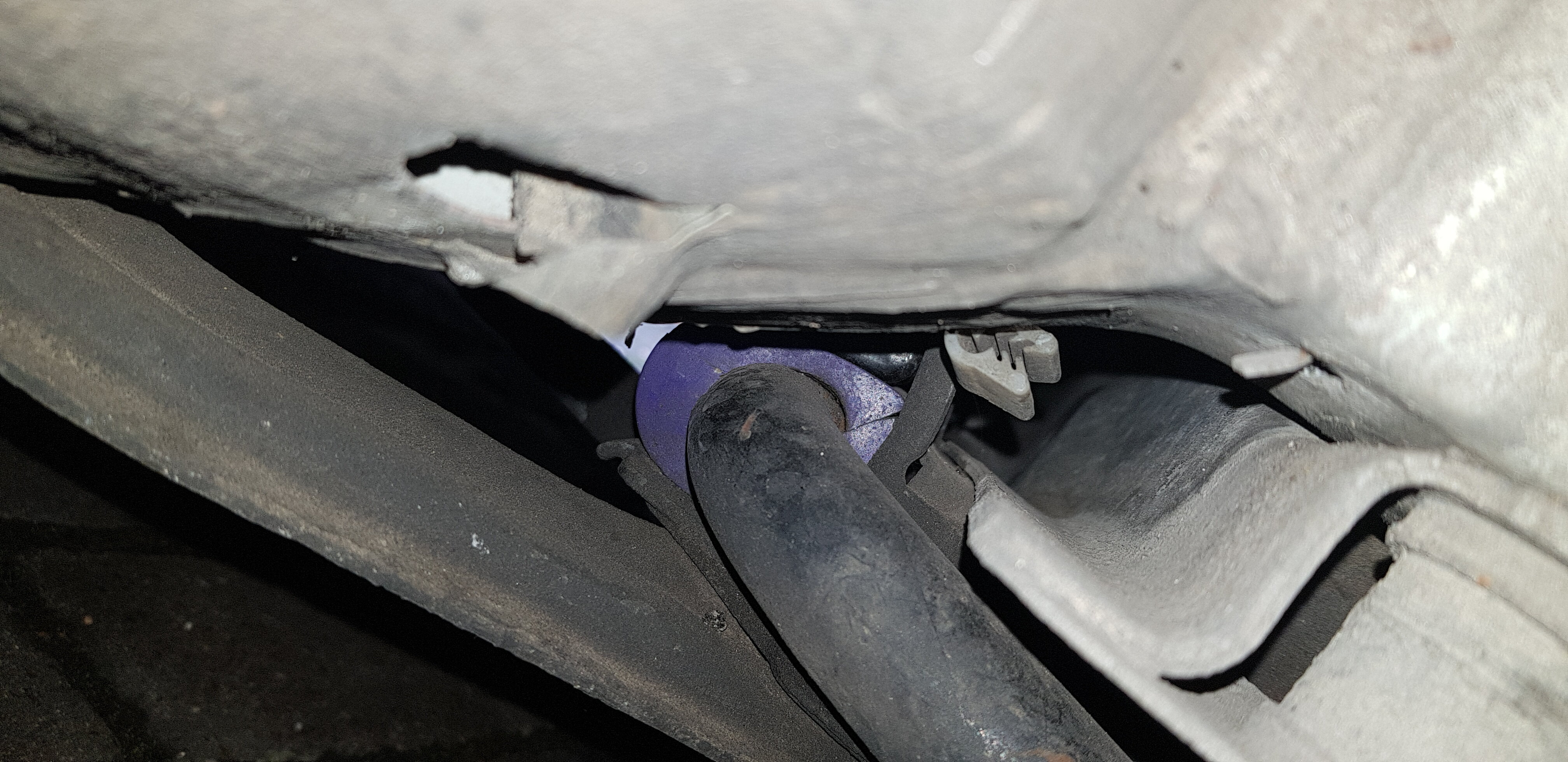

This is what mine look like after a year:
Yeah I thought it should look like that. Thanks for that. Looks like I’ll have to get my third set in 4 years.
Would the wear on mine cause knocking (quite loud) going over potholes and speed bumps? There’s still a good amount of material around the arb so would that be enough to prevent a metallic knock?
