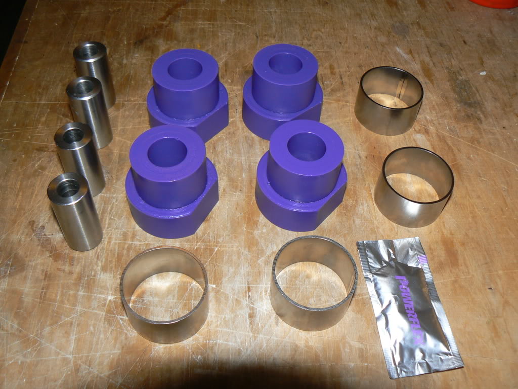

these are the poly bush set for the lower arms. one of the outer sleeves came out recently and it's obvious that it suffered some damage(maybe the arm suffered to I don't know). I want to make a custom replacement sleeve, although powerflex said they will send me replacements, I need the car fixed in a few days and time is a factor.
What I am asking is if some one has the exact dimensions of these outer sleeves, have them posted here so I can try and make some replacements.
obviously I could get the arm out ant take the measures but before that I thought it's ok to ask first ;)
they are the big metal things which appear to be pipe sections. the dimensions have to be very accurate for a proper fitment.

received e-mail from powerflex now. I will post the data here in case someone needs it some time.
outer diameter:45,1 mm
inner diameter: 42,2 mm
length:23,1 mm
