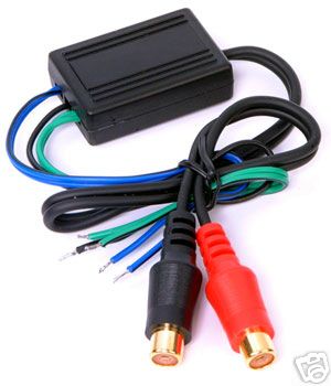

The Y splitters will work but you wont be able to control the output to get the correct F/R balance (or fade)
Your H/U will work as a 4 channel one if you use the line level adaptor for the front and the straight RCA output for the rear. And the H/U will control the fade correctly.
Thanks Brian, I will try using the line level adaptor as that is preferable to buying a new HU since I only bought this one 3 days ago!
This is what it looks like,
