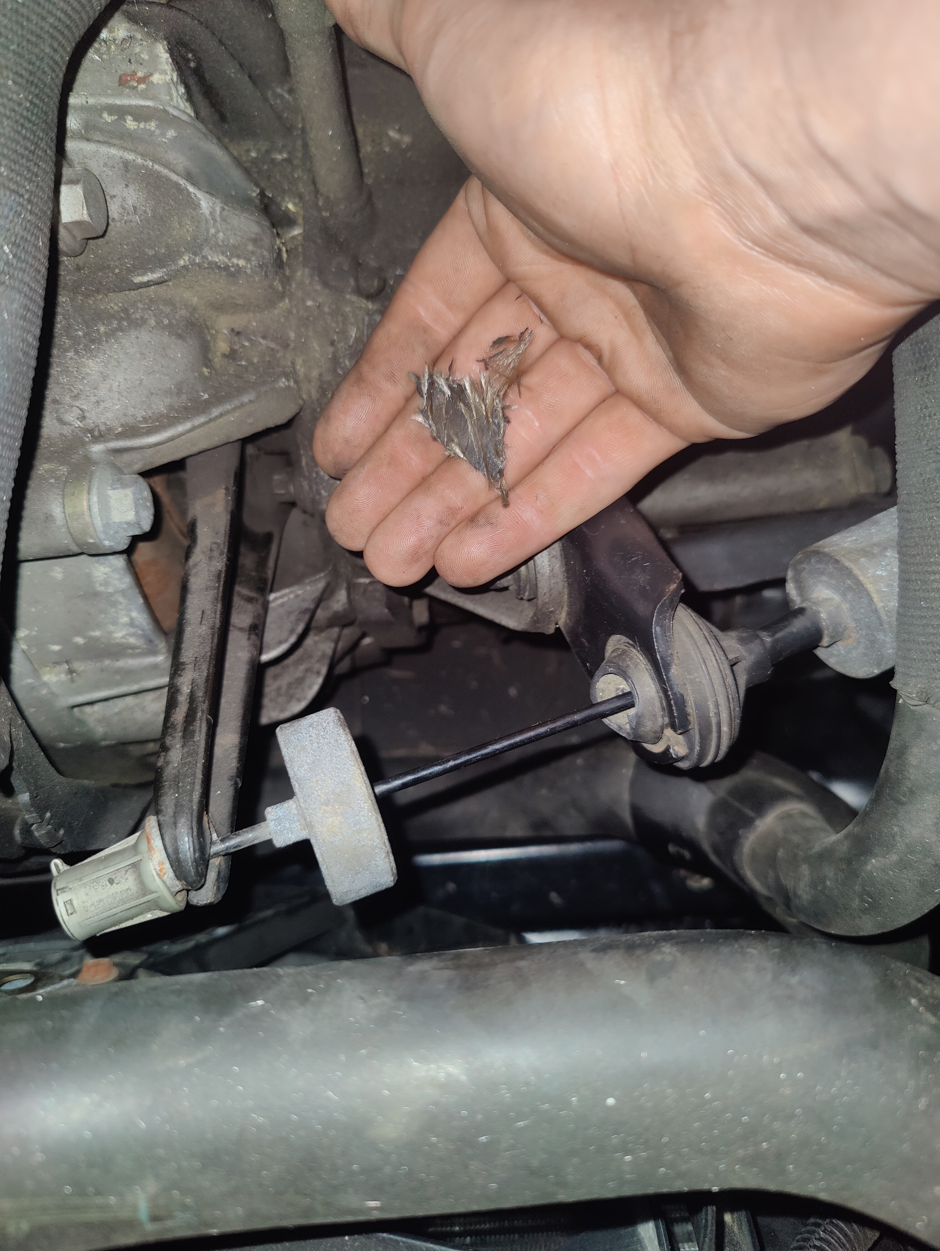

Pretty sure I need a new clutch 😃
Car  clio 172 ph2
The original clutch finally gave way after 100.000miles.
Couldn't get into gear anymore after hitting the redline.
I didn't need to do much investigating after finding these bits in the engine bay.
New Valeo clutch pack is on its way.
Have you tried poking it back through the hole?!
Not the worst job in the world, just not the best either!
I'll try using some super glue!
Kinda sucks as j just replaced the subframe. At least all the subframe bolts lose.
Never done a clutch change so it's going to be an experience from what I have read.
Im ready to break my back. Haha
