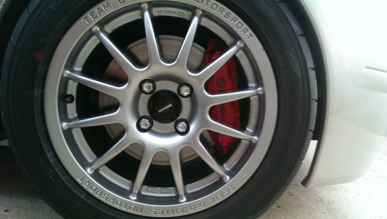

Might be that extra 2mm was just too much.
I had to linish the callipers slightly to make sure I had enough clearance with the 283mm rotors. 280mm standard discs were no problem.

Ah right, that explains it. The PMS kit is designed to accommodate their 285mm x 26mm 2 piece kit and with that on the TD 1.2s won’t even go near without a substantial spacer. Spacers make my car drive like s**t so wasn’t prepared to entertain that or start grinding brand new calipers. Lol
So my question still stands,
I wonder if these LTs will accommodate a Brembo kit? 🙂

Without grinding on the 280*24 discs and a 5mm hubcentric spacer giving ET30 overall.
If you want clearance you're best going for the 295mm AP Racing setup or 300mm discs with the Brembos and running 16s.
