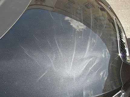

The above image shows these buffer trails mate. Normally associated with body shops who 'mop' the car with G3. What you may be doing is working the polish into the paintwork too quickly. Depending on the paintwork. Start of with 4 passes on speed 4, then 3 on speed 5 and a couple on speed 6. I then normall do a further 3 odd passed on a lower speed to imporove on the finish.
So it could be your turning the speed up too quickly, not giving the polish a chance to break down like its designed to.
^^That pic looks familiar ;)
That pic is actually some rotary buffer trails before I corrected them. With a PC you can instill holograms through not breaking down the polish enough or using too harsh an abrasive or running pad dry. Simple solution is to go over with a gentler polish

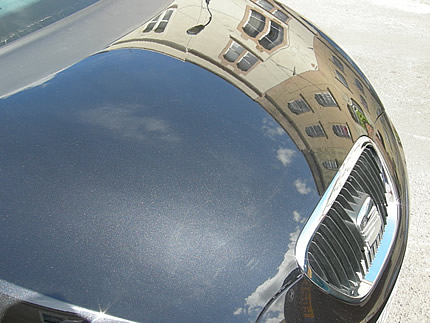

and the above pic afterwards
What a mess :(
They don't honestly let cars out there premises with paintwork like that do they (bodyshops in general)
Fair difference, i think if you have somene that knows what here doing it helps :)
