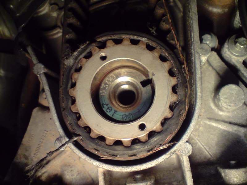

The Aux belt has frayed and a strand off the belt has come away, now at the time the car cut out straight away and the STOP light came on, NO engine warning light atall, since then it will not start theirs spark from all 4 cylinders and fuel getting throught. Ive been told that it has probley wrapped itself around the crankshaft and knocked the timming of the engine out.
The cambelt itself is still intact and has not snapped, it was only changed 20k ago but no sign of the aux belt being done at the same time. Also when you try to start the car the cams still move so thats a good sign right??

The cams moving is a good sign shows the belts not snapped but it doesnt mean it hasnt jumped a couple of teeth.

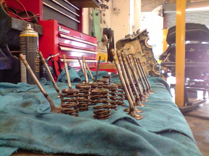

Now booked in for a full cambelt and aux change using renault parts for £400. if theirs is valve damaged probley not to all 16 as the engine cut out straight away i will be able to replace them all between myself and cookie jnr. So maybe not the end of it yet!

The cams will still move because the cambelt is still on all the pulleys. Its just jumped out of sync. You will find you can move the pulleys VERY freely with the cambelt off. This indicates damage. Also you will probably find the tappet rollers have all been smashed off.
