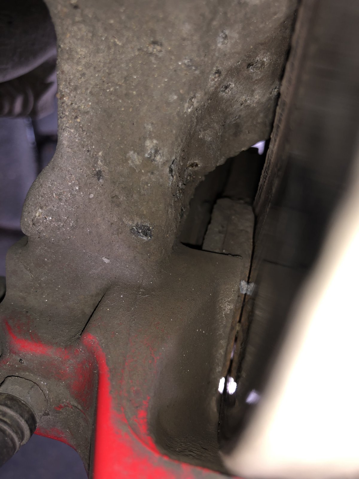

We’re on the car when I bought it in September mate, am I best off just getting some new pads before the ring? Will grab some pics of them Friday evening and post them in here
I'd strip and clean first. If there's not much friction material left then you may aswell replace.

Attached a video, that’s about as far as my investigation got as I couldn’t find the 12mm to remove calliper bolts but I’m assuming they look shot and not fit for the ring anyway? They’re fine when hot but that occasional judder doesn’t fill me with confidence when cold/wet.
