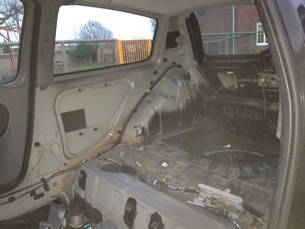

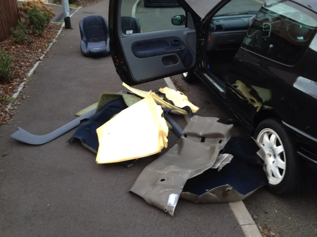

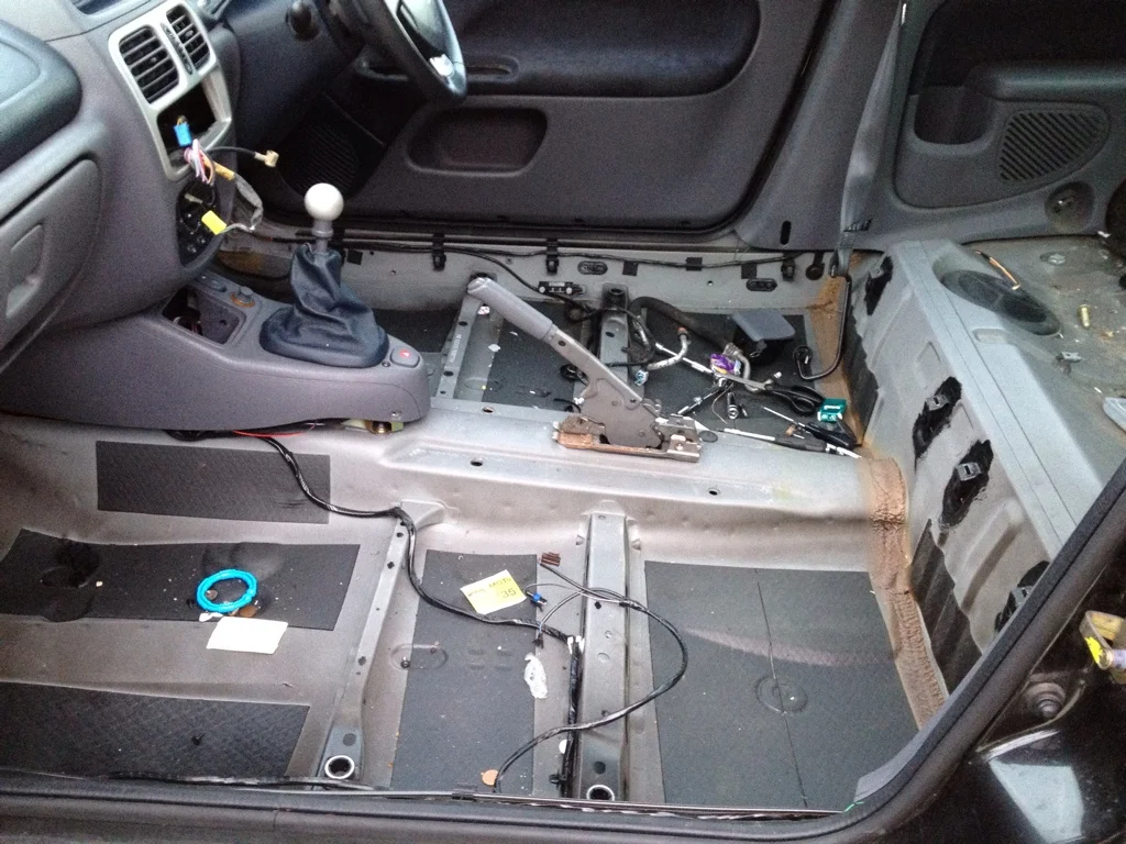

right so after work today i decided the interior was coming out so started with the seats which came out brilliant and it lead on to most hings now removed, i think tomorow i will get all the rest gone and get the heat gun out sat for all that tar type stuff
unsure weather to leave dash in or remove glovebox area or what....hmm any ideas guys?? anyone got a ph1 boss?? will swap with a ph2 steering wheel lol

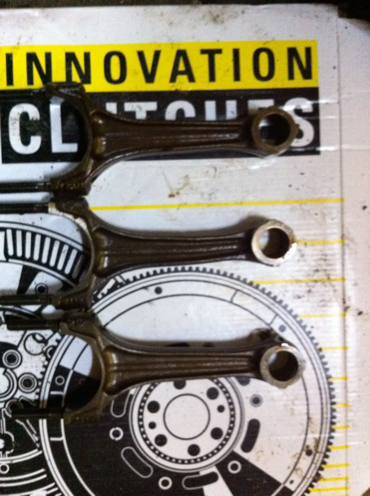

Im so confused with these engine, everyone says diff things. Does anyone know what power a AGU engine can take??
Seen a Few Cupra R's running around 350+ A6's running 300 at the most and Golfs at about 250 summit, safest around 320 on standard internals, think the agu has one of the strongest internals.
  silver clio 182
Agu has biggest ports BAM has strongest internals having thicker rods than the others and forged pistons once rods are uprated the worlds your oyster most use Integrated Engineering for rods etc very good prices if you want to run kO4 turbo expect around 280bhp and similar torque if your run a true 3inch intake you can get very close to 300bhp with a gd cooling setup and 3inch turbo back anymore power look at running a garrett can run over 300 safely on standard pistons like this as the bigger easier working turbo runs lower pressure and less heat therefore much more reliable than a k04 or K03

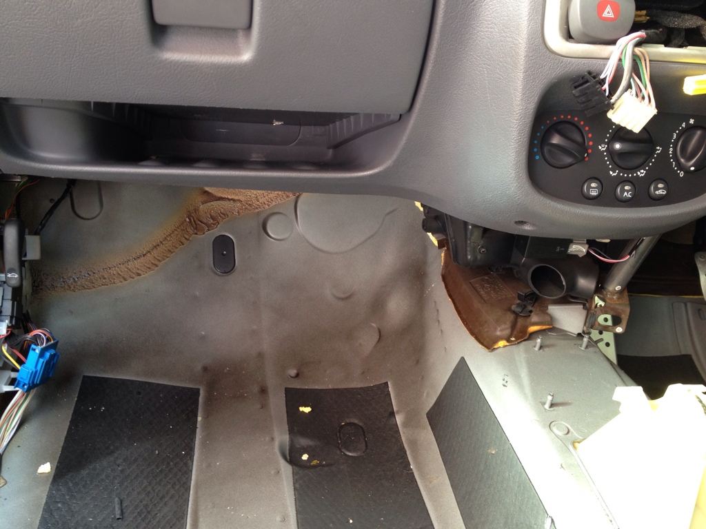

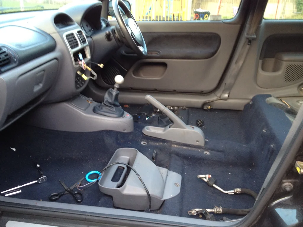

Header tank removed, all coolant hoses, all aircon pipes removed. Wiring look half off lol, more interior parts removed :)

Got more out the car today and door cards are off. Also got the aircon unit off which was a sack lol

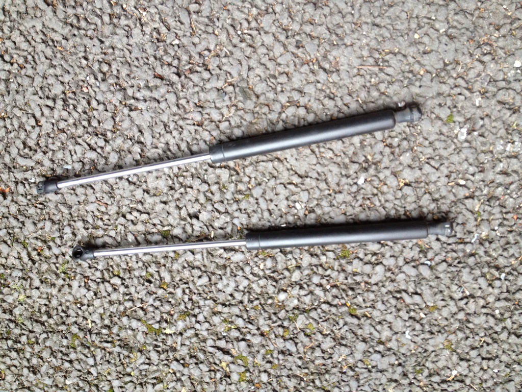

recieved boot struts today ( thanks mickstoke ) as i didnt have any. boot opens on its own now :)

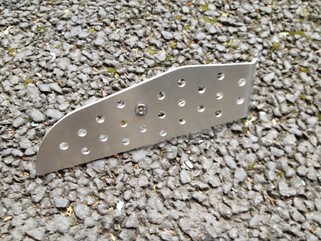

also recieved alloy foot rest as when i removed carpet and the plastic one it looked really crap!!

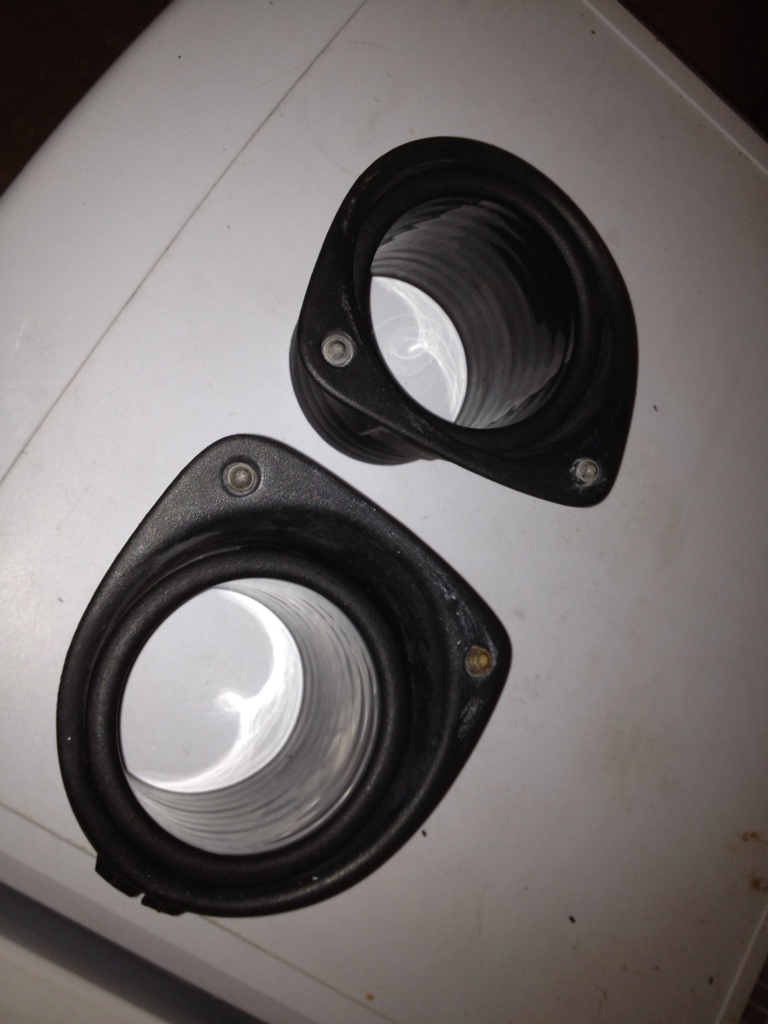

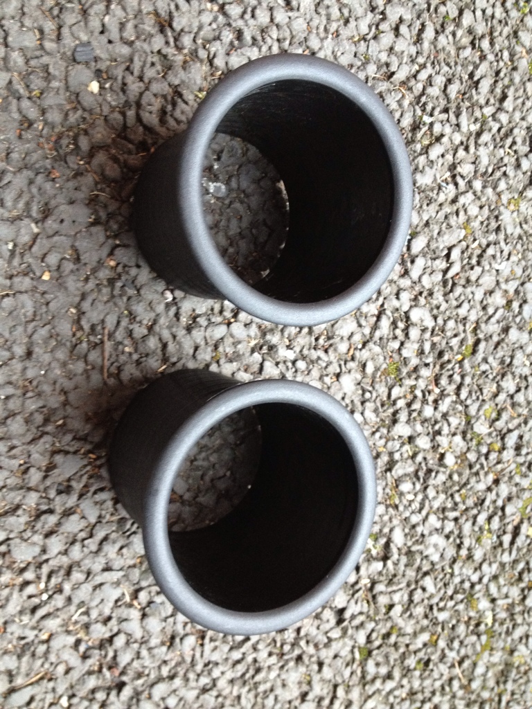

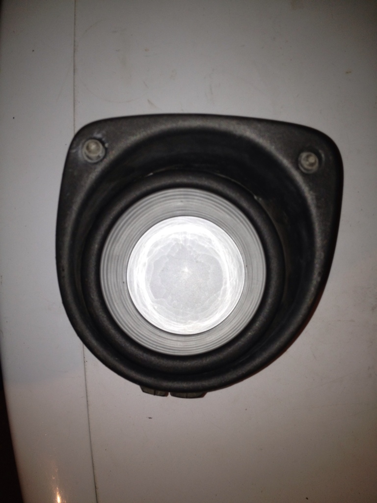

also got these for my ph1 fogs and cracked on. very happy with the outcome. just need to seal them in and clean them.

PS if you want 300bhp you will need a bigger turbo, manifold,440cc...etc it gets expensive...believe me lol
Its cheaper/better to stick with a std k04 turbo and manifold. aftermarkets for k04 manifolds are pointless, the turbo is the limiting factor. Also they are prone to cracking so check the exhaust housing before you hand over any cash.

Rods, well. Rods bend very easily, i literally took a set out of an s3 this morning that has bent 1 at 260lb-ft. you'd be stupid to not put rods in.
He was lucky for it not to damage anything else.

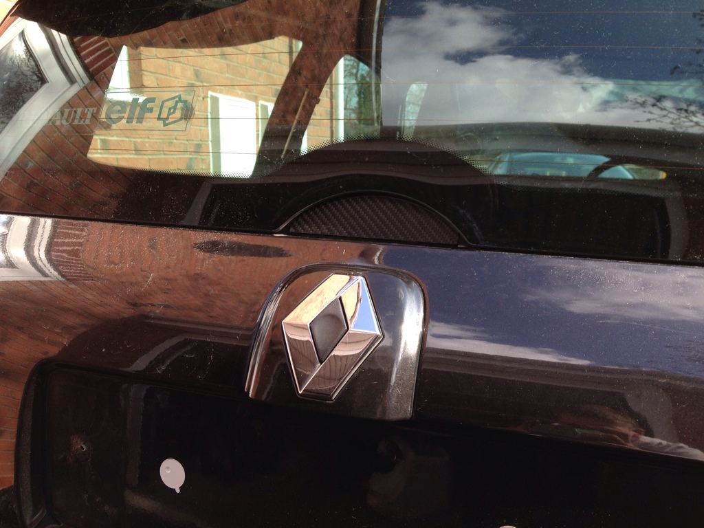

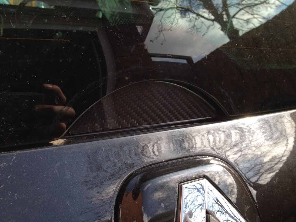

made a carbon blank for the rear wiper and trial fitted it. will wait till cars is painted properly and bond it on

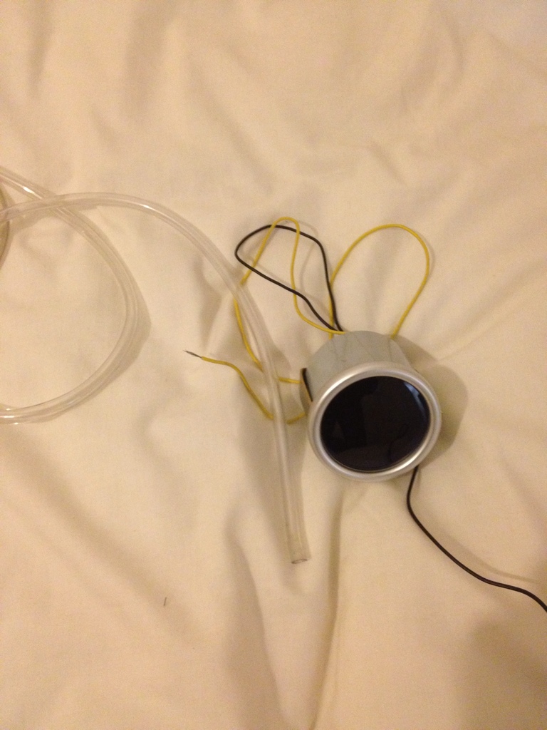

also got myself a boost gauge, going to make a stereo blank out of carbon and mount it there along with cig lighter, hazard switch and central locking button and whatever else takes my fancy.

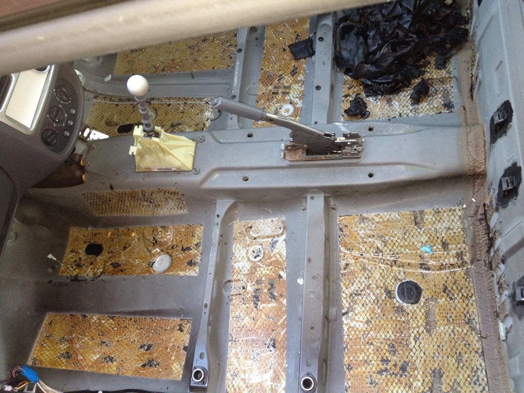

ive still got to remove all that tar crap and get the grinder and all the little bits, decided to keep dash in and see how it goes painting it will plasticoat or what ever its called, just not sure how durable it will be, top dash is being flocked

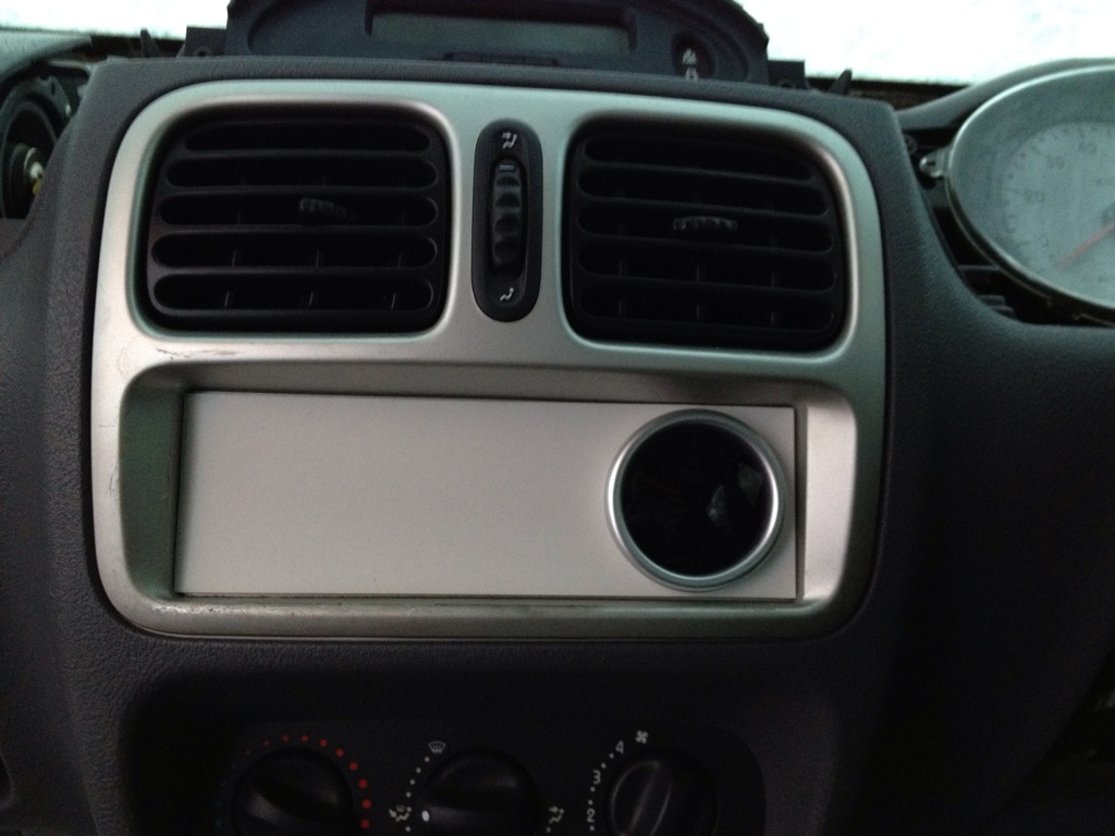

started making template for my carbon stereo blank so here it is ( just template lol ) still switches to sort out

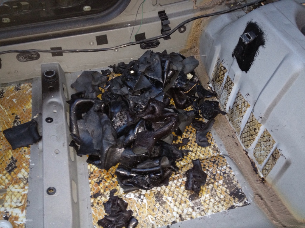

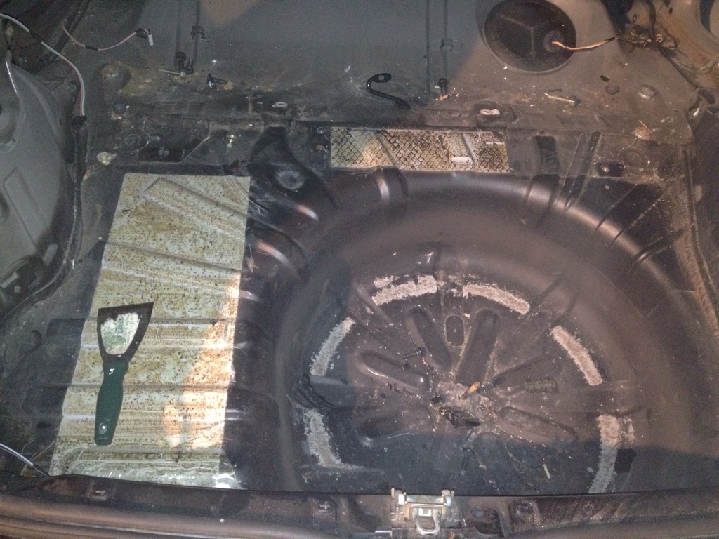

got the rest of that tar stuff out tonight so all gone now, it weighed 4.4 kg if anyones intrested lol just need to give it all a clean with turps now.
  secret
took me about a hour with a heatgun and a scraper, was hurting my legs towards the end lol
next job is the fun part, the grinding :D
