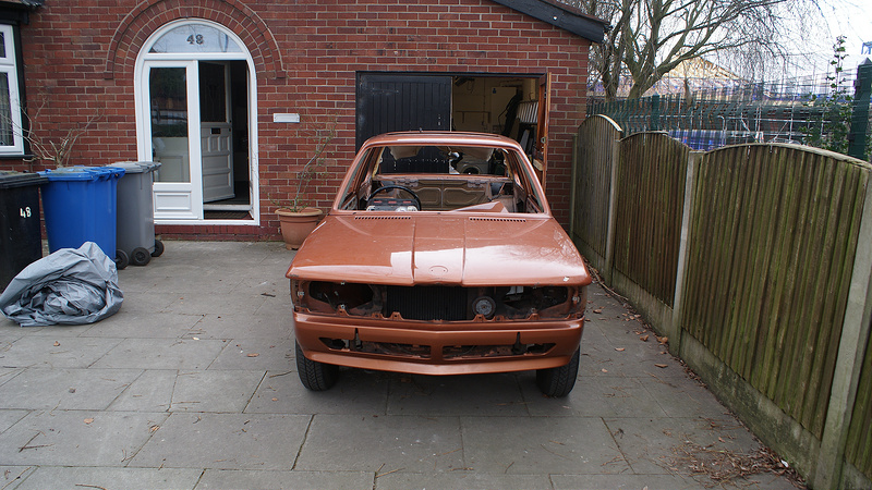

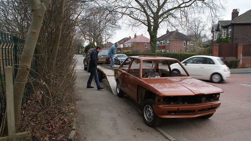

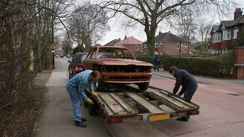

So the brownmobile went to the paintshop this morning.
My mate and his dad trailered it there for me :)
Very excited now :)

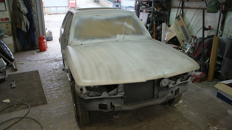

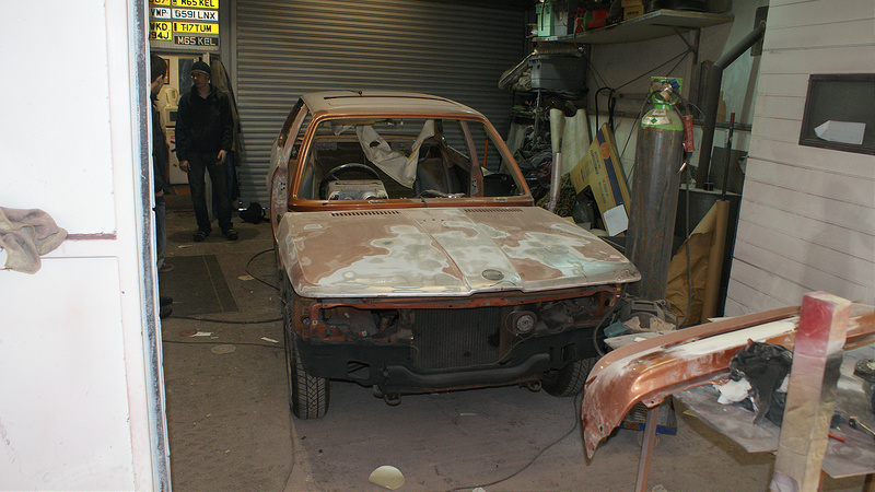

I went down to the bodyshop this morning to catch up with Lee and how the car is doing, he's made good progress and I'm now very excited for it to be finished and back with me!

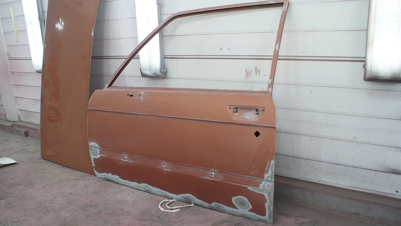

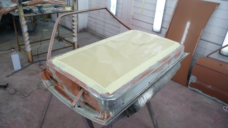

Doors:

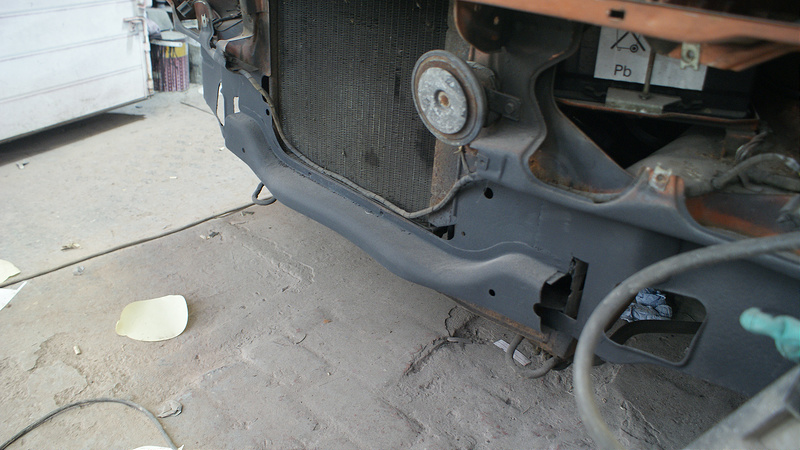

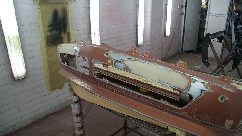

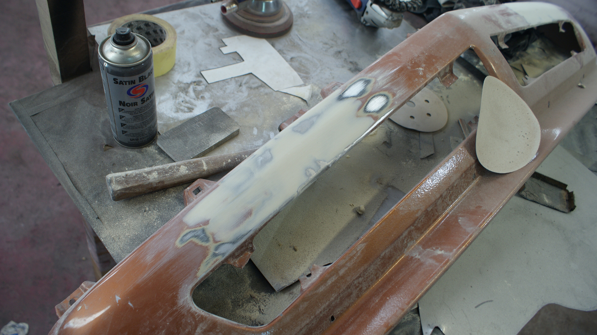

Lower valance smoothed off for a cleaner front end:

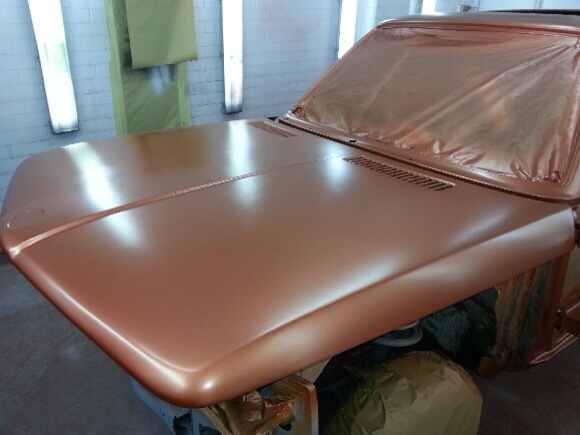

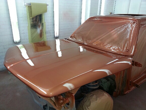

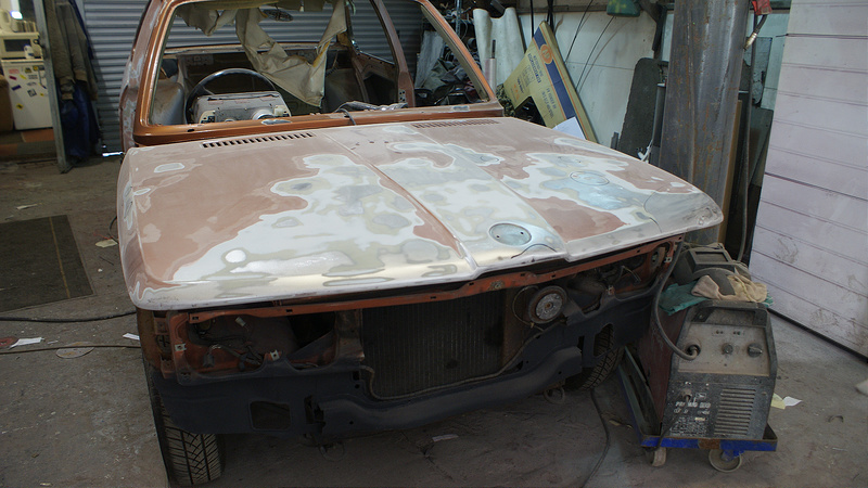

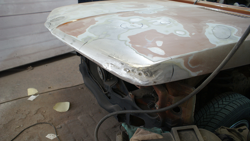

Bonnet, which is like the face of the moon really, Lee is working wonders on it though:

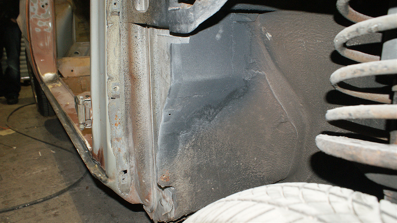

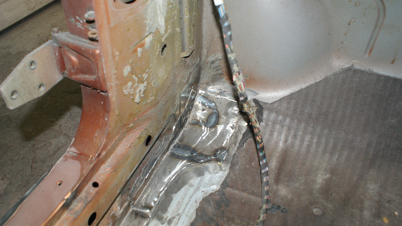

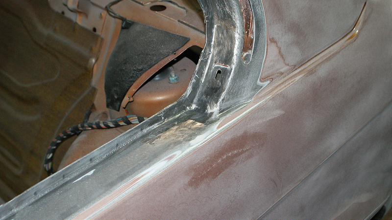

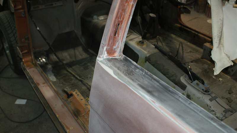

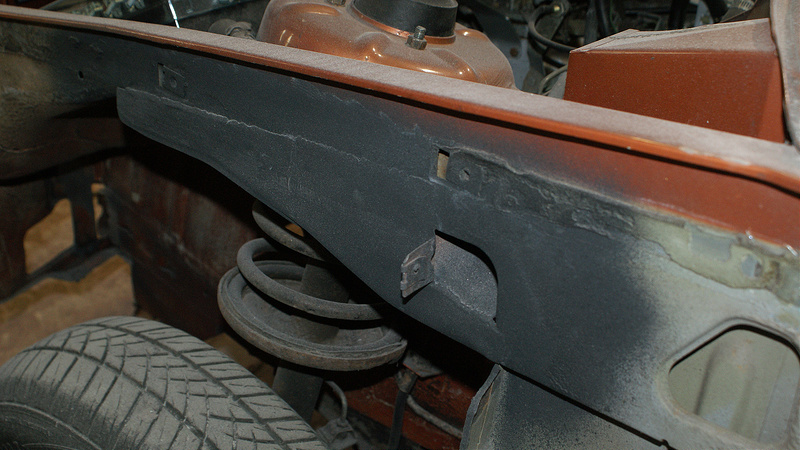

Repaired lower chassis rail:
Remember the big hole in the passenger footwell? All gone:

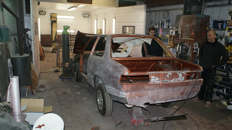

Few bits and pieces around the car:

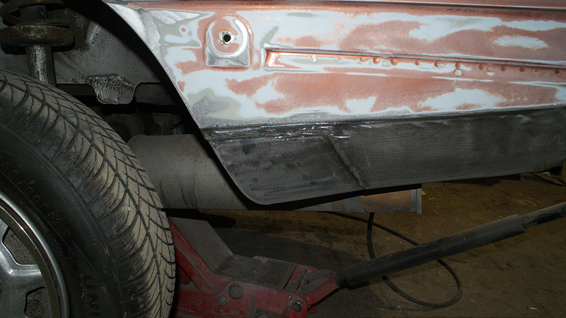

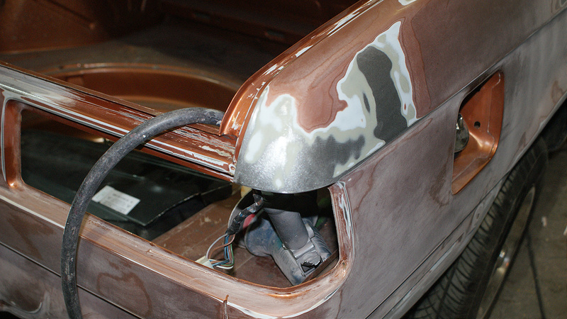

New lower rear quarter:
The hole behind the pedals, all welded and sealed up :)

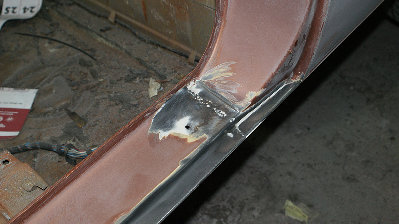

New arch to inner wing join:

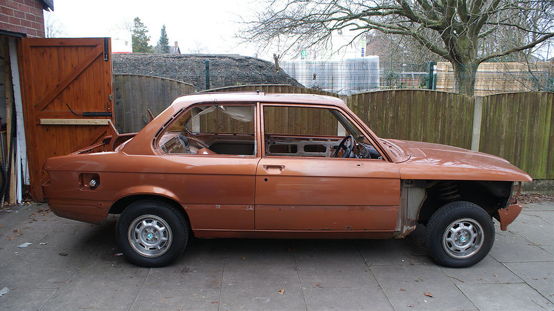

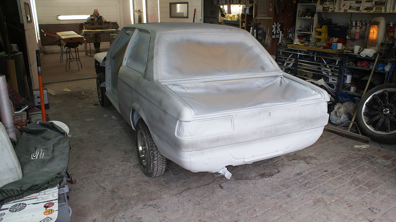

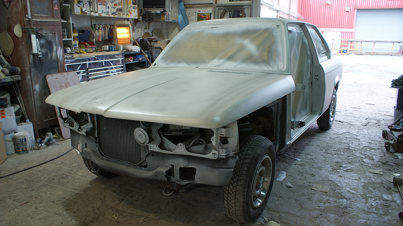

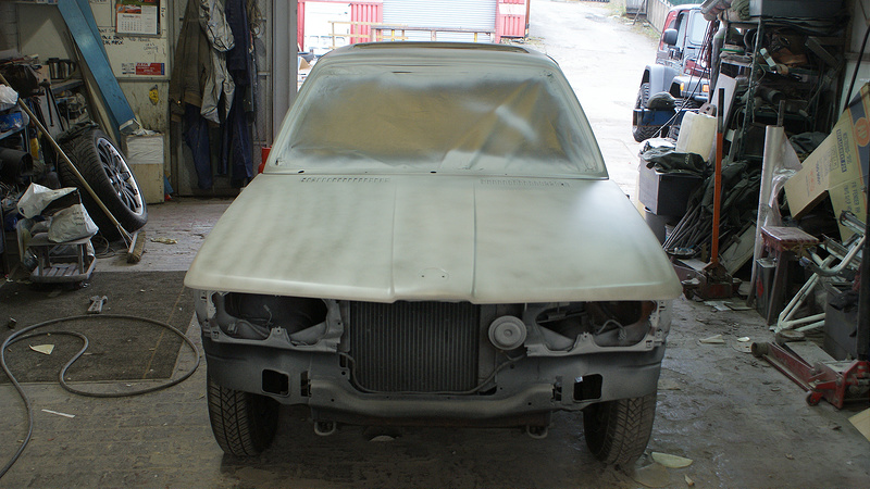

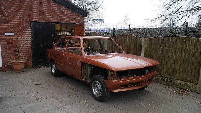

And a couple of the car as a whole :)
All very exciting!
I'll go back next weekend to see it again, by which point it should be primed and ready for paint :)

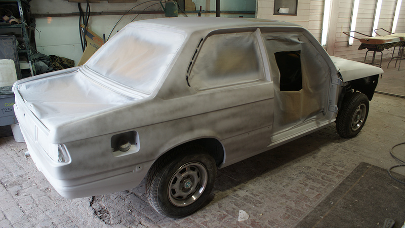

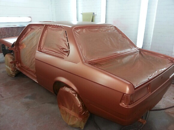

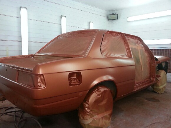

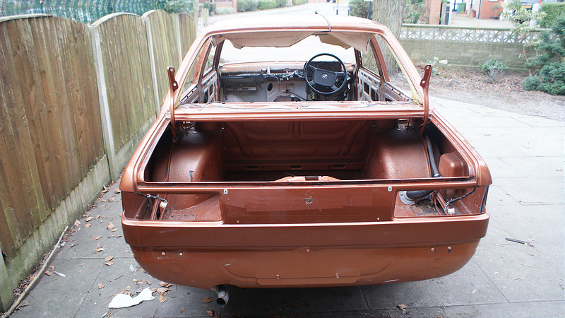

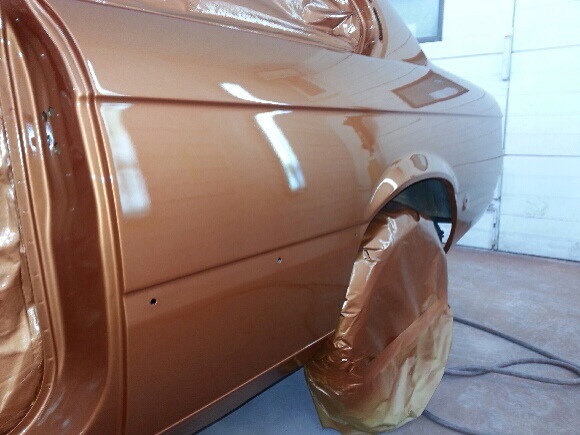

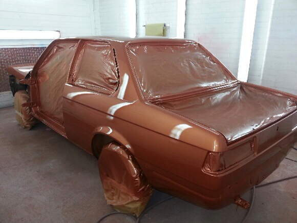

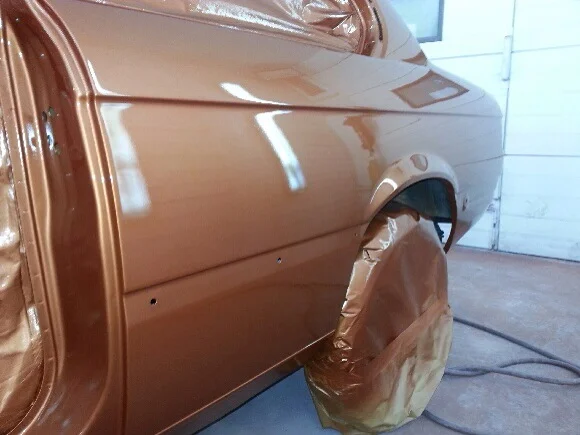

Went down to Body and Design today to catch up with Lee and the progress on the car.
All looking good, base colour is due to go on next week, ready for collection on Good Friday.
Smoothed front valance is looking well too. Very excited for that.
Not long now :)

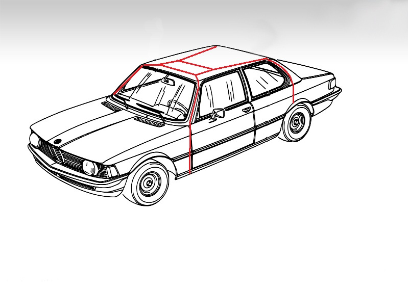

One of the first jobs is to sort the drains.
This is how they should be laid out:

So the plan is to drill the sill, Waxoyl the hell out of the inside of the sill, insert a new rubber pipe and attach it to the end of the existing one, then finish it off with a rubber grommet, so the water from the sunroof will drain out onto the floor.
This is one of the more immediate jobs that needs doing, otherwise I'll be back to square one with rusty corners.
