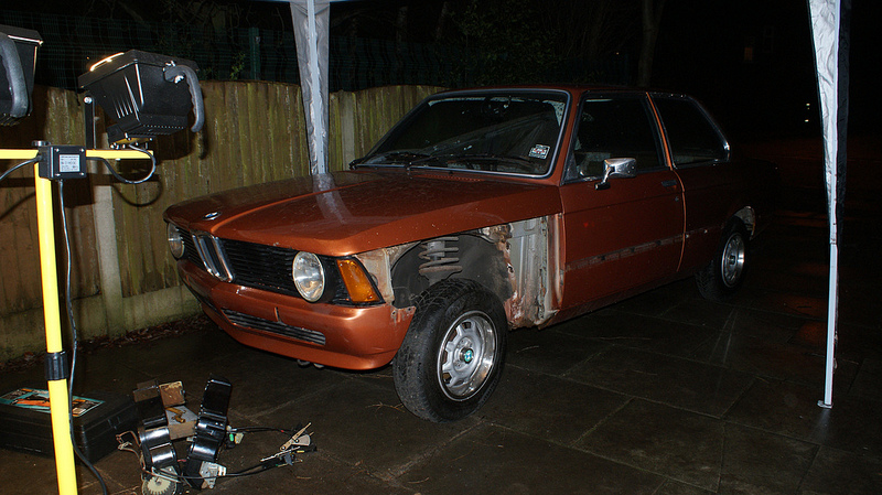

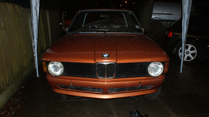

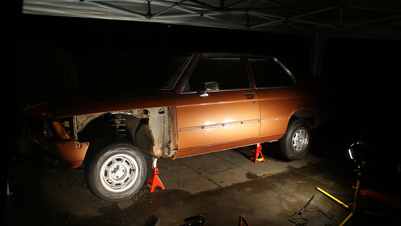

Took the last of the trim off last night, personally think it looks awesome without the front bumper!

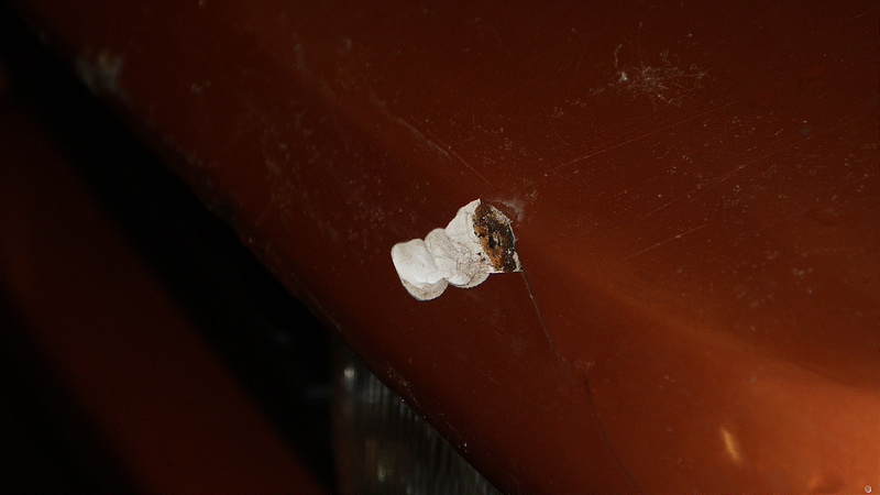

Also, there's a bit of a dent on the front corner of the bonnet, it's been repaired with a fair amount of filler :(
Welding quotes still need to be sourced, and then paint.

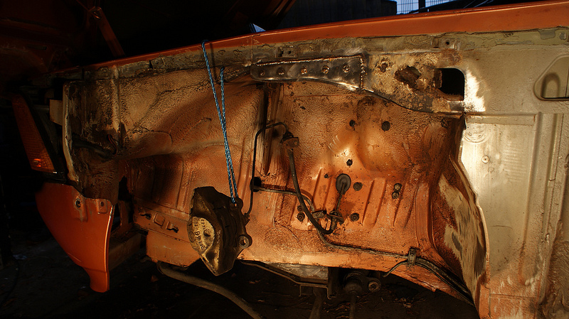

In the meantime, I'll be getting most of the underseal off and reapplied with fresh stuff.
Another night...

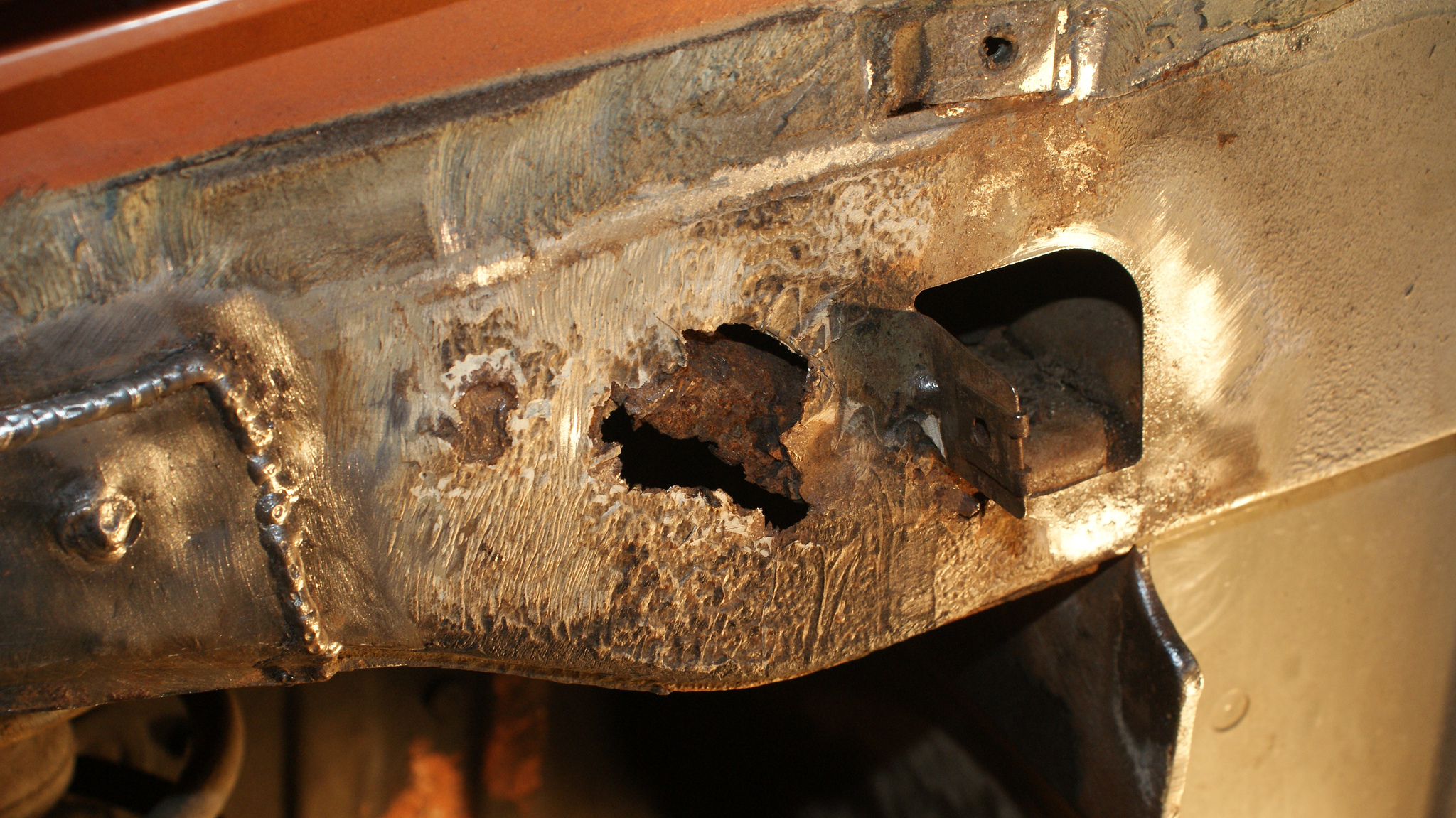

Another problem...
More rust. :(
I also started tackling the underseal, it's come off quite well truth be told, Autosmart Tardis turns it into water, and it wipes off with a rag. Only thing is, it's messy and you go through rags like there's no tomorrow!

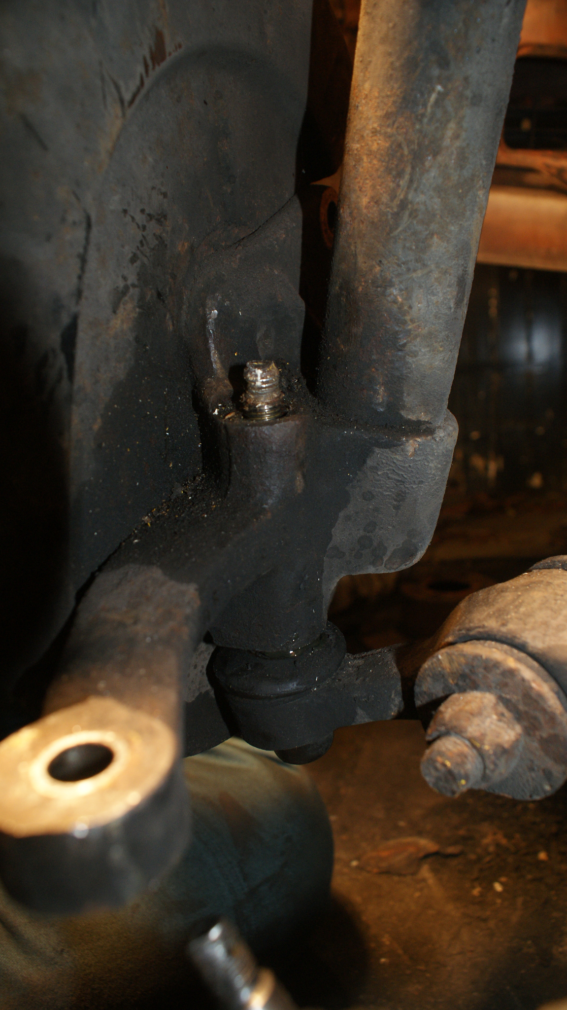

Also tried to get the dampers off, so I could have better access in the wheelarch, but I need a long ball joint splitter to get the damper/hub assembly off the control arm ball joint.
Trying to stay positive, 'tis my birthday on Friday, so hopefully should get a fair few bits for the car then :eek:
So I've been told, but I've also been told it's the only way it's coming out.
The thread on it is pretty rough anyway, I'll probably have to get new control arms :(

I still can't get over how good it looks de-bumpered.
Yup :eek:
