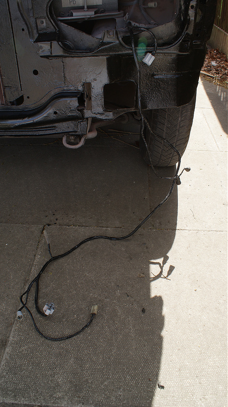

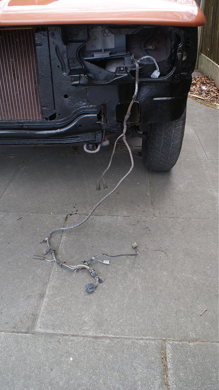

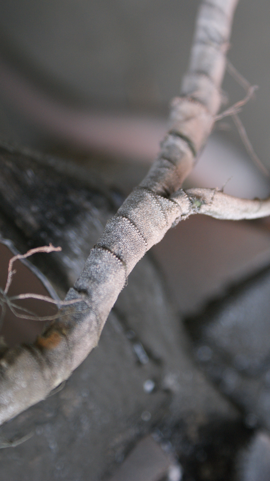

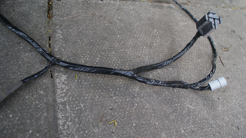

Started recovering the loom, the old tape is all dry and crusty and really needs replacing, so I'll redo the whole loom.
From:
To:

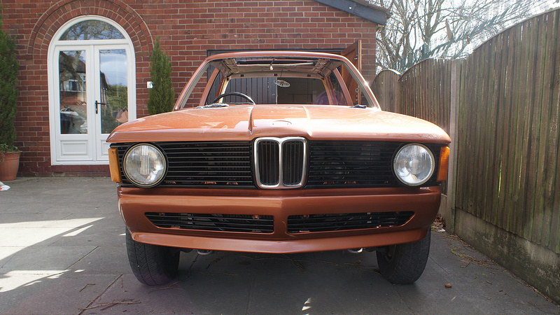

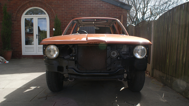

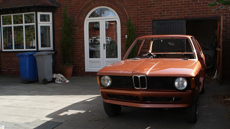

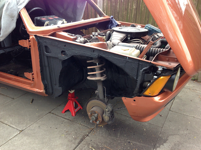

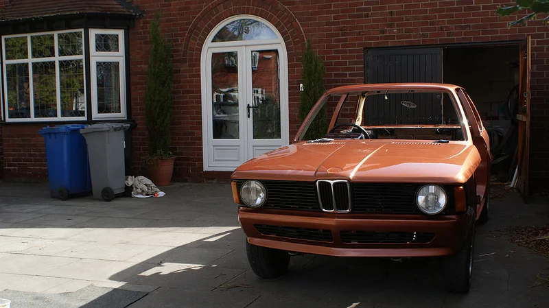

Decided to get the front end on too.
Looking goofy:

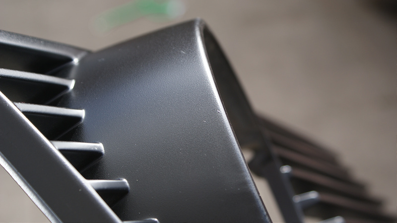

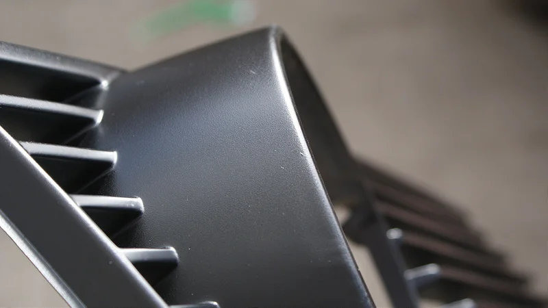

More Plastikote Satin:

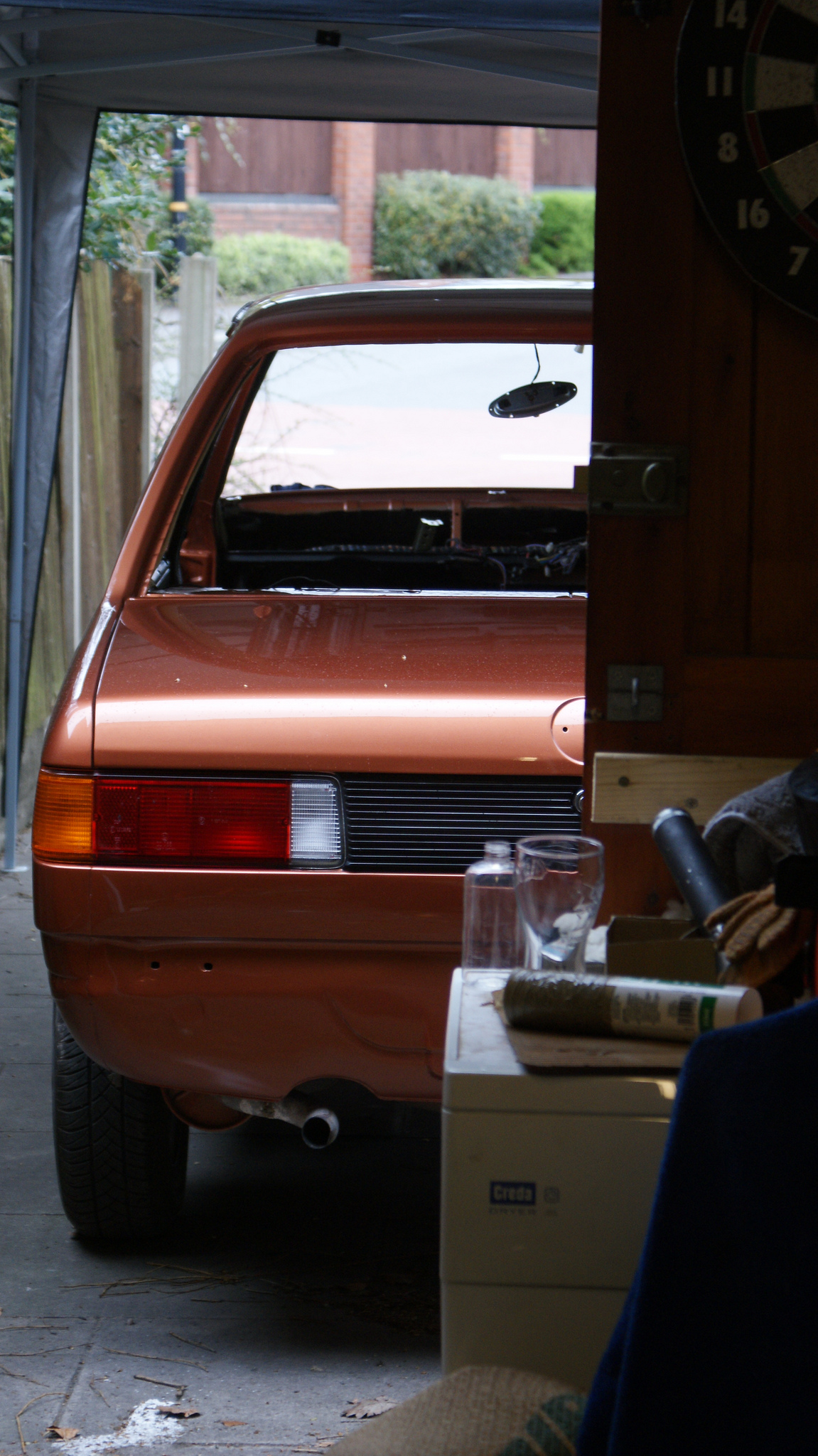

And finally, my debumpered E21 :)
As I expected, I love it! It harks back to the 2002 in so many ways, and really accentuates that sharknose!
So excited to get it finished now!

Get on vehicle wiring products and buy some proper stuff for pennies!
Will look much more oem and do a better job ;)
Rob
Aye, credit where it's due, this is my first "build", I've never done this before, deep end and all that! :eek:
As said, I'll get some non adhesive tape and redo the whole harness, it's a 36 year old car, so tbh, there isn't much wiring to wrap!
Rob
You're doing superbly so far IMO mate, proper cracking job. The heat shrink always make such a difference to the ends also, so don't miss out on getting some of that too!
Jaff.
The braided sleeping stretches over them, add some nice heat shrink on the end and you have a good looking and secure coating.
the twist wrap is easier to apply but its harder to make it look nice, still looks better than the electrical tape though.
Its 70p a meter worth buying a meter of each size and seeing which suits each part of the loom better
The braided stuff will stretch over a big chunky connector???
Jaff.
Yeah it's awkward but you squeeze it together, feed in the cables/connectors then leave it go and it pulls itself tight (remember those finger traps when you were younger? Bit like that)
Like I said get some different sizes and work out which looks best. If the connectors are too big maybe the twist wrap is a better option

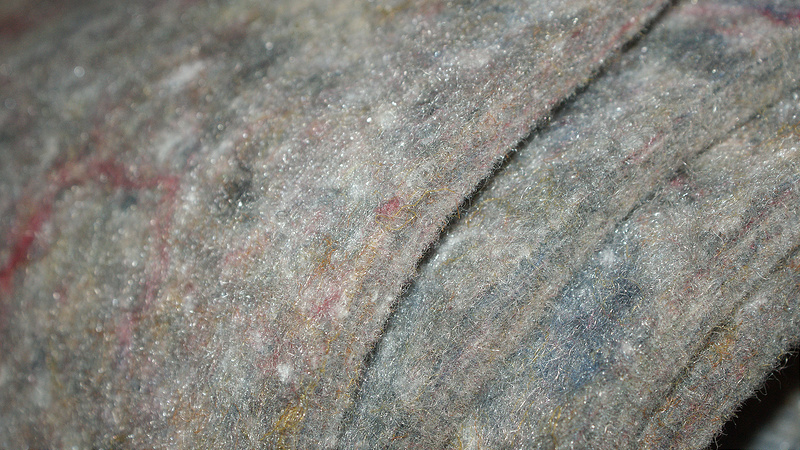

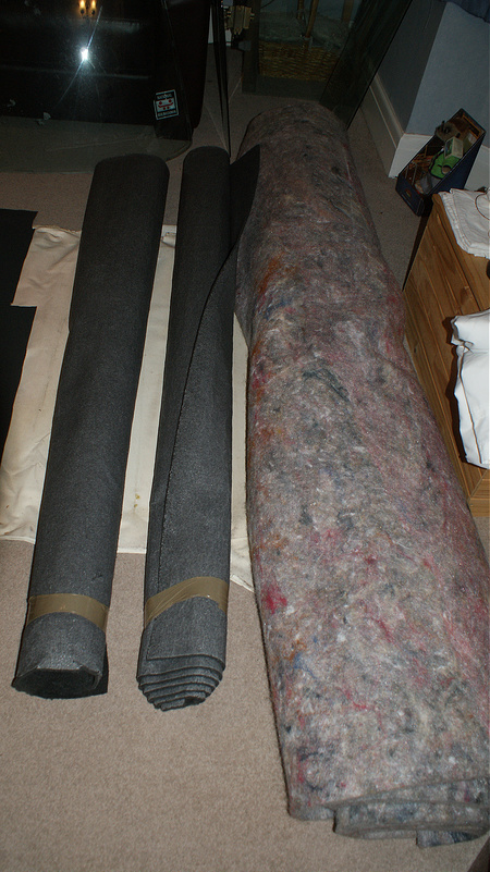

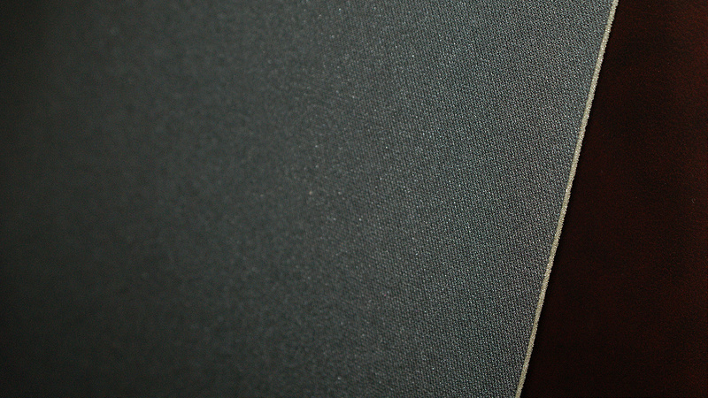

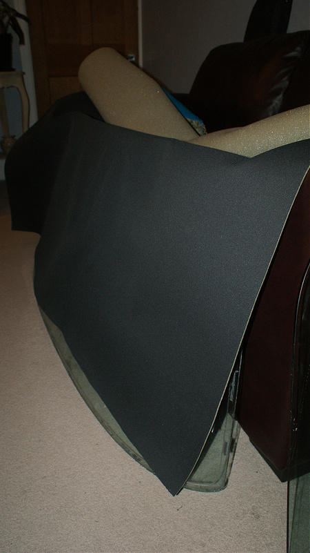

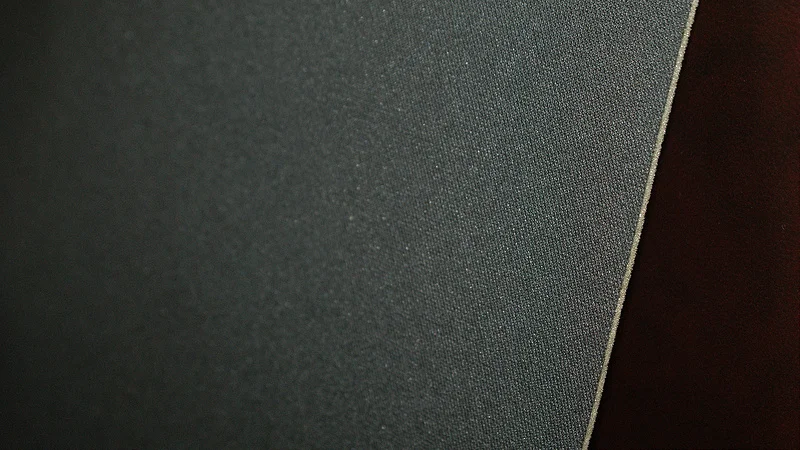

As promised, some photos of the headlining.
It's quite difficult to capture the colour and texture, but you get the idea. It's a foam backed nylon material in a charcoal shade.
Will start making it soon, using my old headlining as a template.

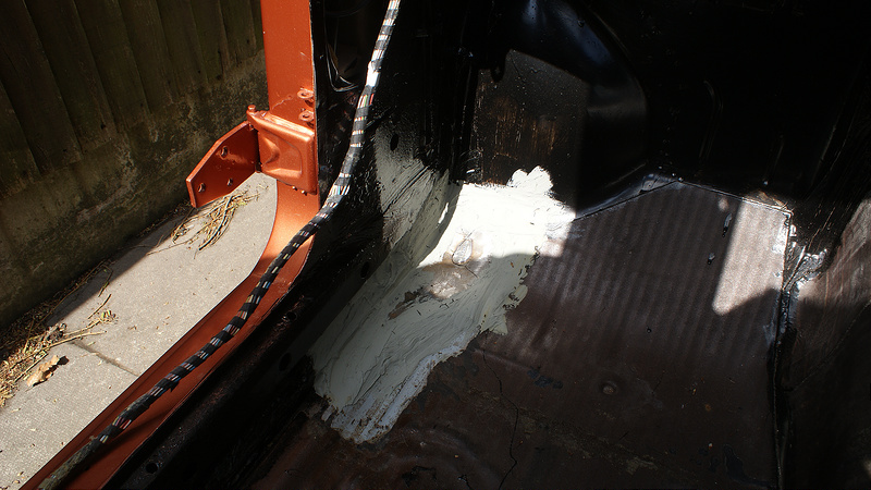

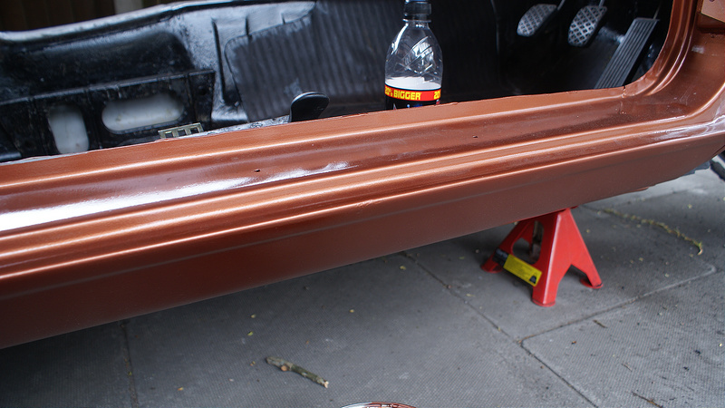

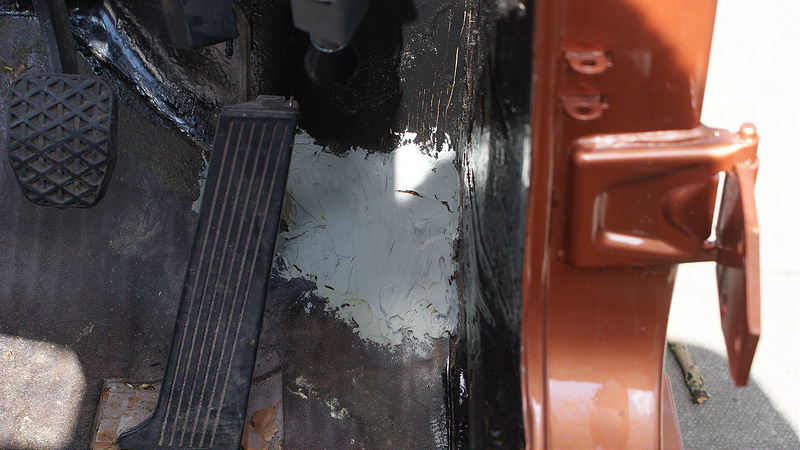

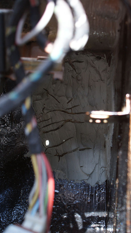

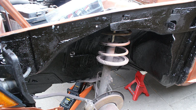

Got a few bits done this weekend, including some seam sealer on the repairs:
I noticed that the sealer had cracked on the upright repair, anyone know why this would happen?

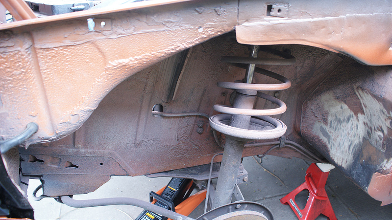

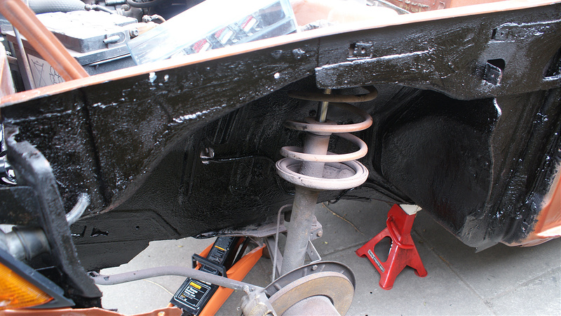

Arches undersealed:

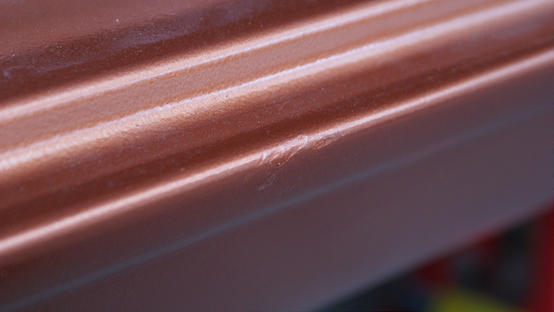

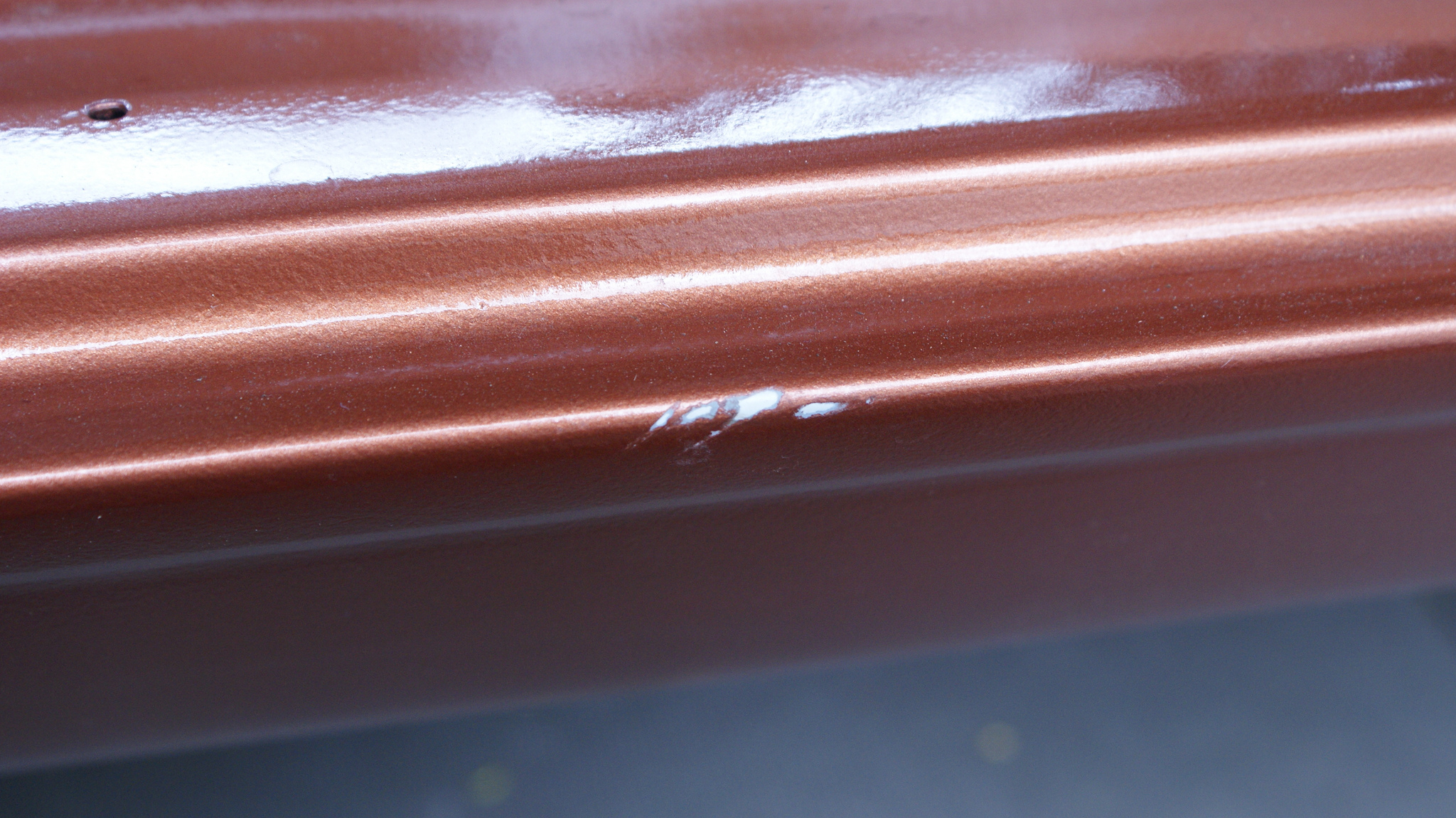

Yesterday I noticed that the sill on the drivers side has been damaged:
No idea how that has happened, but obviously I was pretty gutted.
Fortunately Lee gave me the rest of the tin of paint used to respray the car, so I got a modelers brush out, and touched it in.
Not perfect, but a hell of a lot better than it was.

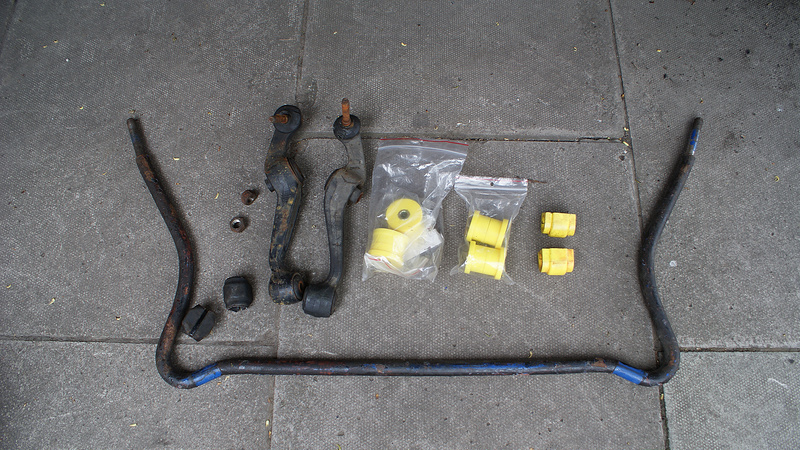

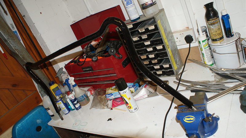

Also, picked up my upgraded front end.
All of this has been kindly donated to me by the lads on the E21 forum, I have to say I've been massively humbled by their generosity, cannot thank them enough.
Spec:
- 323i ARB (6mm thicker than my 316, and slightly improved design)
- Series 2 control arms (to allow the fitment of the 323i ARB)
- Stongflex polybushes (90A hardness, bushes for ARB, control arms and diff)
Gave the ARB a hit with the wire wheel and some white spirit and gave it a fresh coat of paint.

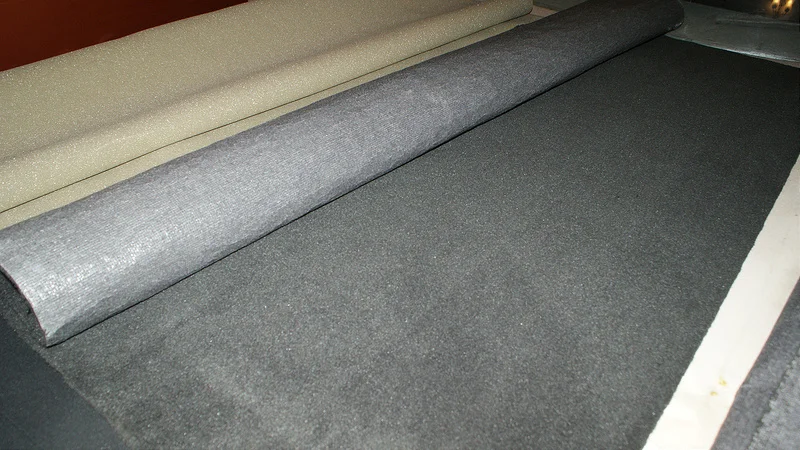

how mcuh did the carpet cost? need some for a k-series midget at work :)
i bloody love this thing, its got me looking at old bmws now :eek:

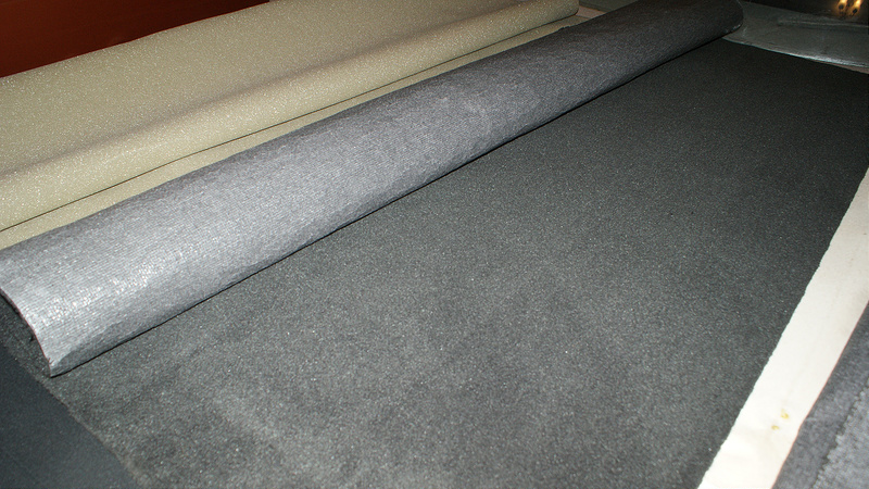

Carpet was £10+ VAT.
Segals Motor Trimmings in Salford.

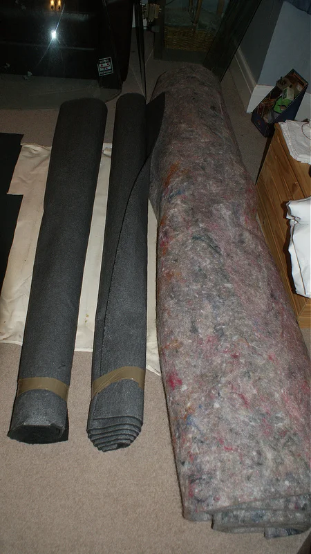

Don't know if you're local, but if you are, go down as apposed to online. They have some mega bargains, especially if you get the end of the roll. My headlining, underlay and carpet has cost me £67 inc VAT.
​Bargains, I'm doing it right ;)

As for the sealer cracking, have you jacked it up or similar? Looks like stress from flexing etc?
