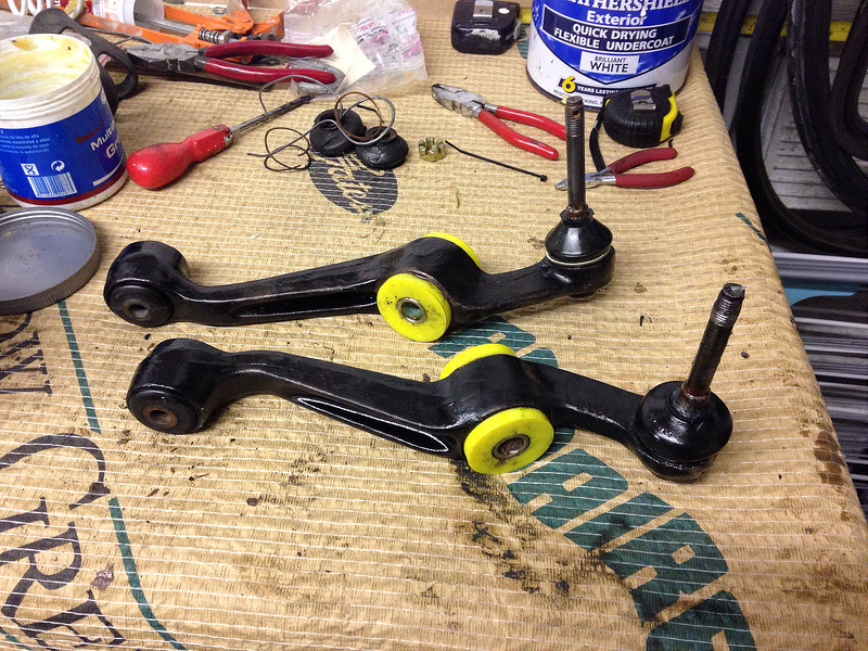

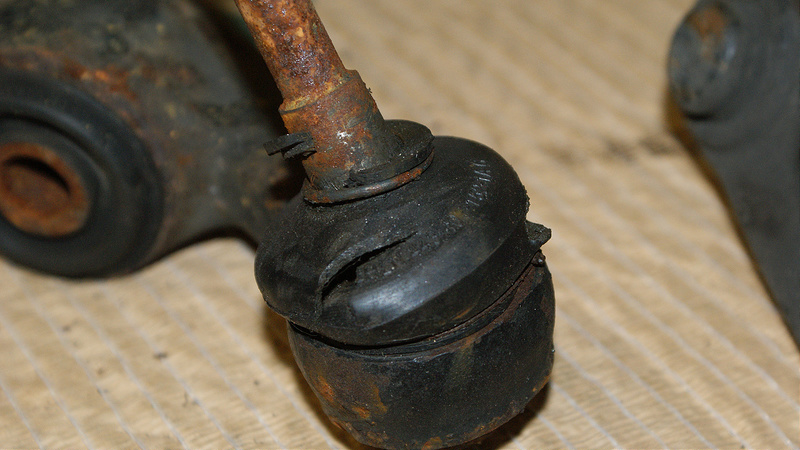

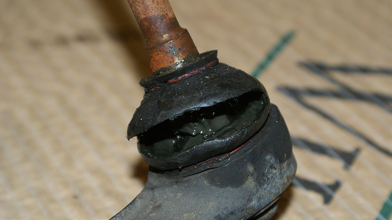

Sorted the control arms out today.
Original rubbers were destroyed, arms were looking rough, and threads were rusty.

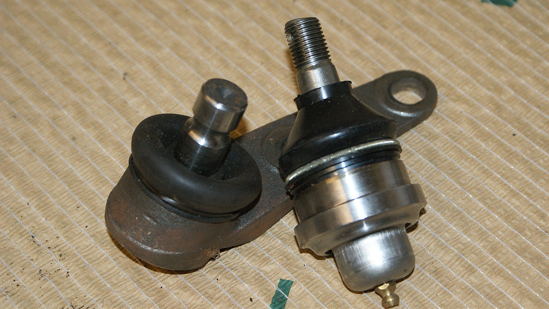

Popped down to a local car place, picked up a pair of random ball joints for a couple of quid:

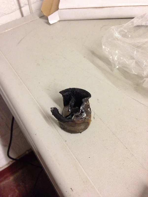

Burnt the rubber out of the ARB to control arm bushes, then hacksawed the metal sleeve out. Tried a socket and vice, it would not move at all.
Metal sleeve certainly bit the dust:
A bit of a clean with the wire brush, some hammerite, new rubber boots on the ball joints, and new polybushes :)
Better than stock :)

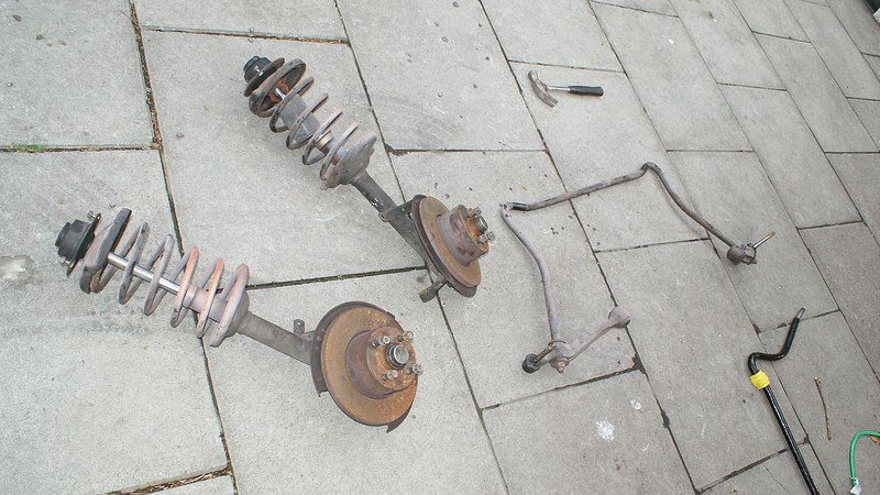

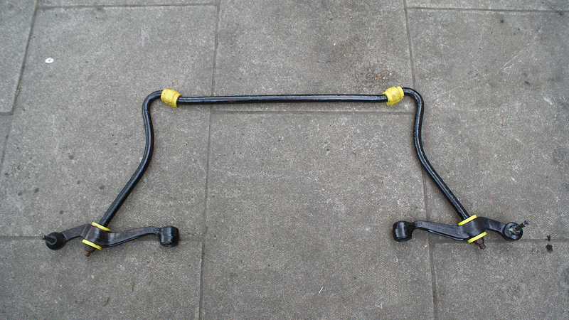

Got the ARB all fitted up today.
Was going to fit the coilovers today, but my hubs don't fit, I was told they would but it turns out I need 323 ones. :mad:

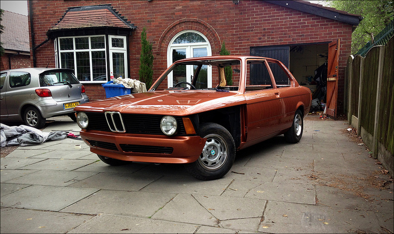

Some progress.

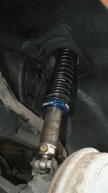

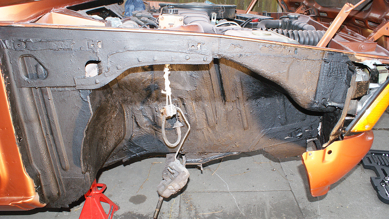

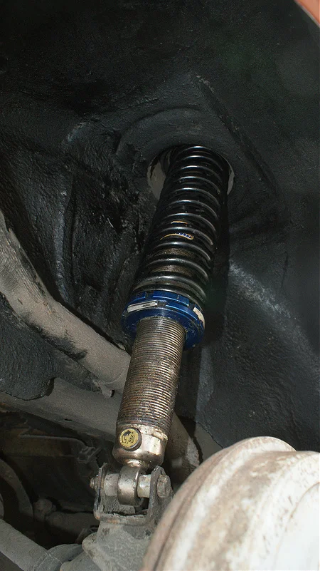

Yesterday myself and Christopher got to work on the suspension. Namely, fitting the new dampers.
First off, it was a fraught day, everything we tried to do just went up the wall.
- New ARB doesn't fit, had to revert back to my original one and clean the threads up on the control arms.

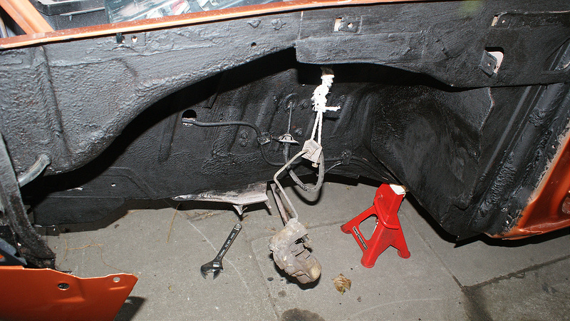

- Coilovers appear to be missing a thread on the caliper mounting bracket, need to investigate further.
- 323i hubs I bought so the 323i coilovers would fit, have a cross-threaded wheel bolt hole.
- Retaining screw on the 323i discs was rounded to hell, and I had to angle grind it out, meaning the thread is still in the hub.
All in all, a tedious day, that said, we did achieve victory:

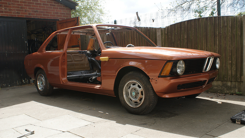

With the wing test fitted:
Need to do some work on the wing, it doesn't seem to quite fit properly atm.
I'll get some better pictures of the front suspension over the rest of the weekend.

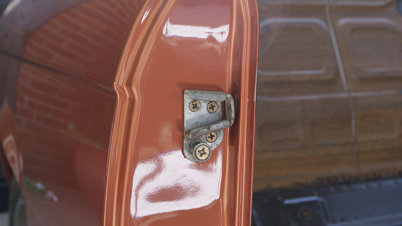

Got the door stops on too:
Still lots to do, but it's getting there, if a little slowly!

Can you not put a bit of rattle can silver on the door lock thingies? They look minging up to the immaculate paint!
I started with all that sort of thing. I've started realising that doing that, will leave me with this thing finished in 2 years! In the interest of getting it finished, I've got to accept a few things won't look brand new. Not just yet anyway.
welshname
Precisely this. It's not a big job to take them off at a later date and paint them. Get it to a driving project first.

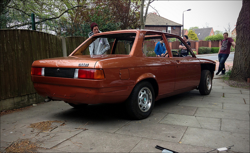

You know who your real mates are when they're prepared to stay and help hang some 36 year old doors while I shout and bark orders.
Massive thanks lads, today was fantastic. Great progress, great effort, this thing is going to look the fecking dogs!

When your ready you can send off a bag of bits to get plated, they do "clear" (sliver to us) or yellow (gold to us) for about £30.
Its not worth spray painting tbh as it wont last (bits like door catches)
I got my Clio wheel bolts done while my wheels where away being powder coated, that was almost 2 years ago now and they still look like new.
