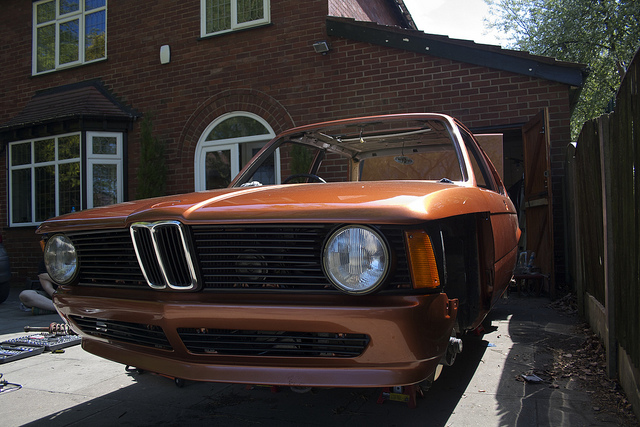

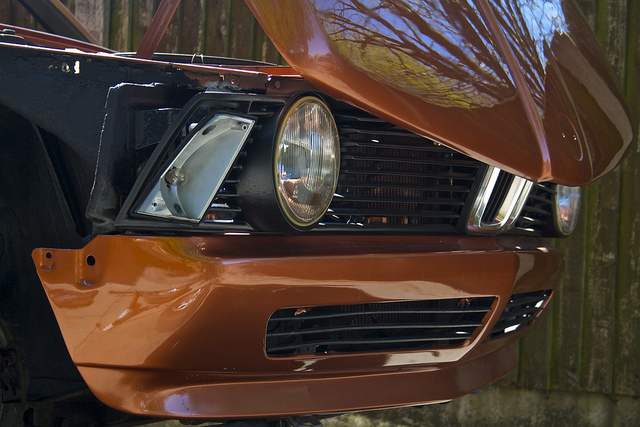

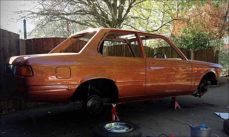

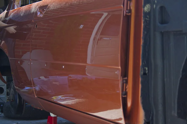

Anyway, got the wings hung and fitted much better than yesterday, the drivers one sits a little out, and the gap isn't as even as I'd like. I'll look into it another day though.
The only two pics from my iPhone:
welshname
Yeah I took the first one and thought that the fact the bonnet was open and lack of indicator ruined it. I then corrected both and it didn't look half as good so I stuck with that one lol.

Great progress. That first shot by Rhys is awesome.

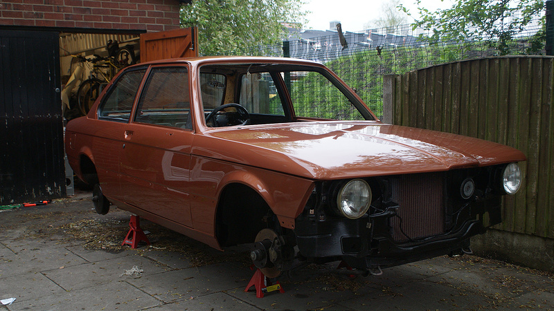

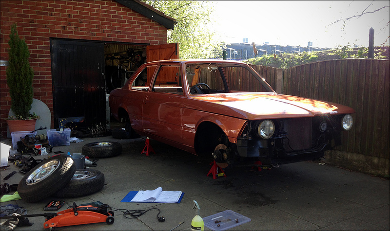

So, it's starting to look more and more like a car!

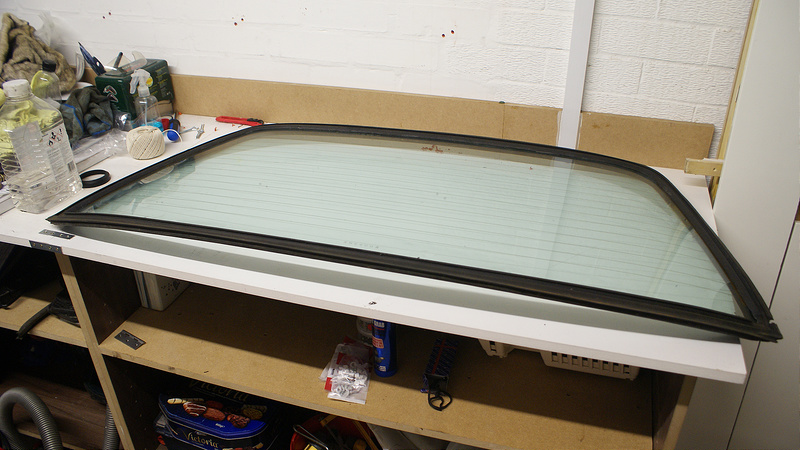

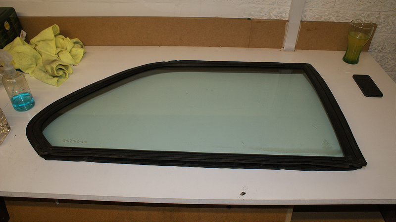

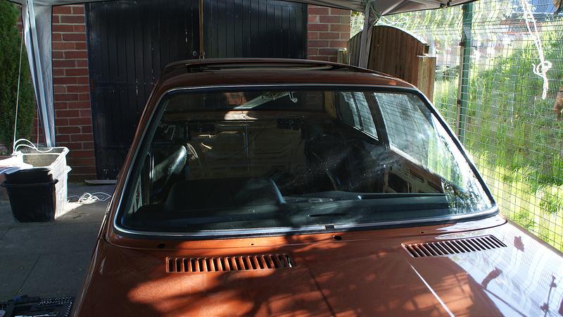

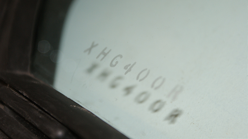

Yesterday was glass day, got all but the passenger door and the windscreen in.

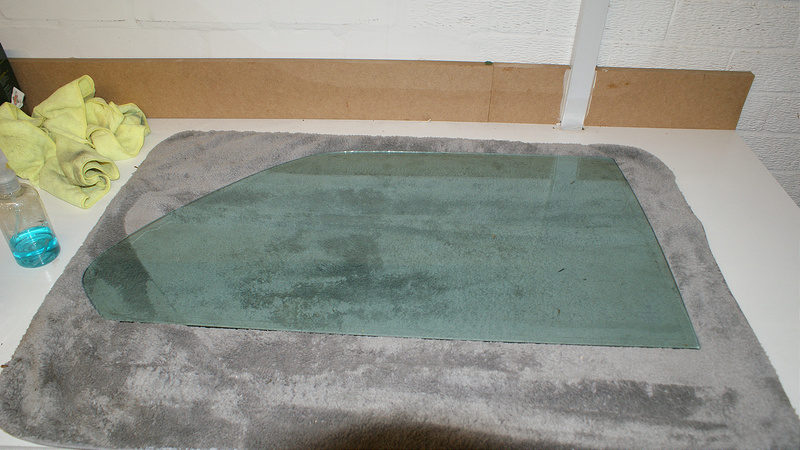

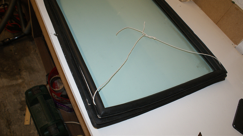

First up, clean the glass with some white spirit, eraser and Tardis:

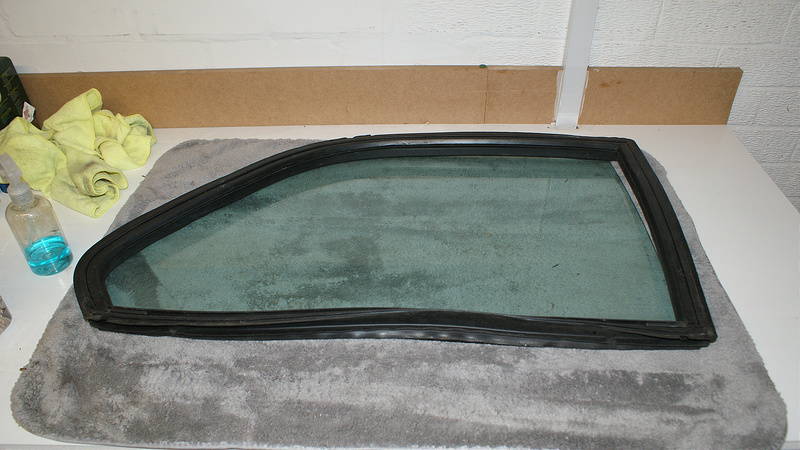

The cleaned the seal up a little bit, and offered it up:
Seal fitted:
Making sure I'm extra careful, wouldn't want to lose the original glass:
Some YouTube videos gave me a good idea of how to use the "string method" to pop the windows into the car.

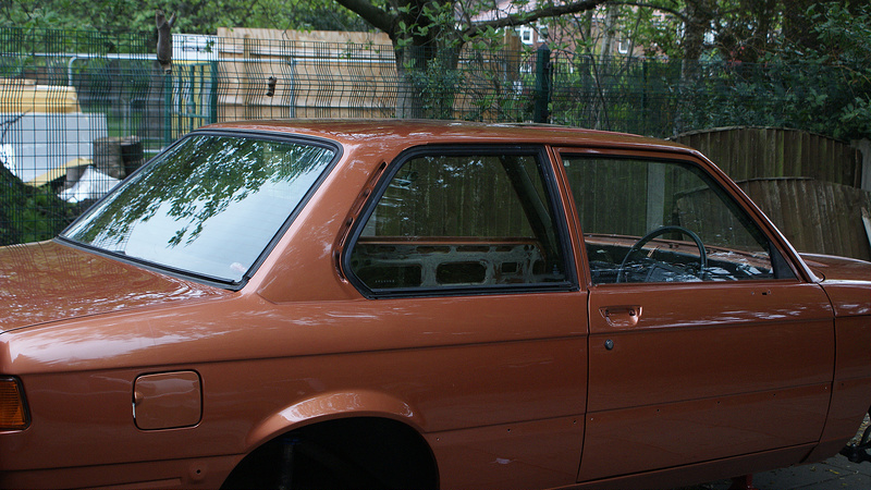

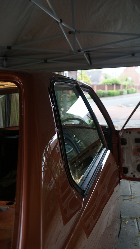

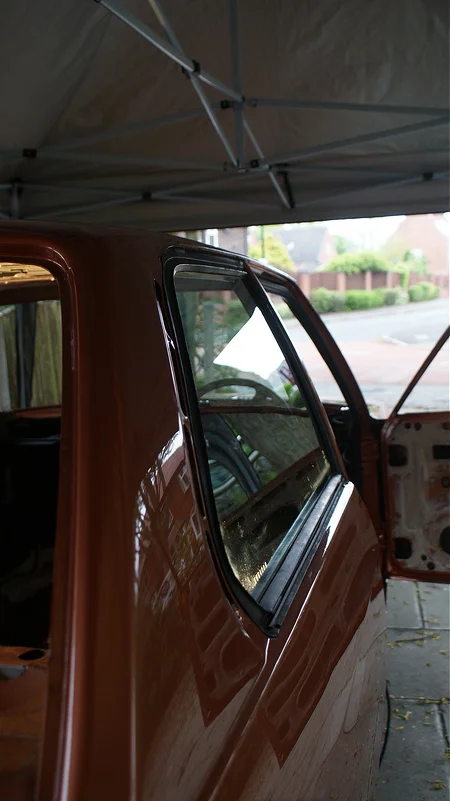

First one fitted:

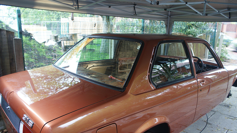

Rear screen:

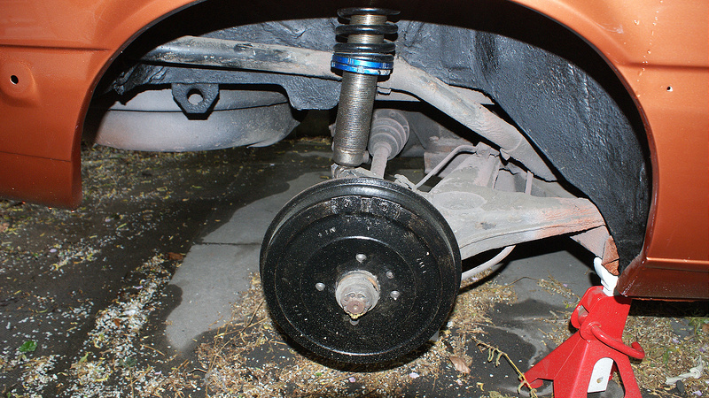

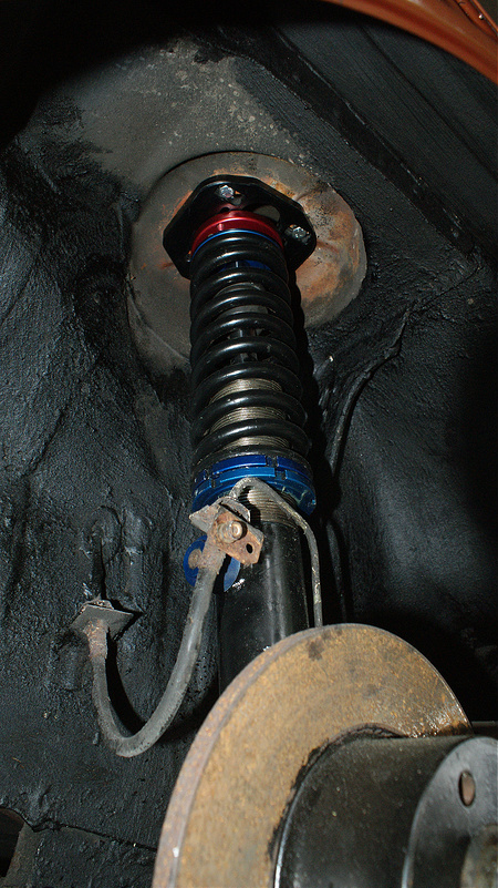

Also grabbed some photos of the painted drums:
Front discs:
And front coilovers:
Still a mountain to climb, but it's getting there :)

Did you use the proper tool to get the glass in the rubber or did you use the old screwdriver trick? I nearly stabbed myself in the eye when I was doing the ones in my old mini :eek:
String to pull the seal in, and then the little bits that didn't quite come through, used a screwdriver.
​Very nearly put it through the rear screen!
I do have a proper tool, but I couldn't work out how to use it, and impatience had settled in for the day, I wanted it done!

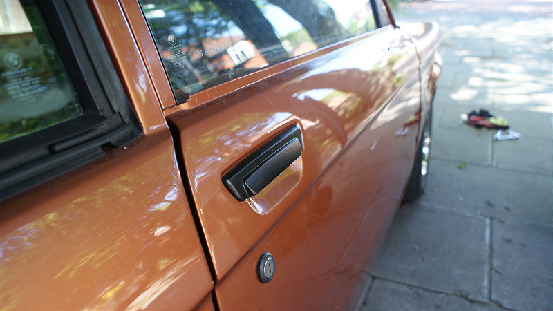

Got a few things done today.

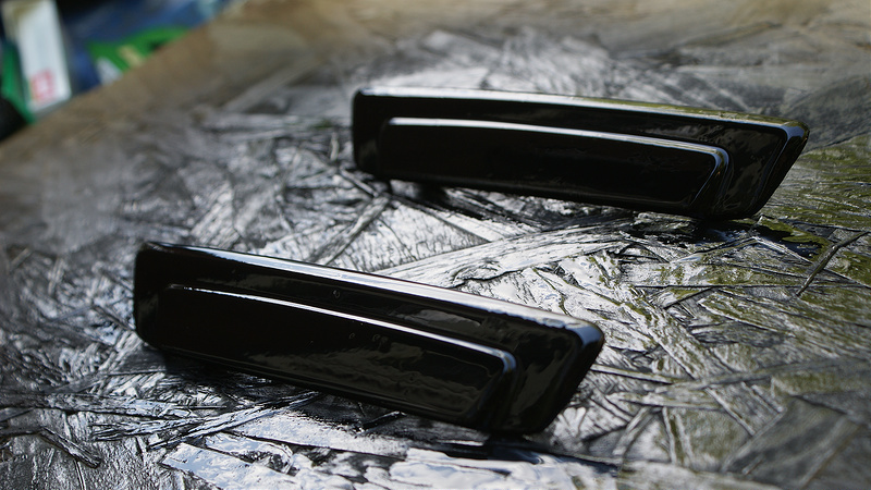

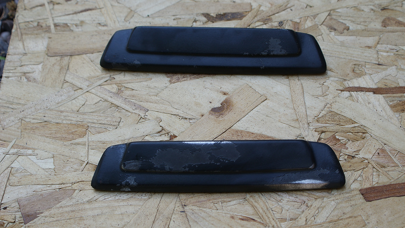

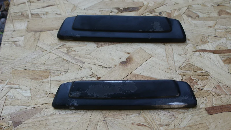

Door handles were a bit crappy, so sanded them up and gave them a quick lick of paint.
They could probably do with being powdercoated, but they'll do for now.
Dried and fitted:

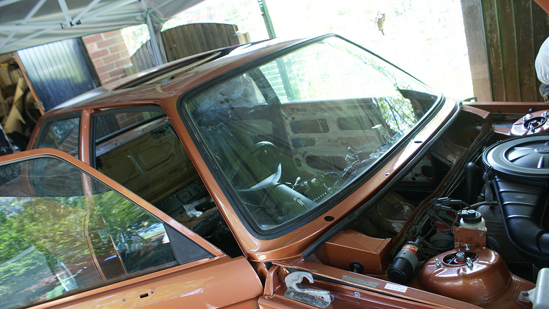

Windscreen in:
Chrome trim fitted:
aucky
  N
Satin paint on the handles! Light mist if lacquer will protect them, orC1.
