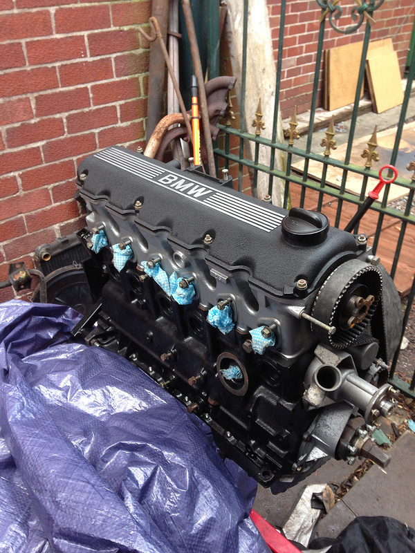

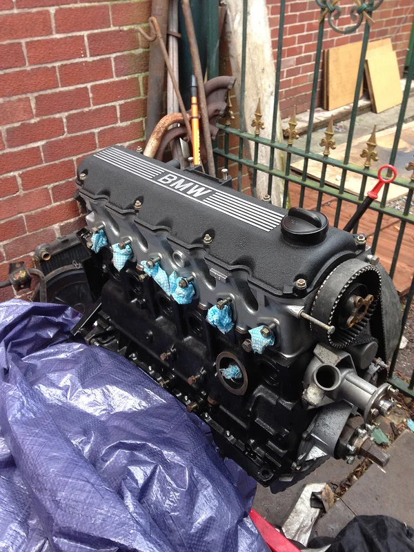

The head looks awesome in that last shot. Just putting together the time-lapse I got of today. A bit gutted there isn't as much footage as I would have liked, but I need to sort out the battery limitations.
Can't wait to see it tbh, even if we only got 2/3 of the day in, so be it. As you say, it was a chance to research what's what, so hopefully when we come to drop the engine in, you'll have a better idea of what the best settings are.

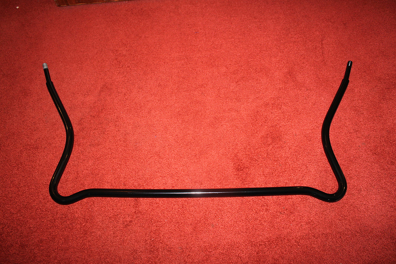

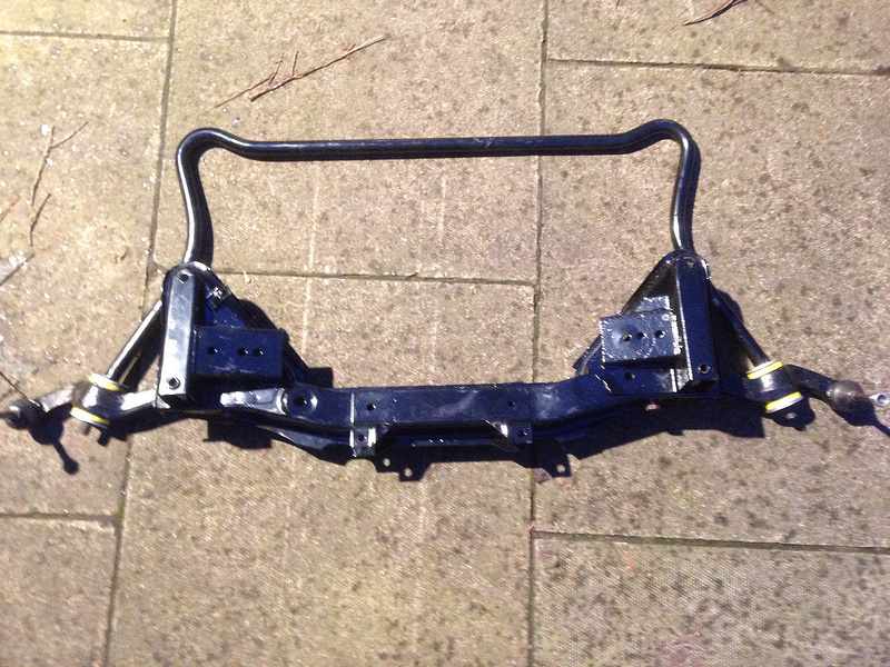

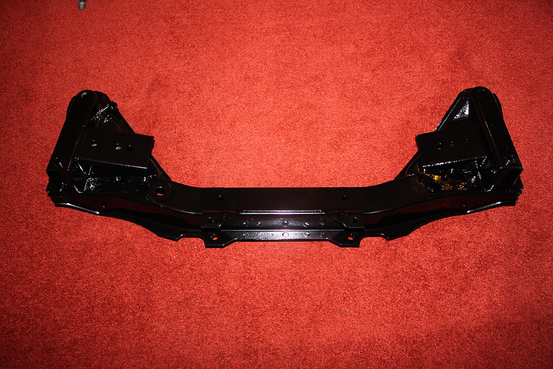

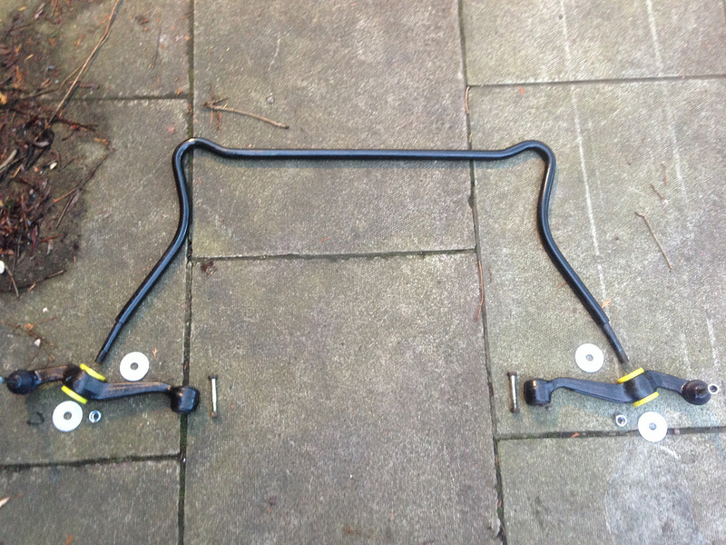

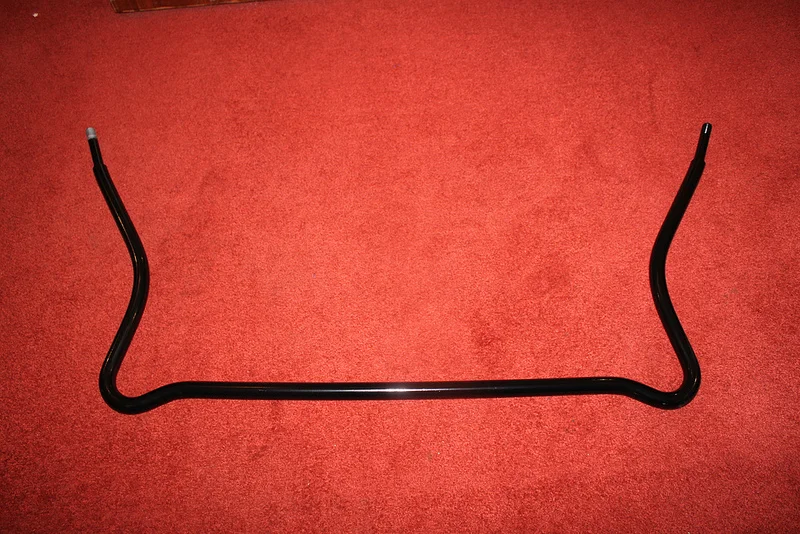

So today I picked up the subframe and ARB from the powdercoaters. Very impressed, the quality is excellent and they're well priced too.

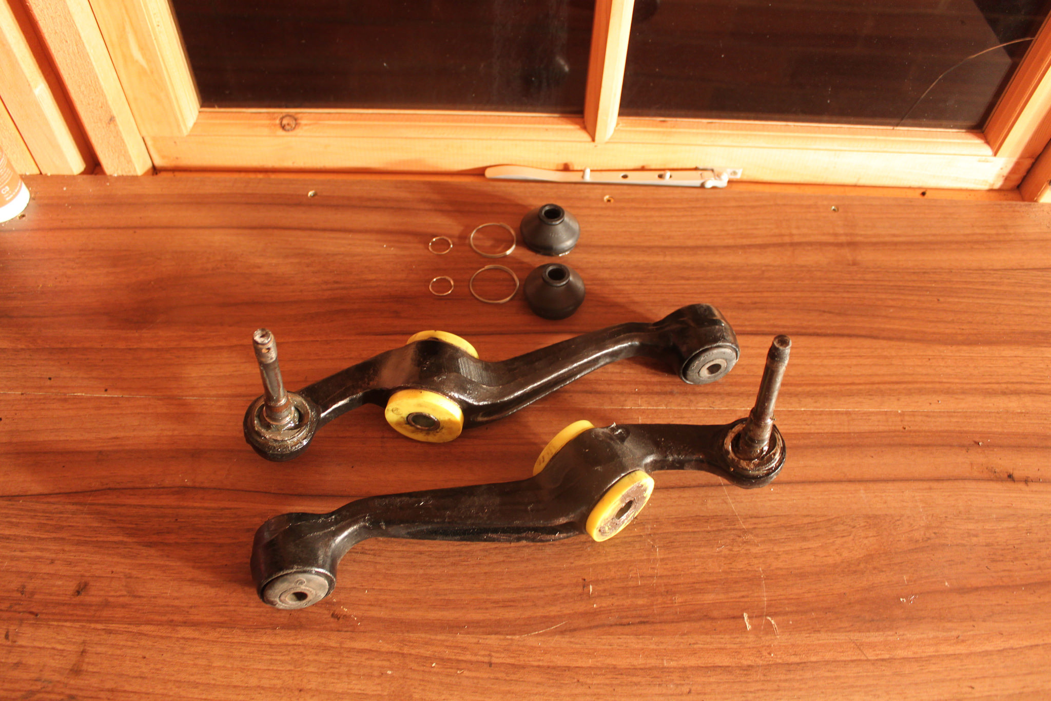

Also got some fresh ball joint boots fitted on the control arms, ready for fitting on the car.

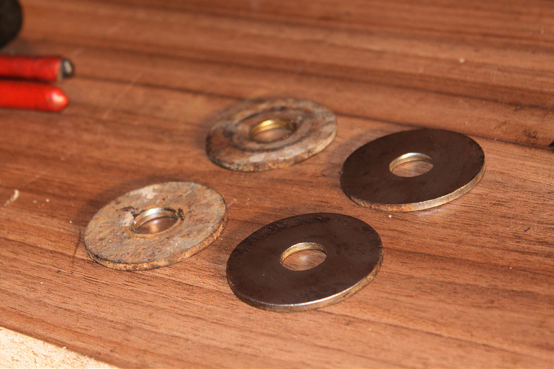

Took a wire wheel to the shims that sit either side of the control arm bushes. They were crusty as hell, but they came up really well, before and after:

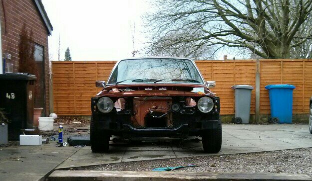

This just gets better and better, any modification required to fit the M20?
Not really no, slam panel will probably need cutting to get the engine in, and then to allow space for the radiator.
Most of it is E30 or 6cyl E21 parts, most of it all bolts on tbh.

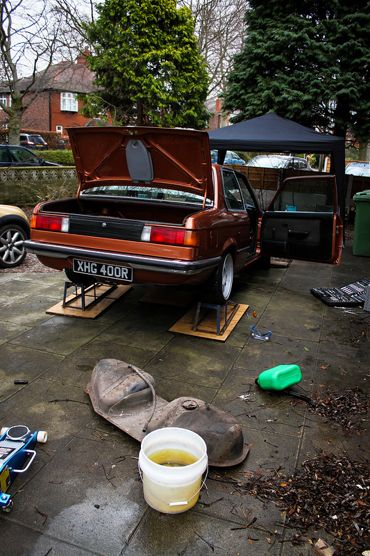

Got the fuel tanks out ready to install the new fuel return line:
Wasn't too much of a nightmare as I had expected. Drained the tanks and left them out to air any fumes out. New fuel pump is here and ready to be fitted once I've got a fuel level sender from an E30.

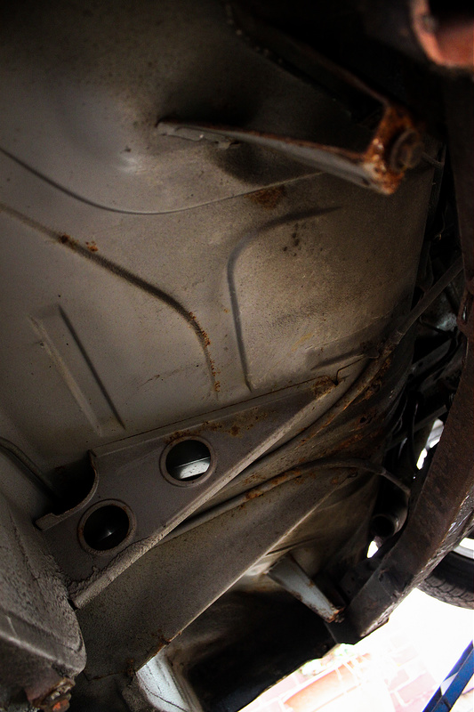

Underside of the car (the area hidden by the tanks) is in very good condition:

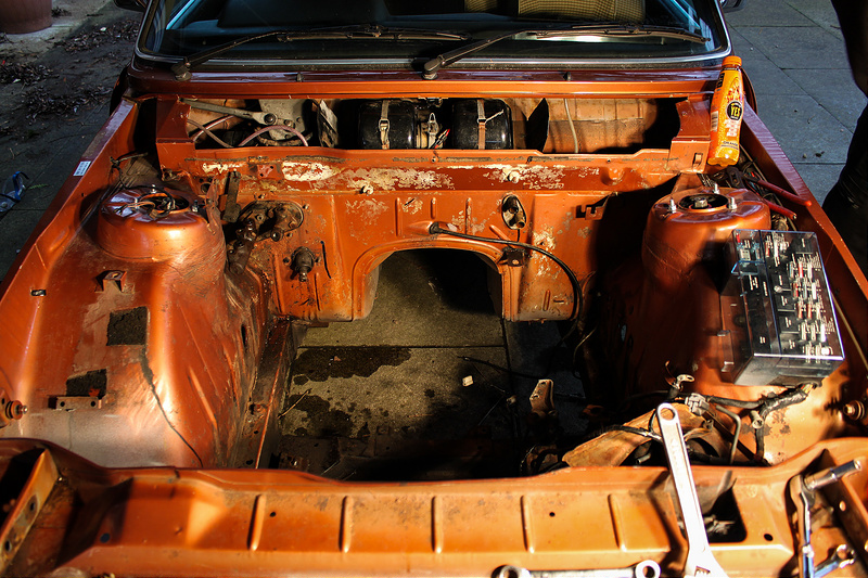

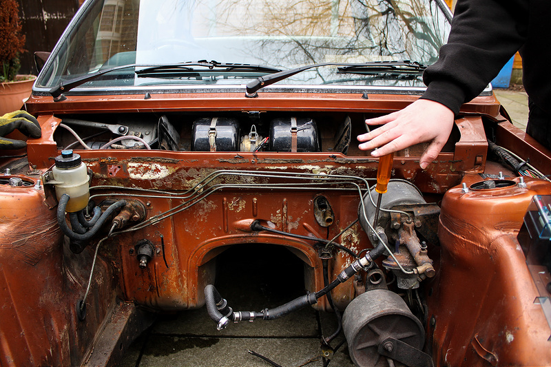

I also got the engine bay stripped, all the braking system is now out, and the steering rack is off and ready to be spruced up.
All stripped and ready for paint.

Over this week I'll assemble the new subframe and ARB, get the M20 rocker cover painted up and ready. Need to order a few bits for the M20 as well (inlet manifold gaskets and rear crank seal).

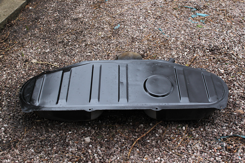

Petrol tanks painted, and then a good thick coat of underseal applied.

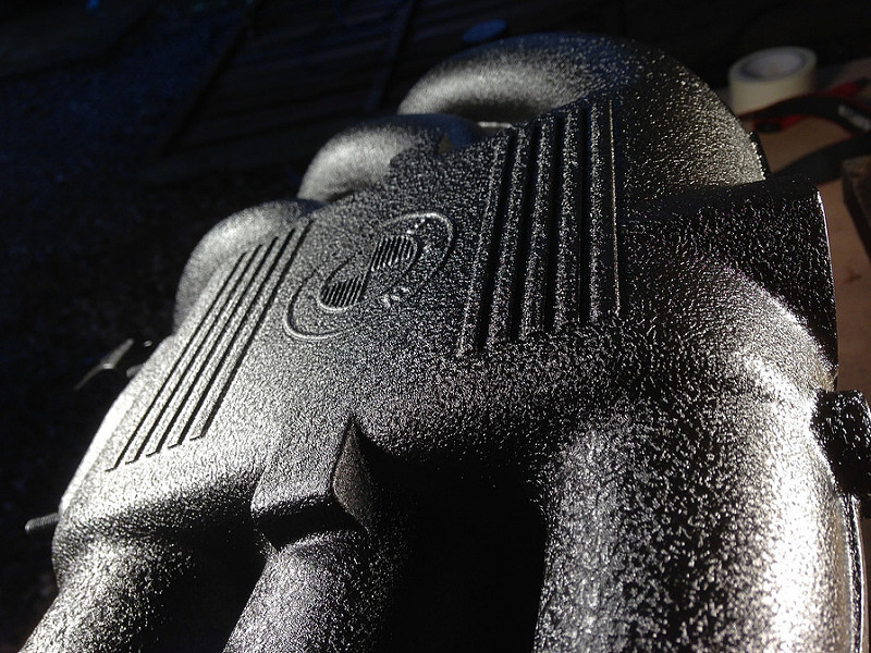

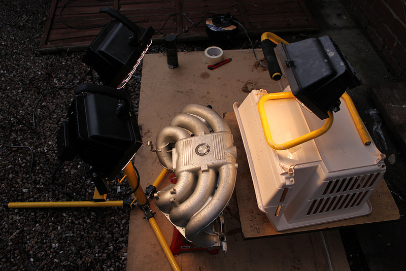

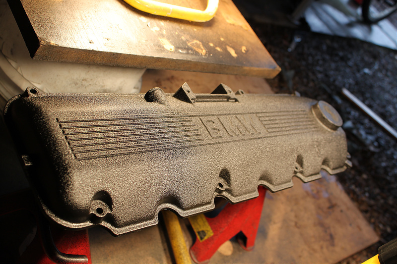

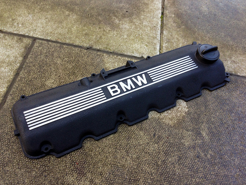

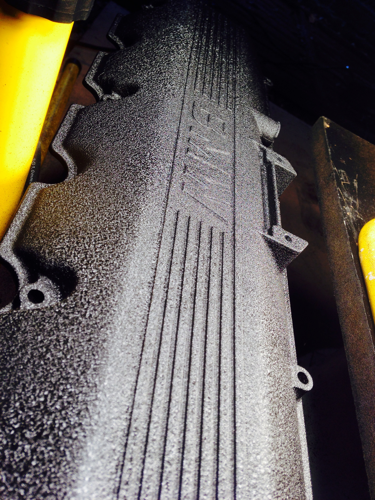

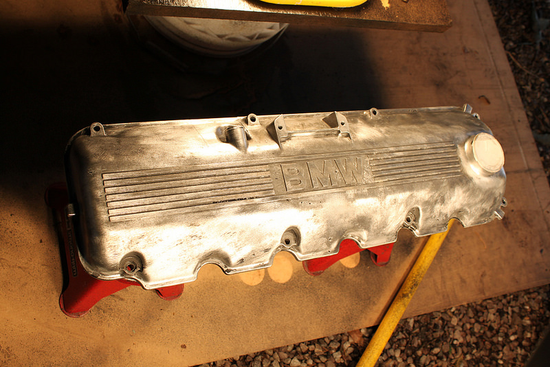

I then prepped the inlet manifold and rocker cover, under the site lamps which produce at least the required 16°c to make the paint wrinkle correctly.
Then applied the paint and let the lamps do their work. The results are fantastic and I'm very impressed. I'll sand up some of the details and it should complete the look really well.
I also got my fuel return line fitted. The engine bay is pretty much ready for paint too.

Epic work on the crackle black matey.
Looks bloody great.
Thanks, as I say, I'm mighty impressed with the results up to now. Will look great once it's all back together and in the fresh engine bay.
Love the crackle black. Still haven't seen the mag feature. You'll have to remind me when I'm next over
