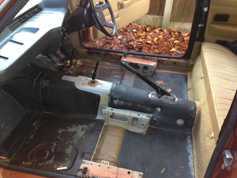

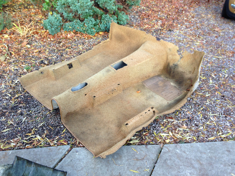

Yesterday saw me spend the entire day working on the car, the plan was to get the interior stripped out, so I could locate a leak that is causing moisture on the drivers side carpet.
I went to start the car so I could move it in front of the garage, but of course, in standard fashion, it wouldn't start.
So I pushed it over to the garage, and went about finding the problem.
Jon.G & Welshname (Rhys) came over to give me a hand with it, we started by checking the fuel lines, they seemed fine, so I tried starting it, and voila, it started. Possibly I flooded the engine with fuel with my multiple attempts, then it drained? I dunno.

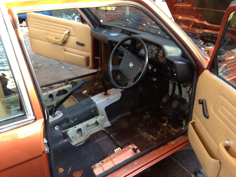

Anyway, now that the engine was fine, we started on the interior. Because BMW are epic, nearly every bolt is a 10mm, so only one socket and spanner is needed to remove almost all the interior.

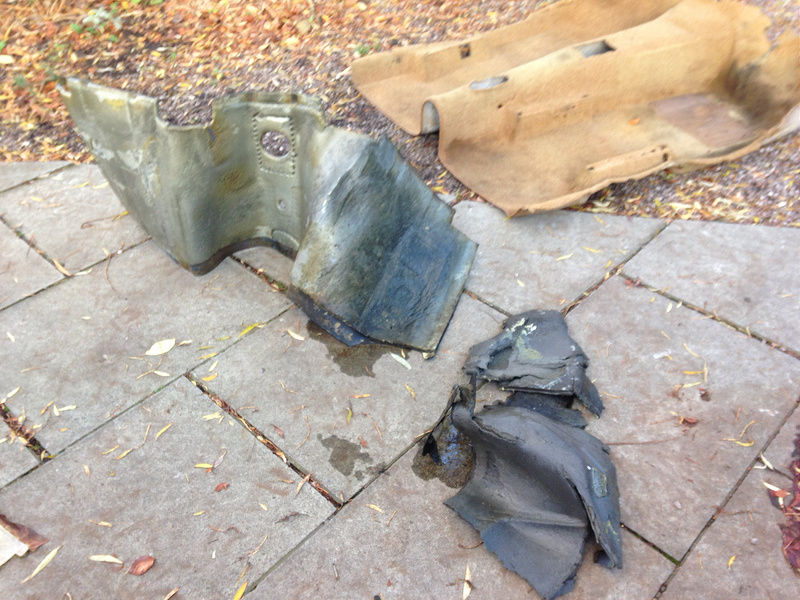

Once we had the seats and the carpet out, the extent of the leak was apparent. We took the sound deadening off which was saturated in water:
(sorry for the diabolical iPhone camera)
And you can see the water damage is contained to the drivers side:
Anyway, time was pressing on so we never found where the water is coming in from, but now the interior is out, I'm happy.
I wanted to fit my black and silver plates, but again, there was no time, so I'll have to do that in the dark this week at some point :(
Also, and more concerningly, there is a crack/hole in the passenger footwell, looks to be a weld seam that has torn and gone rotten, so that will need cutting out and welding. Not the end of the world, but still not what I wanted to find of course.
So it's got a drivers seat and a top dash, and that's pretty much it now! Should be even more of a laugh driving it now.

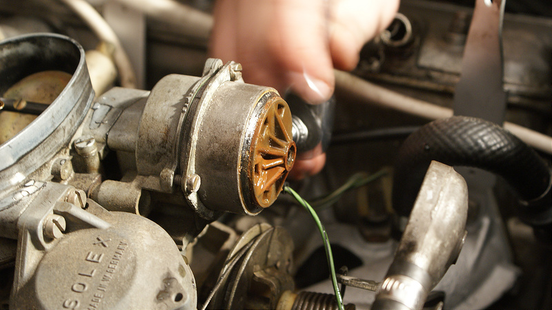

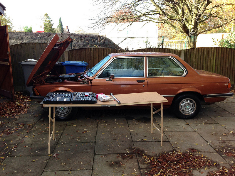

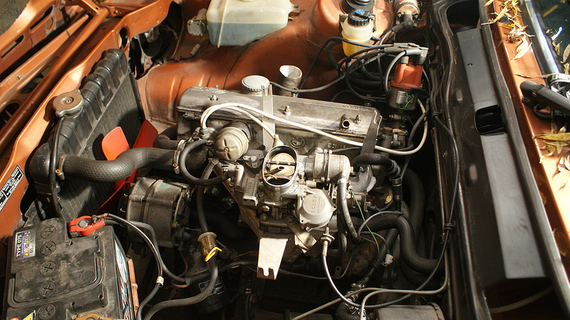

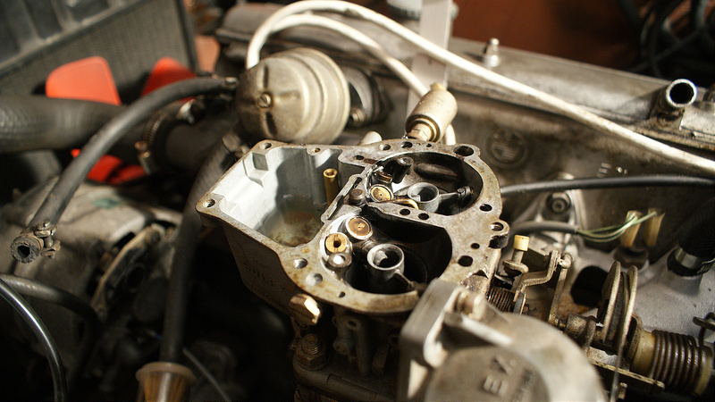

So tonight was the night we would start the car. We weren't accepting no as an answer, so we set about the usual suspects with a none starting car.
It was getting fuel, and the fuel pump was fine. The plugs were sparking, although the dizzy cap and HT leads had a lot of corrosion on the points.
Still, it wasn't starting, plenty of easy start wasn't sorting it either, so we decided to check the carb float/auto-choke.

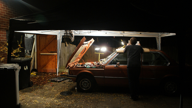

I got myself some site lights and a headtorch from Screwfix yesterday, so that working on the car through winter, isn't restricted to daylight :)
And the parts started to come off:
Carb head off:
Everything was fine in here, so whatever it was, it wasn't the carb.
After some headscratching, we decided to try and jumpstart the car, to see if the engine would actually start at all. It did.
So a faulty battery seemed to be the culprit. It passed us by because the car was turning over and it was sparking fine, so we presumed there was enough charge to start it, evidently not. We took the car out for a drive (lol) and it started up as soon as we got back to it after leaving it for a bit, so it's probably a slowly de-charging battery.

It only dawned on me when we had started putting the carb back together that it could be a weak spark due to a dying battery. Then realised that the car was cranking rather slowly.
Glad we got there in the end.
