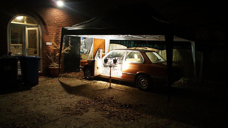

Okay, so progress was made tonight. The plan was to strip the dash and trim out of the front, and hopefully find the source of the water on the drivers side floor.
Got the awesome site lights out again.

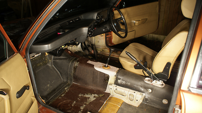

And this is how things looked before we got cracking:

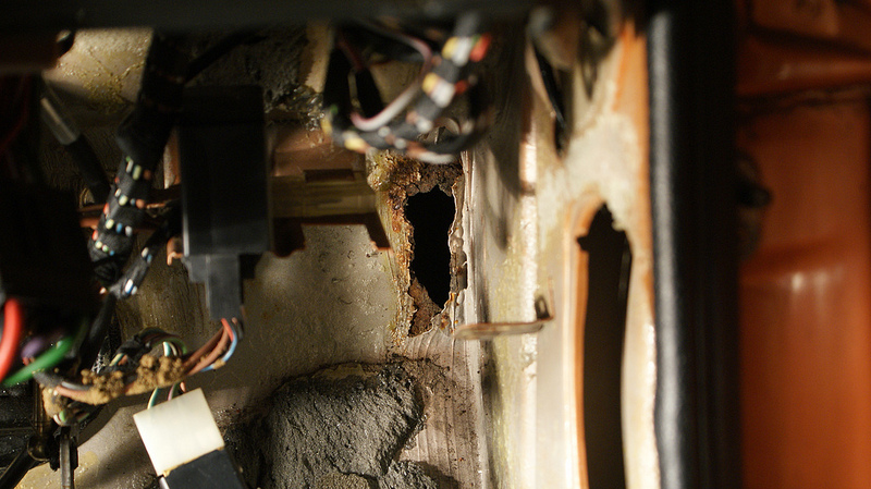

I got started before Rhys and Jon came over, and within a few mins of pulling sound deadening off, I found what is, beyond reasonable doubt, the cause of the water:
Shine a torch through the hole, and you can see the tread of the front tyre. Pretty gutted to find such extensive corrosion, but it's not too unexpected, it's a 35 year old car at the end of the day!

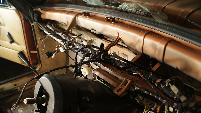

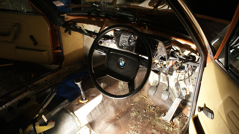

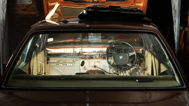

Anyway, to discard any possibility of any other leaks, we set about removing the dash, so I can check under the windscreen for corrosion.

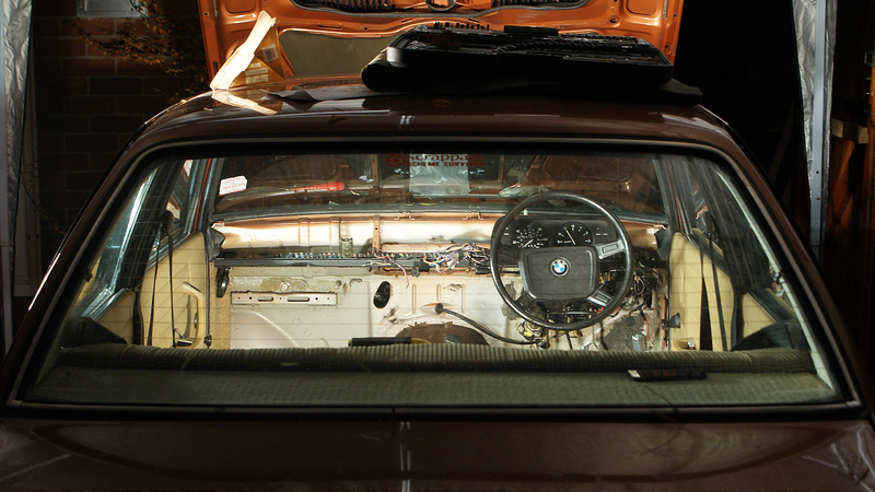

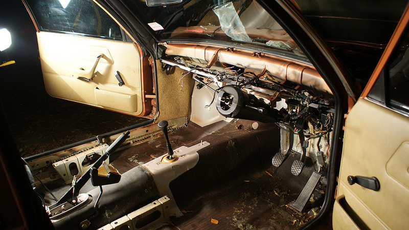

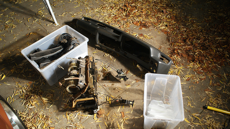

A few hours later, and it's out:
That's the loom! LOL Super simple:
We removed a fair but as well!
Got it pretty much driveable though

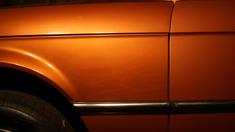

Also while I was packing everything away I noticed some strange marks in the paint on the front wing, only visible under the 400W lights. Don't know what's caused that, but it's very odd?
