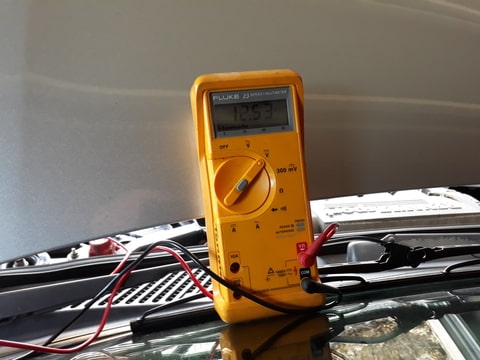

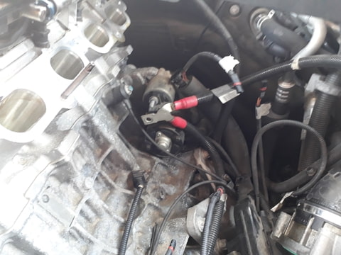

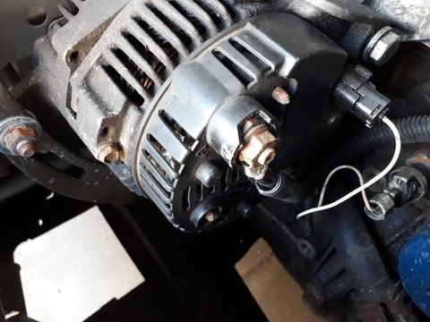

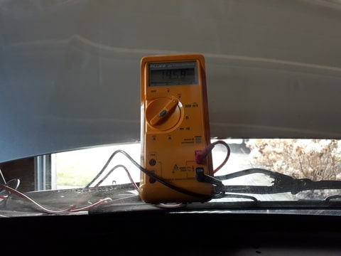

I also had an issue. While waiting in pit lane for the last session, the STOP and battery light came on shortly. I saw it, and forgot about it shortly after. The day after, with unloading, and putting the car in the garage, the lights came on again, and stayed on.
After some searching on here, I found out that is was probably the alternator not charging fully, or the battery itself.
I borrowed my dads multimeter, and measured 12,2 Volts with the engine off on the battery. When I turned the car on, it had 11,8 Volts, both stationary and while revving.
I figured that the alternator wasn't charging the way it should be, and I had an idea why. In post #96 you can see that I wasn't able to get the nut on fully on the thread. I took it off, took the plastic cap of, and saw that the spacer fit's right into the plastic cap.Obviously it wasn't mounted the rigth way. The parts were all a bit corroded, so I cleaned them, and put them back in how they should be this time. Now I have the nut on fully, and I have 14,6 Volts with the running engine.
It's a simple fix and it was a small problem, but I'm quite happy that I figured it out and solved it, since I'm not really good with electrics. :tongueclosed:

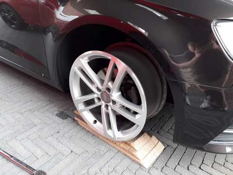

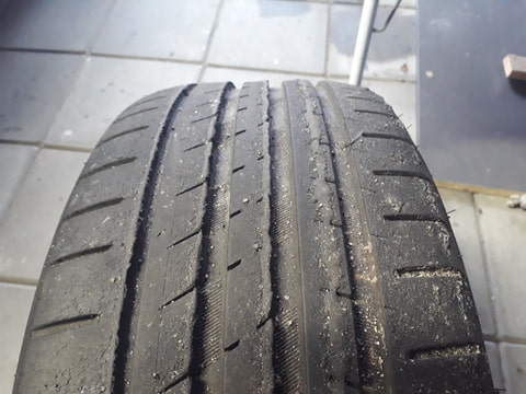

I changed the wheels diagonally to improve even tyre wear. Every time I take these wheels of, I can't believe how light they are. :cool:
Here's how they came of, a lot of pick-up, just like Formula 1. 🙈
This is the degradation:
Front left
Right rear
Front right
Left rear
I still don't understand why the rears show more degradation than the fronts. Is it because the back is very light, and it wants to oversteer? I feel more understeer than oversteer, so it doesn't add up. Should I play with my tyre pressures to even this out? I drove with 2.1 bars (31 psi) when hot all round. Any advise on this is more than welcome. :up:

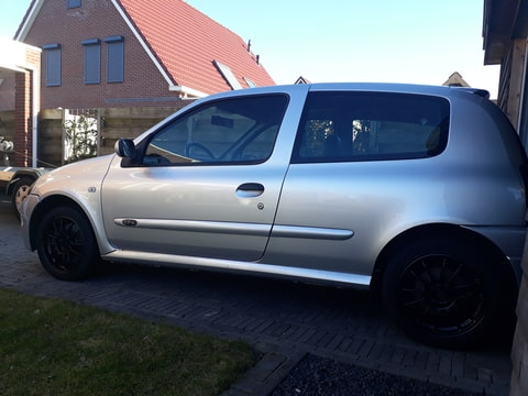

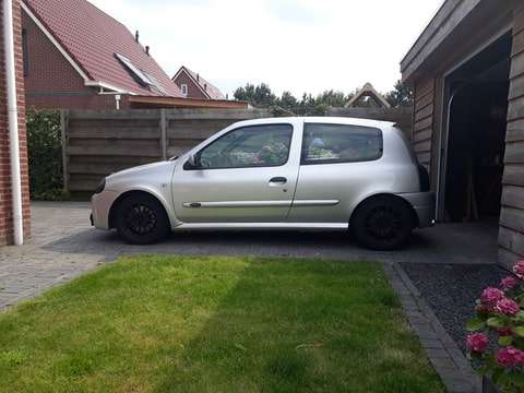

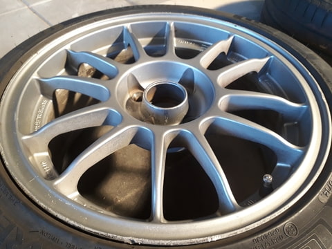

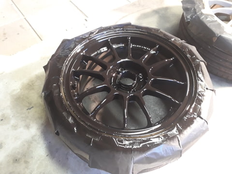

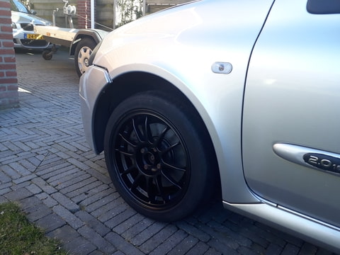

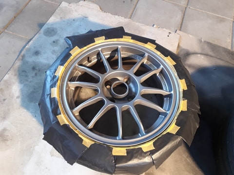

To continue with the Silver/Black theme I've got on my car, I decided it was time to paint the wheels.
I'm also thinking of adding a bit of RAL 3000 on the bumpers, sideskirts and mirrors. Any opinions about this?
Here's what I started with. Paint looking quite tatty on several places. As it's a track car, I didn't bother about the marks on the wheels.
Masking up.
During painting.
And the finished result.

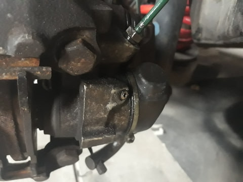

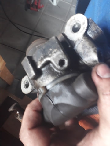

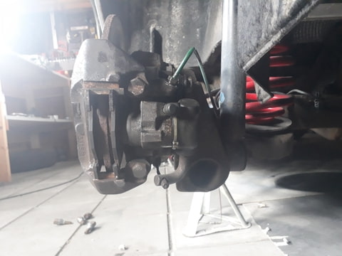

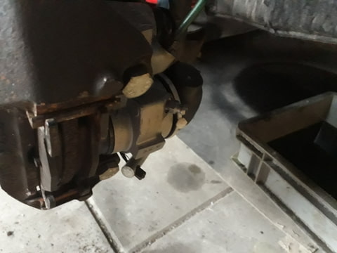

I got a new (well used) rear caliper for my car, and changed it, as the old one had a snapped of bleed nipple.
Now just waiting for my brake fluid to arrive, refresh that, and the car will be ready for it's next outing. :cool:

Black wheels look good! Adding a bit more colour is definetly needed but not too sure on the red. It's kinda in your face.

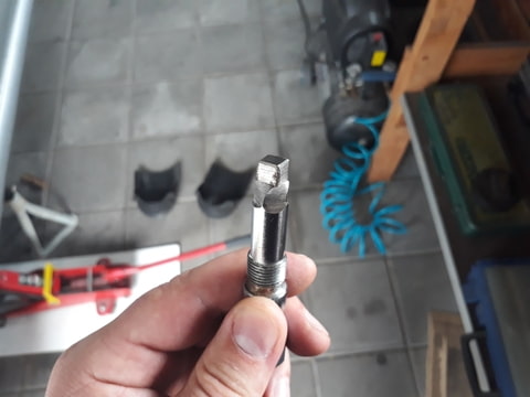

I tried everything to get the snapped of bleed niple out. I heated and cooled it a couple of times, used a left rotating tap (don't know if it's correct english, or just translated dutch :tongueout:), welded bolts on, but the remaining piece did not move one bit.
So I had to bite the bullet, and ordered a new one.
Should have done that the first time, buying cheap isn't always the best.
Got it mounted, and got all the brake lines bleeded again, so the car is ready for next thursday. :cool:

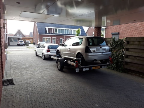

I had a test in Delfzijl in the morning, so my father offered very kindly to bring the Clio to Assen and meet up there.

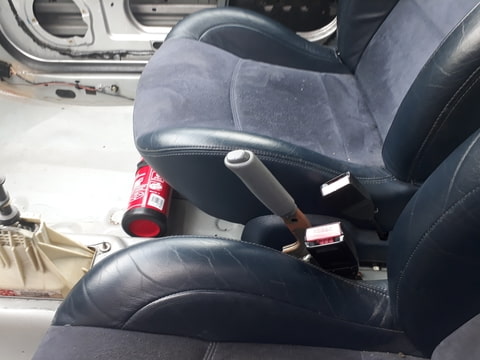

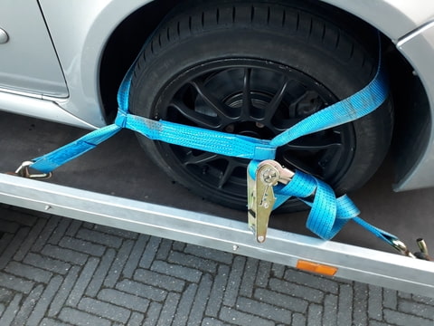

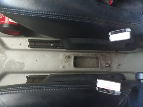

I put the car on the trailer the day befor the trackday, and tensioned the handbrake. The lever went up really far. :kissingsmiling:

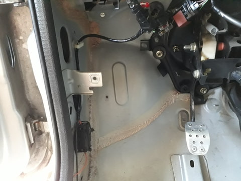

Had a look under the car, and quickly found out the handbrake cable on the left rear had snapped. I already noticed it was bad during the caliper replacement, but on the first tension it decided it had been enough.
I think I can live without a handbrake, so it will all be coming off soon.

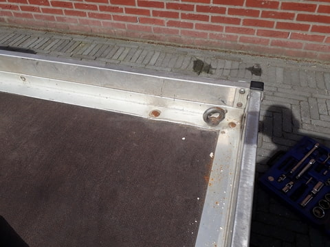

Another thing I want to improve is move the first eye on the trailer more forward, as I don't have enough room to tension the front straps properly.

  • Remove handbrake assembly

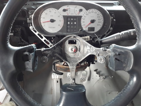

For all those who are wondering how much aluminum there is behind the pur of the steering wheel, here you go. :smile:
Wasn't really worth it, only saved 254 grams, making total weight savings 199,7 kg's.
But I also wanted to see if I could use the steering wheel to make an adapter plate for my deepdish wheel with quick release, which isn't an option ofcourse, as I deep down already knew.
That's a bit stupid. I'm all up for saving grams, hell have you seen the inside of my car.. But to remove the handbrake us just unbelievable.
What happens if your brakes fail?
Well, I've thought about this, and here's how I see it.
When you approach a corner at high speed, and you brake as late as possible, and you discover at this point you have no brakes, you are always going to be to late. Your mind needs time to figure out what's happening. In the meantime, you need to try and get through the corner at a far to high speed. By the time you have figured out you have no brakes, it will be too late.
And have you ever tried your handbrake at say 150 km/h? I'd say you can only use your handbrake as an emergency brake under 50 km/h.
What about them skids mate. You need to Tokyo Drift in the snow...
I'd put the handbrake back in as well. Even with jacking the car up it comes in handy.
You know I should, but then I would also be single. ?

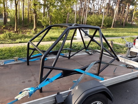

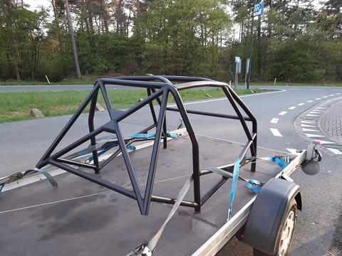

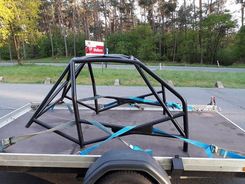

It came out of a donor vehicle, and as you can see, it will not fit inside the little Clio as it is.
Plan is to convert it into a bolt-in cage.

Although, there's not much going on at the moment. I plan to install the cage over winter.
I did get to weigh it, and it's far to heavy for my liking, weighing in at 70 kg's.
I guess my lightweight scheme is out the window, but that must be the price of a bit of safety. And at the end of the day, it's just for trackdays.

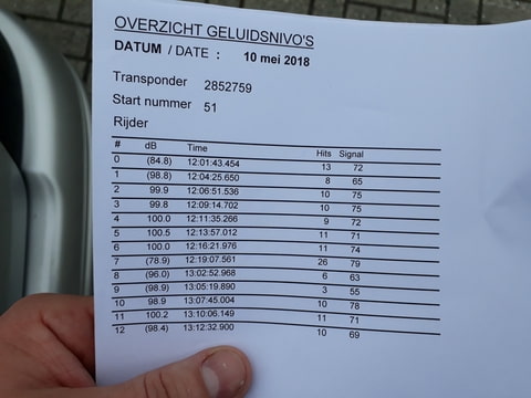

Second session was a short one for me, as I got black flagged for having to much noise as can be seen in the video below. In the end you hear me saying a dutch swear word, and instantly thinking that is must be because of the noise.
I got sent to the control room, where my noise levels were showed. 98 db's was allowed, and I was clearly over.
I was allowed to continue, as long as I went of the throttle at the measuring point. And so I did.

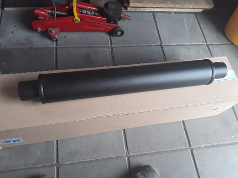

To adress this issue, I will be installing an extra silencer. I already had this in consideration since the cat delete, but I first wanted to see if I could get away with it. Now that I know I can't, it needs to be adressed.

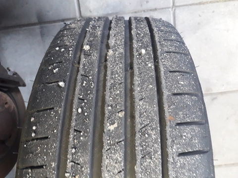

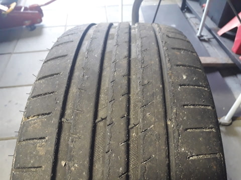

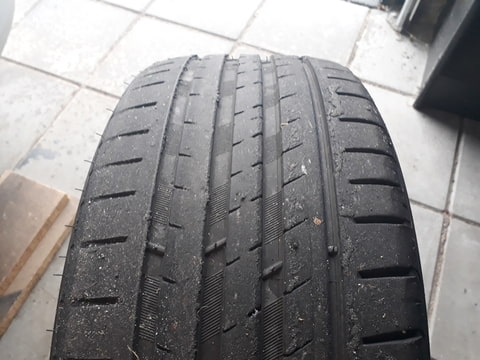

About that, here's the state of the front left.
I guess this tyre is finished right?

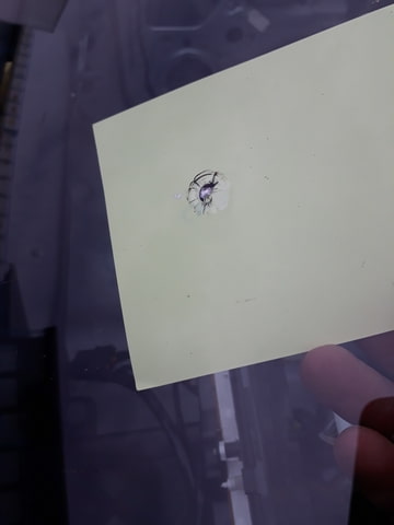

My windscreen also got a nice memorial of this day. I'll see how it holds up, if it start to crack, I will replace it. If I can find a cheap replacement, I will probably change it in combination with the cage install, because of easy acces to the interior.

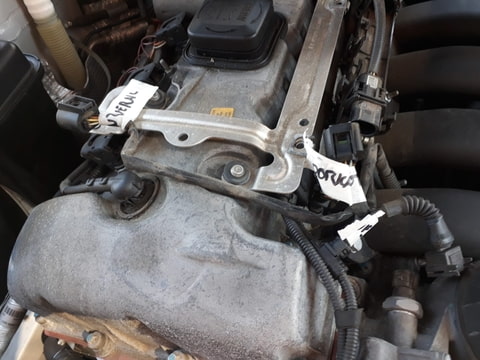

I had some spare time, and it was a nice day to do some work on the car again.

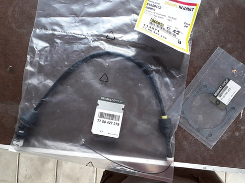

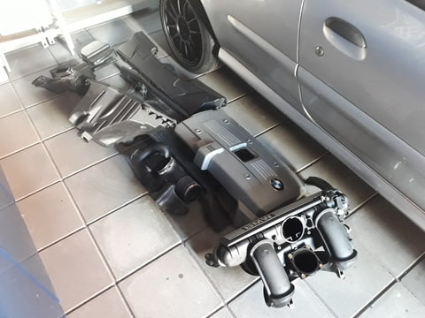

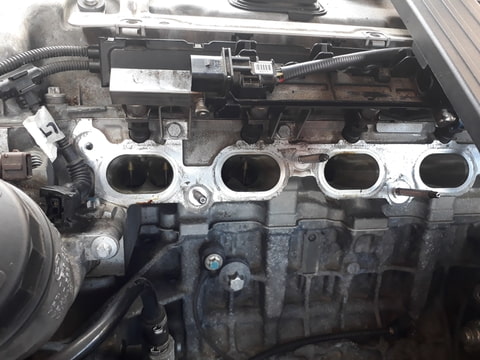

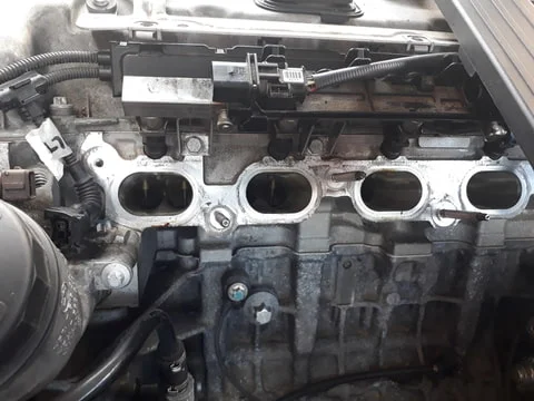

I ordered a new throttle cable at the dealer, and a new throttle body gasket as well. I'm hoping this will solve the issue with the throttle sometimes sticking at higher revs than stationary. It's only an issue on the paddock, not on track, so it's a minor issue, but than again, the throttle cable wasn't expensive.
I was planning on removing the throttle body, to dissassemble it and clean it, but it seems there is a liquid seal behind it, and it wouldn't come off easy, so I decided to try only the cable at first.
@hostler commented that these might cause some serious injury incase of a crash, and I couldn't disagree, so they had to go. From this:
To this:
I saved 80 grams in doing so, so win win. ?

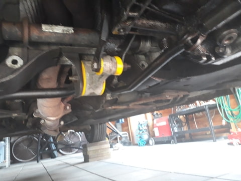

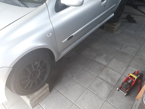

Then it was time to raise the car.

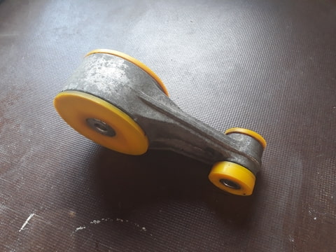

I also installed a powerflex dogbone.
If anyone is interested in the original one, please let me know.

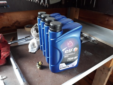

I received another bottle of brake fluid. Went for the bigger one this time, as I flush the brake fluid a bit after each trackday, and the 5 litre can was very cheap at 53 Euro's including postage.

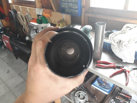

Got another package to solve the noise issue.

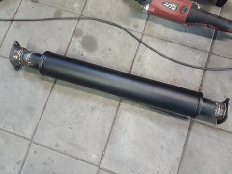

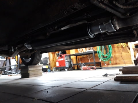

This is the reason, the car needed to be raised, as I want to do the exhaust again, with the wheels in their normal position, so that I can be sure I have enough clearance at the rear axle.

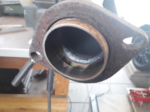

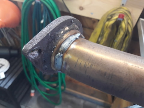

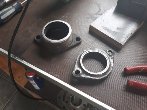

I took of the link pipe I made a while ago, as I needed the flanges again. I weighed it this time, and it weighed in at 1,384 kg's. I estimated it at 2 kg's, so that's a gain of 0,616 kg's. Weight of the silencer is 3,726 kg's. Total weight saving so far, 200,4 kg's. This does not include the silencer, as it will be modified.
Next up is removing the midpipe/rear silencer, and modifying that, so I can get the mid-silencer in between. Should be fun, as it's corroded to one piece. ?

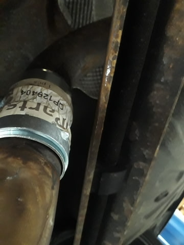

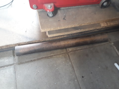

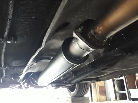

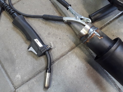

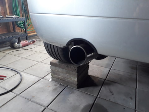

I continued with the exhaust today. I was hoping that I could get the mid-pipe and rear silencer out in one piece. That was not an option. I had to get the clamp off, in order to separate the two. My air hammer made easy work of that, and in the meanwhile, my car kept getting lighter. ?
So I needed a new clamp, and the local carparts shop had one luckily.

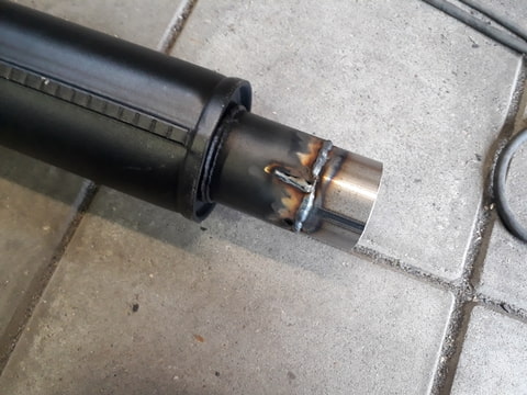

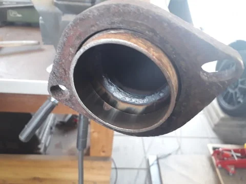

When I had the new clamp, and I had the rear silencer in the correct position, I could measure how much I needed to cut of the mid-pipe in order to get the silencer in between.
After that, I welded the flange back on.
Now I was able to get the silencer to fit in between the 182 manifold, and the shortened mid-pipe.

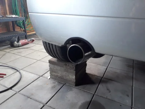

And the finished product.

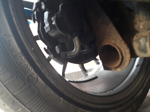

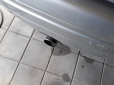

The tail pipe is in a neat position.
Got decent clearance around the rear axle.
And I paid attention in to getting the exhaust higher than before, as I hit the trailer with the exhaust when I didn't lift it up enough with the nose wheel.
As a result, it is much quieter than before. Now I hopefully don't get into anymore trouble with the noise.

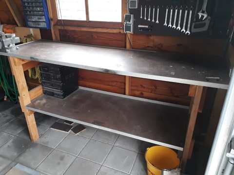

After all the work on the car, it was time to clean up the workbench first.

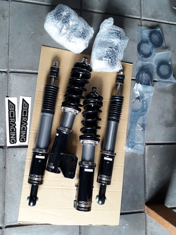

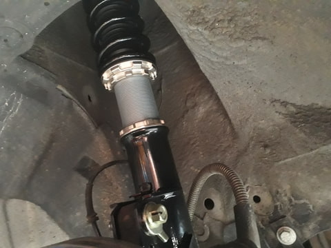

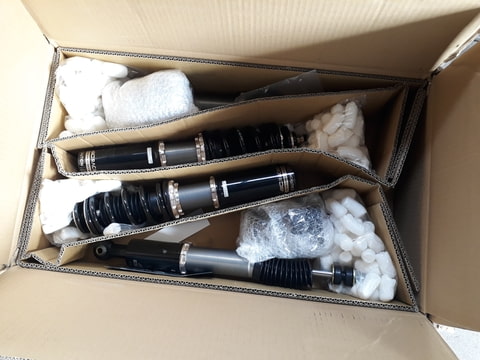

And then a nice package arrived from the UK.

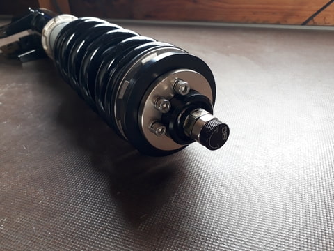

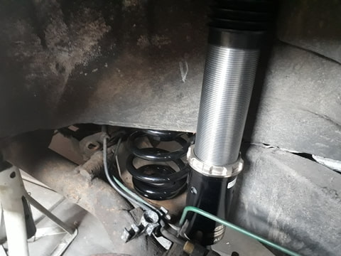

BC Racing DS Coilover supsension, with the 10/8 kg springs, and the adjustable topmounts.
Cornering will be a whole different experience from now on. ?

I called the assistance, and eventually we got towed to a BMW dealer which was only 2 km's away. They found out that the starter had died, and we could jump start the car. The decision was made to go home, and see from there.

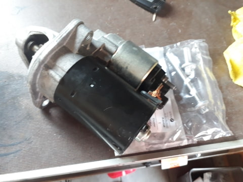

I ordered a second hand starter, and started dismanteling.

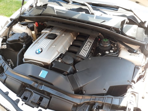

Here's how the engine bay normally looks.

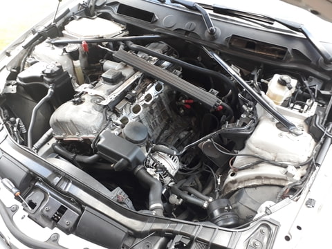

And how much needed to be dismantled to get to the starter motor.
The starter is all the way in the back of the engine bay, beneath the fire wall.
The new starter, with new bolts, as they are one time use only.
Here's everything that came off.

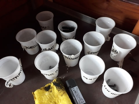

And to remember and make sure I used every bolt that came off again, I labeled every plug, and ordered all the bolts.

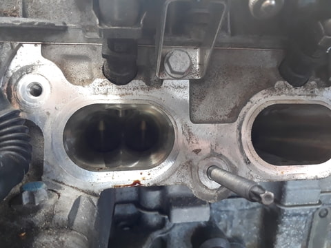

The cilinder heads look very nice for as far as I can tell.
After replacing the starter, and mounting everything back up, the car started again, so problem solved. It only cost me 70 Euro's. Quite a big difference compared to when I would have it fixed at the Austrian BMW dealer I suppose, as it was quite labor intensive.

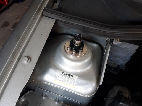

Today I had some time to fit the BC Racing coilovers.
Don't mind the Camber bolt washer, it's still loose here, and I need to look at it anyway. The ABS wire mount also still needs to be transferred.
I've set it to maximum caster, and want to adjust the camber with the camber bolts. If anyone has an opinion about this, that's more than welcome. ?
And the height before.

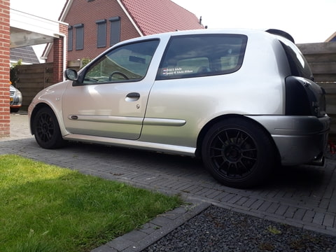

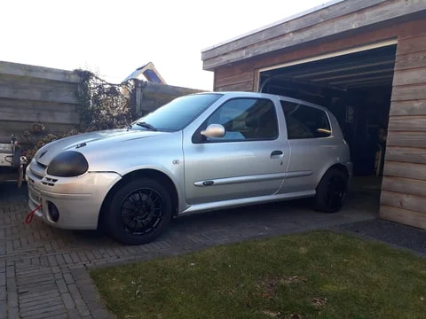

And bye bye monster truck Clio. ✋?
Still a bit high for my liking. I need to lower the front a bit, for now I've mounted them as they arrived. The rears are at their lowest setting.
Offcourse I have weighed the original suspension, and the BC Racing. Turned out, the front axles have lost 3,8 kg's, and the rear 1,2 kg's, so a total loss of 5 kg's. ? Which brings total weight saving to 203,1 kg's.

I refreshed the brake fluid.
I refreshed the gearbox oil.
The gearbox drain bolt was very tight, so tight, that I twisted my home made drain bolt remover. A few taps to the bolt with a hammer, solved the issue, and I could undo the bolt easily afterI had remade my tool.
I retightened the sump bolts, as I still have a bit of an oil leak. I put the car on axle stands, cleaned the underside with brake cleaner, and luyed under the running engine, until I saw some druplets forming. Looks like it is coming from the cambelt side. I lowered the subframe, and retorqued every bolt according to the tightening sequence, and did the final sequence to 17 Nm, hoping that this would solve the issue. As there is already a druplet under the sump, it did not help. My guess is, that is must be coming from the crankshaft seal behind the cambelt.

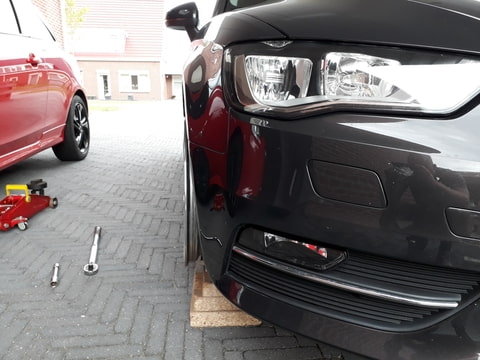

Our new car is this:
A 2015 Audi A3 with 42000 km's. It has the 1.4 TFSI 150 hp COD engine, which it strong enough for daily driving and to act as a tow car. The colour is Beluga brown, and if I'm not mistaking, it can only be found on the Audi A3. It has different shades, black, grey and brown/blue, with a gold sparkle in the sun.
I was looking for one with a nice looking interior, and I'm quite happy with this.

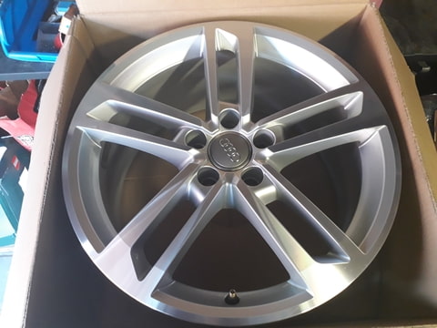

The only thing I plan on doing to it, is to fit some nicer looking wheels.

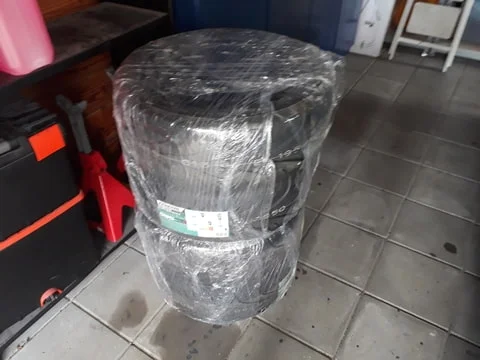

I received a nice package today.
A new set of Federal 595 Rsr's, but bought second hand, so I got them for a decent price
Quite happy with these, as I've been driving on normal street tyres all this time, and I feel that the coilovers and these tyres should complement each other.
