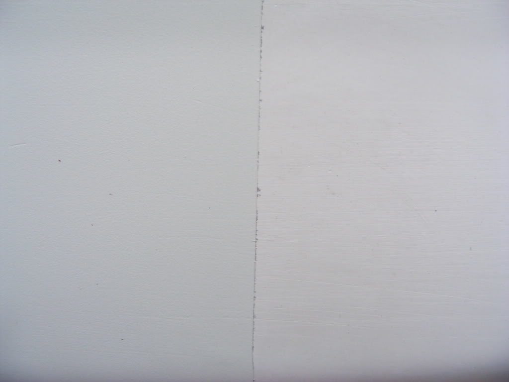

Had a go at spraying the rust on the tailgate today but turned out blueish grey?? Think its because i used grey primer, not good underneath white paint.
Now looks like this
Annoying :? Need some white primer

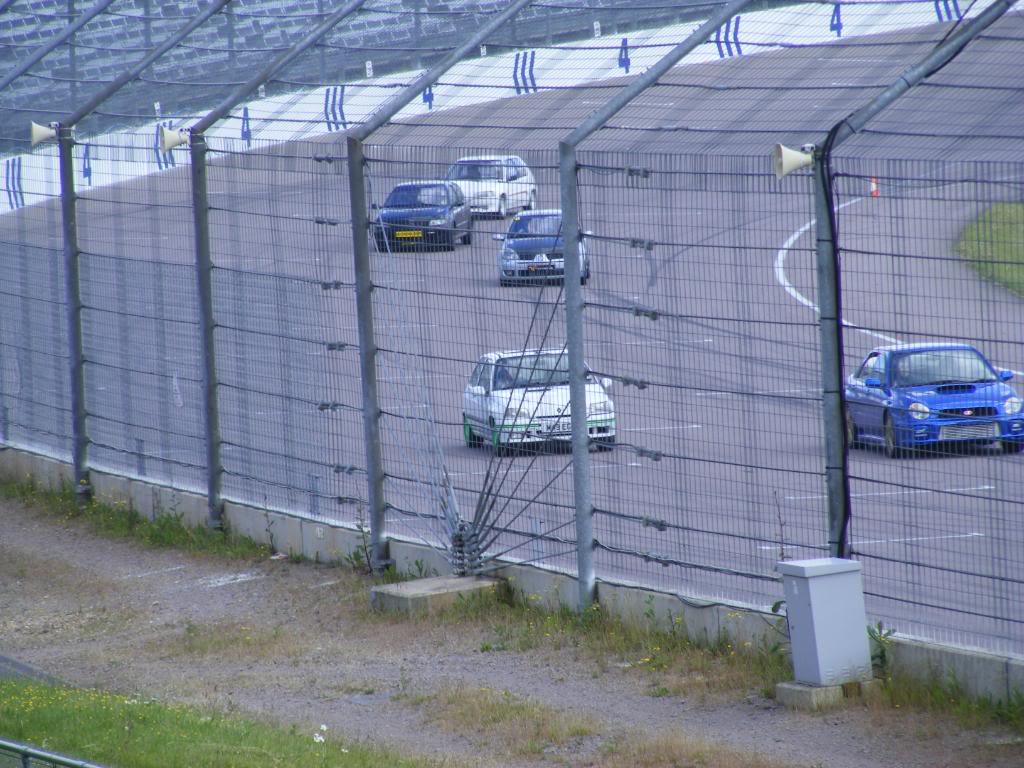

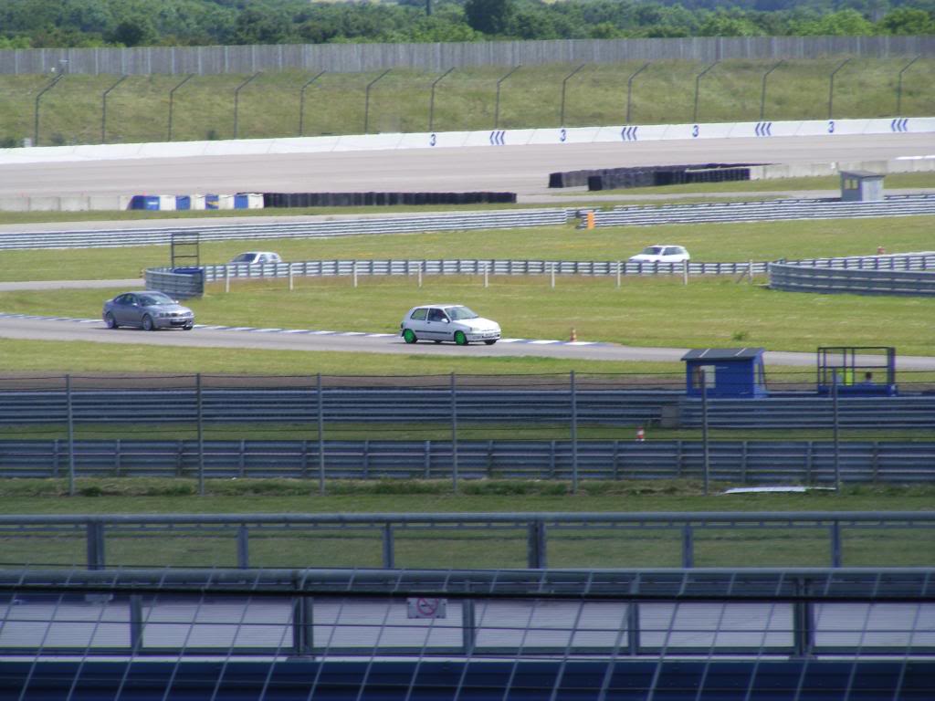

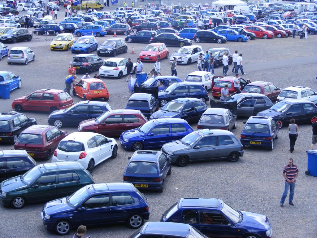

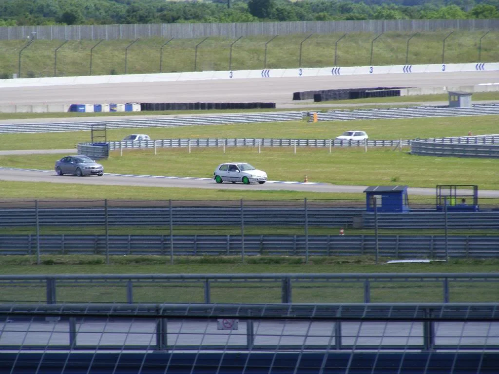

Managed to scrape my car together in time for FCS and had a fuckin amazing time. Had 30 minutes on the track, luckily wasnt on my own as i was out with ronee (clio-girl) who tried in vain to make me feel less nervous :) was fine when i got out onto the track though, not sure my clutch would have lasted without heel toe after the home straight/big sweeping bend as i was braking pretty late (or it felt late to me) and changed down at the same time. Did experience some brake fade coming up to the first hairpin after hanging it in 4th round the big bend and mark (clio-wizard) said this was probably down to the brake lines getting too hot from the manifold so i will have to do something about that as that shat me right up. Also managed to understeer MASSIVELY on a few corners, car just felt like it had wooden tyres on; need better ones. I was very pleased with my car, so glad i did the preparation i did as i definitely dont think it would have stayed as cool as it did and i dont think the brakes would have taken as much abuse.
Almost managed an off, i either slipped on something or braked a little bit too late and ended up turning just before letting off the brakes but the right hander after the first hairpin managed to get my tail slipping all over the place. Thought i may have hit some oil or dumped some so pulled over to have a look but couldnt see anything so carried on and all was well after that!
Overall an epic weekend and I am now officially addicted to track days for life, hopefully will manage a few more this year, fund permitting!
Thanks to everyone who i convoyed with, was nice knowing you were all there to help when my wheel nearly came off on the way there and was great camping with some of you and then meeting more people at the show itself! Is amazing to think all those people can come from so many different places to meet together at a car show and get on so well :D.
Some pictures of my car on track (not taken by me obviously so sorry for the quality :D)

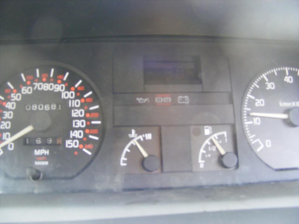

My petrol after driving from bournemouth to rockingham, actually went up from this before track time! well pleased!
The black 172 with half black light covers managed to creeeeep past me on the next lap on the straight but was very impressed with Mag-e at how slowly he went past :twisted:

Spent 4 hours cleaning her today. Used this colour restorer by tesco which i presume is just their cheap version of t-cut all over the car and its made a massive difference. The colour was so fuckin matte before and now it actually reflects light instead of absorbing it!

Thats a touch warm on the coolant mate!

That was sitting in traffic in the queue going into rockingham and my fan doesnt like to kick in as soon as it should lol, drops straight down once it does, around that sort of level actually. Need to look into it!
