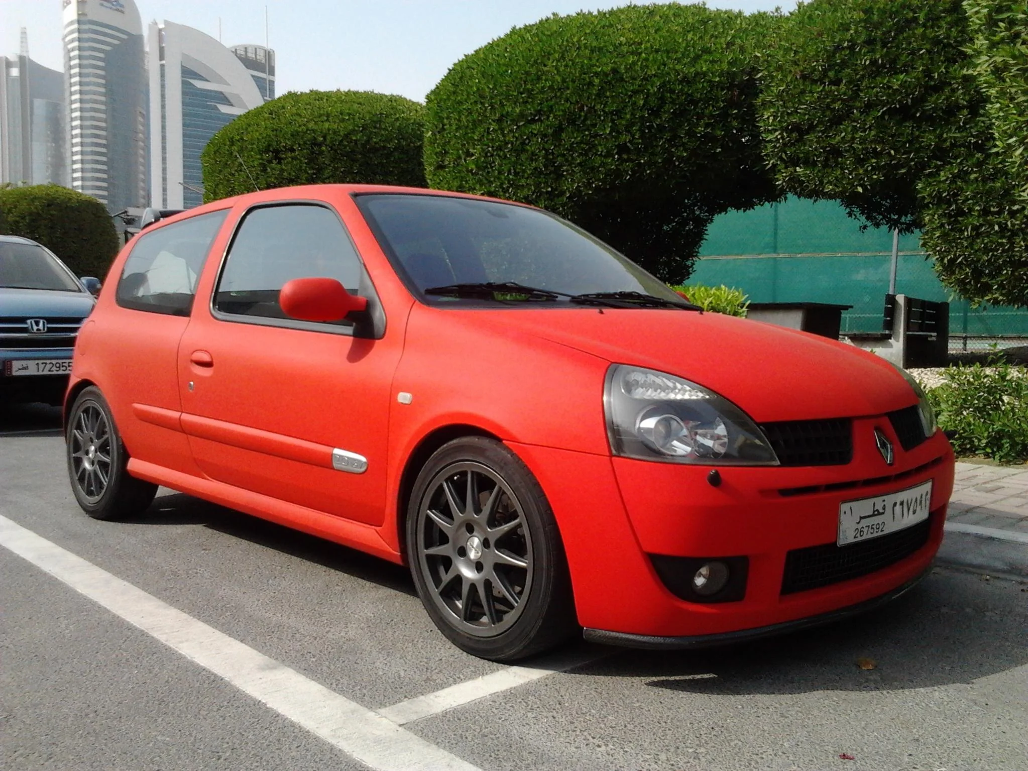

It does look a bit like the colour of a red S reg corsa in those pics but I'm sure it will look better in da flesh.
  Flame Red (172)
Some photos with my phone..;)
  Toyota MR2 GT Turbo
:S Why didnt they strip off the mirror caps, and seperate the handles to spray them.
Matt on a full car will be a bit of a nightmare, you'll never be able to polish it without special compounds. Is that a single stage? or a base coat and dull coat lacquer?
Taking the door handles apart is almost as hard as changing a headlight!

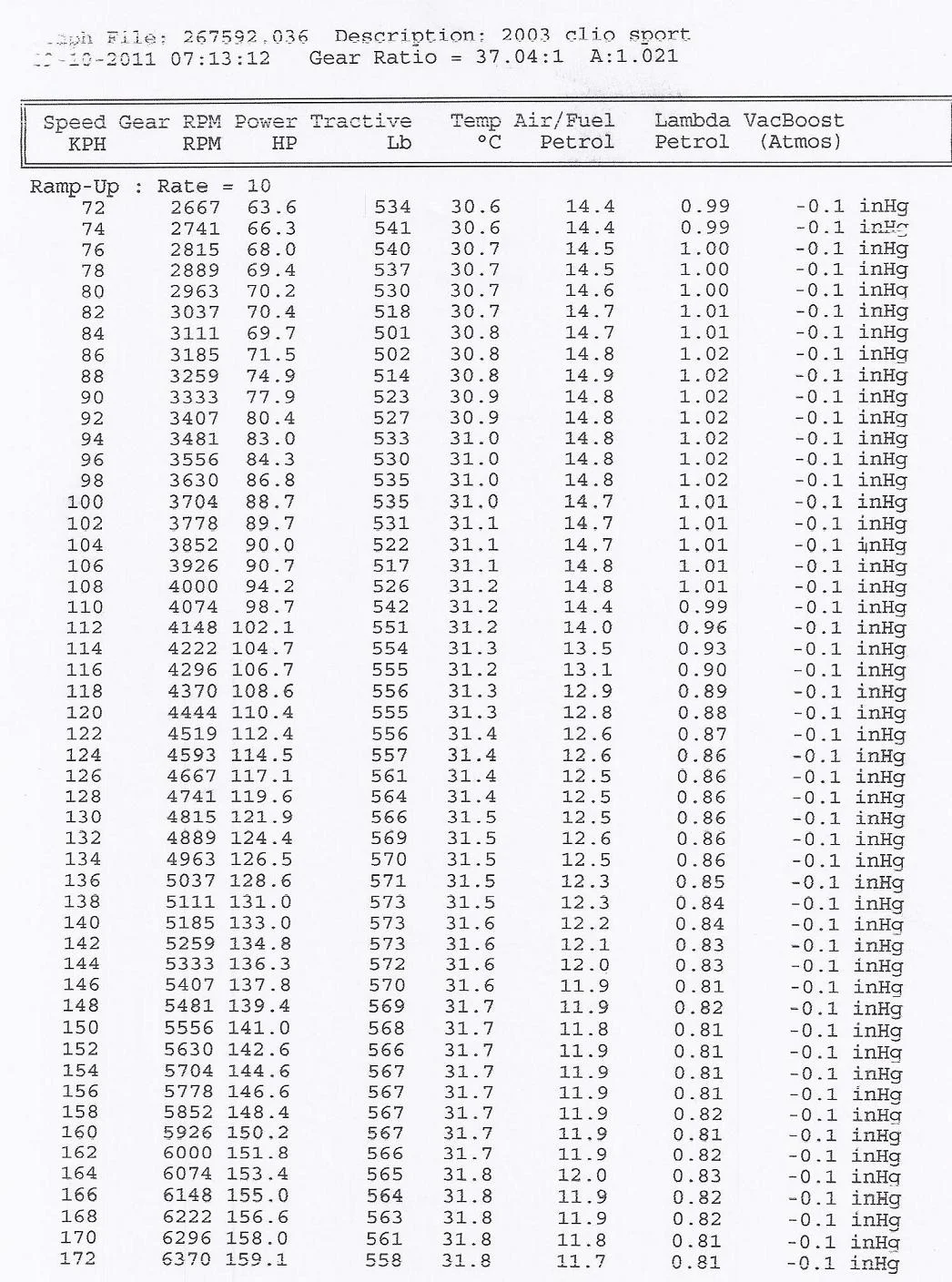

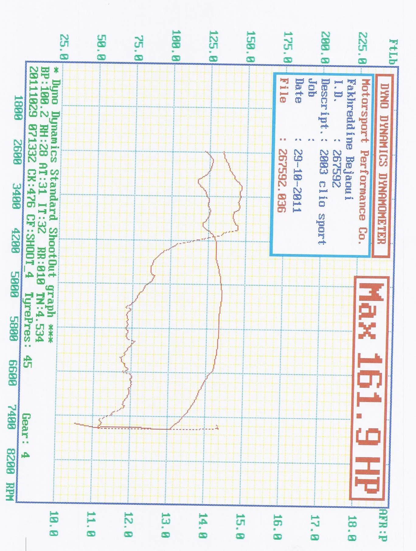

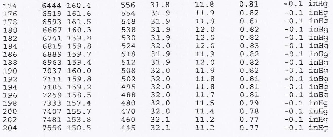

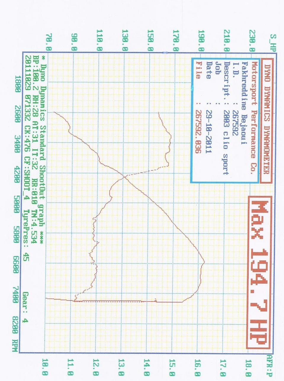

Hello,
I already did a couple of remote tuning with ( superchips..), but still feel that the car(172 MK II, 2003 Model) need more proper tuning.
They advice me with LIVE tuning , but the problem nobody can do it HERE (QATAR).
The car have the below upgrades:
1- high compression pistons 11.5
2- Group N cams .
3- 182 manifold.
4- Decat.
5- JMS intake manifold.
6- KTR recessed Exhaust.
7- Matched inlets.
Dyno graphs are attached....i tried a loooooooooot for find somebody around for live tuning..but none found..
i really need serious advice base on the attached graphs.....i'm willing to fly anybody to Qatar to do the live tuning here!!!!..
Cheers,
F.Bejaoui

Yeah that looks good. Didn't know what to expect but it looks good. Paying for flights and a hotel lol that's a big opportunity for someone that know how to do it!
  182 track, Mk7 ST

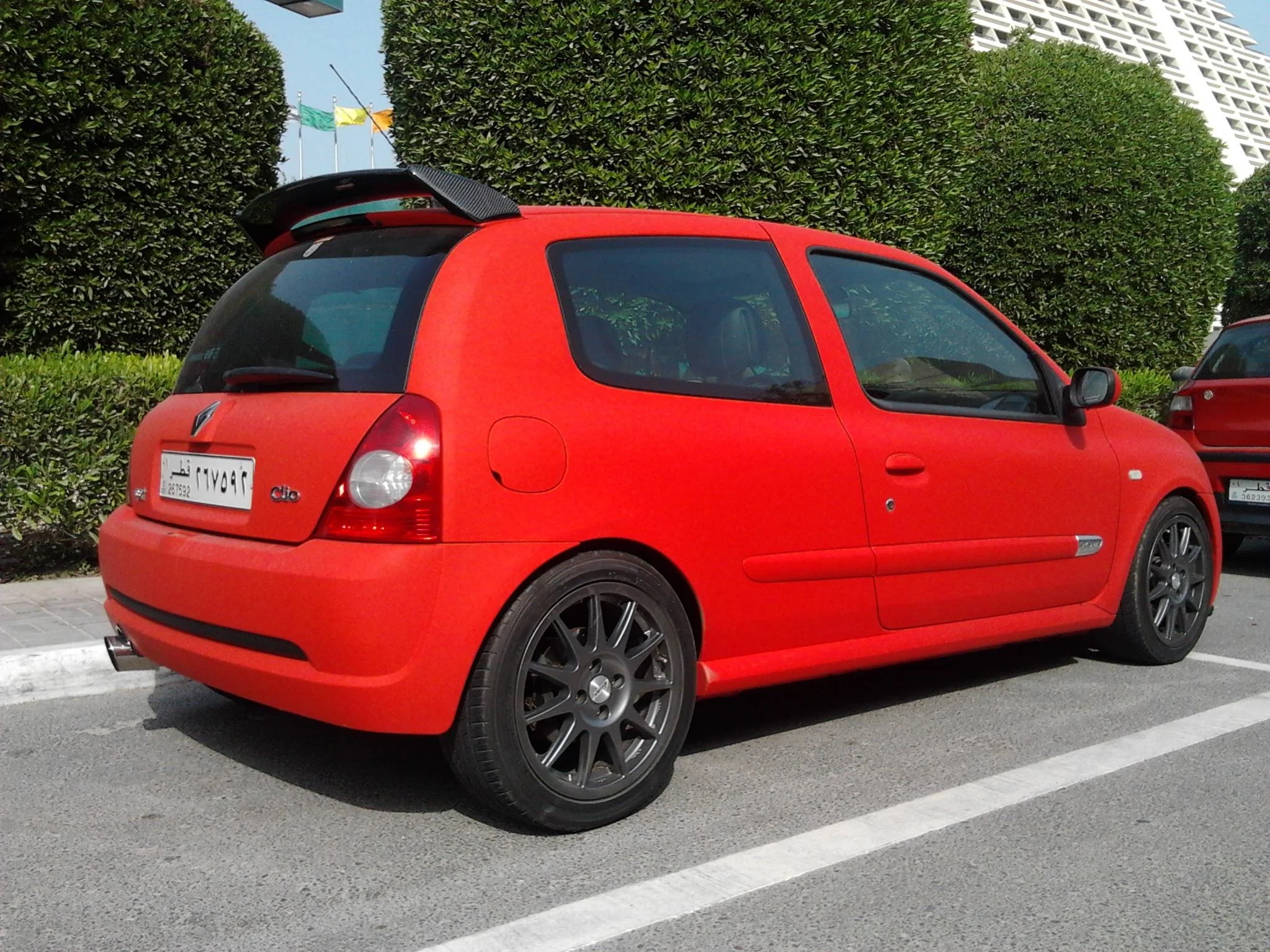

I love this! It looks awesome and tbh I strangely like the spoiler although a trophy one would look good too ;)
Good power already too and some good engine mods
  172/1.2/E30
Did you speak to Henk regarding mapping? You could ship/fly the car over to Europe for mapping if money is not a problem ;)
  172/1.2/E30
fastchip.nl! He does custom mapping based on logged data you'll need to send him. Maybe he is coming over if you'll pay him enough ;) You could seriously ask some of the tuners on here.
