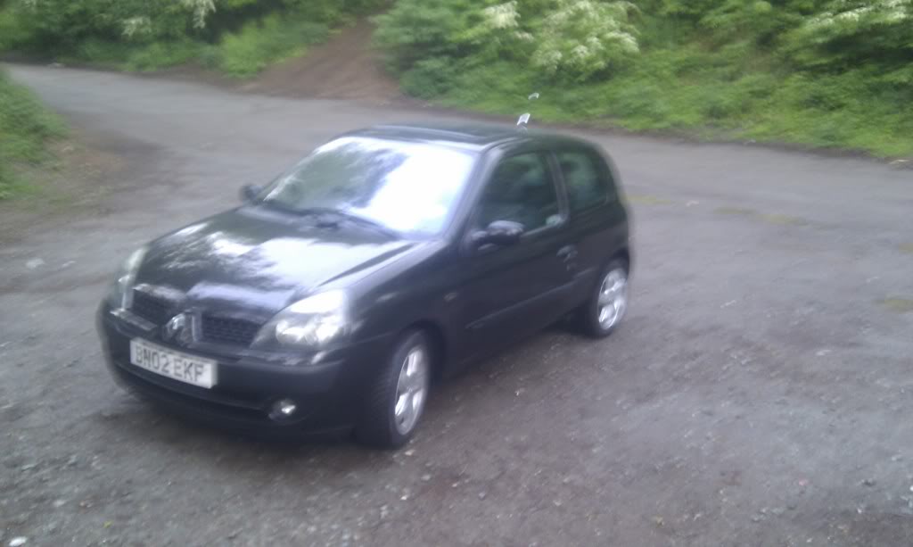

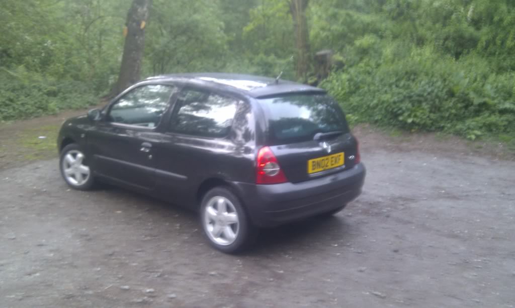

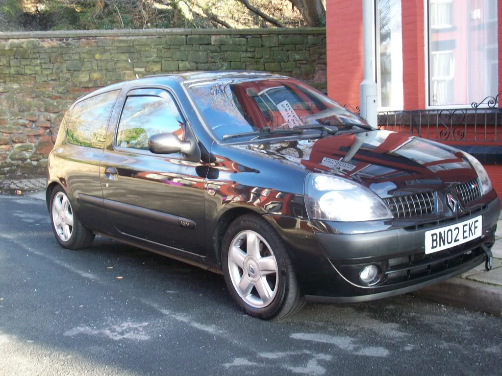

so this `was the car how i bought it only thing fitted was a set of HID's other than that it was standard.
so she sat like that for a few months then i decided to take my thumb out my ass and make it my own

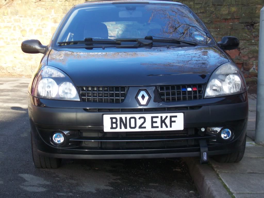

so started off by getting myself a rs grill was in condition when i bought it but as the car is black it looked a lil too grey for my liking so out came the rattle cans
and then gave it a little bit of colour

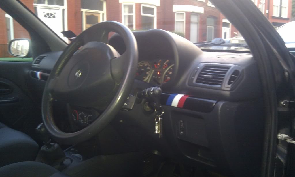

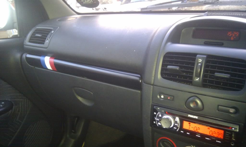

while i was there i thought might as well do the interior dash strips

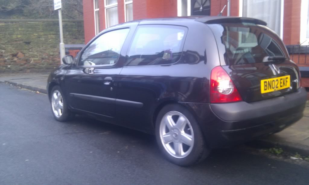

next up was getting rid of the big arch gap that had been bugging me for ages sorry always forget to get the camera out while doing these jobs
AFTER:

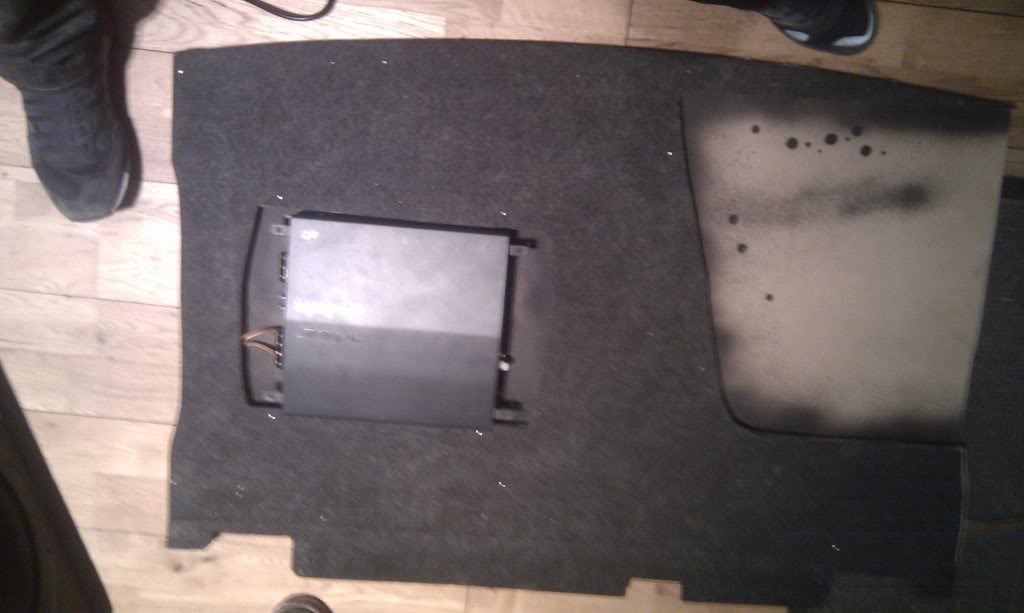

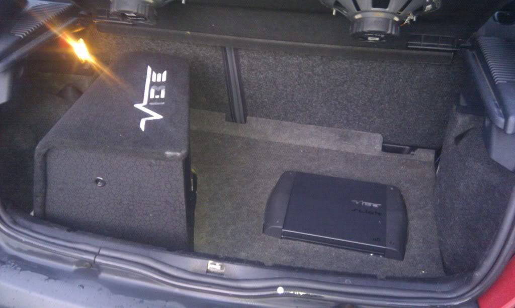

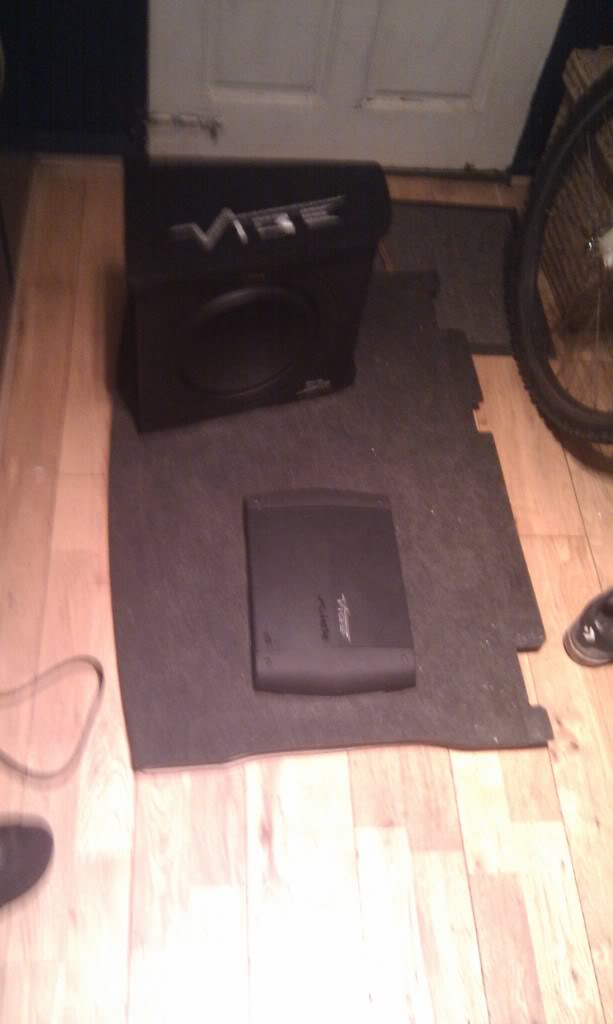

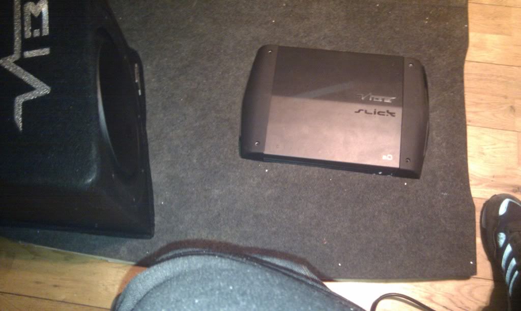

next up was giving the amp and sub somewhere so rest instead of rattling round the boot so out came the mdf
INSTALLED:

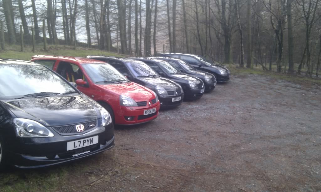

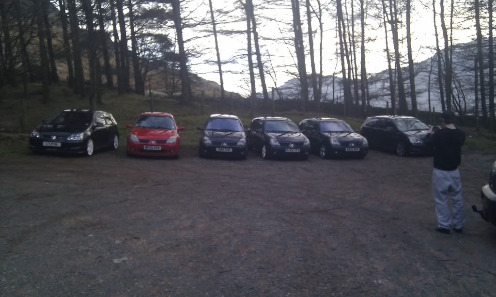

then i headed up to the lake district and went to the lakes run out and met up with tunst, ben g, n1cki and a few more was a good day got to cruise through mountain passes get stuck on the corner from hell with another 1.2 and two ep3s that tunst and ben had already flew through wont realising how bad it realy was haha.
and spent two cold nights in a tent having to cuddle up with the missus lol (it was january and -5)

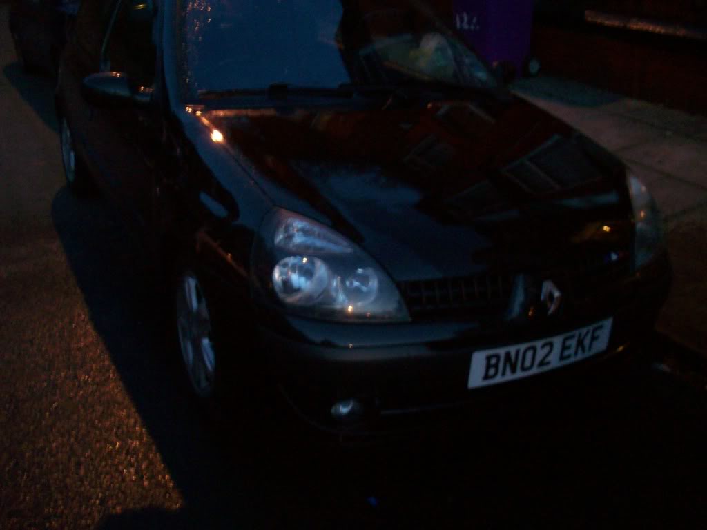

so after seeing there cars thaught the car needed some more tlc to the exterior so not having a dc anymore i decided to improvise

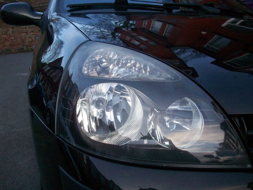

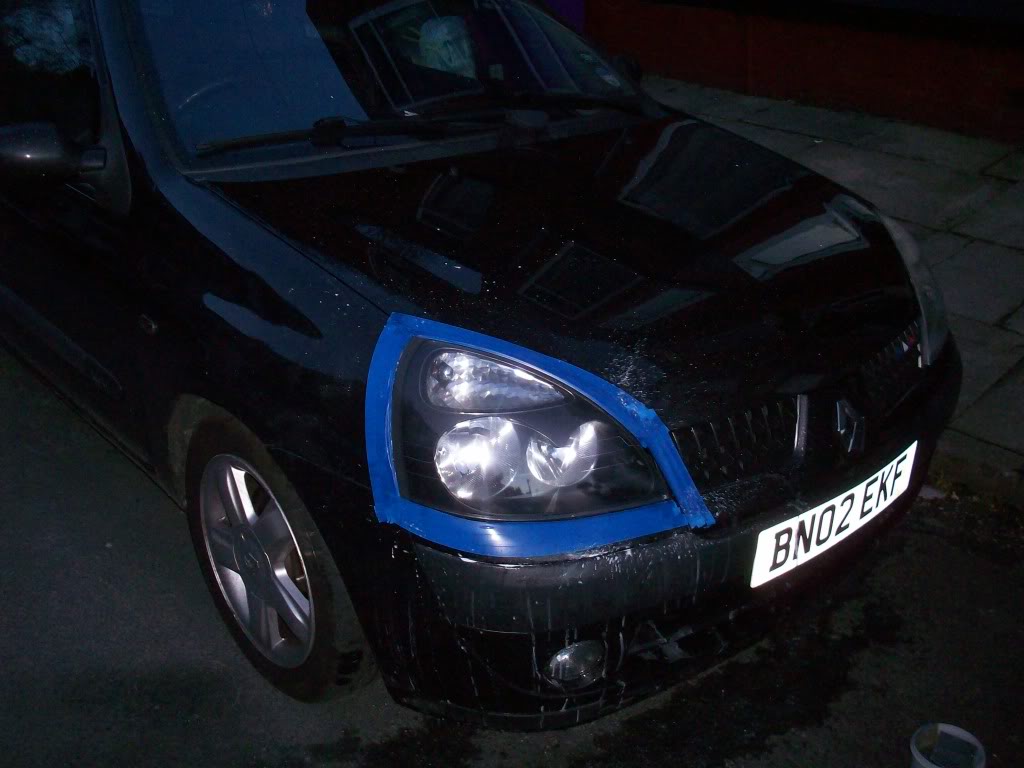

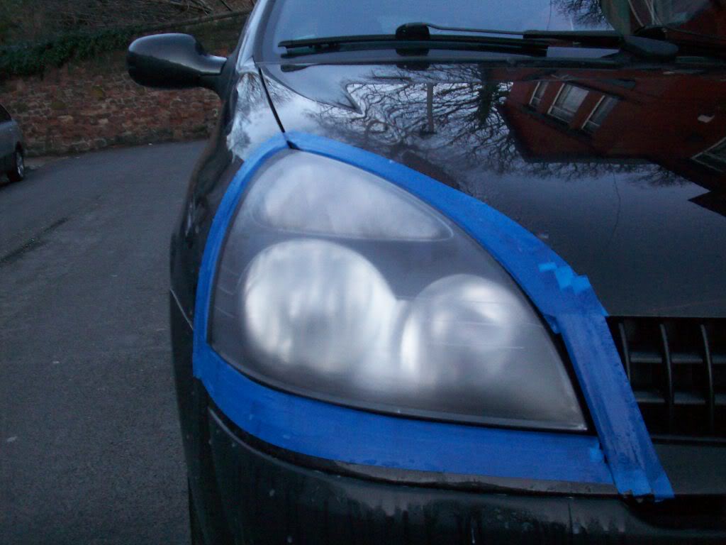

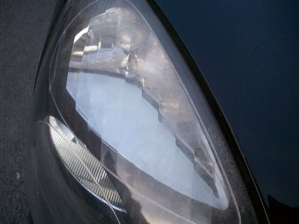

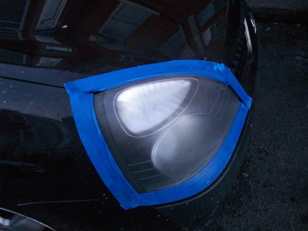

then set about restoring my headlights is beyond as it has a leak somewhere that i cannot find so keeps misting up so a replacement has been bought but hers how i done the o/s
didnt look too bad straight on but when you got up close the top had pitted and yellowed

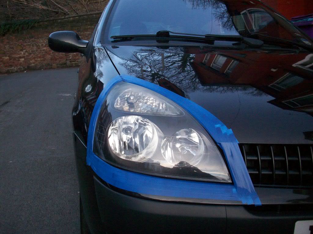

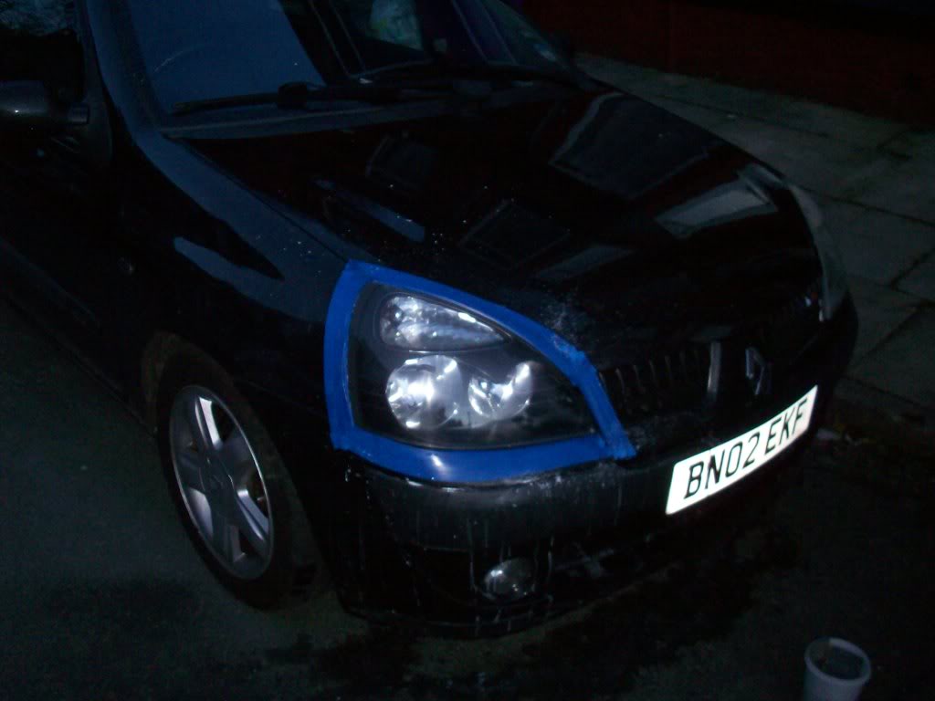

so started out by masking up round the mirror as i didnt want to hit the paint which is in prety good condition

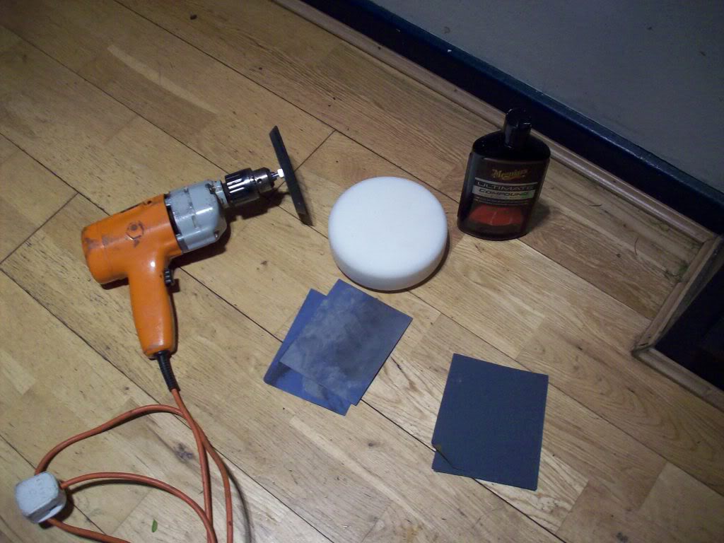

then hit it with some 800 grit wet and dry

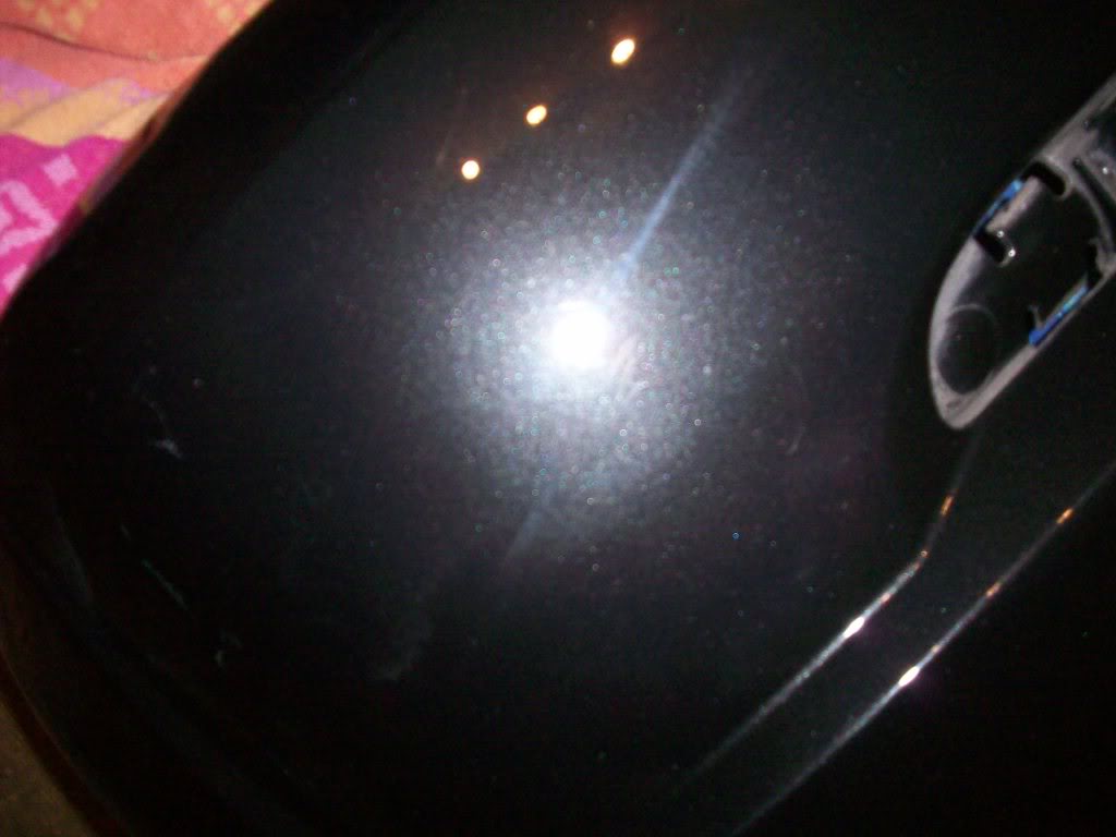

then with 1500 but i forgot to get a pic sorry, it went prety clear with the 1500 but no shine so used maguires ultimate compound on the mop and let the drill do the work instead of my poor arms lol
realy brought out the shine again light looks like brand new now

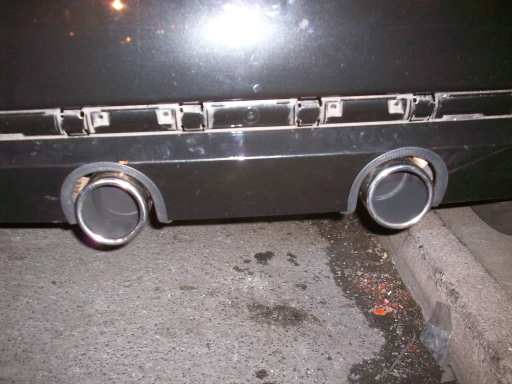

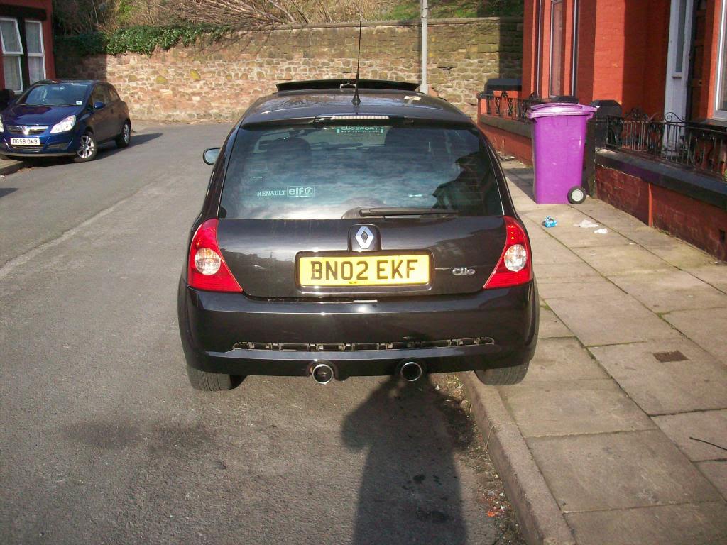

then after a 6-7 week wait and a mess up 1 more week finaly had a delivery of the k-tec 182 style exhaust which i love the look of
heres a video but the system sounded bad as i couldnt get the center section to stop blowing with the cat bracket was dead and still had the ecu problem thats why the idle is rough as a dogs ass

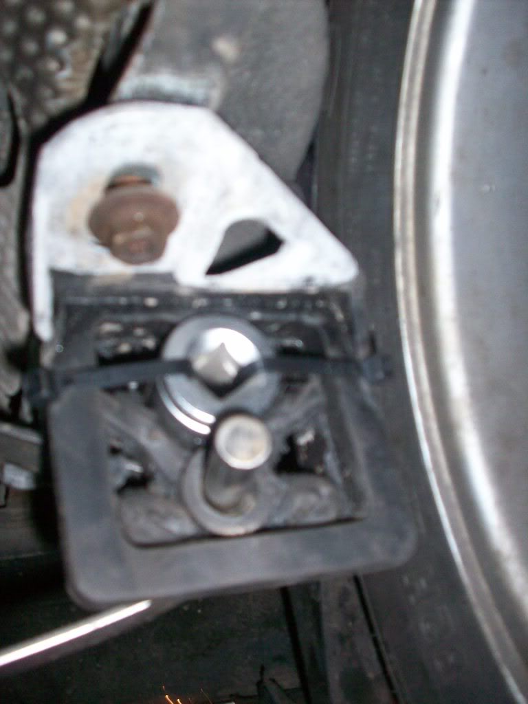

so since then iv fixed the blow i got the bracket from renault £8 not bad and payed out £45 for a new engine top loom fitted it myself with my dad, engine management light is now gone so much for "you need a new ecu as when the loom has gone its damaged the ecu losing its 5v feed" thank god i gave it a go myself instead of letting renault get there hands on it heard some horror storys of people having the same problem taking it in, and being told they need a ned throttle, loom and ecu and smashing them in the face with a 1500 quid bill.so i no longer have rough running engine and the blow has gone. so think i need to get another video this weekend and hopefully witha take off also.

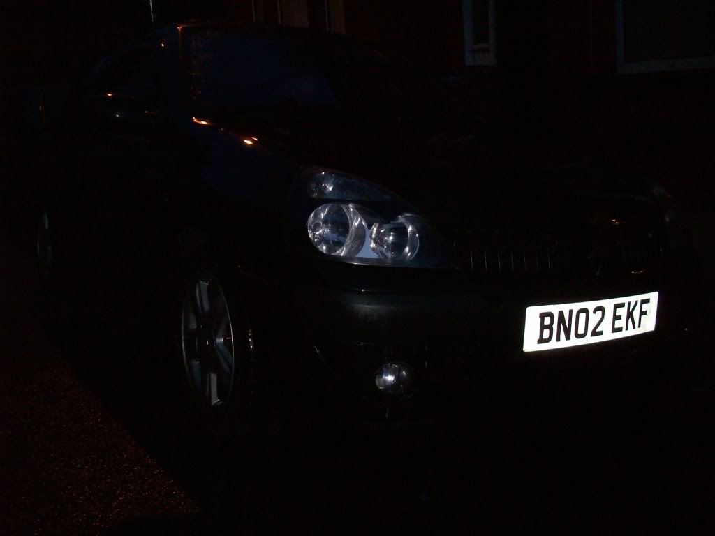

sprayshack do them I think mate. sure n2graffix do as well. My headlight misted up after a refurb and i put my lights on and took the caps off the back and it dried them out.
my passenger misted up before the refurb tried everything even dried it out with a hair dryer and fixed the cap but it came back so just replacing the unit when the new 1 finaly arrives

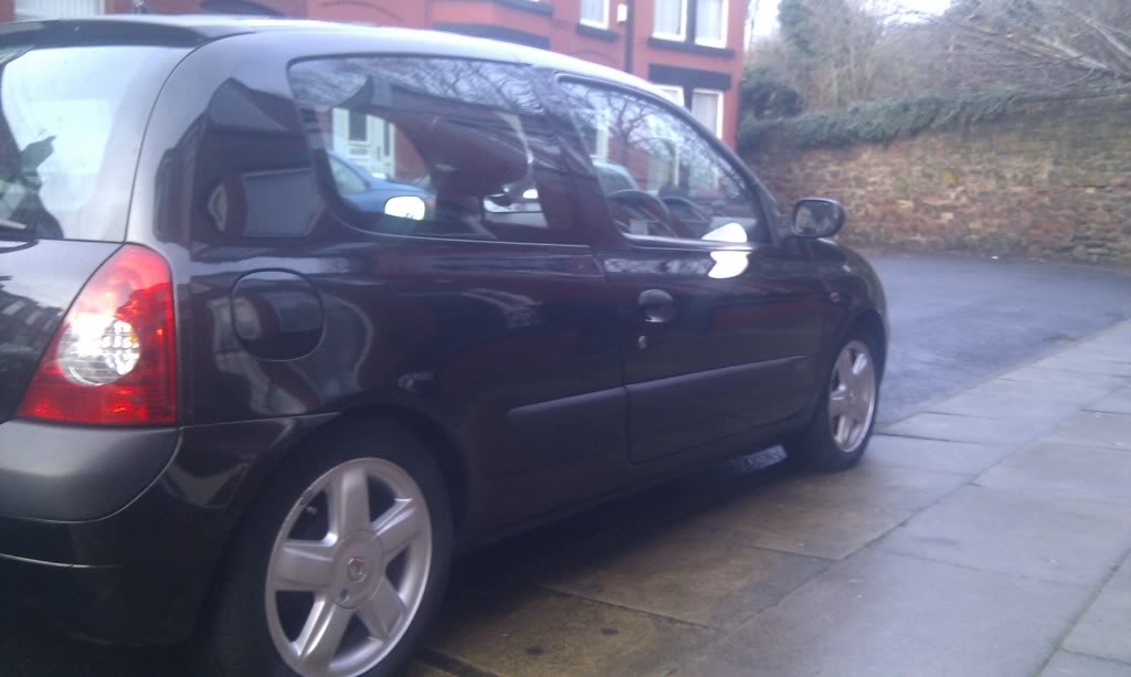

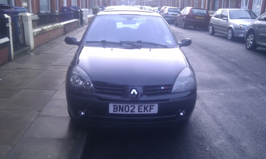

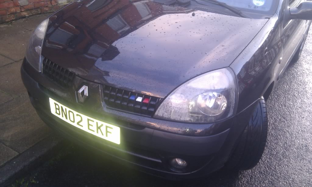

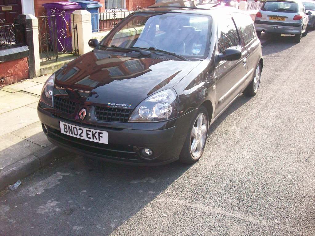

also got round to putting one of my decals on i removed the french flag from the grill also well heres how she looks i think its aot better
and i know the car is rotten getting a good clean tomorrow i have to of the cs decals with the three lines underneath dont know where i should put them did think on the door pillar but think i need a bit of guidance there lol

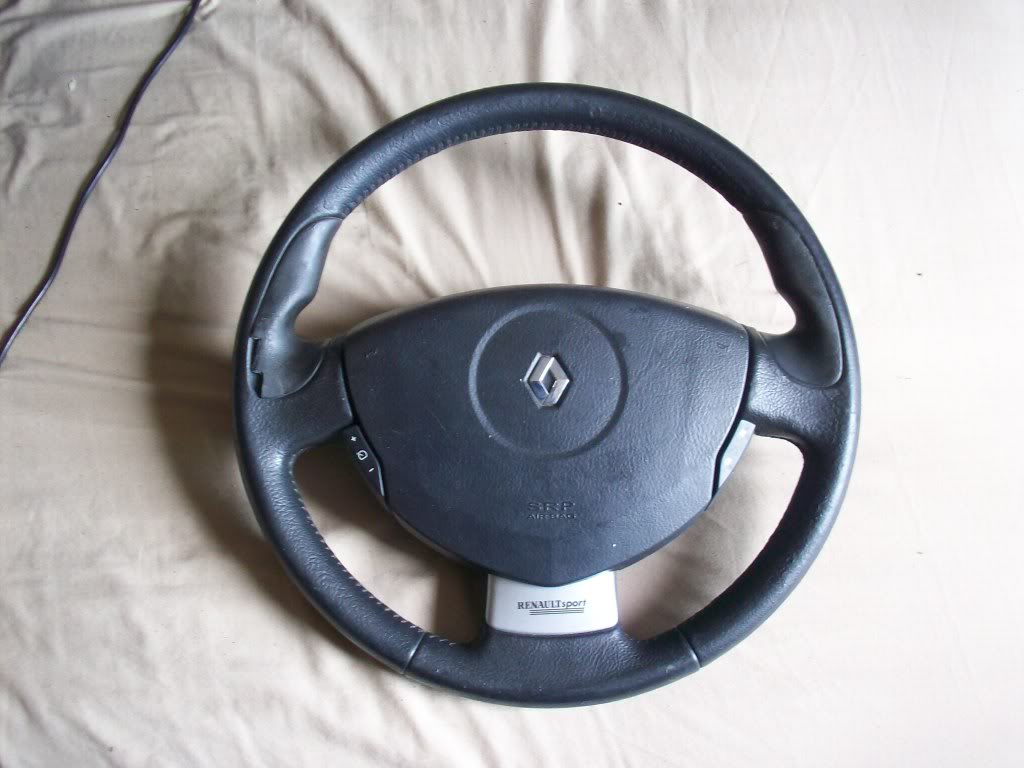

well had another package today my 182 steering wheel arrived its not in the best condition leathers melted and one of the thumb grips is a bit ripped etc but that doesnt bother me as im sending it off to mikey to retrim for me so itll be looking nice when done.

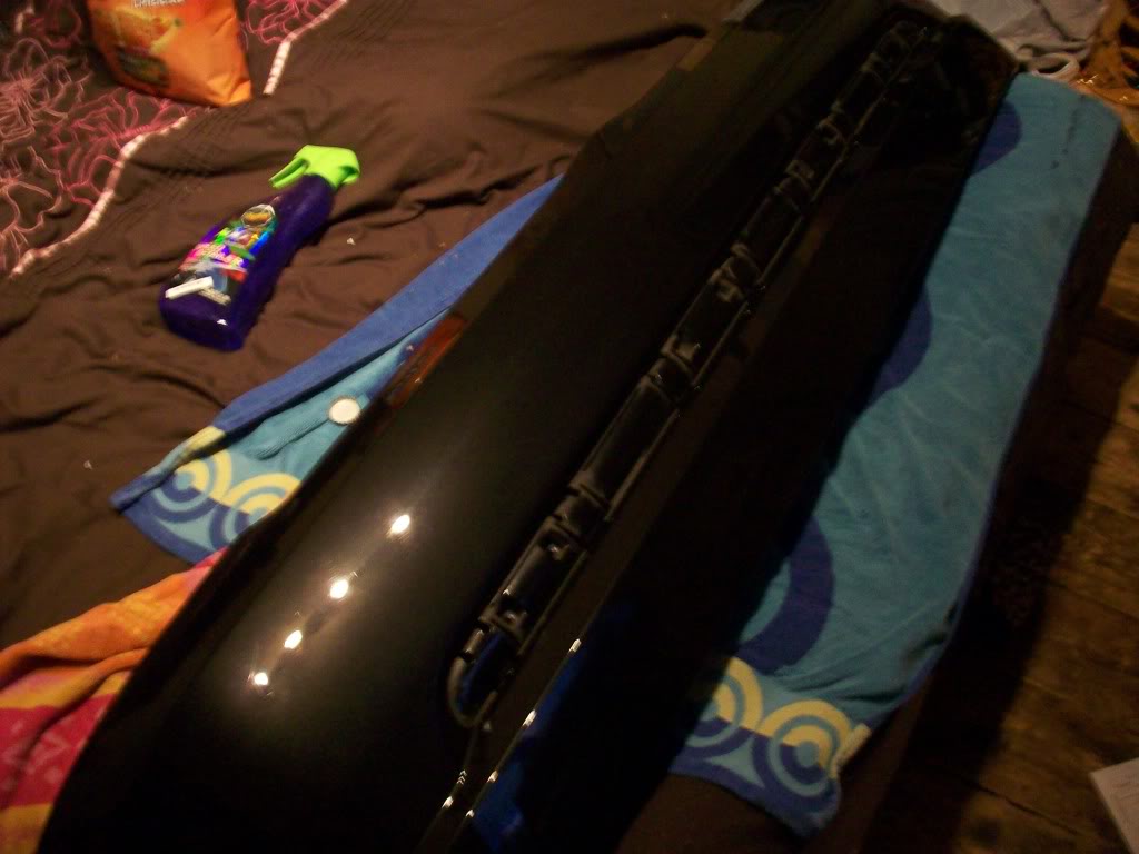

yay the sport bumper has arrived thanks ebay lol its not in the best condition but nothing that some elbow grease cant fix so im going to be buffing the s**t out of it tonight so getting some beers in and some supplys ill post as many pics as i can

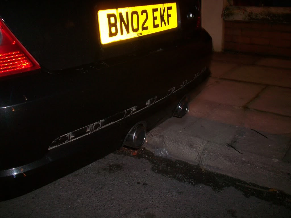

found it hard to get any decent pictures without natural light but managed to get two half decent ones bumpers came out well a few imperfections here and there but its that shiny you don't notice them unless your looking for them. but going to try and fit it tomorrow weather permitted, if anybody has any tips on how to recess it into the bumper id be much appreciative,
well heres how the back end looks now forgive me for it being dirty thats getting sorted tomorrow haha

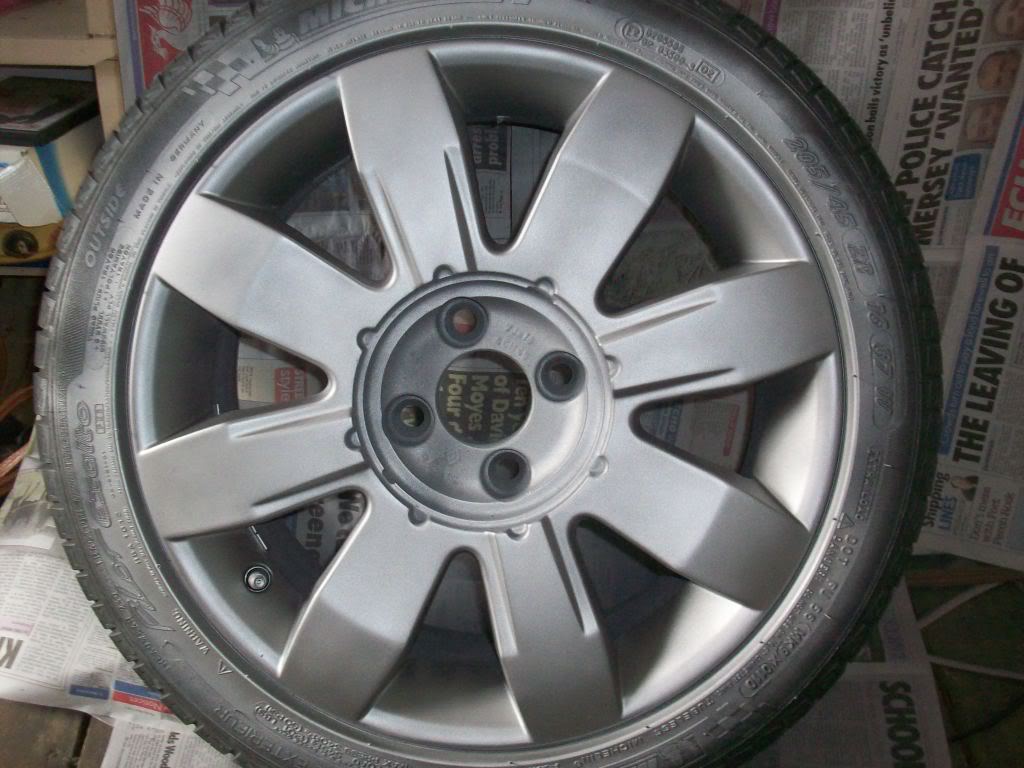

well wheels arrived yesterday tyres are far past loegal lol so need new tryes all round which i wasnt expecting to have to sort straight away so the parada 2's are out the window so got a set of nankang ns2's on the way for now till i get some money together for the yoko's, the wheels have scuff everywhere (only light) which i think is from transit as the piks sent to me dont show any of them so im rubbing them down and spraying them silver hopefully before the new rubber arrives.
and my fancy plates arrived today bit smaller on the car than i was expecting so think they will be show use only unfortunatly ill try get some piks up soon.

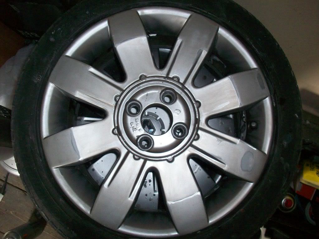

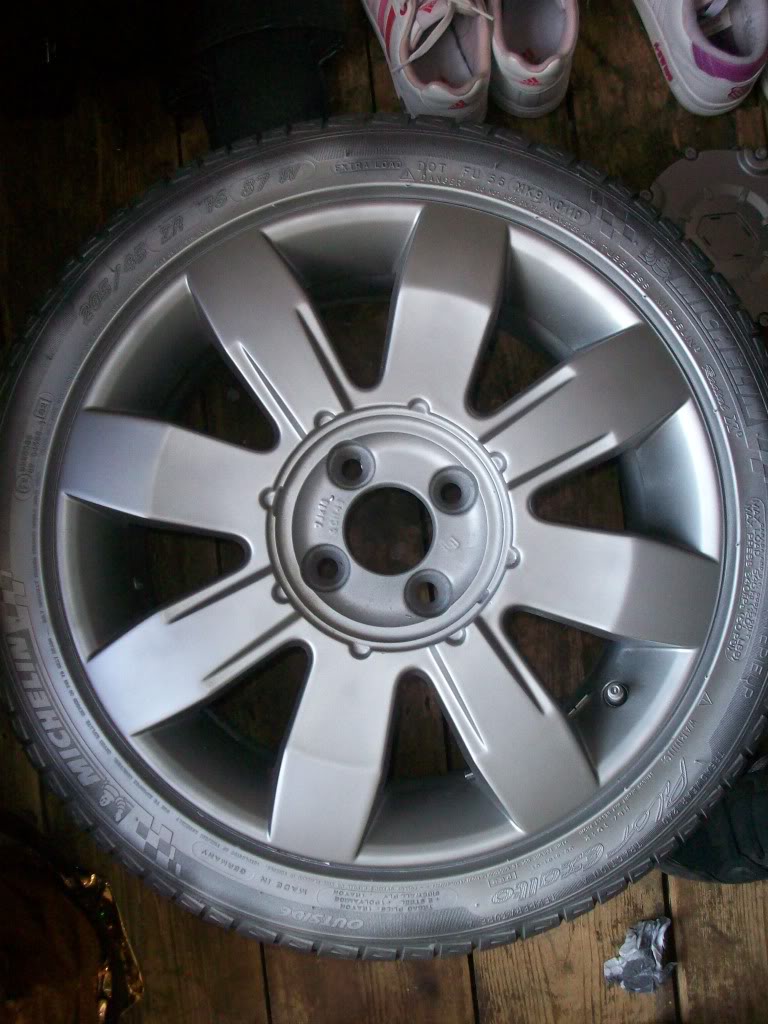

so attacked the wheels this morning managed to get two in colour coat and ill clear them tomorrow while getting the other two into colour forgot to take a pic when primed but heres what i have, oh and yes i havent masked the tyres up as they are far past gone and i have new rubber on the way.
wheel rubbed down to get all scuffs out
in colour coat
he said the tyres were past the tread limit so i suppose hes going to be putting new ones on. other than that mate this car is coming along very nicely. really like the progress soo far keep it up
all the paint on the tyres? how are you going to get that off?
tyres are dead mate so not worth the bother to mask them up as they are coming off by saturday at the latest as i want the wheels on by sunday for the big chester meet hopefully
