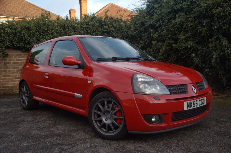

Well after owning this for almost 3 months now I thought it was time I put up some details on what's happened with 393 so far since I picked it up from York on the 8th May.
To summarise the eBay listing:
76k on the clock
Timing belt done
new tyres all round,
Sachs racing front suspension rebuilt end of last year
mintex 1155 pads in the front, new standard pads in the rear inc new discs,
New engine mounts with uprated dog bone bushes
Service history
Scorpion cat back stainless exhaust
Recaro suede/leather front seats in great condition
6stack cd changer in the boot and cruise control
Motd and taxed
£3800 ono
On the surface It seems a bit of a bargain however the work involved so far says otherwise...

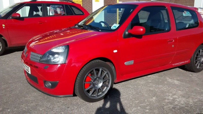

... And that's pretty much how the car sits today 3 months later. Some choice pictures from my first proper outing in the car to the Lakes for a weekend with my wife:

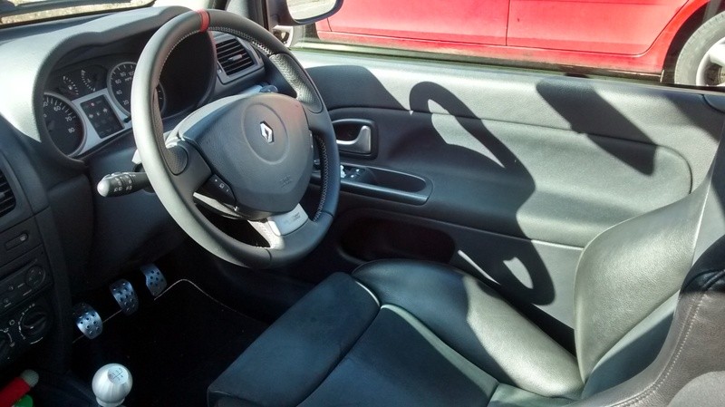

And an interior shot:

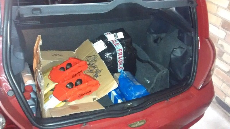

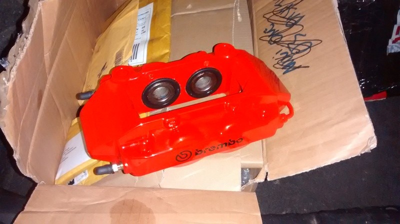

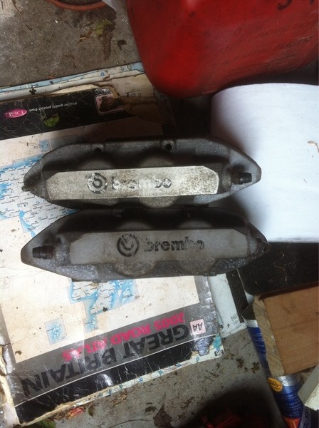

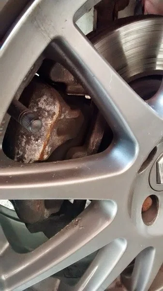

The latest addition has been the Brembo caliper conversion. I picked up a pair of Chris Powell brackets from his recent group buy and then after a cheeky offer of £105 on a local eBay listing managed to collect these:
Looking very sorry for themselves I decided to send them off for a refurb to a local'ish company based in Long Eaton... what a mistake that turned out to be! After the best part of 8 weeks and me delivering and collecting them they were finally ready:
So after yet more shopping with G172 and eBay I managed to source everything for the conversion which included:
- 280mm mounting brackets and custom brake lines - Chris Powell
- Brembo calipers - eBay
- Brembo HC discs, DS2500 pads and new OEM rear discs and pads - G172
- Motul RBF 600 fluid - OpieOils
- Revised caliper pins - MrPink (clio197.net)

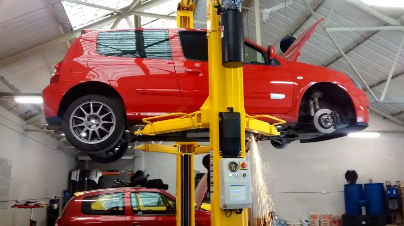

All loaded up and ready to go:

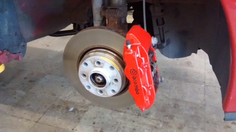

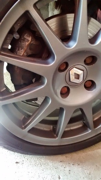

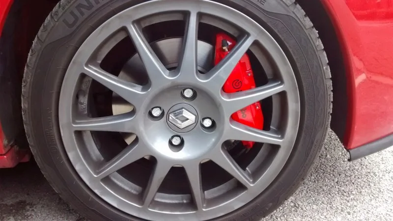

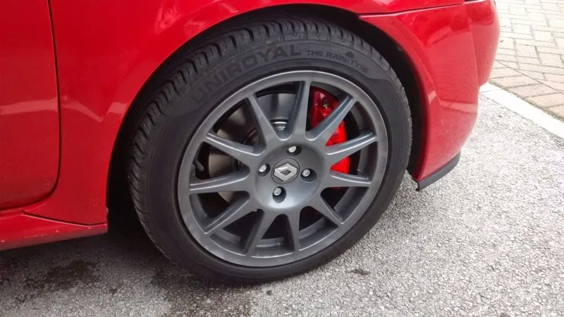

And finally a before and after of the lot fitted:

Brakes look a bit beefier than the standard affairs, although I think I'd have gone gloss black or silver. Do you have any pictures of the entire profile of the car?
  Nissan 350z

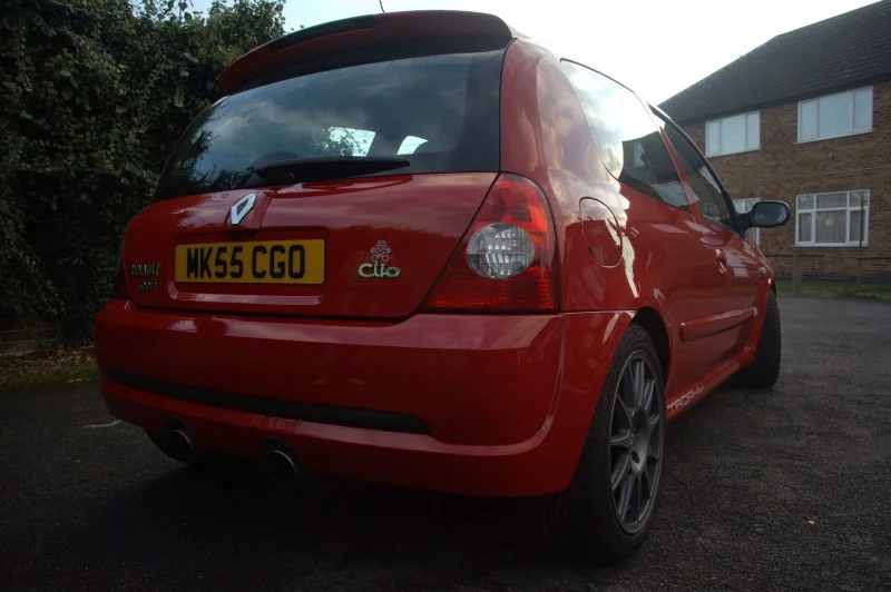

The standard rears are now black as they were in a similiar condition to the fronts as seen in the before pics above. I dont have any better pictures to hand due to the weather and being at work but hopefully this gives a better idea:
(this was in direct sunlight after being fitted)
  Nissan 350z
Cheers both. They are still bedding in really what with being new discs and pads, when they've got some miles on them I'll report back. First impressions are slightly increased pedal travel (to be expected) but then great initial bite and feel.
We did a similar conversion on our Trophy - but used 300mm discs and fitted the bigger master cylinder - and because we're fussy we fitted 197 rear brakes as well (same sized discs but bigger pads)
The brakes are now exceptionally good.
DS2500's are excellent as a road pad but in my opinion can't really stand up to the severe use of two of you driving back to back on track.
Last week we fitted DS1.11's and used the car at Oulton Park yesterday - I have to say I think the setup is now perfect for track use. The pads initial bite is quite something and they don't seem to fade or judder even when they are really hot. Brilliant pads for track use - but they do squeal a bit too much when cold which would drive you mad on a daily driver.
