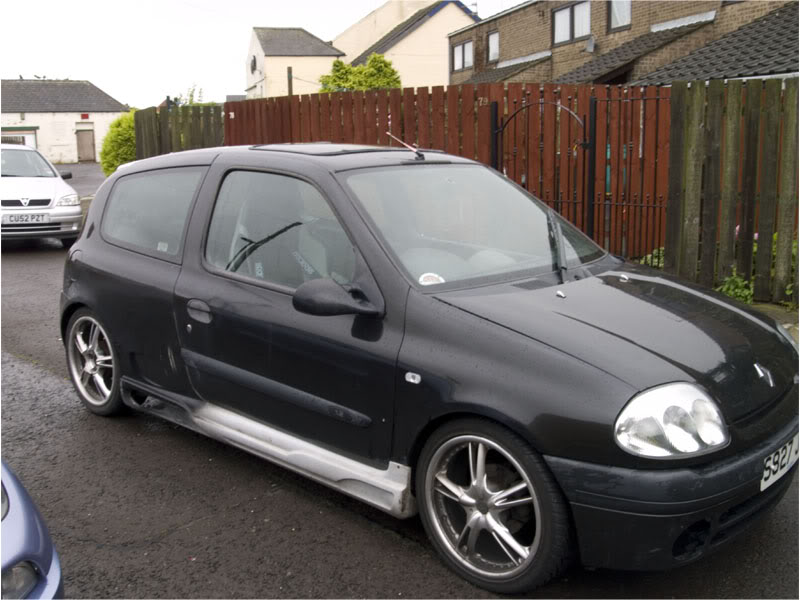

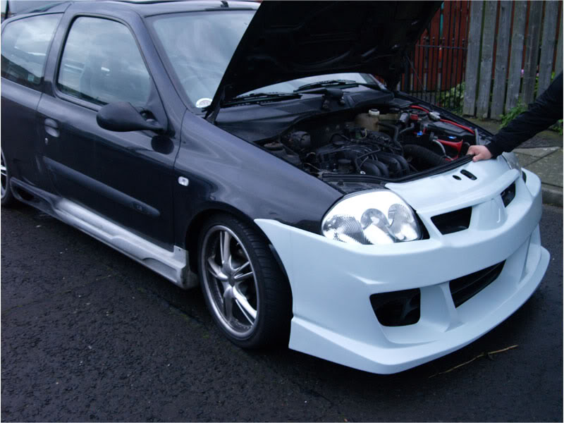

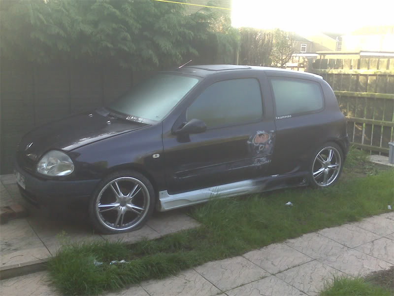

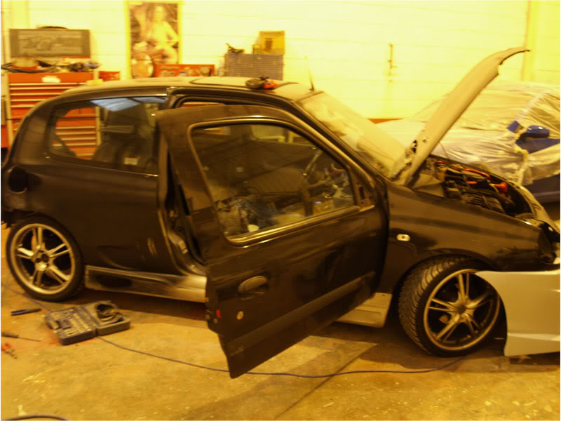

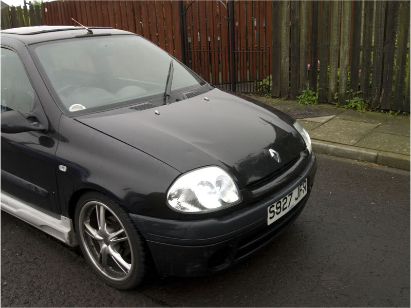

I spent some time and got her MOT'd, taxed and ready to go to the body shop then I took some pictures before she went off to be sprayed Vauxhall Casablanca White.

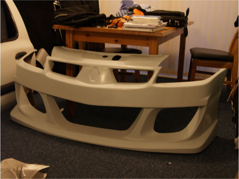

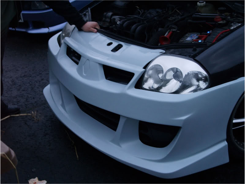

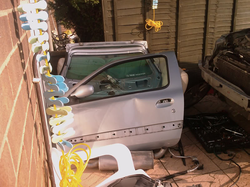

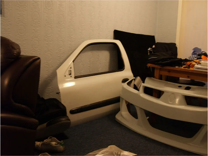

got myself on Flee bay and did a search around for a new door/boot and the front bumper I wanted. Drove down to Tunbridge Wells and on to Maidenhead to pick up the gear.
After a gruelling 12 hour drive to Kent and back in the same day I checked the bumper was a fairly good fit.

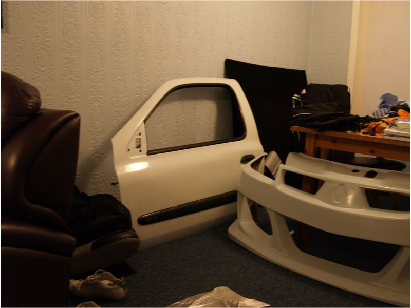

now at this point in time I understand most of the forum members will be saying it's not my style and each to their own etc. I've seen the general consensus on the Mohave bumper but I like it and I think once its cut and fitted correctly it should look fairly nice. If not it can be replaced :)

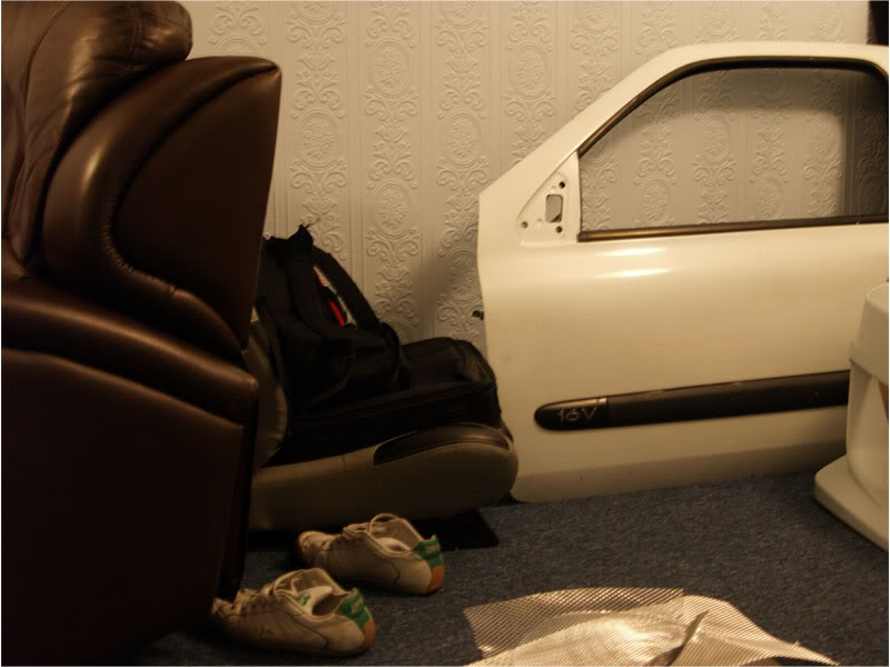

we stuck the gear in my sitting room for a few days till we could transport it to the body shop heh. Glad I don't live with my parent's otherwise they would have gone ballistic.

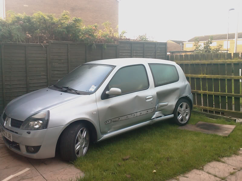

During the process of work commencing I heard my friend had written his Clio 172 off. I was very interested in this as I had always wanted to source a cheap write off for a conversion.
To cut a long story short one night when out in ASDA we passed each other and got talking. We agreed a price of £1500 and I let the body shop know I would finally be getting the 172 rear bumper I was searching for.

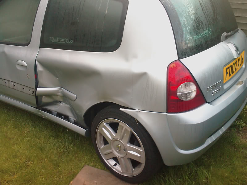

We got the car a few weeks after discussing it and I parted with an extra £1500 over budget. But I really wasn’t that fussed I had always wanted to do the conversion. I got on to Adrian Flux who were more than happy to insure me for only £1000 Per year with all mods declared :D.

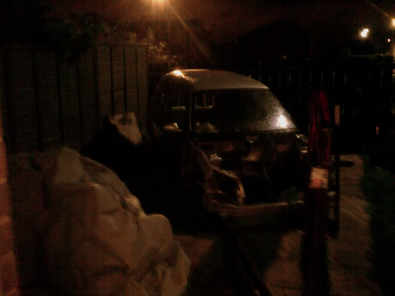

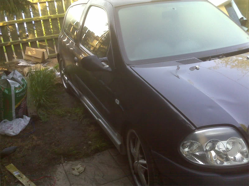

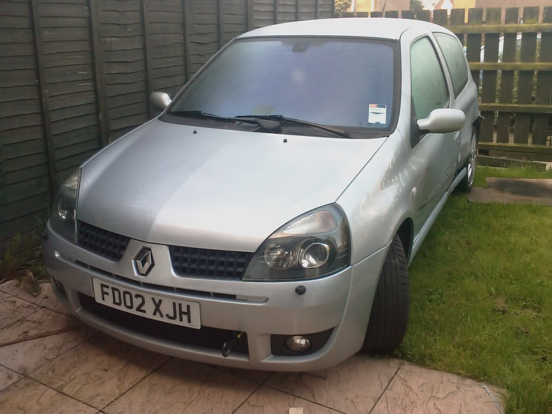

So here’s the car the day it arrived.

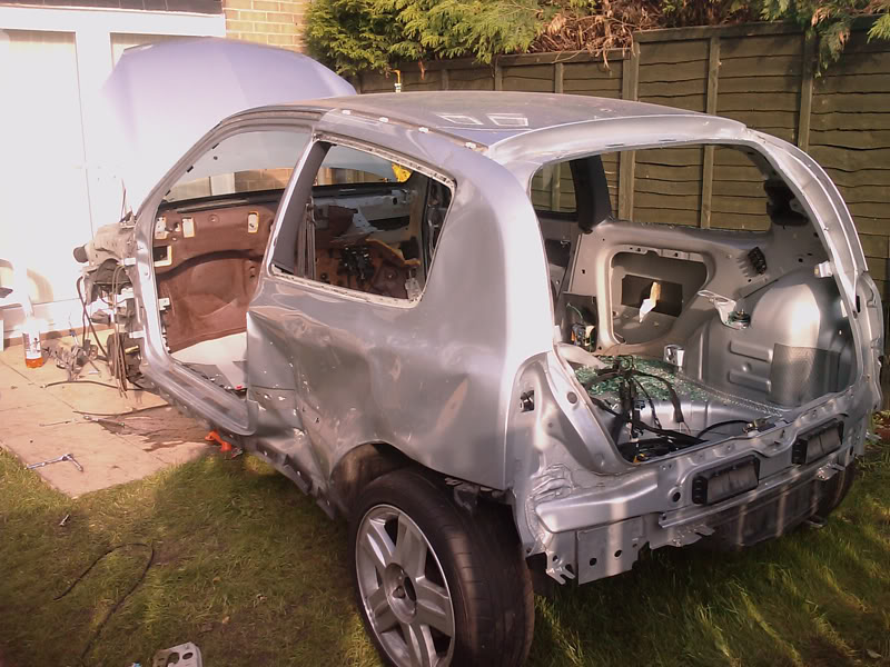

There isn’t a massive amount of damage and yes I’ve heard this one before “would it not of been cheaper to repair it?” Well maybe but that wasn’t the point I had a Clio in the body shop which would only be lower in value than standard and therefore I would lose money.

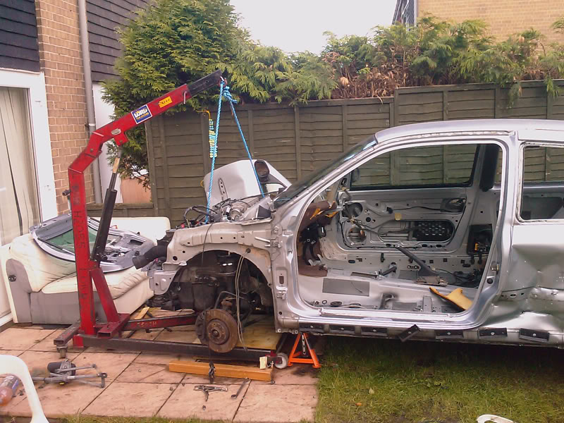

So we commenced operation Strip.The.172.
  White Clio 1.2 @ 172

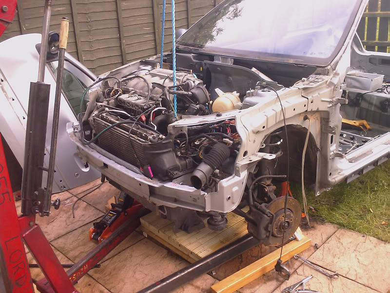

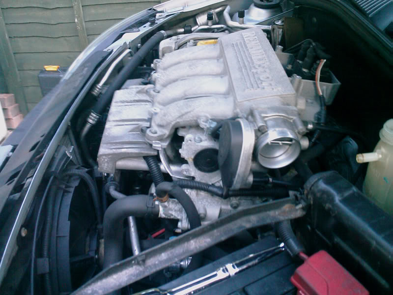

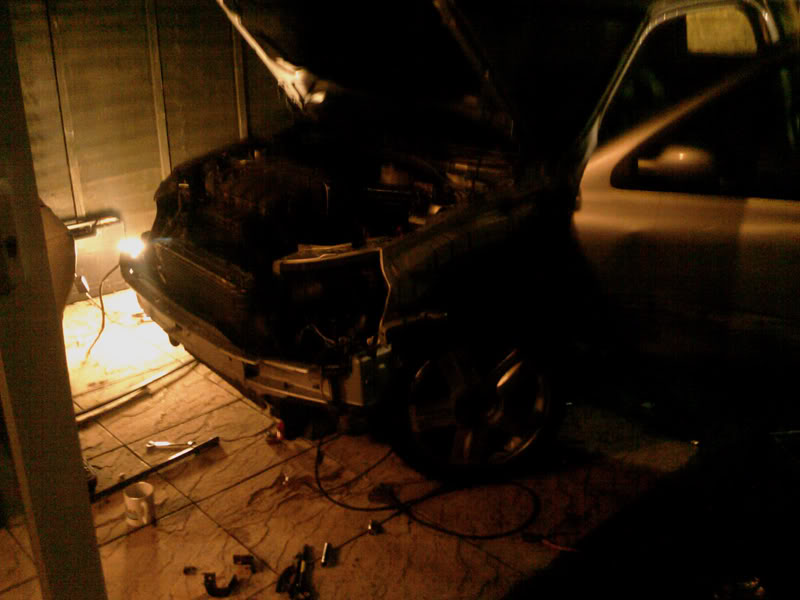

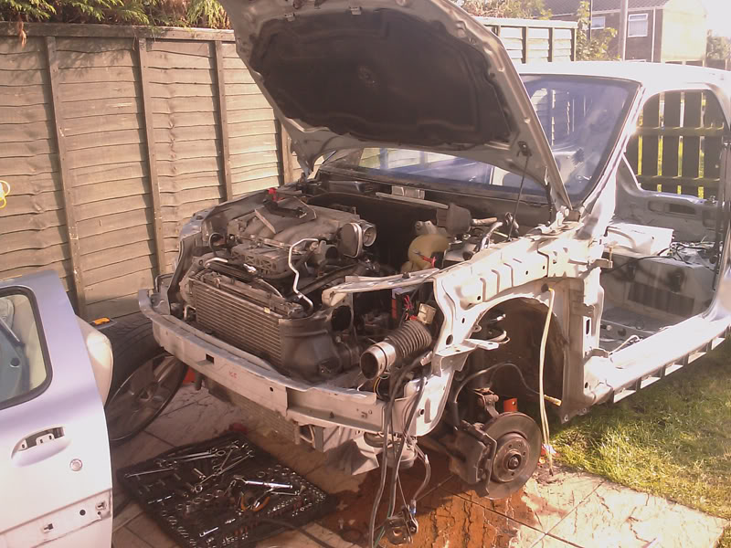

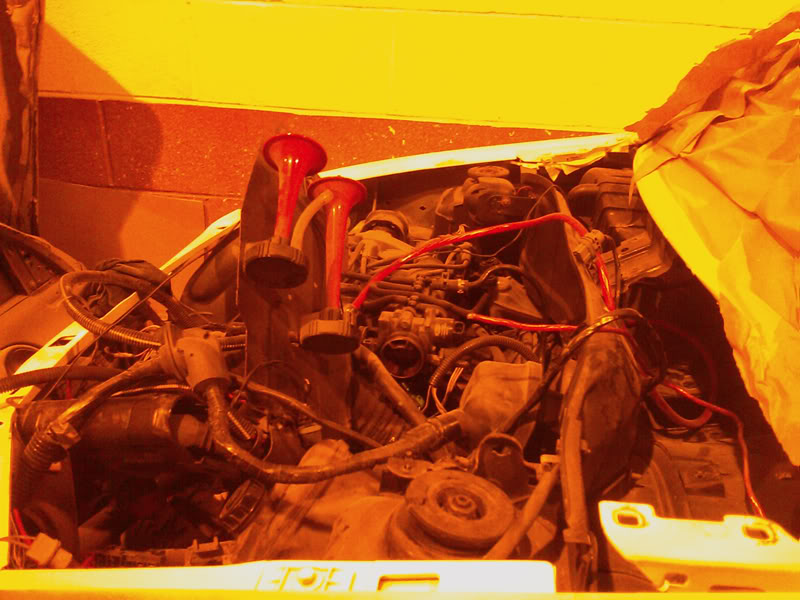

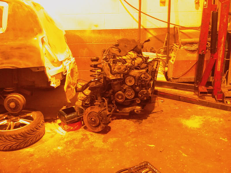

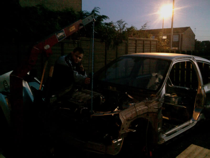

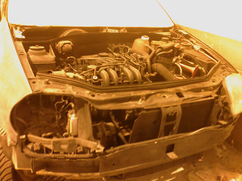

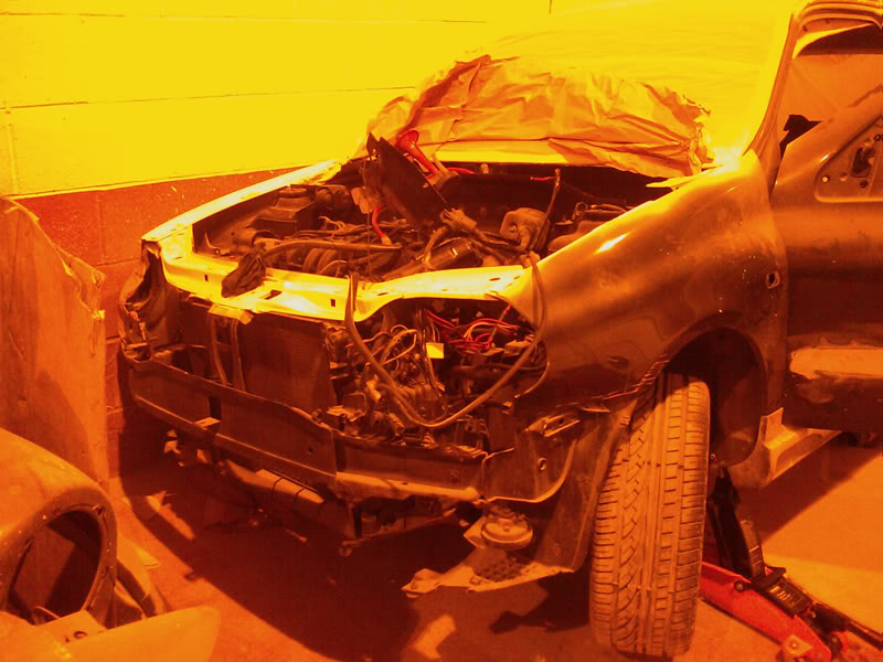

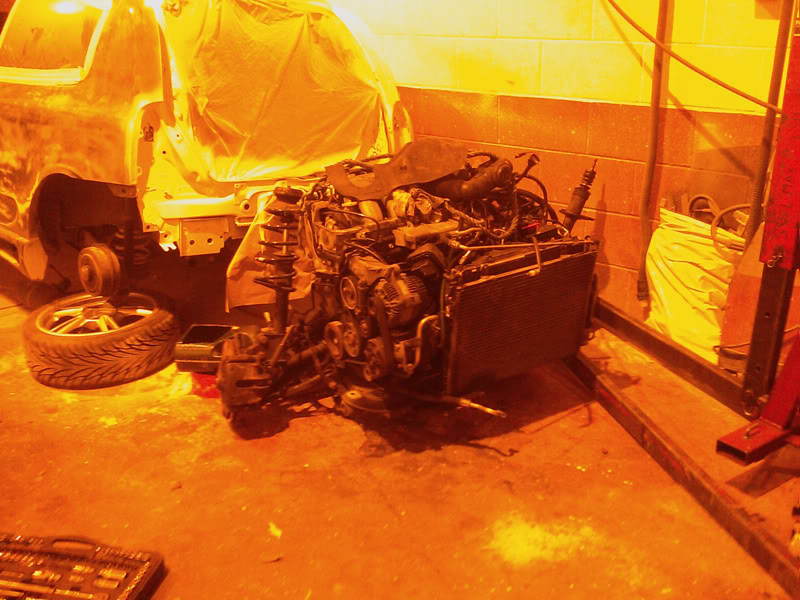

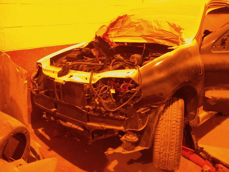

With very limited hands on experience of mechanics I began stripping the engine bay carefully documenting where things were laid out for the conversion.

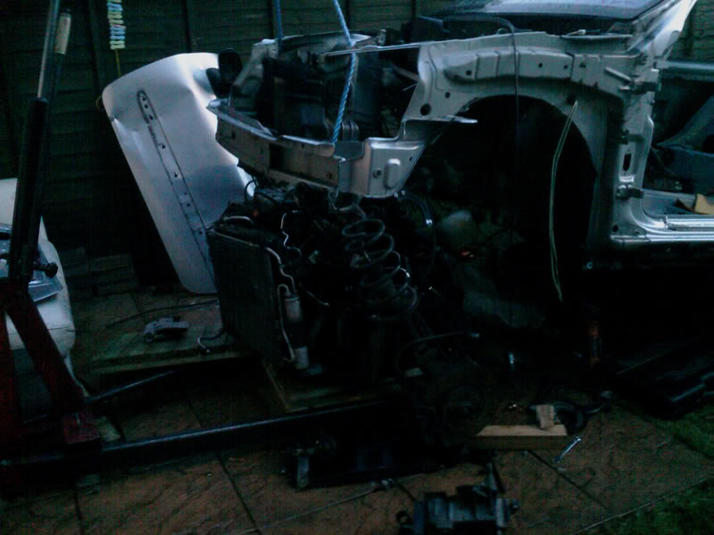

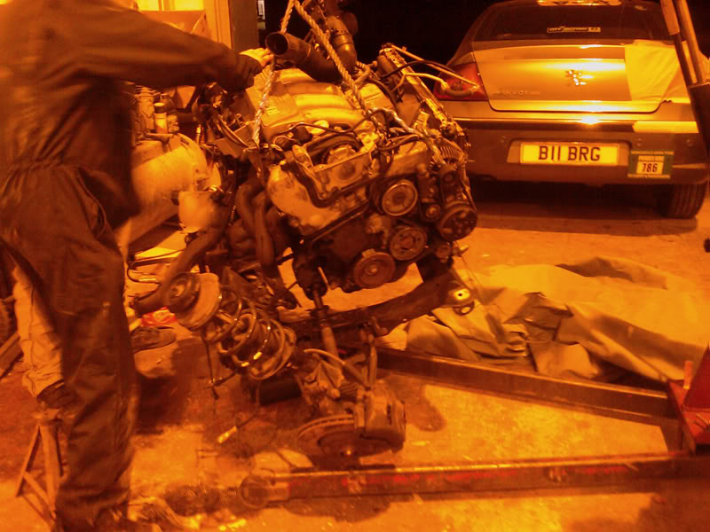

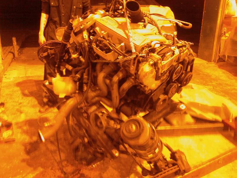

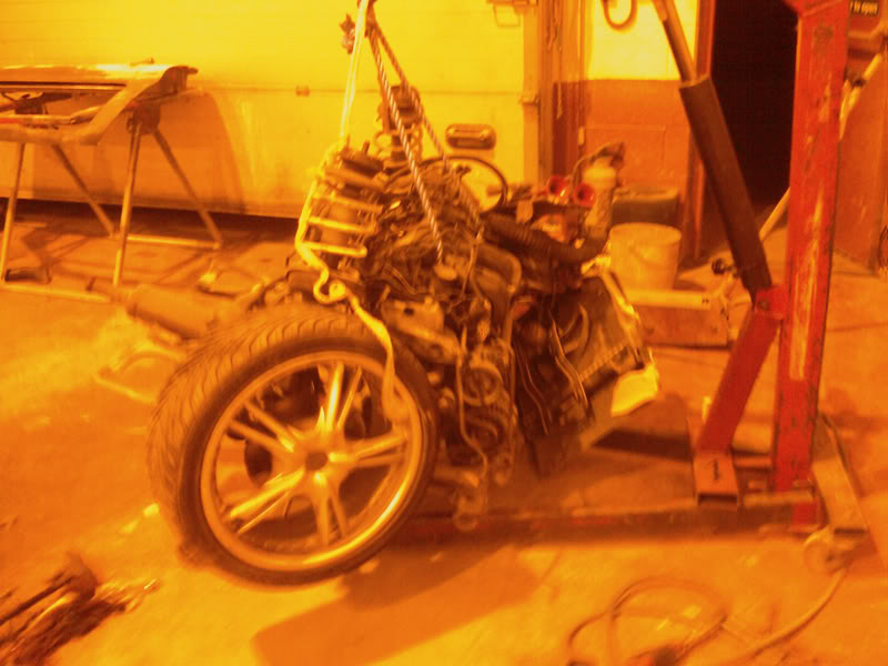

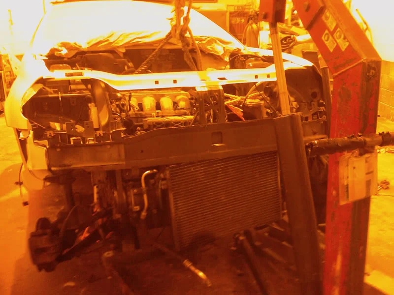

A week later we hired an engine crane out and finally removed the engine completely. We wrapped it up and covered it to protect it from rain and went back to our efforts on the 1.2

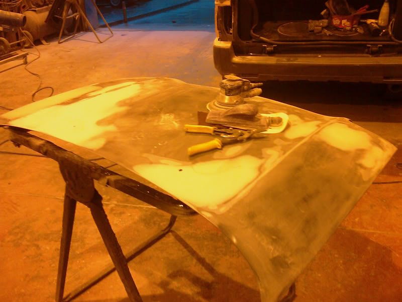

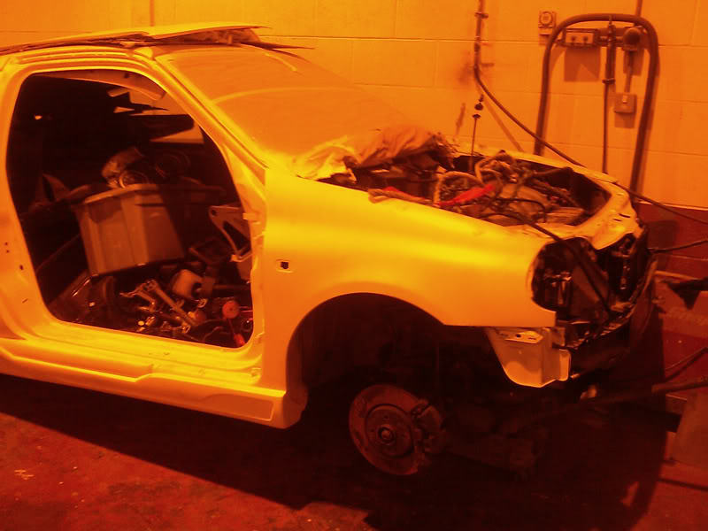

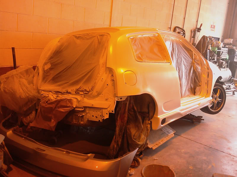

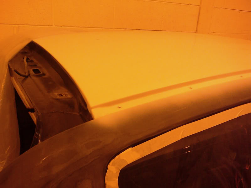

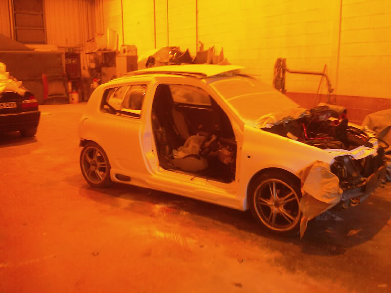

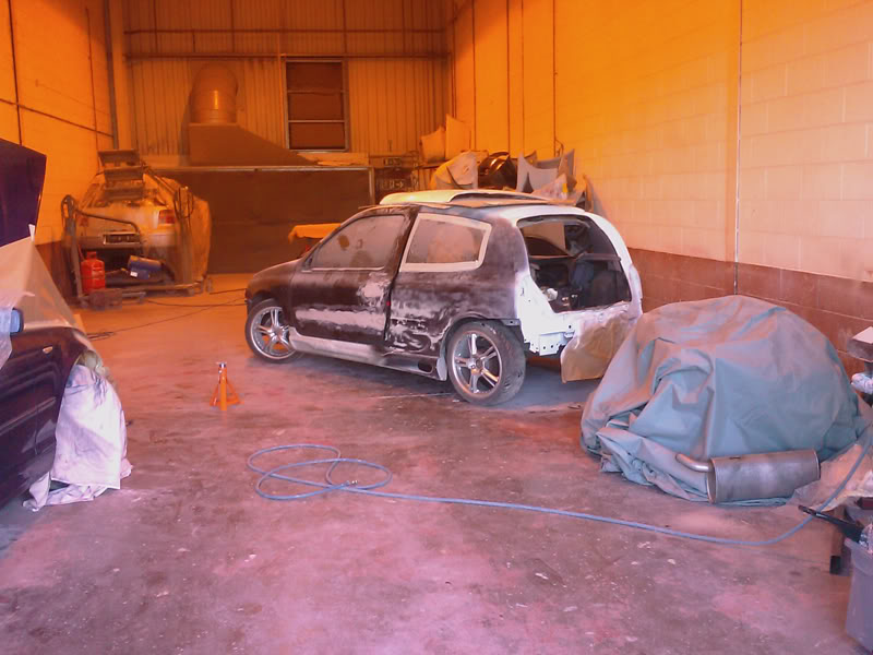

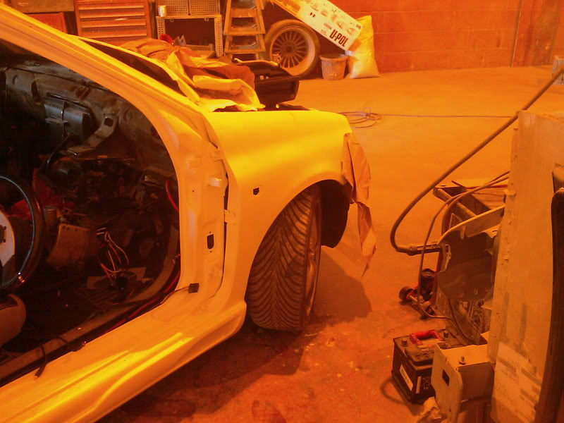

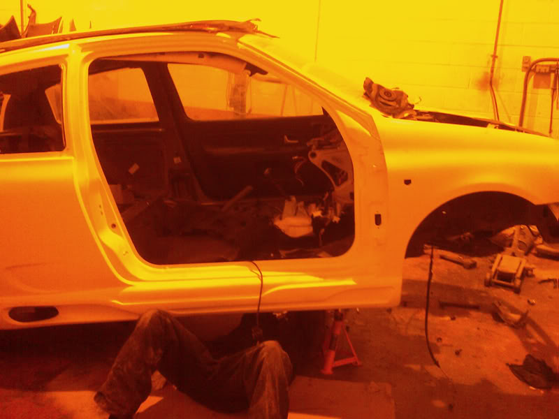

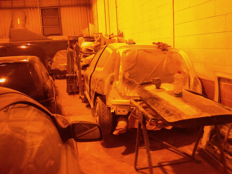

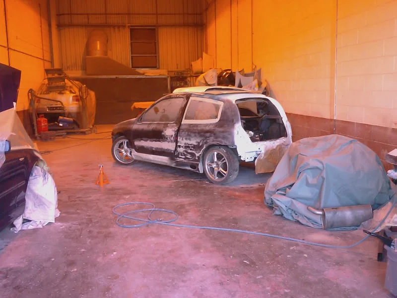

And so we return to the 1.2 in the body shop. Firstly the roof got sprayed.

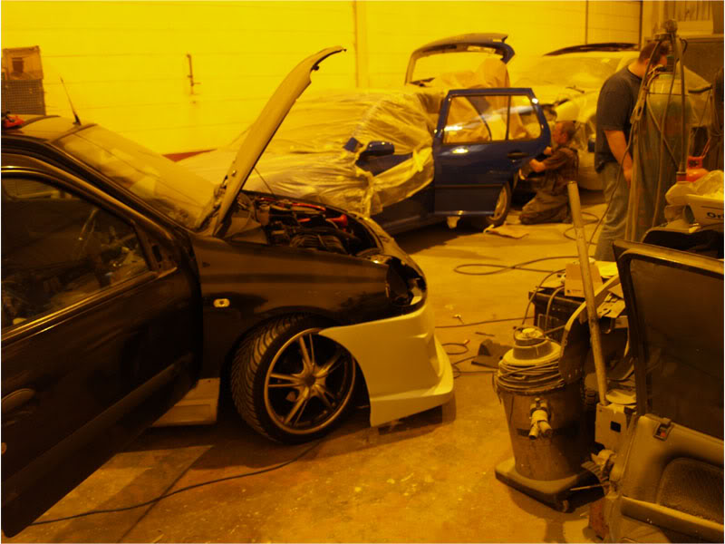

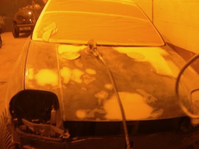

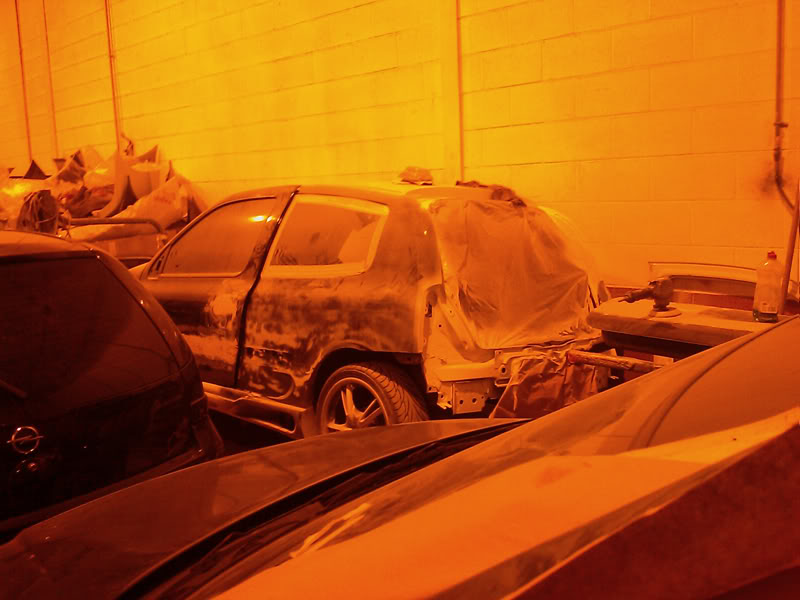

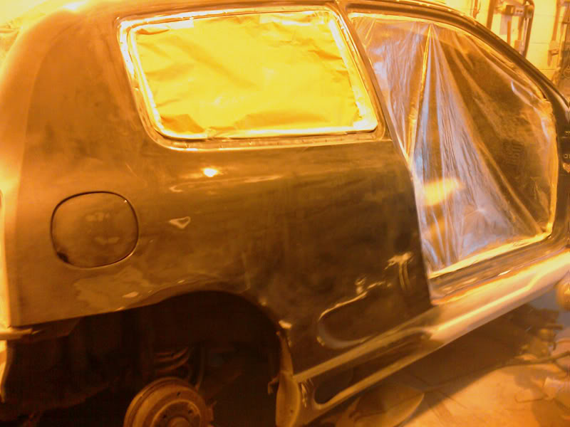

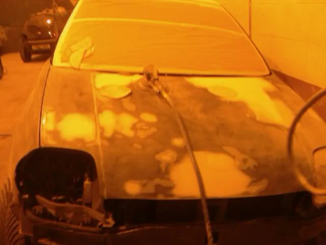

I decided on trying to get as much smoothed as possible. So I asked the sprayer to flush out the Renault badge on the bonnet.

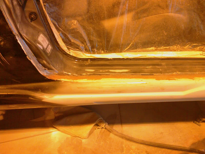

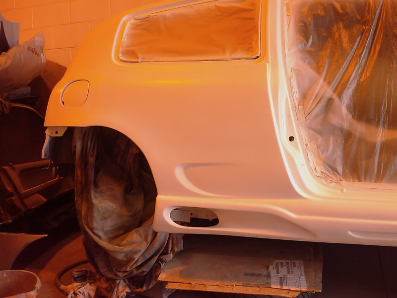

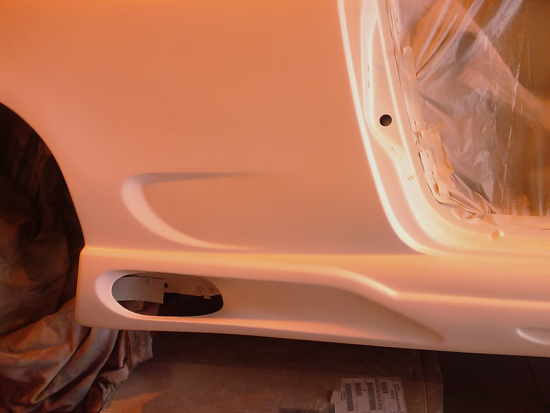

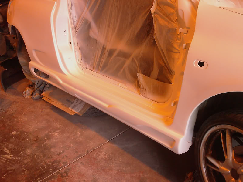

Work then moved on to the side skirts and trying to blend them in as best as possible. It was imperative that the side skirts look as OEM as possible.

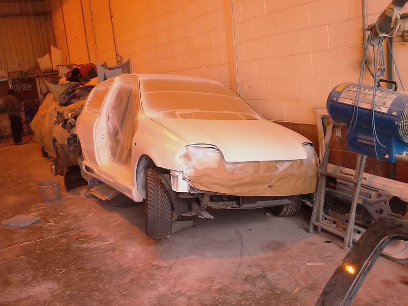

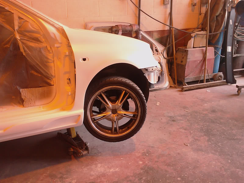

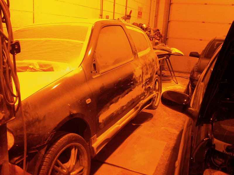

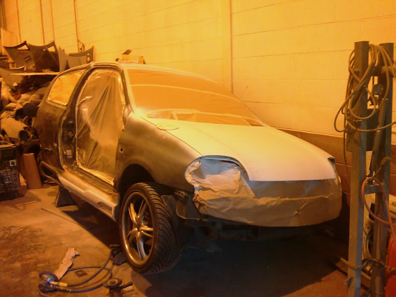

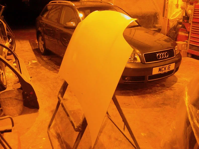

A week later I return to the body shop to be greeted by this :D
This is just the primer but I am absolutely astounded by the quality of the work, there are absolutely no visible join lines for the side skirts.

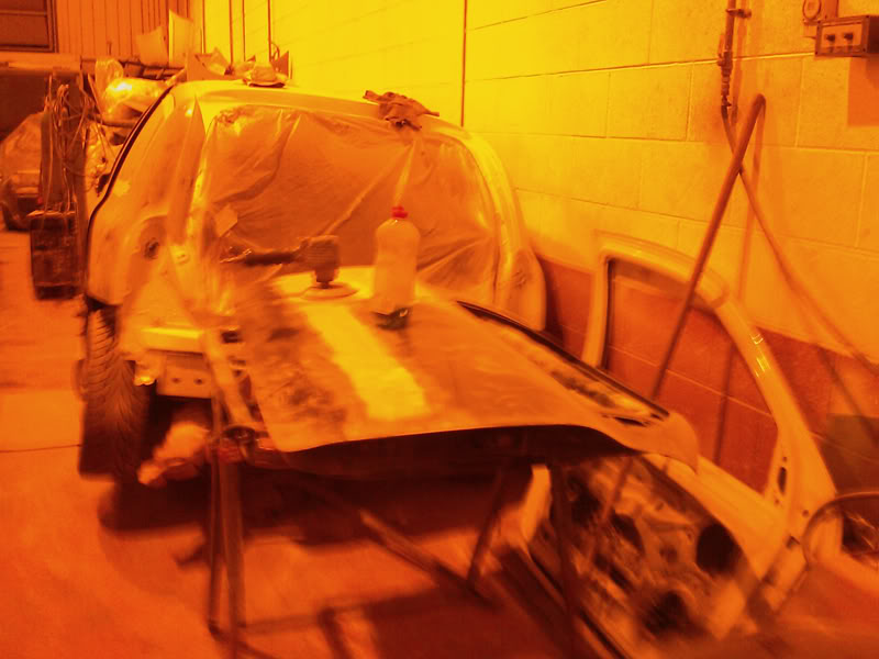

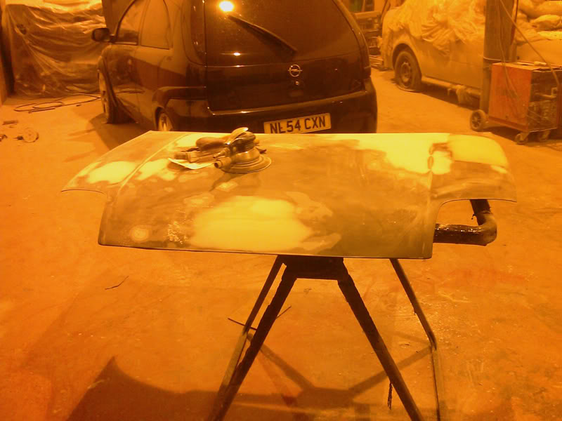

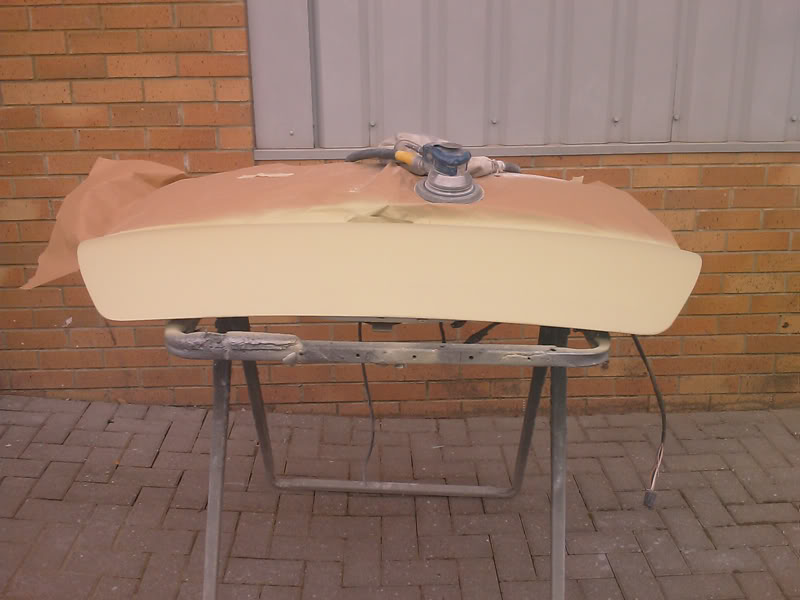

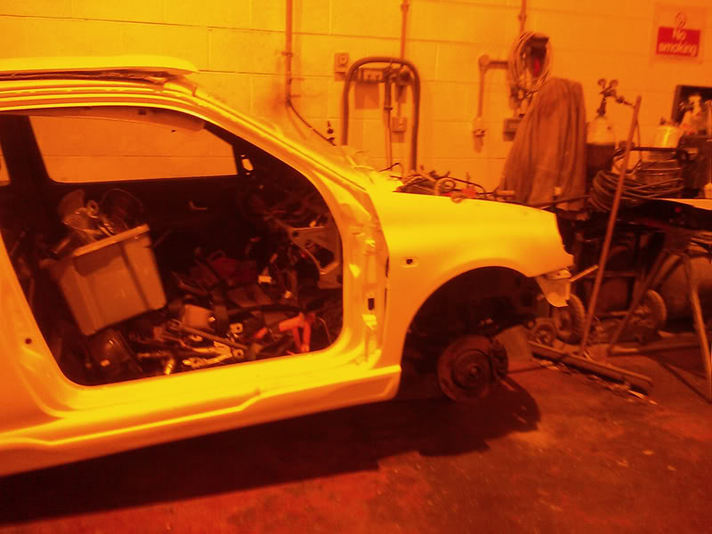

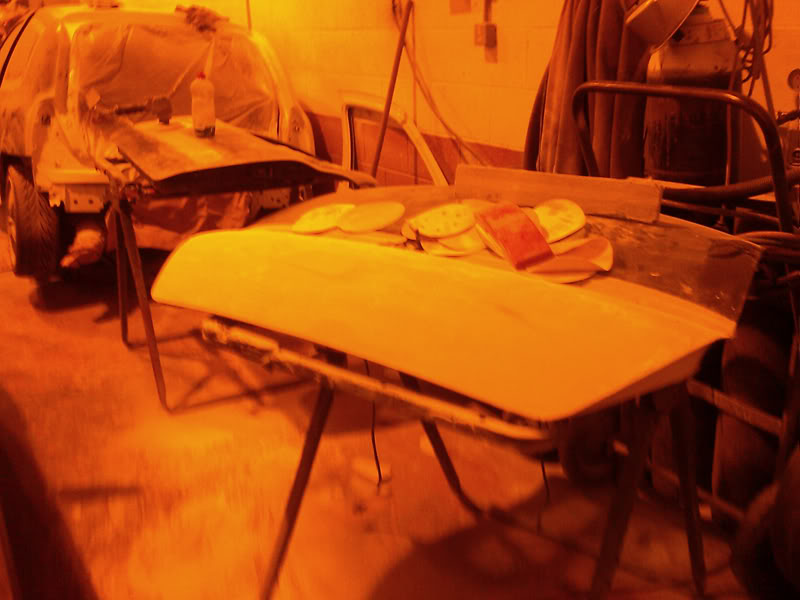

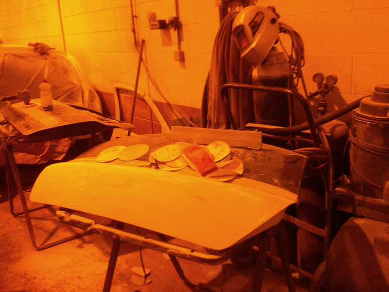

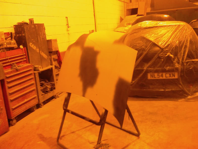

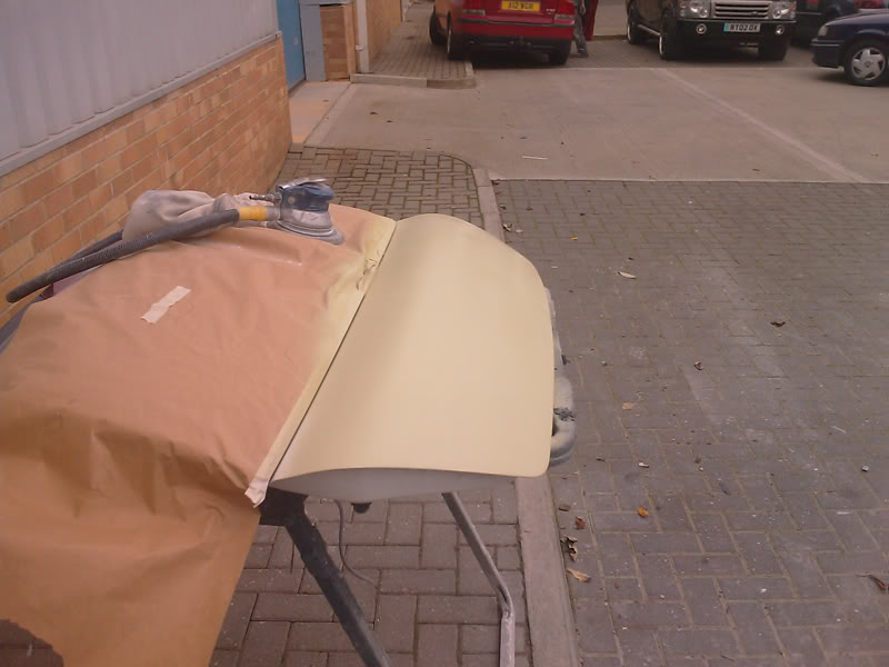

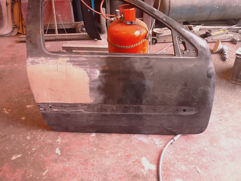

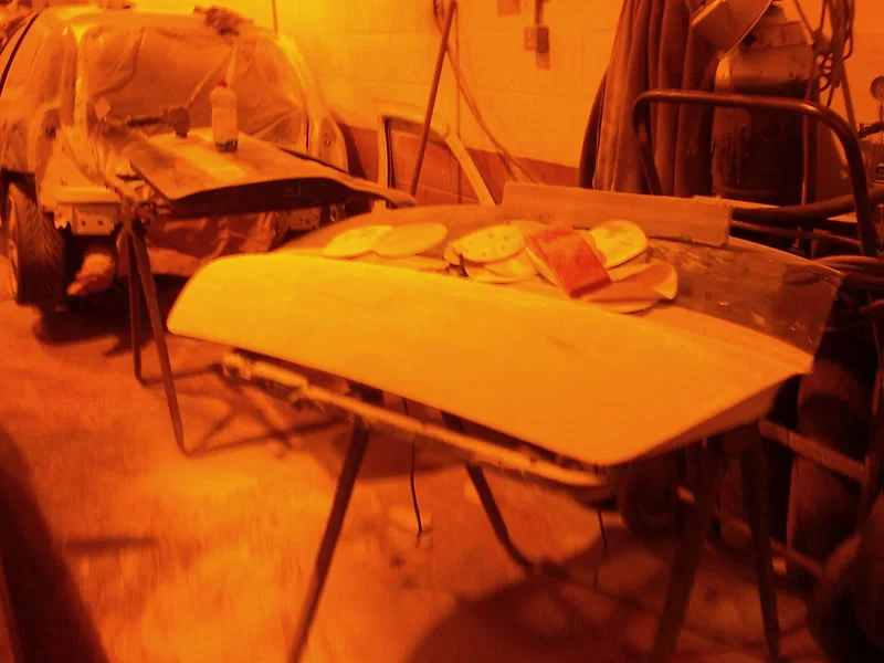

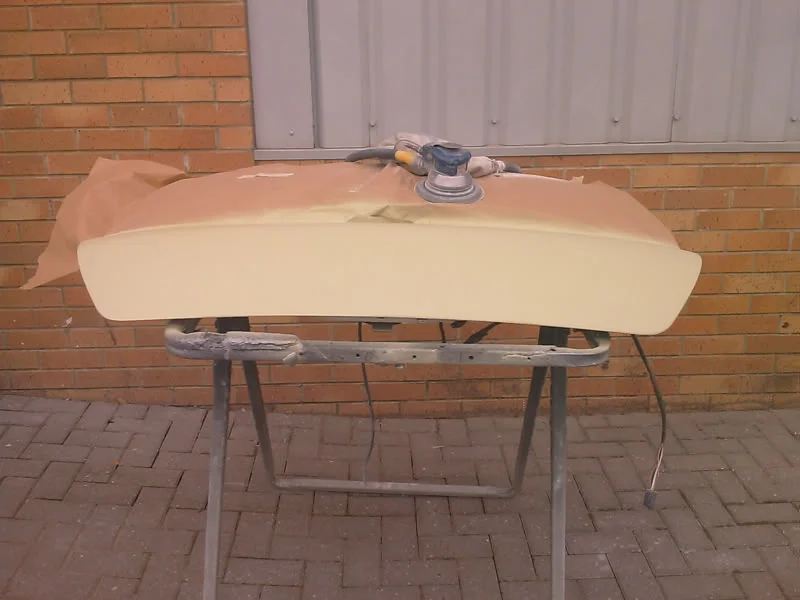

Next Jeff moved on to the doors and boot as I stipulated I would like them completely smoothed.

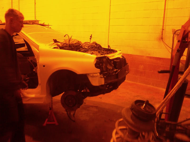

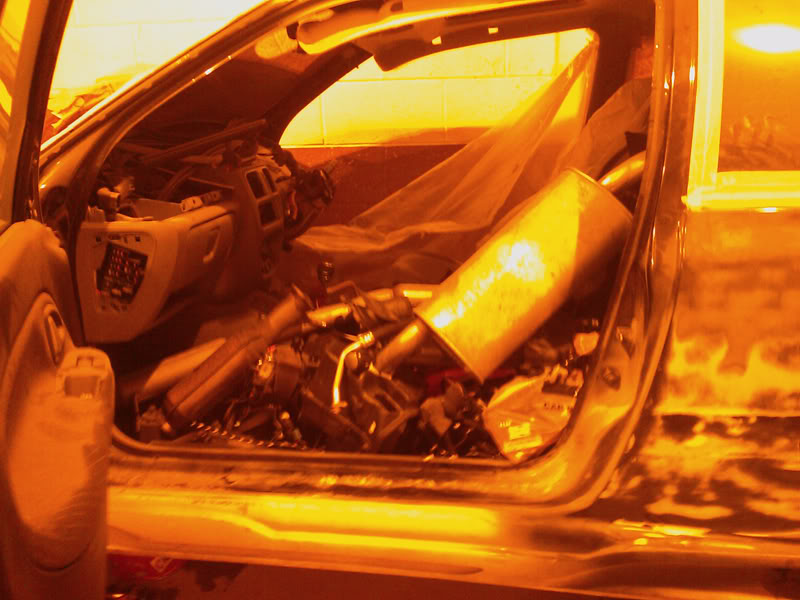

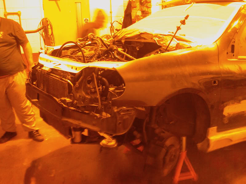

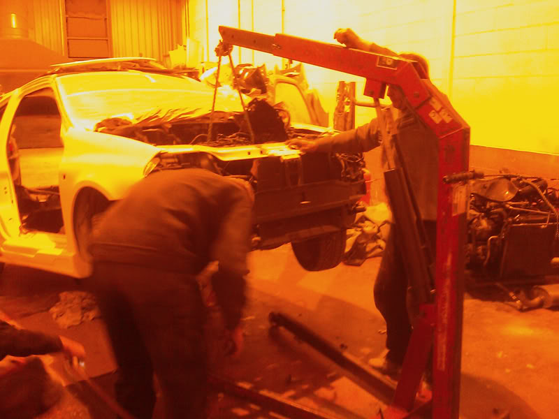

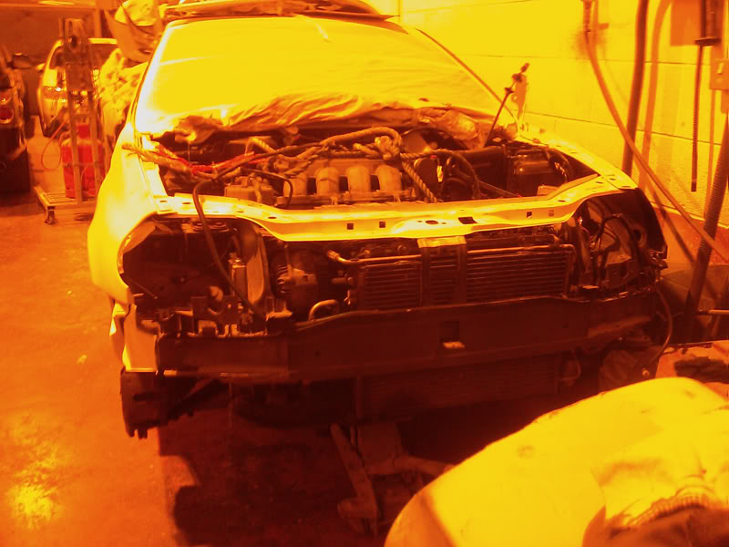

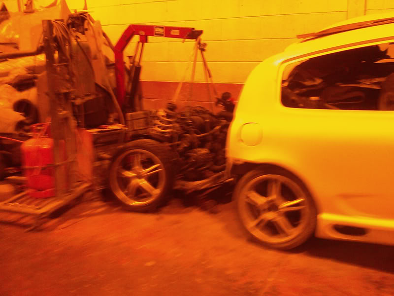

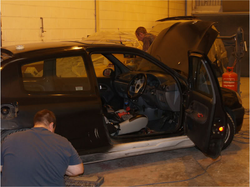

Once that was all done my friend helped me crane the engine down to the body shop and I began stripping the 1.2 lump out of the car.
We loaded the inside of the car full of parts lol and left it for a night.

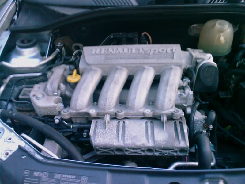

Next night after work we returned and got the timing belt done on the 172 lump. The previous owner had not taken care of the engine to say the least and the inner shaft on the driver’s side was split and the inner cir clips on the passenger side was out so we needed to reconnect the shafts.

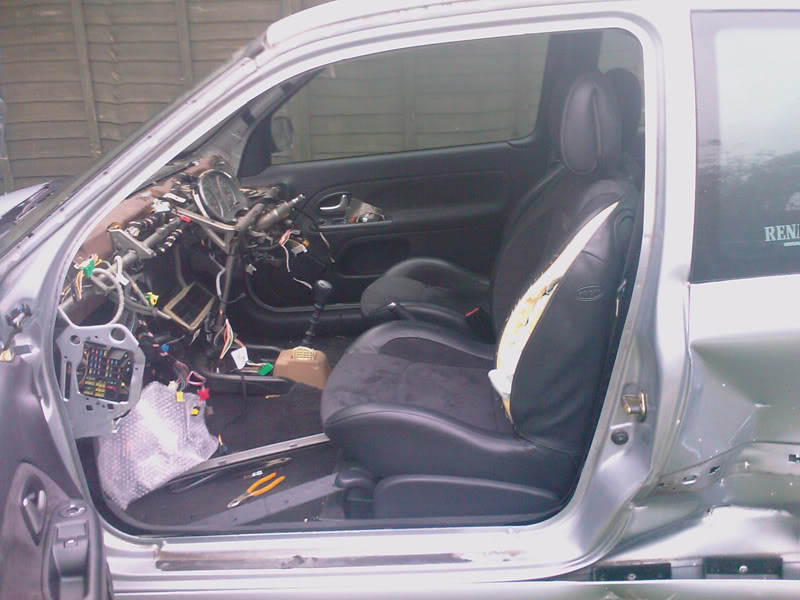

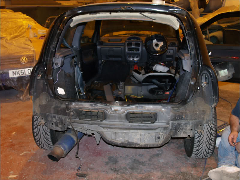

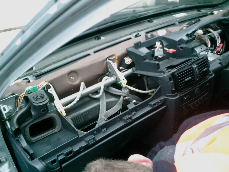

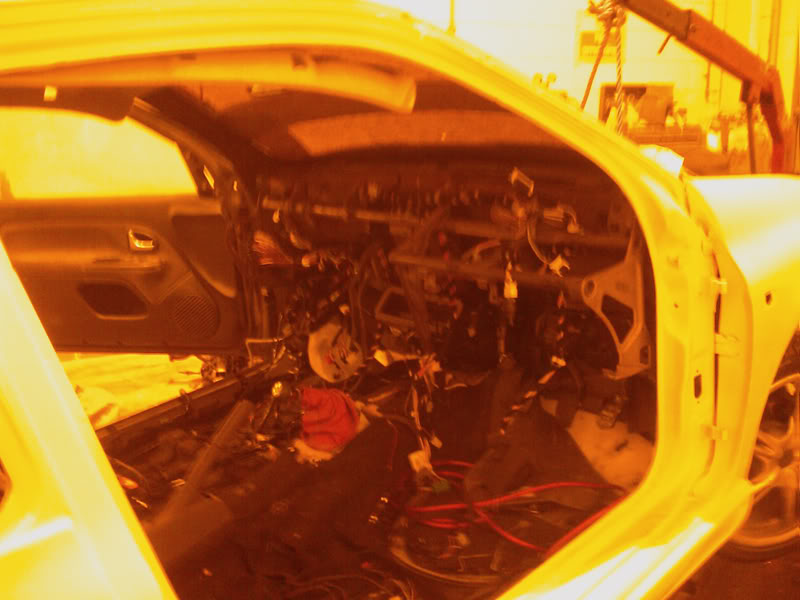

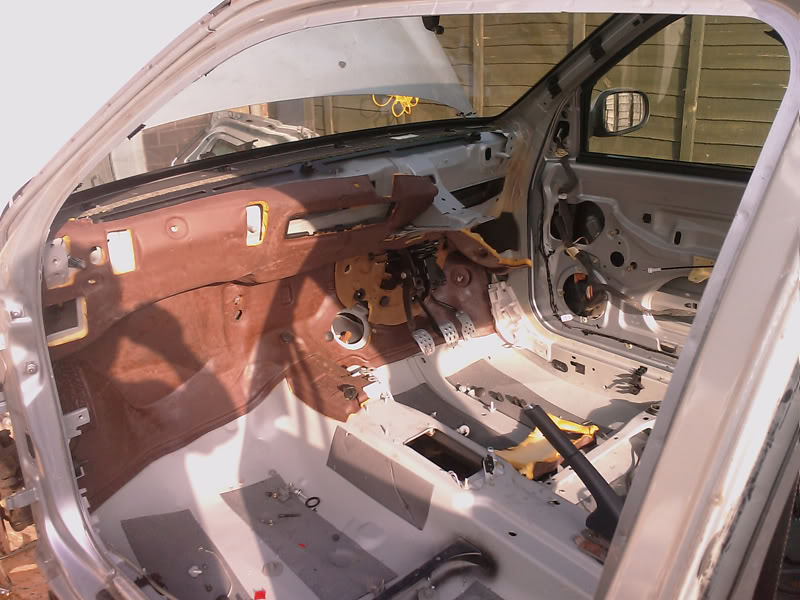

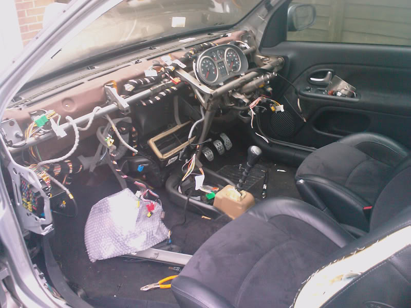

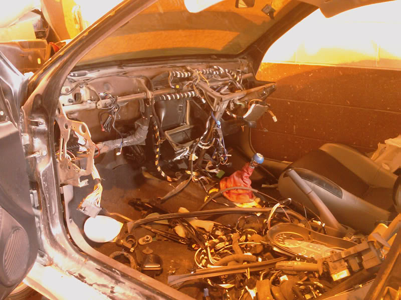

I began working stripping out the interior ready to put the new loom in and began turning the car round ready for this evenings work.

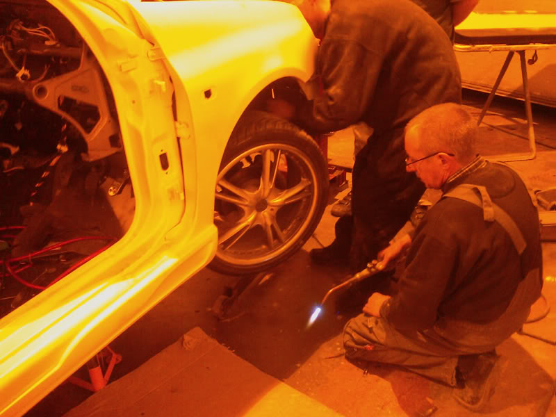

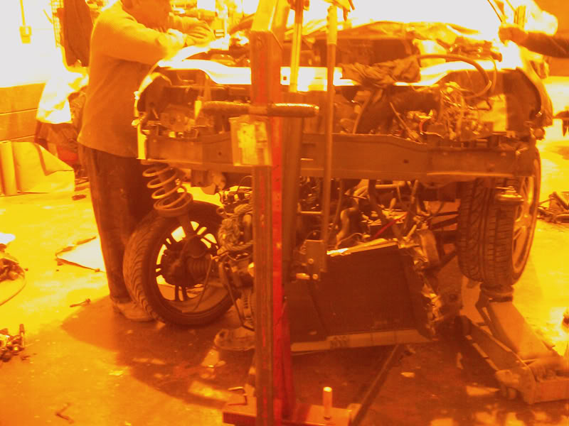

Don’t let anyone tell u getting those damn sub frame bolts out are easy. In typical Renault style there is a nut and bolt, however the nut is welded with a _o_ sort of system, the nut has 2 metal lugs which clip to the chassis. The only problem is they can’t withstand the torque needed to loosen the bolt so the result is that the nut spins. This is nothing the blowtorch doesn’t sort out though.
Whilst those 2 got on removing the bolts I began refitting the new interior wiring harness.
We packed up for the night and put the old 1.2 engine in the corner.

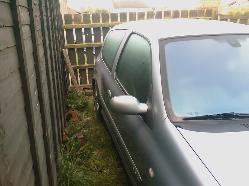

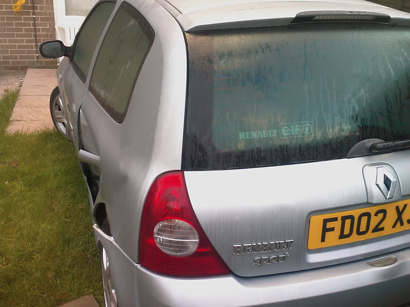

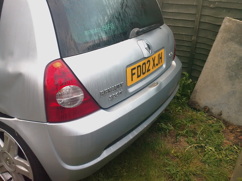

why did you smash the rear windows on the 172 btw?
I didn't someone else thought it would be appropriate to climb over my rear fence, and have a bit of fun smashing things up on the car. not impressed but what can ya do. Atleast the windscreen hasn't been popped as I could do with it for the sensor.
It looks like only the offside one is smashed, and that the nearside was removed succesfully, and guessing the offside one wasnt!

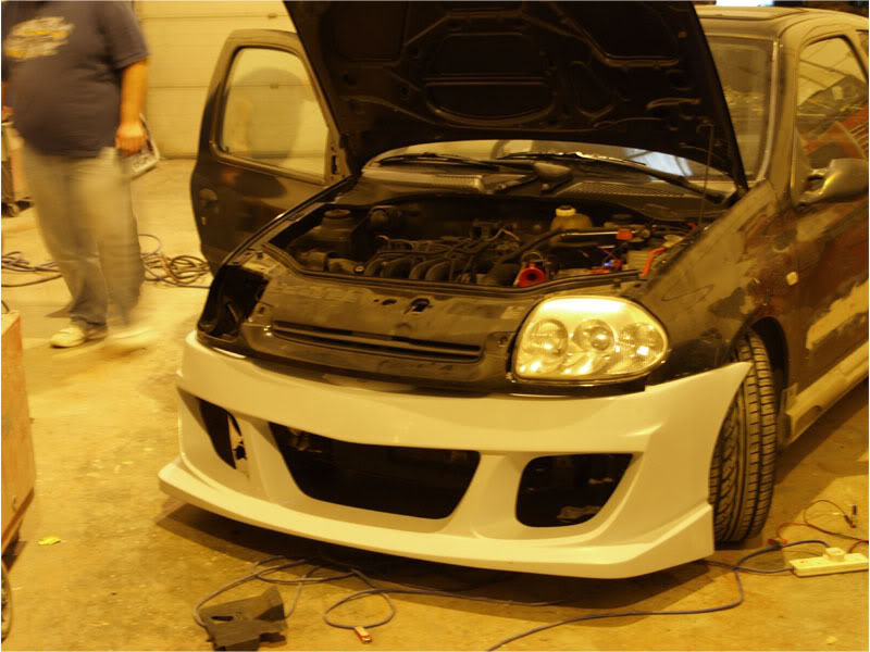

if you're talking about the front bumper then its gunna be a damn sight more OEM. it looks f**king gash at the moment I would agree. but just wait and see. that plus the side skirts are the only major visual diffrence to the outside.
because its going to be cut to fit the lines of the car a lot better. its made for a mk2 ph2 but mines obv ph1 shape so I was hoping for a 1 off car just wait and see ;) theres a lot thats being done that hasn't been posted up. Lilliput is a clue :p

Why didnt you weld up the smoothed bits first? The catty will sink and crack fairly quickly Id imagine. And why did you only paint 1 side of the car at first? Its gonna be a b**ch to get the other side to match well.
Cattytastic.
it's a bodyshop, every single part has had plates welded... the only photos showing shocking bodge is what the horrible old bodyshop done which has been replaced. the painting is just primer and buildup. so it's fine what hes doing hes levelling each side then hes gunna do the real spraying.

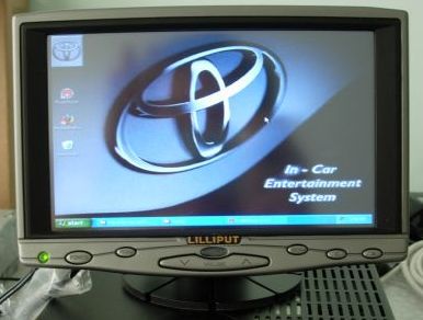

I had already sourced:
It's a Lilliput 619, 7" Touchscreen XGA monitor, takes VGA and 2 RCA imput's, I've had this for circa 1 year but the fun is just begging, I've taken the shell of the monitor to the bodyshop to be fabricated into the dash to look completely OEM.
This will be the basis for my Carputer which I've already purchased.
I've got a photo of me playing WoW on the monitor somewhere and some new photos to upload but I'll do that another day.
So heres the spec of the Carputer:
Via Epia M 1Ghz PC,
1GB Ram
250GB IDE HDD
M2 ATX Intellegent PSU
The PSU is specifically designed for car applications as PC's only run on 5V and 12V it wouldn't make sence to take the ~15V from the car transform it to 240V then back to 12V so the PSU is super efficient and controls the startup & shutdown of the computer automatically based on the voltage.

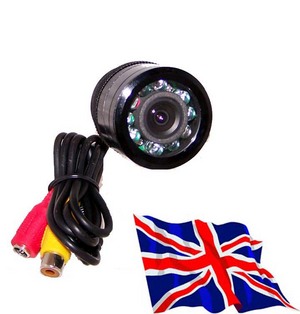

A long side that I was very worried about potential car park dents appearing on the car once shes finished, It's very easy to park up and some careless individual smacks my door...not good if its full of filled and not cheap to fix either.
I pondered for a while over a possible solution and decided I needed to source some camera's and determine there appropriate location.
Fleebay sold me some Infrared camera's, 2 bullethole ones and 2 bulky ones. Luckily the bullethole camera fits perfectly in the rear tailgate where the wiper used to be and covers that hole in the plastic nicely :)
One's to go in the front bumper and the other 2 are getting moulded into the mirrors. so they will be able to capture number plate + said incident.
