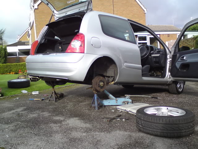

Had the day off uni and got bored, so did what everyone on here does when they have a few hours to kill...
comments welcome folks =]

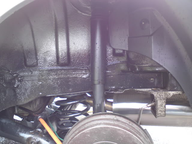

Ha yeah plan was to paint the drums and calipers though hence reason for the big anal clean but rain stopped play =[
good effort mate, looks very good. desperately need to do mine, but with it being winter i cant be bothered:(

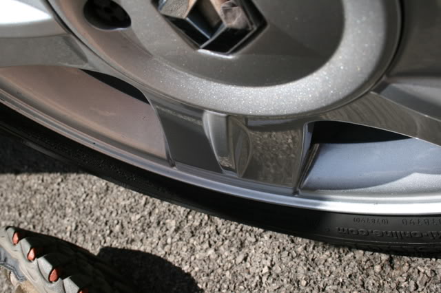

Good work with the cleaning, not so good work with the sandles :dead: trainers or pumps FTW (in this weather too!)

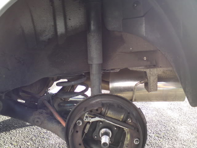

Good job, Is there any way you can tighten up the rear drums brake shoes, whilst the rear drum is off? So the handbreak works better?
I think the exhaust needs to come out to do it :(
Yes mate, take the drums off, and you can see the pistons that push the shoe's into the drum? (see the pic)
there is a little ring there that will click over (spinning it towards you)
just rotate that and keep offering the drum up untill it's a tight fit.
then attatch drum and your away.
Is there no guide for this? as i could do a more detailed one if needs be...
