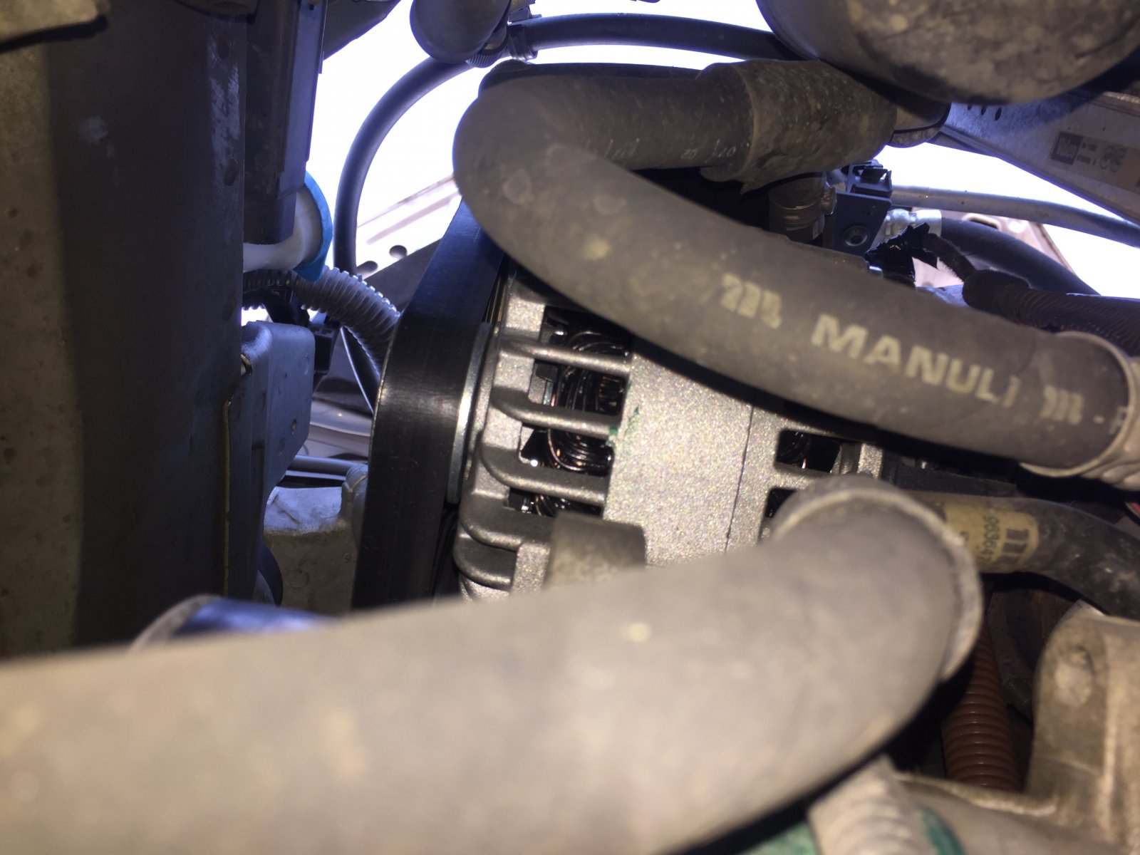

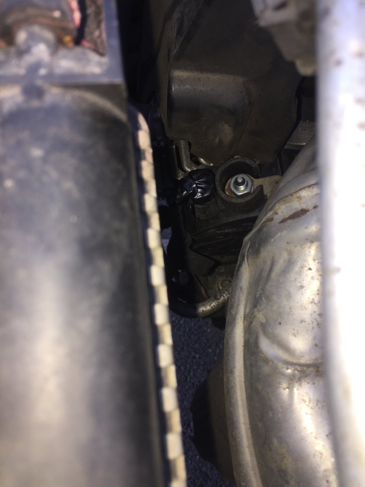

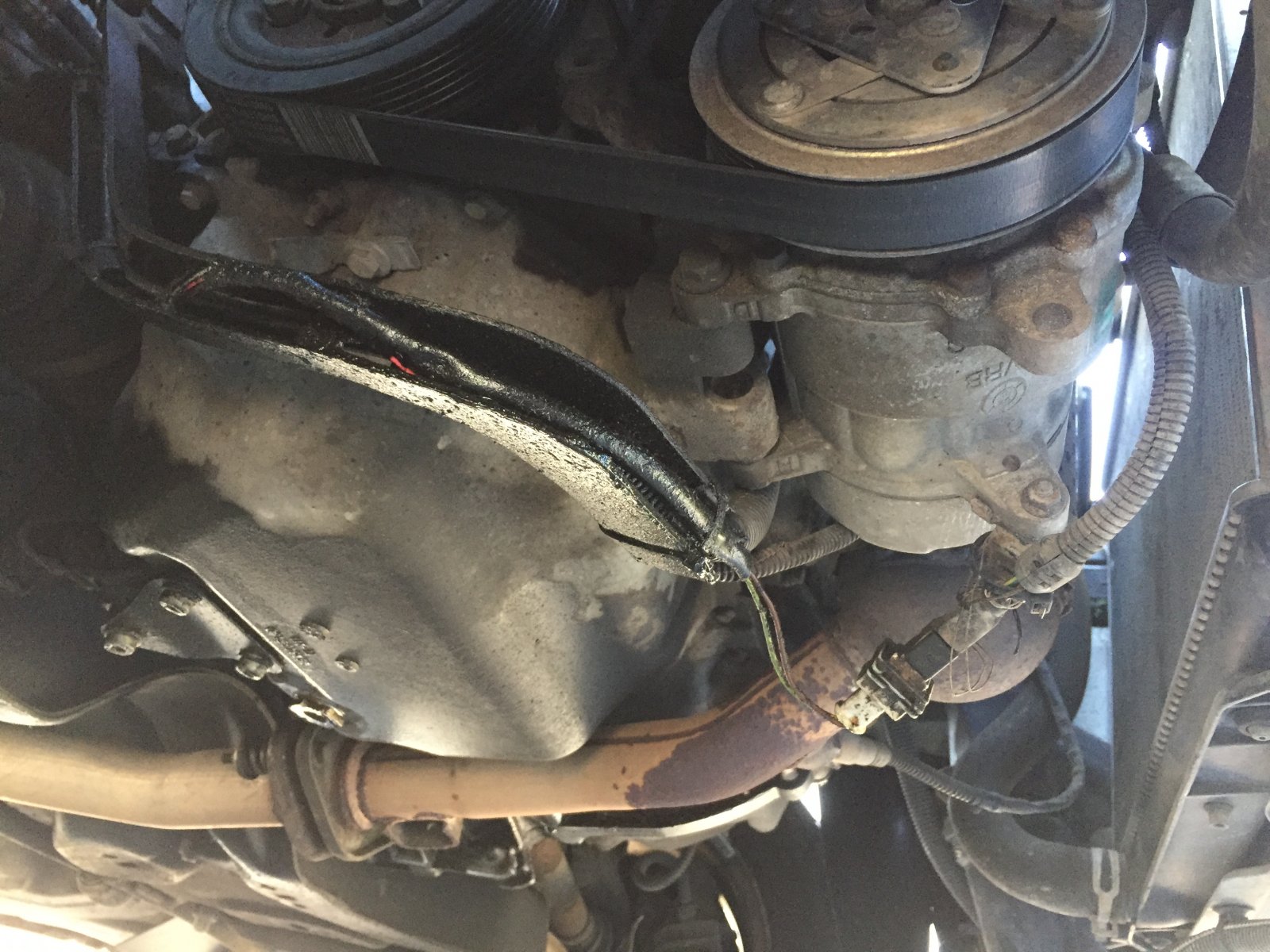

The AA man put the black tape on, but these wires under the car seem to be going to the alternator and dont exactly look secure!
Ex-User (72296)
  Clio 172
It broke down again shortly after, got it recovered to Rentech, the legend, he replaced the plug which goes into the alternator as that had seen better days. But ir broke down again, so the issue must be something else.
