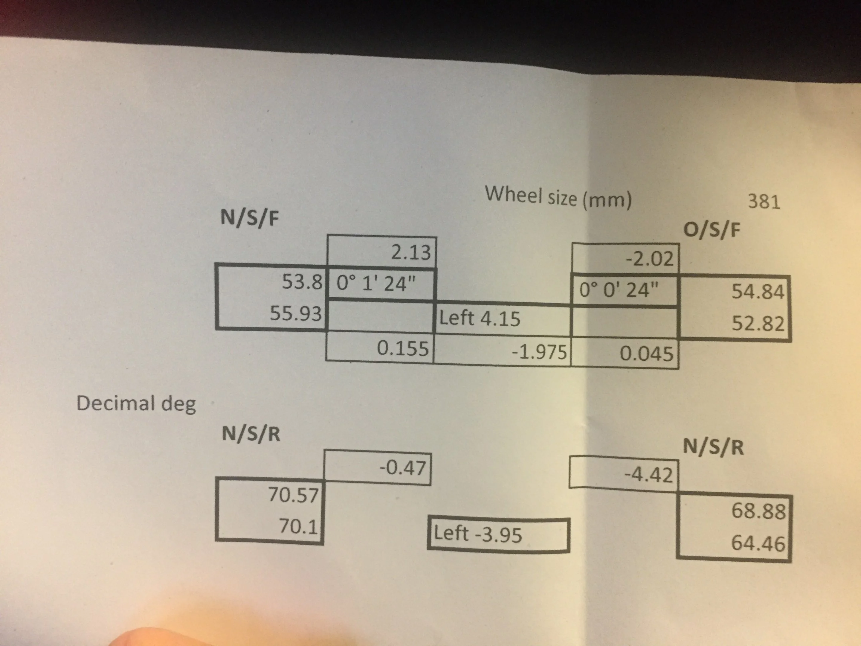

Checked the tracking again last night. I strung the car on Saturday and did it with a 0.5mm accuracy ruler. Yesterday I did it with vernier calipers which read to 0.01 mm. It only needed some small adjustments which I did on turn plates. There is some improvement but by no means is it gone.
Correct though there is some rear thrust angle which hasn’t been resolved ever. It’s static though.
Tracking results from last night.
Strings fine have you looked at the rack as its the only thing i can think of
