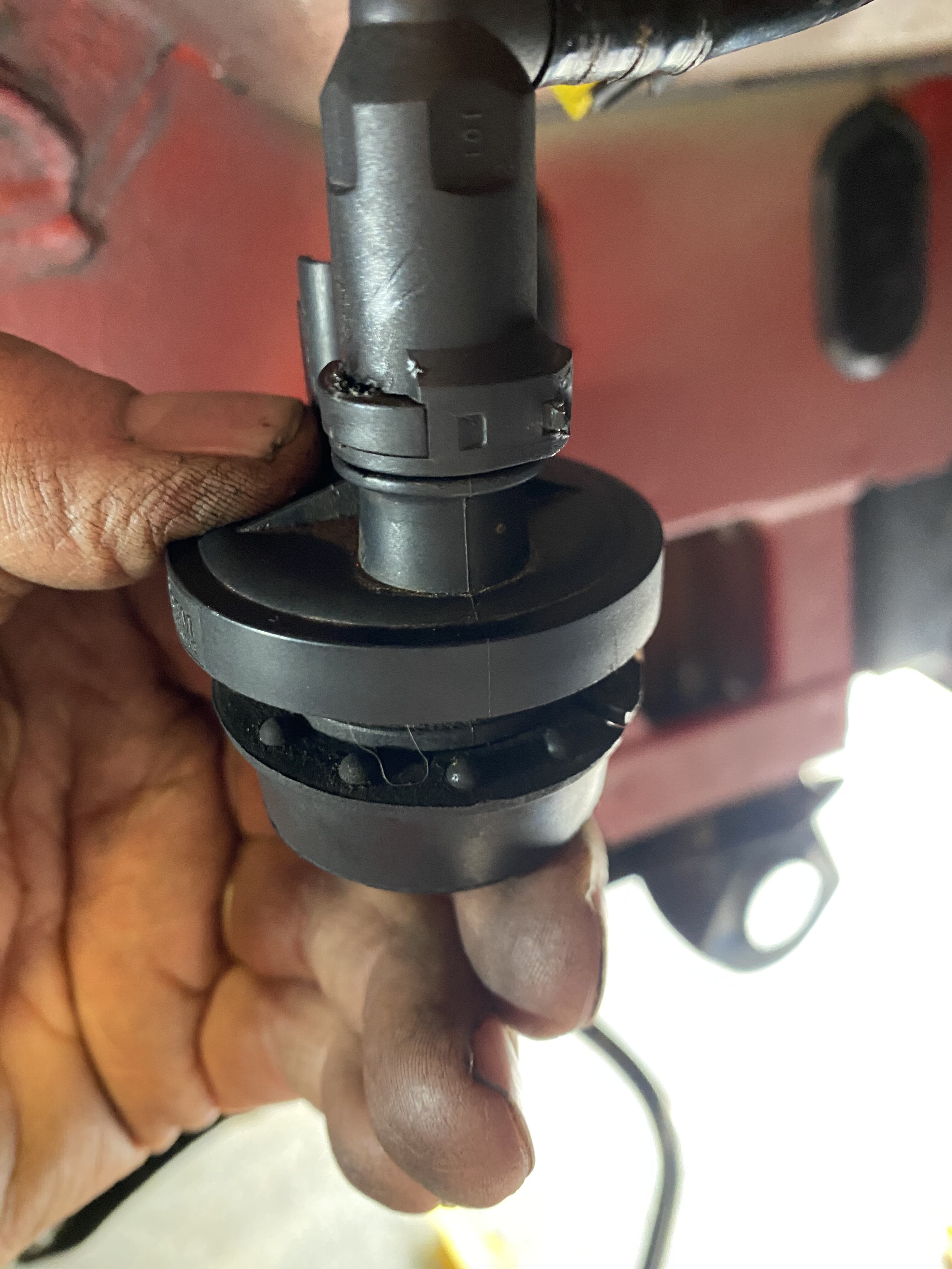

Struggling to get this clip off the purge valve; is there a particular method as I don’t want to force it and break the plastic cap.
Thanks

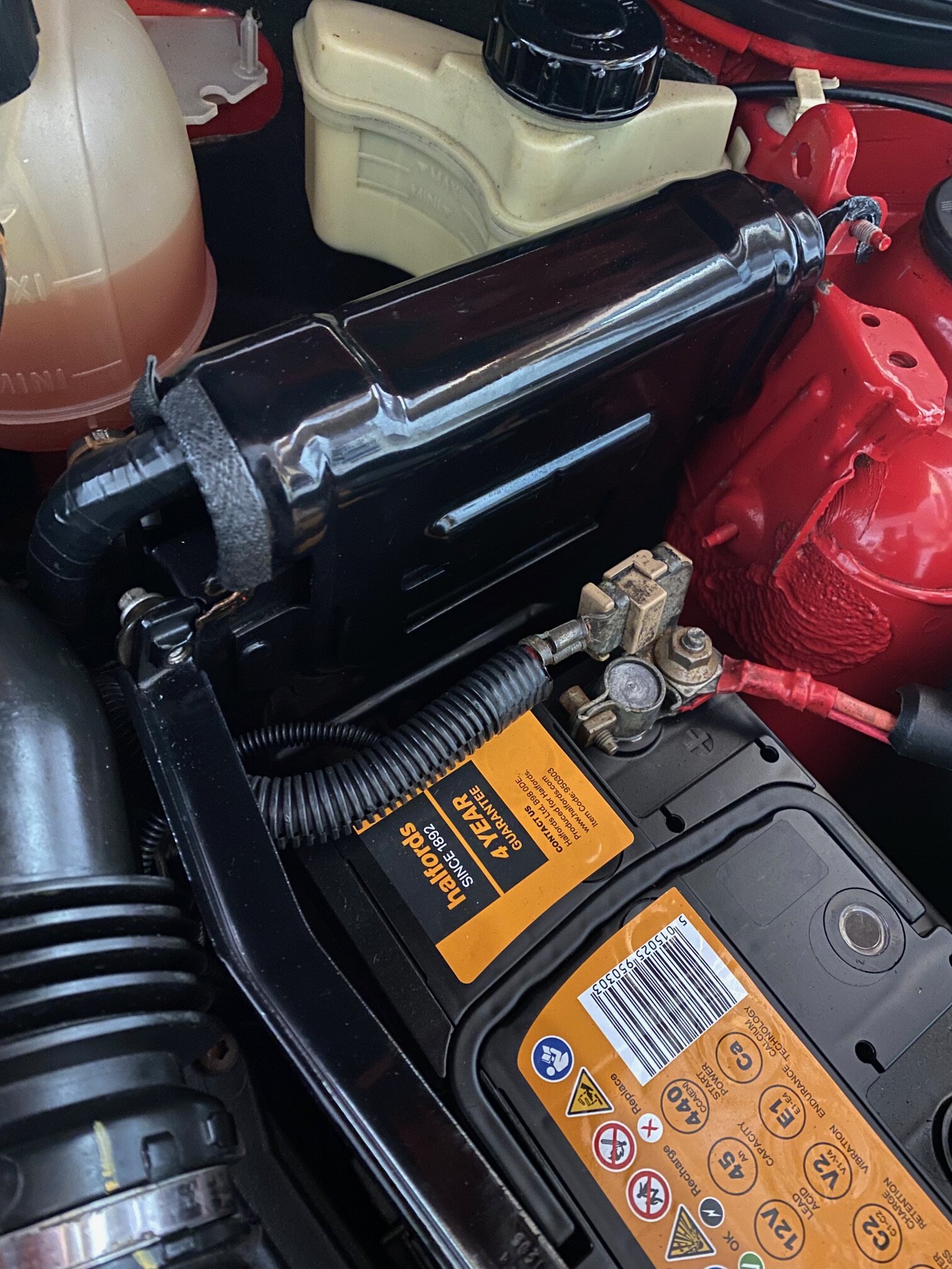

Thanks for that; what does the 3BB mean for the colour? Also, I assume the battery has to come out to remove the ECU; see attached photo. Is pin 8 obvious when I get the cover off the ECU? Sorry for all the questions but I'm a bit of a novice when it comes to Renault's, grew up with classic Mini's so it's all a bit different!
Thanks
Battery can stay. The metal cap comes off top of ecu holder (can be very stiff). That will expose ecu connector block.
No idea what colour codes mean, thats just what ive seen online and copied it in. But numbers are shown on the ecu connector.
