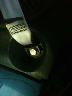

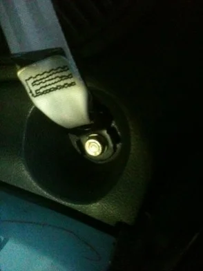

The picture on the left goes on the window side under the seat cushion. The sticky out bits go in first with the main loop pointing at 10ish. 18mm bolt iirc. Not sure what the second on is from.
cheers, i have looked everywhere and can't see anywhere that the part in the pic on the left can go? there are no holes that the sticky out bits can go into under the seat cushion (or rather i can't find them!). as for the pic on the right i'm sure it goes at the top of the passenger side where the seat belt comes out to attach to the roof for the middle belt but can't work out how it's meant to be attached :S most annoying.
It's not under the seat, it's at the side of the seat. In the plastic trim there is a how for it. Hard to miss really ;) I'll be removing mine tonight or tomorrow, so if I remember i'll take a piccy for you.
The first one is on the door card.

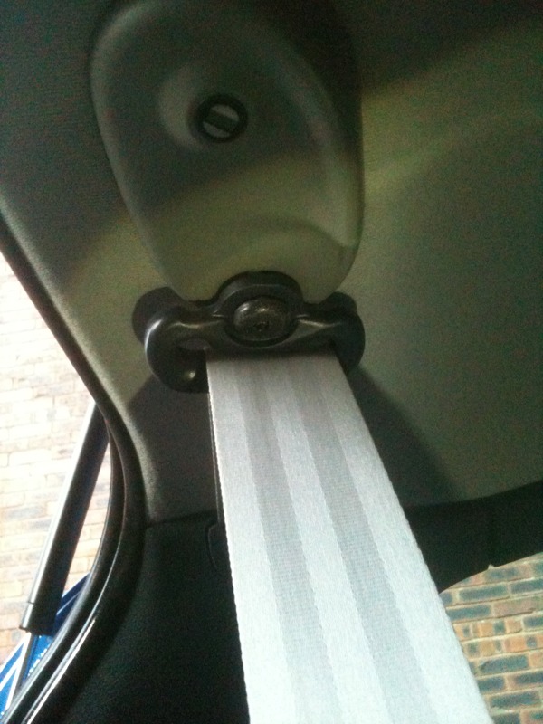

The second one, if it is the top of the rear middle seat needs to go in the roof. There should be a small plastic trim piece you need for it, depending on how far you went with the strippage you might also need to put a small metal bar back in too.
cheers for that, yeah i have put the plastic bit back on the roof i take it this needs to be bolted on there? i have the bar to put back on too. where does the bar go?

17mm for the one next to the speaker ;)
