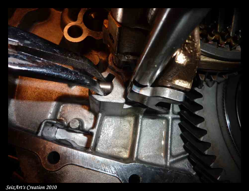

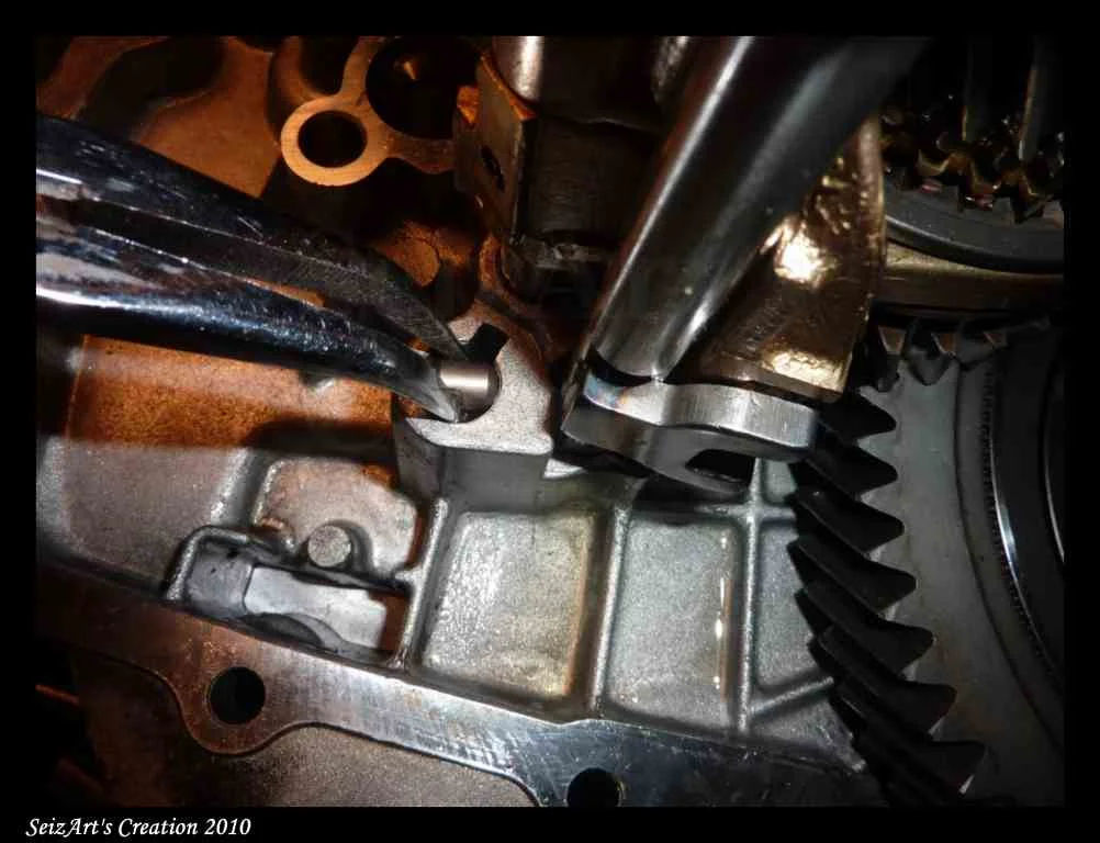

I had the same problem on Monday when putting mine together, you need to align 1st,2nd and third and forth selectors like this first

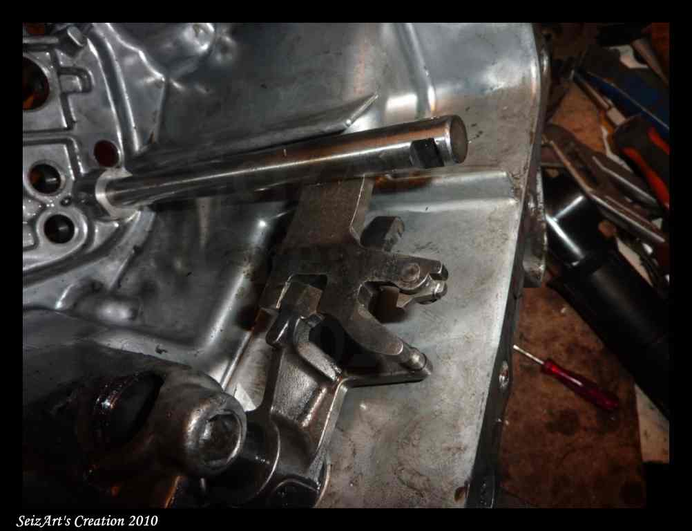

Then put the fifth gear selector in the top casing like this with it engaged before lowering down

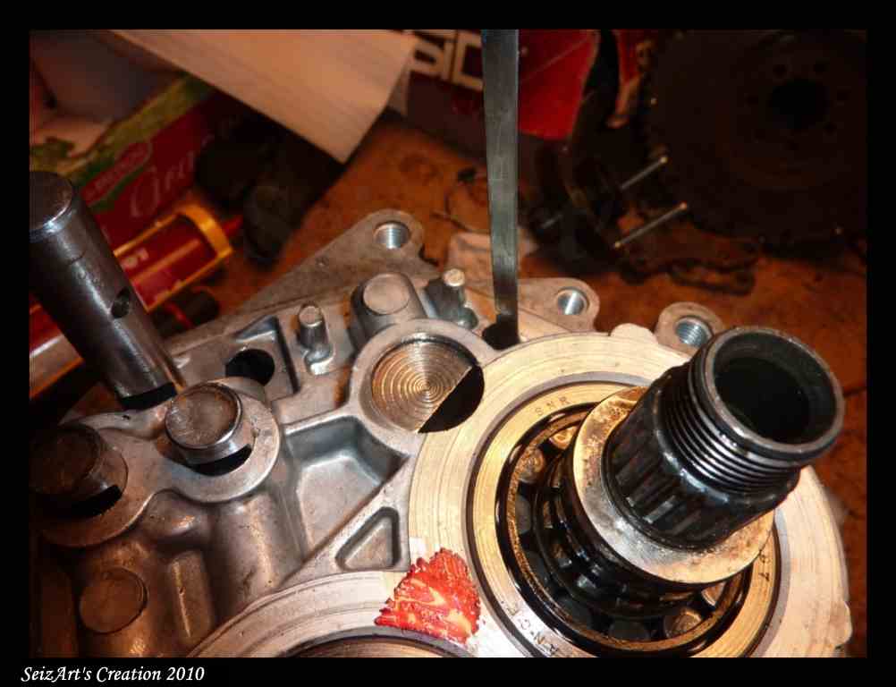

You will need someone to help you tho, will need someone to push the ball bearing detents in on the top with you hold the fifth gear selector in place.
Then make a hook and lifted the reverse gear once the top is on, don't try engage any gear until you have lifted reverse and place the last detent in
Once you've done that try engage the gears,
Took a few attempts but worked for me, it might not be the correct way but like I said defo worked for me :) hope this helps
this is how i tried it so i must be on the right lines , thanks for the info and pics much appricated mate :)
