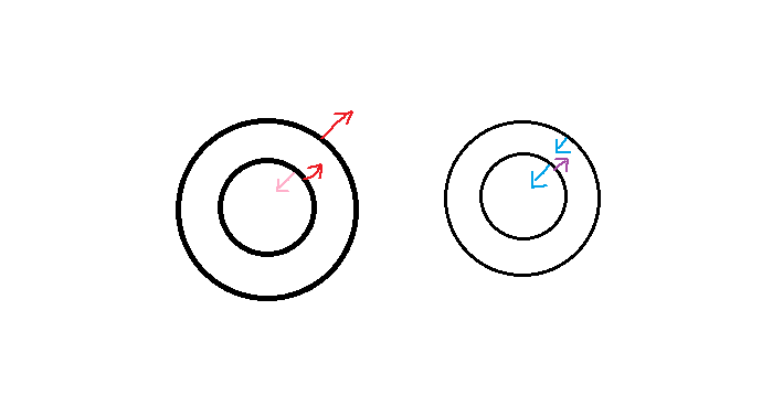

So when you heat it, it goes outward both ways and not inward. When you cool it, it goes inward both ways. But its both increasing in size and shrinking at the same time right?
No, it's not increasing and shrinking?

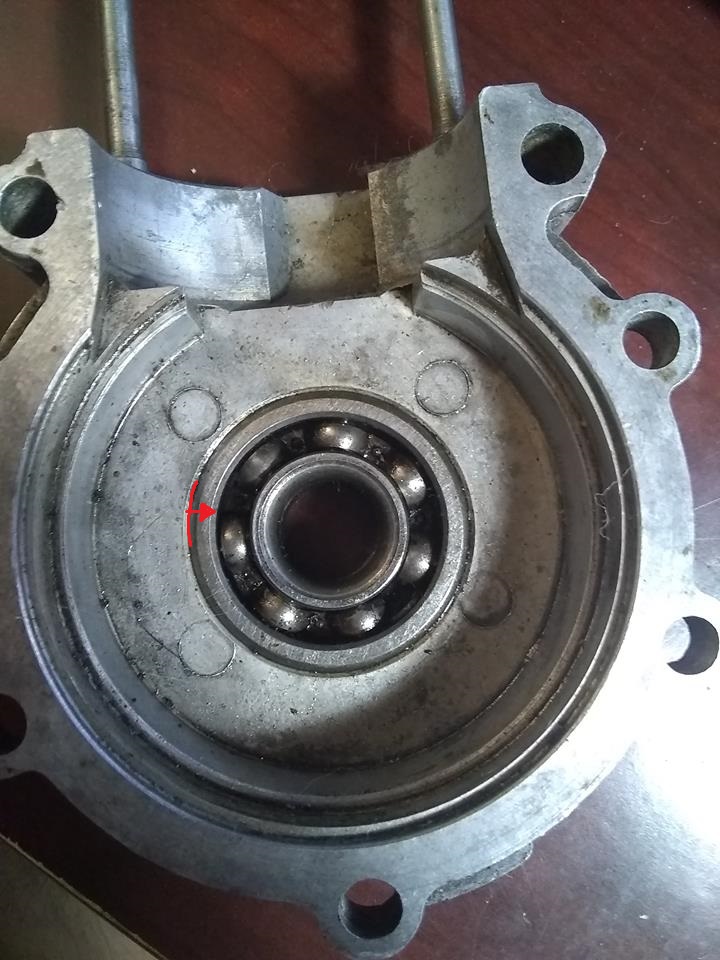

Picture on left which is what happens when you heat it right? You are 'gaining' size in the outer and 'losing' size in the inner part. Because what I dont get is you heat the part and you are not heating the whole casing just where the bearing seats, 'it gets bigger' for the bearing, but the casing would be losing its total size ever so slightly (the casing gets smaller by heating)
Imagine you have two doughnuts and you slice them up like a pizza. You take a slice from doughnut B and add it to doughnut A so that it has an extra doughnut slice.
Both the inner and outer circles of the doughnut have increased in diameter. Because they are hotter and have expanded

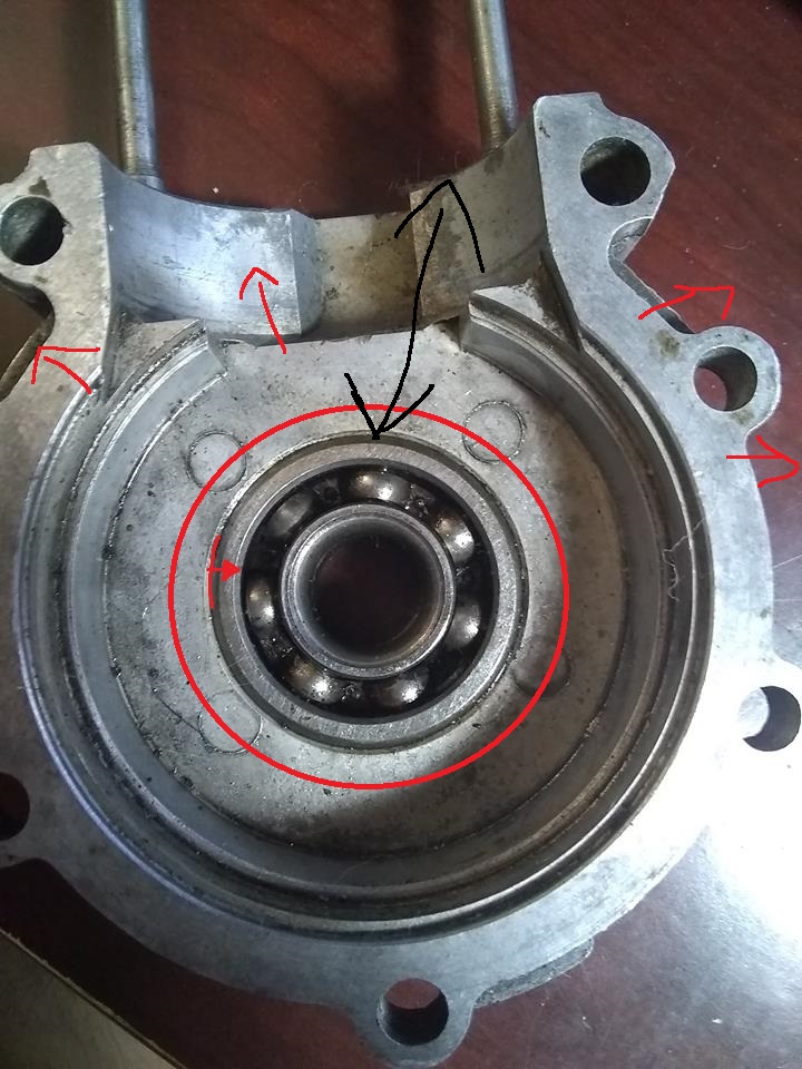

You would probably heat just the red circle area. Surely the whole casing wouldnt expand as the outer part is not getting hot at all. So the the inner point to the outer point (black arrow) is getting smaller.
The heat will transfer through the casing a lot. Then you have the different CTE between the metals. It cant contract with temperature, it just wont expand as much if the outer isnt able to move (not as hot).
If the heat does transfer a lot then that explains it.
