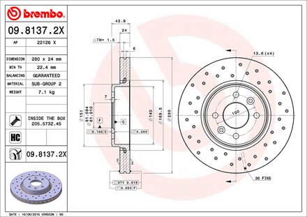

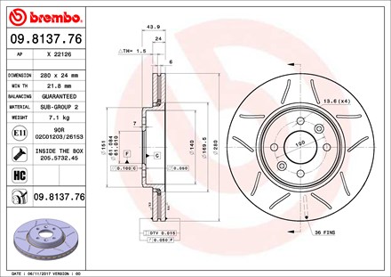

I've been on Brembo Max front disks since '09 and will be needing some more in the not too distant future - but i hear that Brembo are discontinuing Max them, although have launched Brembo Xtra range which seem identical but are drilled instead of grooved.
Any feedback on these yet or are people running other variations?
Brand part numbers
Brembo 09.8137.2X
AP 22126 X
Breco
Disc technical data
Diameter 280 mm
Overall height 44 mm
Centring diameter 61 mm
Number of holes 4
Thickness 24 mm
Minimum thickness 22,4 mm
Nm 90 Nm
Go to product data sheet
Brand part numbers
Brembo 09.8137.76
AP X 22126
Breco
Disc technical data
Diameter 280 mm
Number of holes 4
Thickness 24 mm
Minimum thickness 21,8 mm
Nm 90 Nm

Brembo Max have been discontinued for over two years now. The Xtra discs replaced them but they are serious money. George has a couple I think of the Max discs but I guess that shows the popularity when plain discs are so cheap and expendable.
