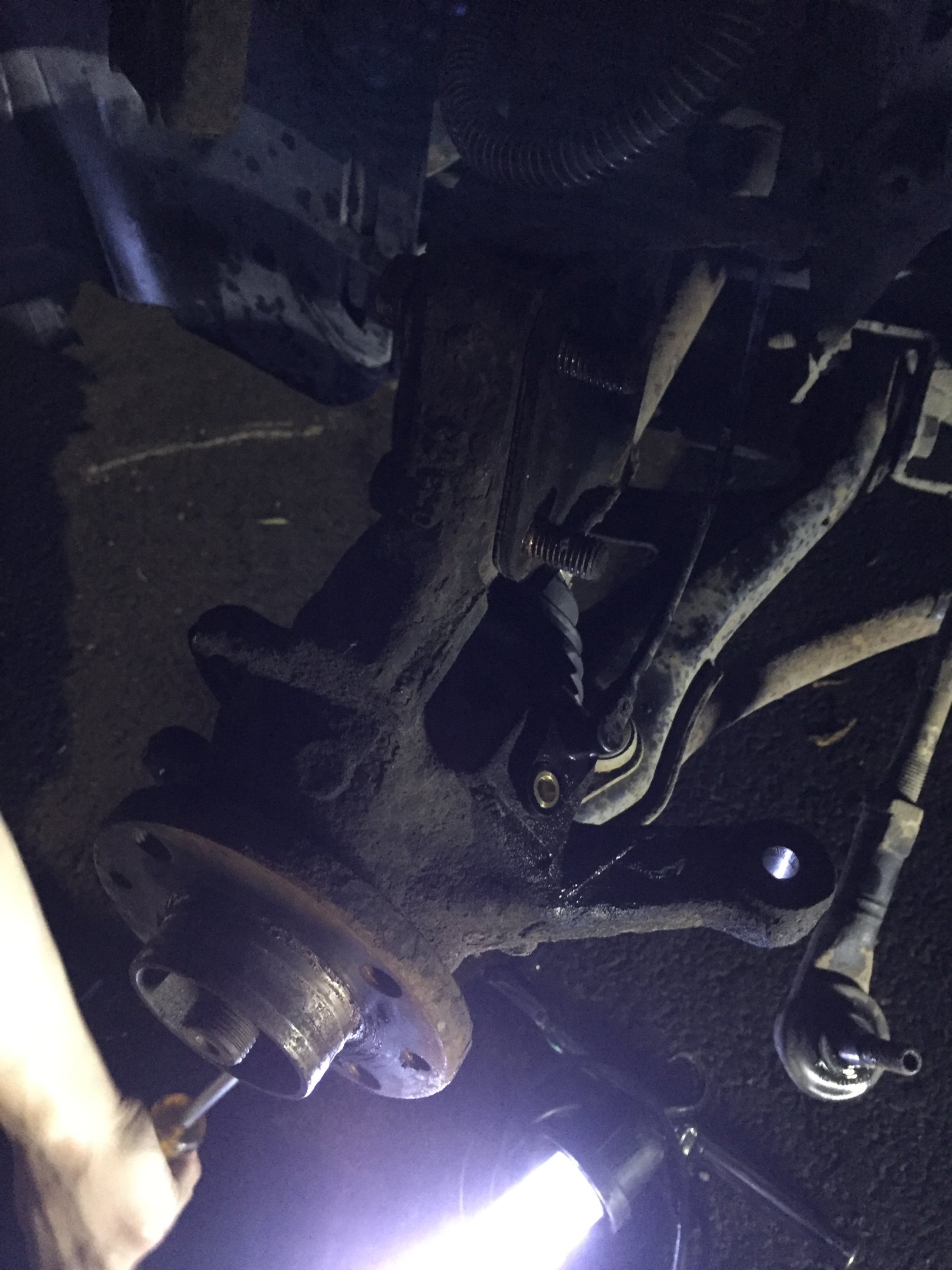

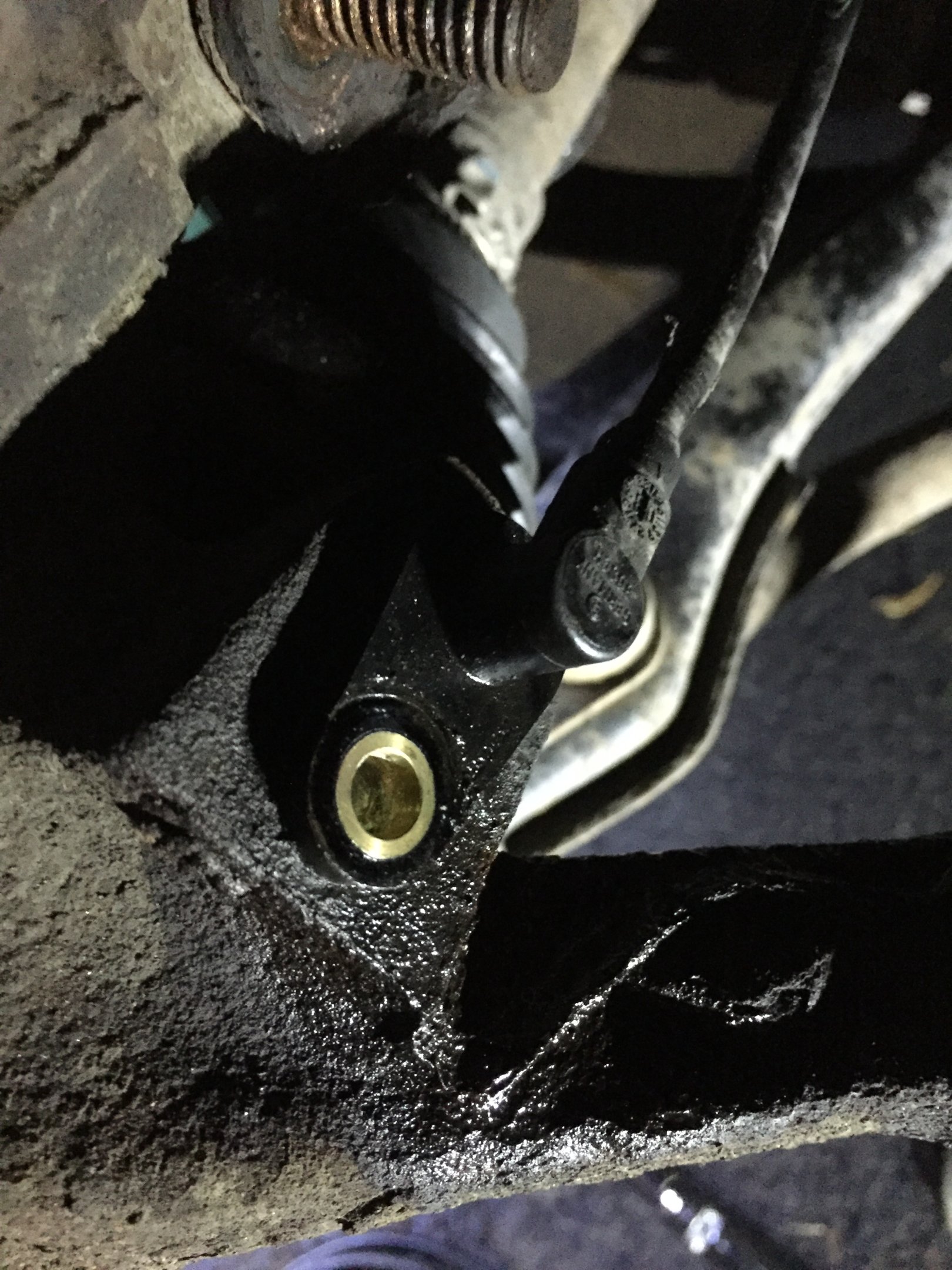

I've removed the screw holding it, but how do I remove the abs sensor? It's quite firm in there and I've heard they're expensive and Fairly rare in good nick.
Thanks
  Clio 172 Merc ML55
Plenty of wd40 or similar, give it a little while to soak in a bit and then try to gently twist with some grips. Be prepared for it to break up but you may get lucky and remove it in one piece
JamesBryan
  Titanium 182
They're pressed in, so naturally a really tight fit.
Usually have to smash it out from the inside when you get the hub off.
Dom_capper
  2012 Renault Clio
Thanks for the replies guys, got the hub off the morning after and the sensor almost fell out! Couple of light knocks from the inside with a socket extension and hammer.
