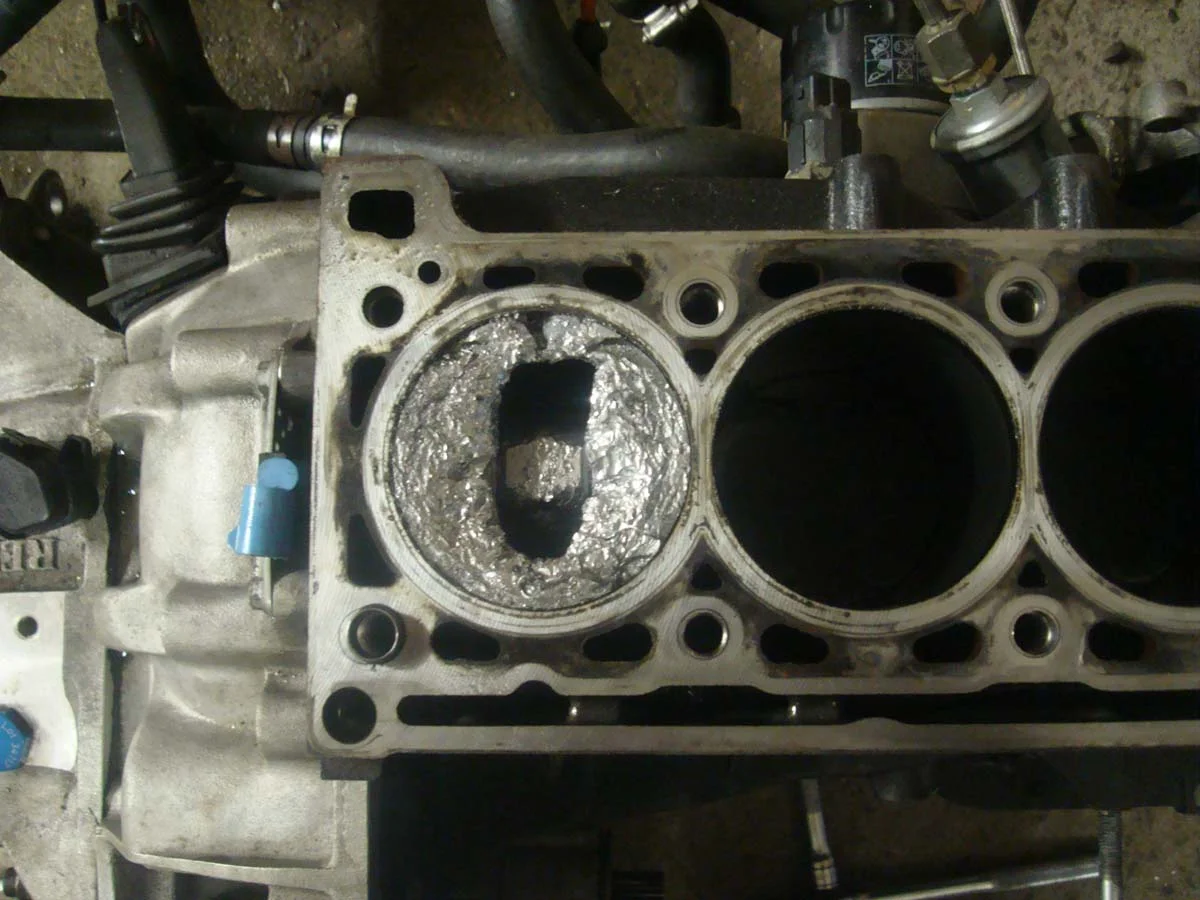

Mike, the F4R has a not overly common issue (thankfully) of dropping inlet valves. I've personally done a couple and the result is not nice and bits of valve do make it into the inlet.
I'll dig out some pictures for you of the last one when i get home.

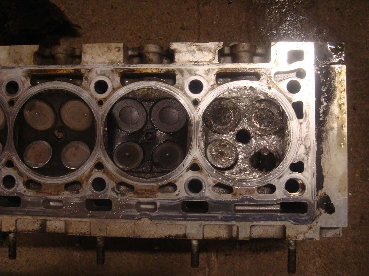

the valves are 2 pieces, friction welded together. It's not that uncommon, but it does seem to happen more to people who like to use (abuse) the rev limiter
this is one Steve at Birchdown sent me a while back
Ouch. Can guarantee that's what mine will look like. I'd just done a 100 mile trip coming back from Cornwall sitting at spot on 70 with cruise control on and it just died on me. Could it have been weakening over time and it eventually just gave up?

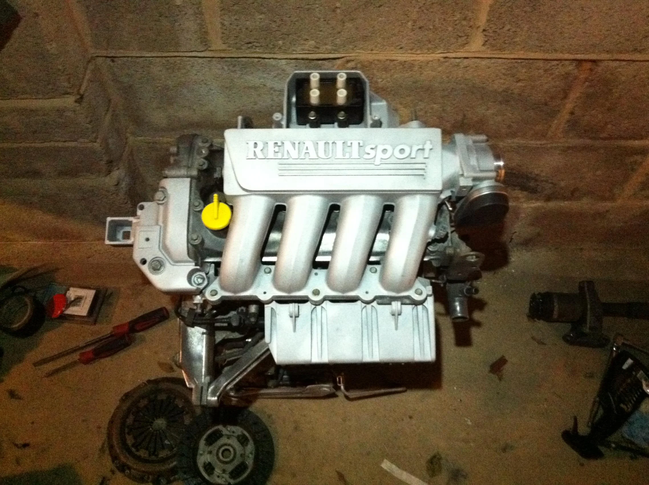

Update:

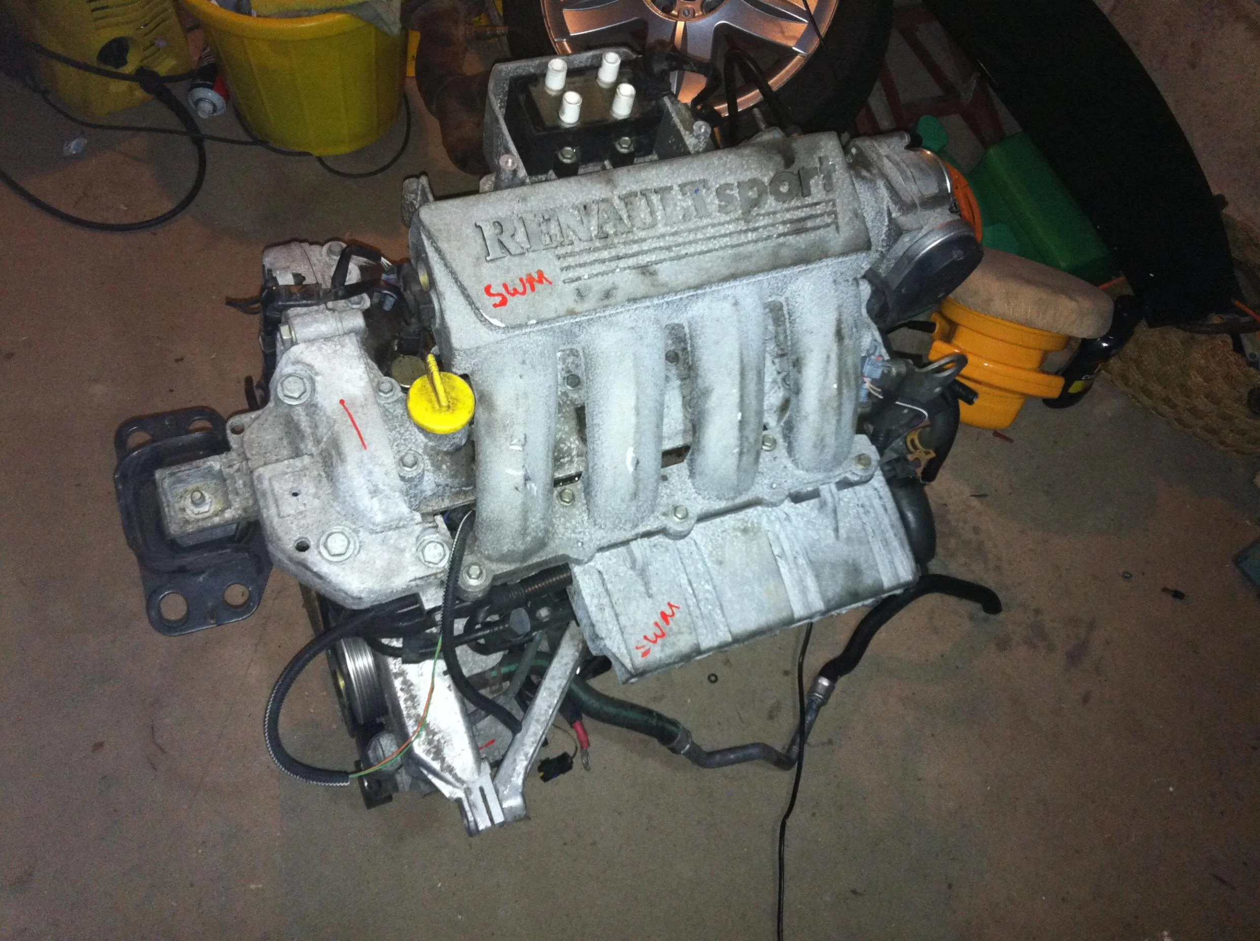

Got an engine from my old town of Bideford. £300 for the engine (without ancillaries) which also came with the 4-2-1 Manifold, which will be going on Ebay.
Also got a cup spoiler for a tenner! :)

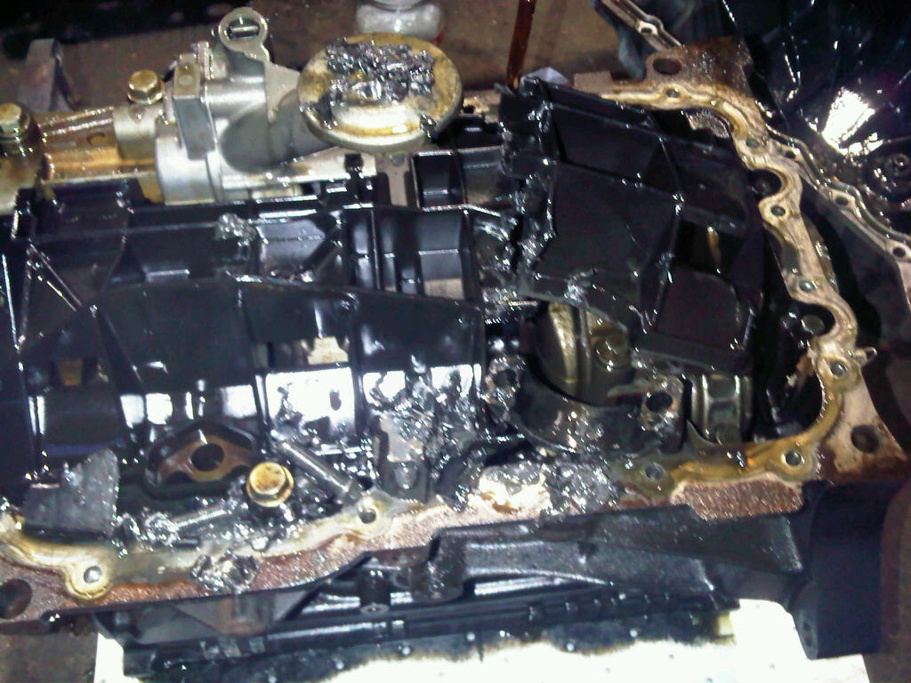

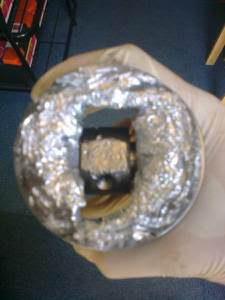

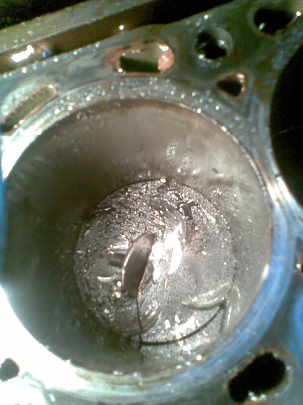

as said on other threads no noise when it went wrong just went off a cylinder, well as you can see by the pics it is well and truly of a cylinder
have heard quite a lot of people sayng to change the valves, if engine is getting revved
Ohw my the horror...

Found out that a BG 182 got handed in at my old local scrappy so got the engine out of it as it only had 51k miles, got the 4-2-1 Manifold with it too :)
Also while I was there I picked up a few things.. CUP spoiler (£10) , All dash trims (£5) , door bullets (£5) .. All to sell on at a profit of course.

Valeo Clutch is on it's way so that along with the box will be fitted when it arrives then a new set of belts + pulleys etc to follow.
I'm aiming for 2 weeks before its back on the road but with problems at home it may take a while longer, but I'l keep it updated on here.
