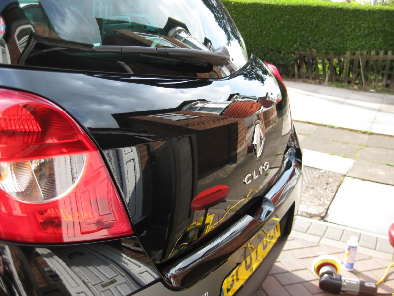

I began correcting my R27 today - the swirls on this thing are shocking!
I'm busy doing other cars too, so I've only managed my bootlid for now. I'm awaiting some Swissvax Best of Show to finish it off, so may hold off the rest of the correction until it's arrived.
Should look great when it's finished!
I used Menzerna 203S on a Menz Polishing Pad via PC.

Using the new Menzerna 203S with a Menz Polishing Pad on a Porter Cable 7424.
I then have a sample of the £200 CG Ezyme to top it for now...

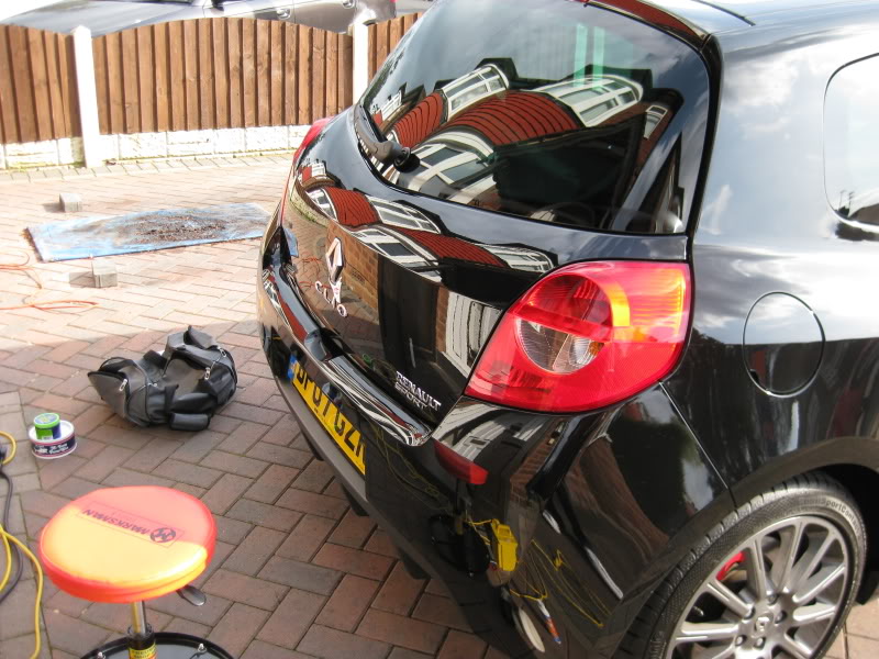

It's a hydraulic mechanic's creeper I'll have you know! :p

How long did you spend going over the boot lid with the pc? I have a kestrel and would love to know how to get results like that, I don't think I spend long enough on one area though!
  200 Gordini
1ft by 1ft square about 10mins
Start at a slow speed to spread, speed up, then slow down on the last 2/3 passes to refine the finish... read the guide on Detailing world which goes into a lot of depth :)

It's not Colli next to the car, it's Finish Kare 1000P, which I loaned to a neighbour to do his wheels :)
The boot took about 30 mins or so... it's all about the Menz pads tbh - love them. PO85RD would have brought out even more gloss!
