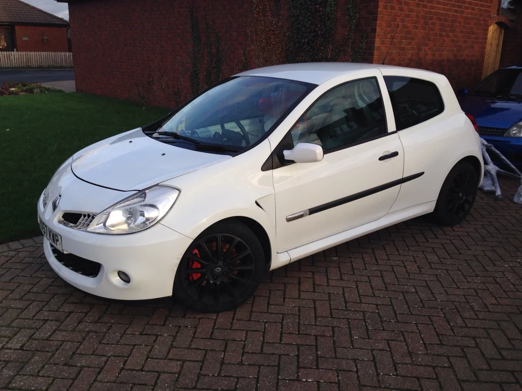

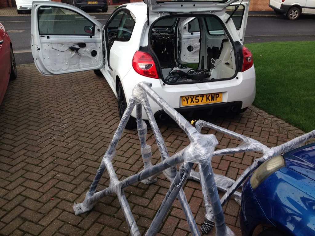

As promised just some pics and details on a 197 we're doing for a fellow Tricolore Racer for the coming season.
Original plan was to just finish off the build, some loom tidying, extinguisher install etc but the original builder has run out of time so I've got the full job to do.
As its class F, production class, it'll be similar to our own 172 cup in that modifications are limited and it'll be built as far as the regs will allow and also allow an easy upgrade to the higher classes.
-Full 14 point a Safety Devices bolt in cage as used in the Michelin cup road series.
-Upgraded pads, hoses and fluid, new springs, new oe shocks and poly bushes all around.
-safety stuff like battery, battery cut off and extinguisher system.

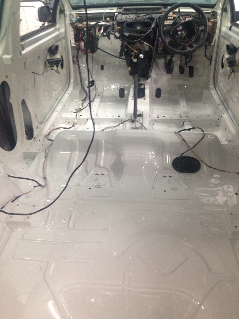

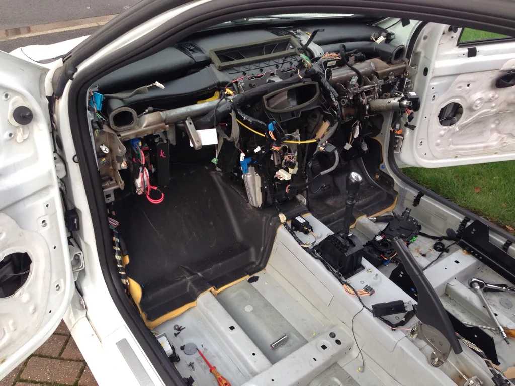

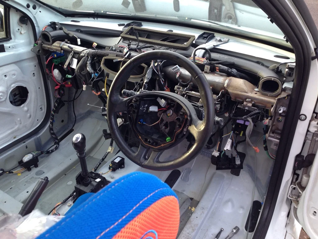

Managed to get the rest off the interior out today including roof lining and dash.
Also the sound deadening behind the dash which is a royal pita.

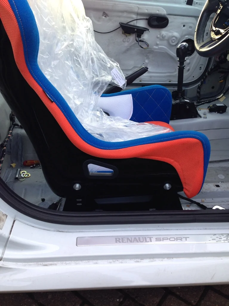

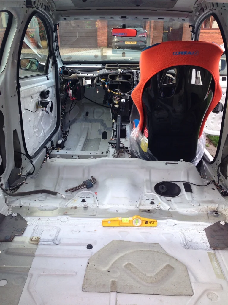

Got the seat mounted roughly. Just need to fabricate mounts to bring the rear seat rail up 15-20mm to level them out.

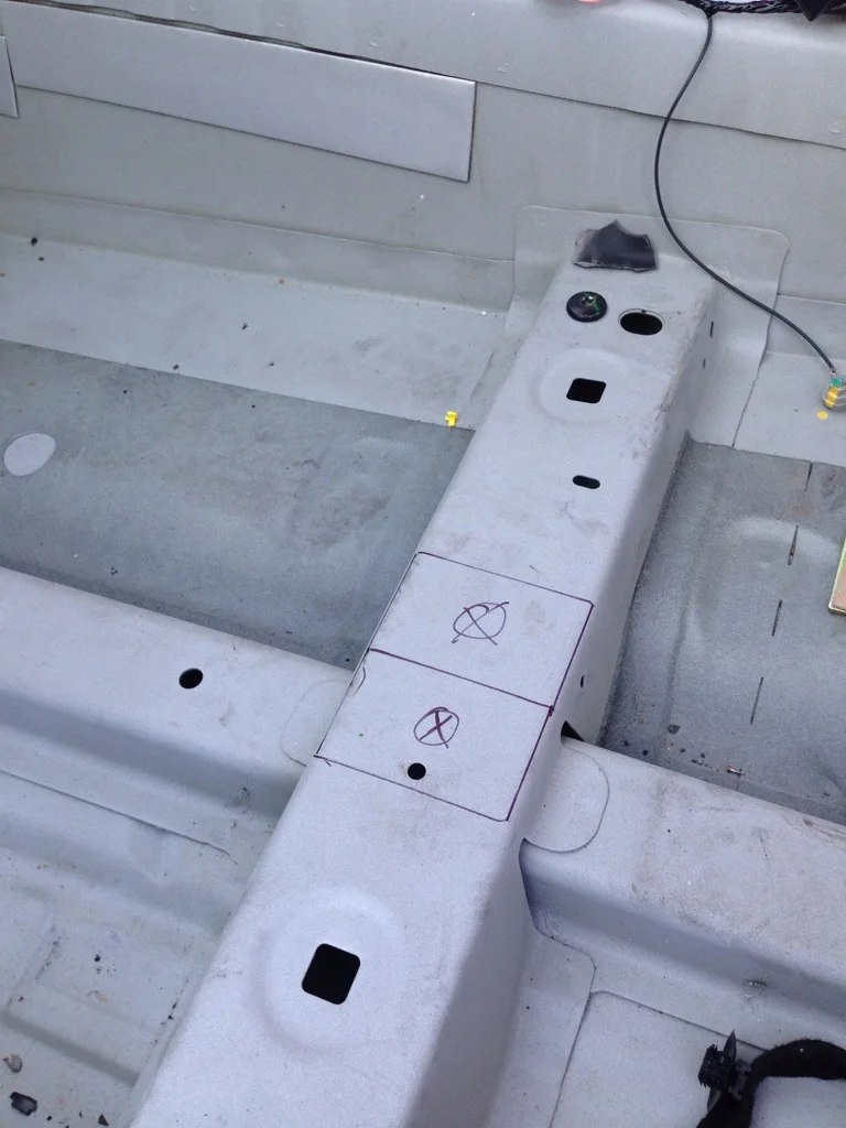

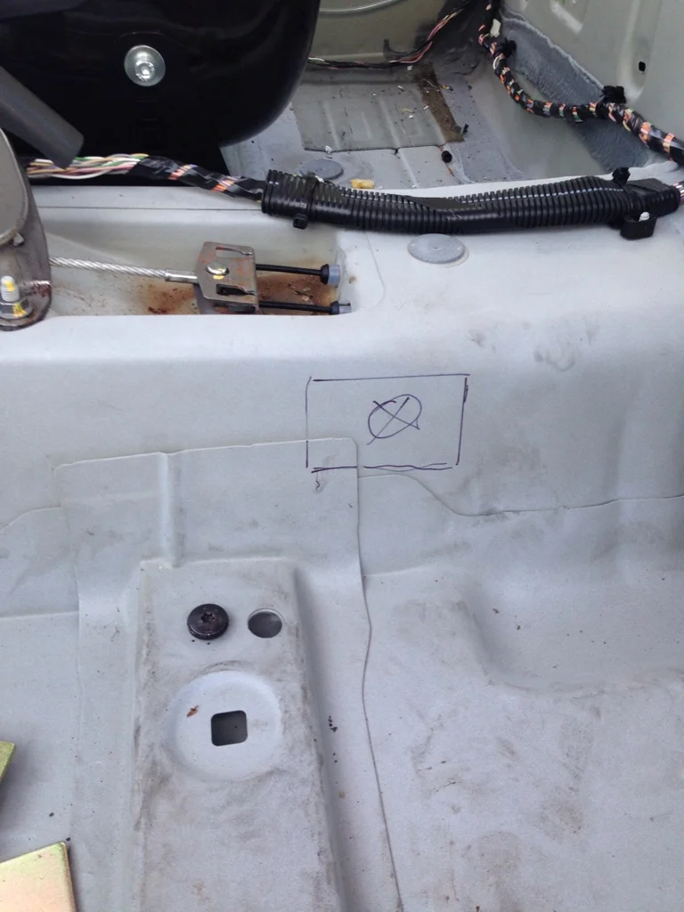

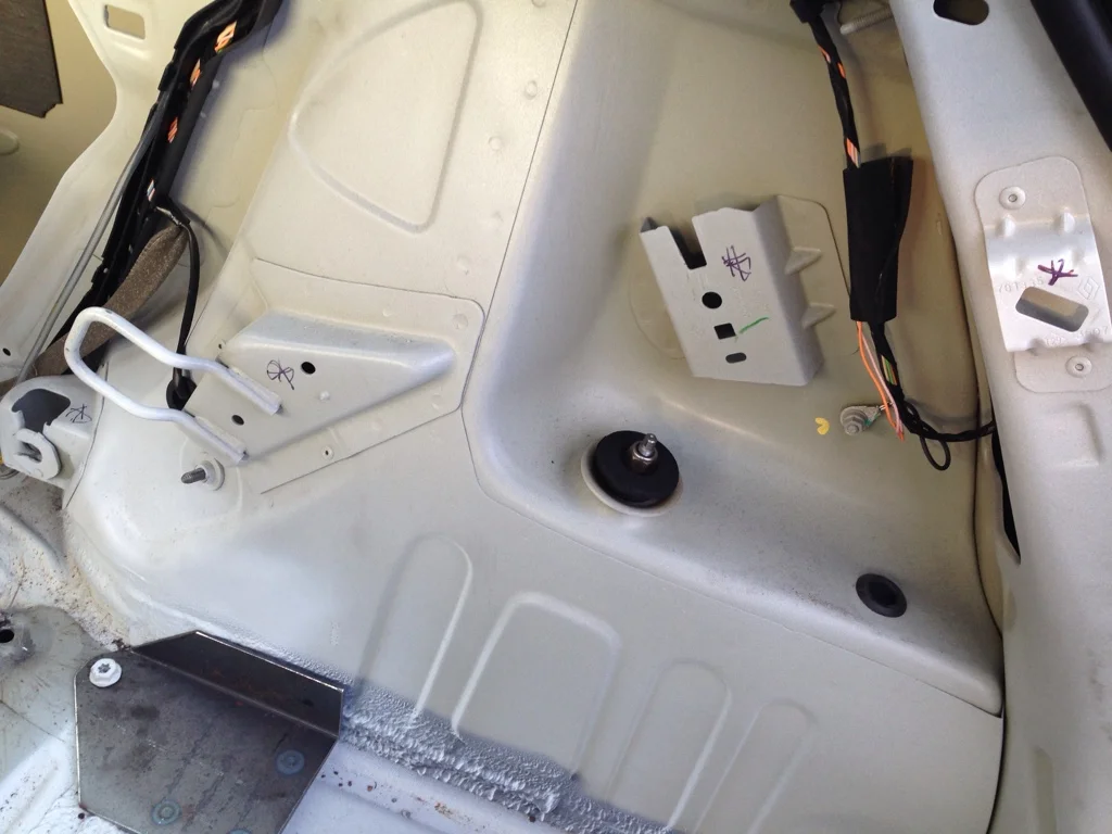

That's it up to date really, car is going to the fabricator this week to have the cage done, harness eyelets welded in and any bracketry removed. I've marked them up for him because I'm nice like that!
Have loads of new shiny bits ready to bolt on once the cage in done and it's painted so watch this space, more shell prep and cage pics towards the end of this week.

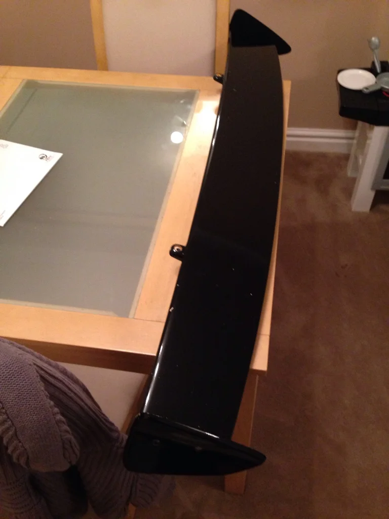

Forgot to mention, managed to get a genuine Cup Racer rear spoiler from a friend.
It just needs painted along with the wheels to match all The grilles/trims which are ready now.

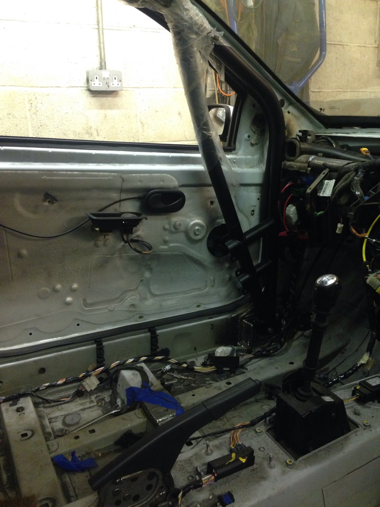

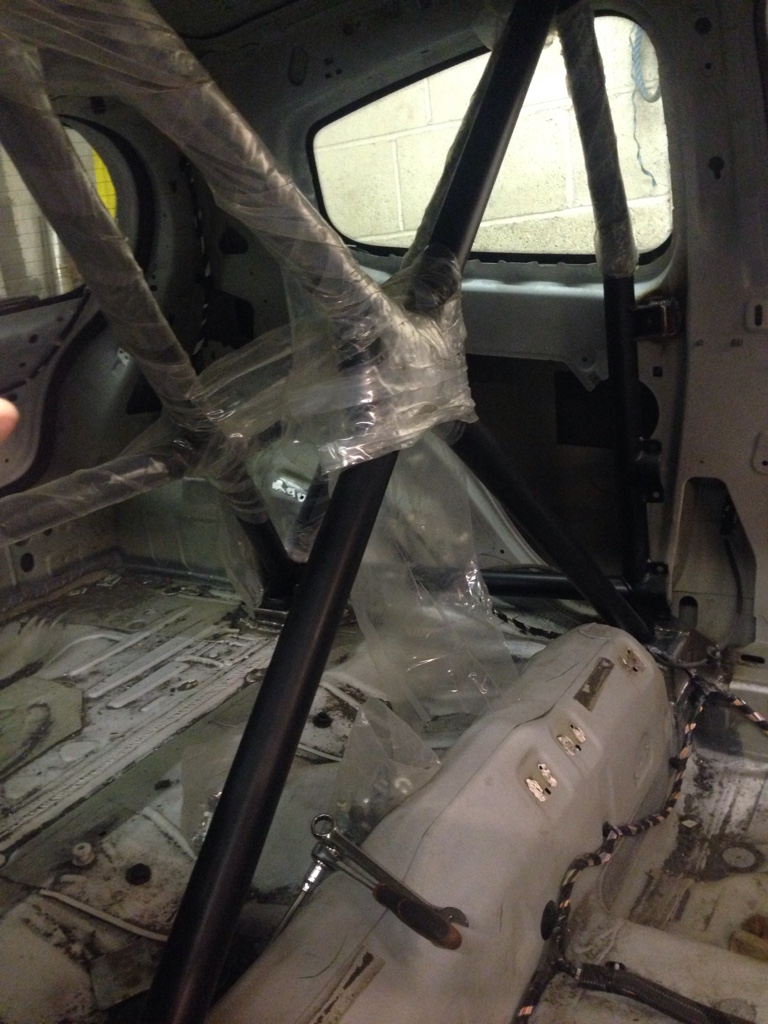

Russ Rallye

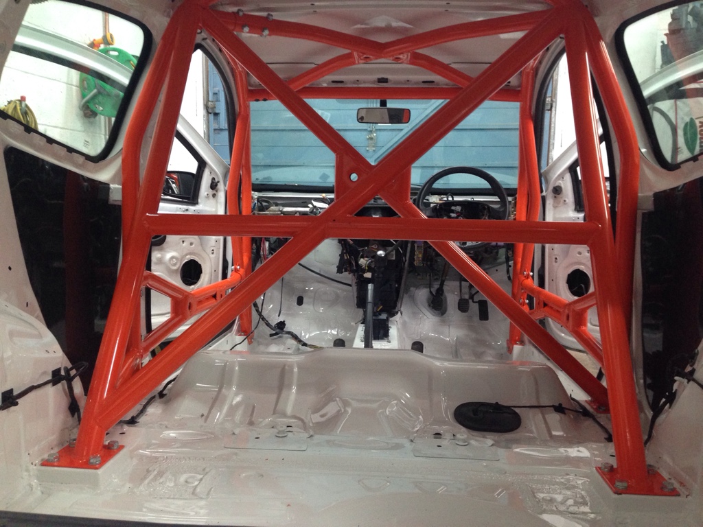

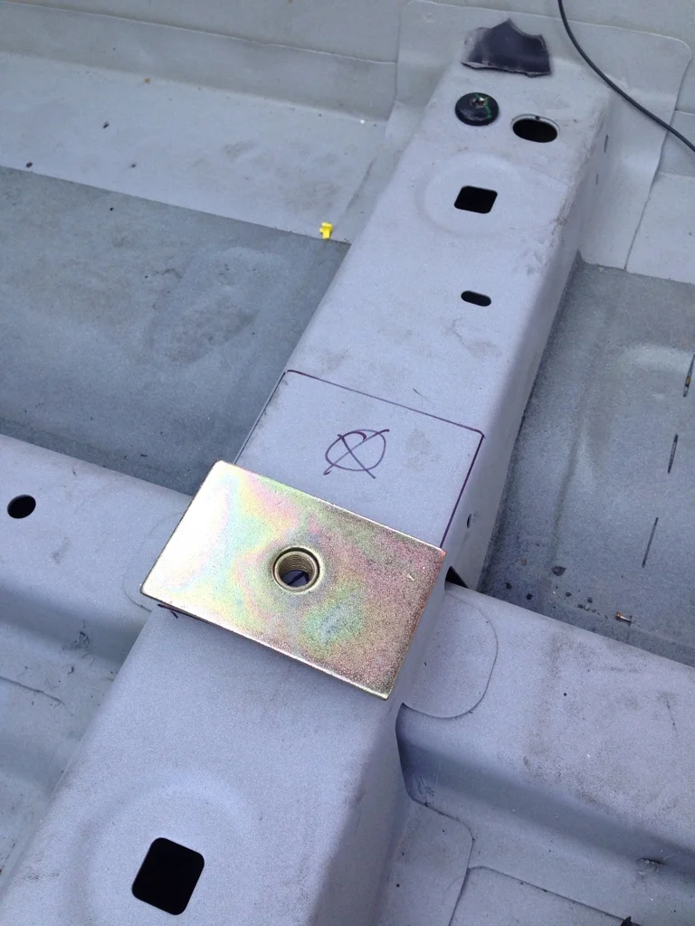

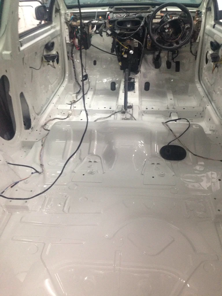

Pictures are horrendous but cage is done. Just have the seat mount alterations to do and it's finished. All the brackets are removed, dash frame modified and harness eyelet plates fitted.
Excuse the lack of door bars, pointless putting them back on as the whole thing is coming out to be powder coated anyway.

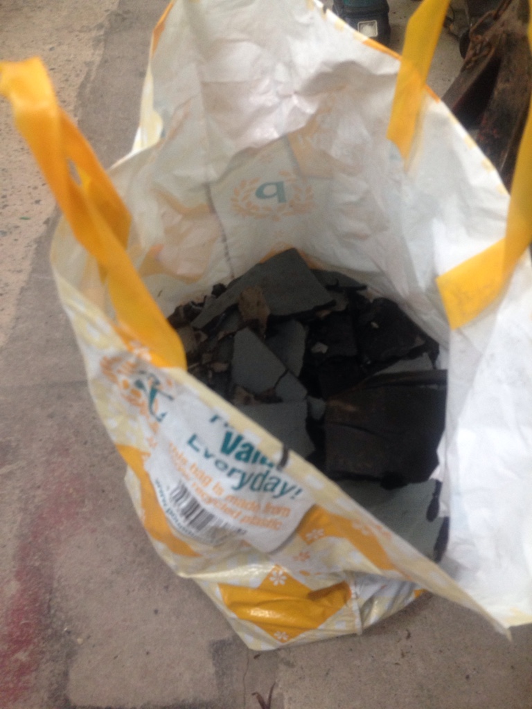

6th picture down, that magnetic yellow level is what i use in scaffolding. Im guessing someone helping you used to scaffold?
Jamie86
  RS175,595,205gti,172
Just a boat level most tradesman have them.. sparkies never use them mind ;)

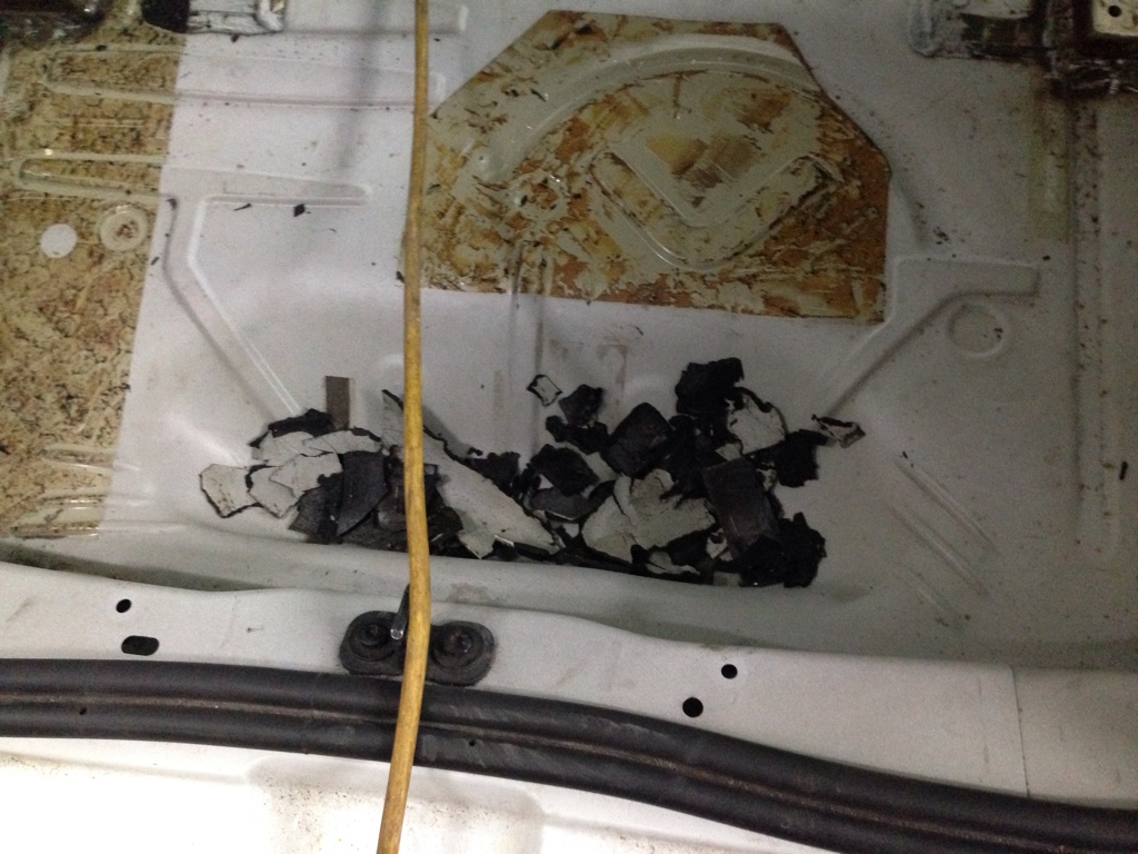

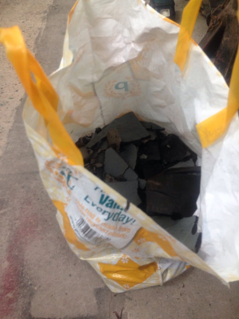

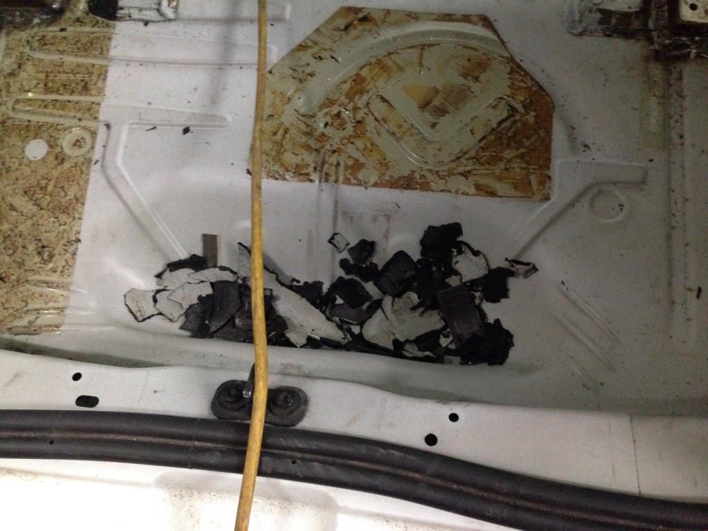

Been getting the interior ready for paint this weekend, removing all the sound deadening and giving it a general clean up. Still need to get the glue off.
Half Filled a carrier bag and I'd say there was at least 5kg in there.

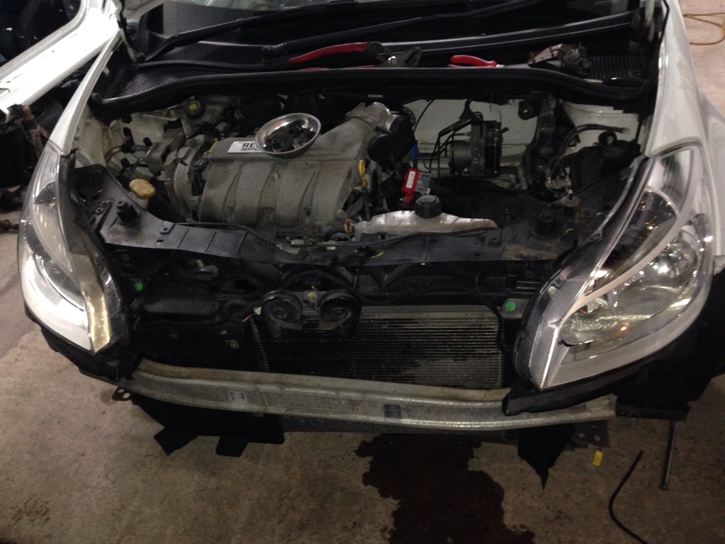

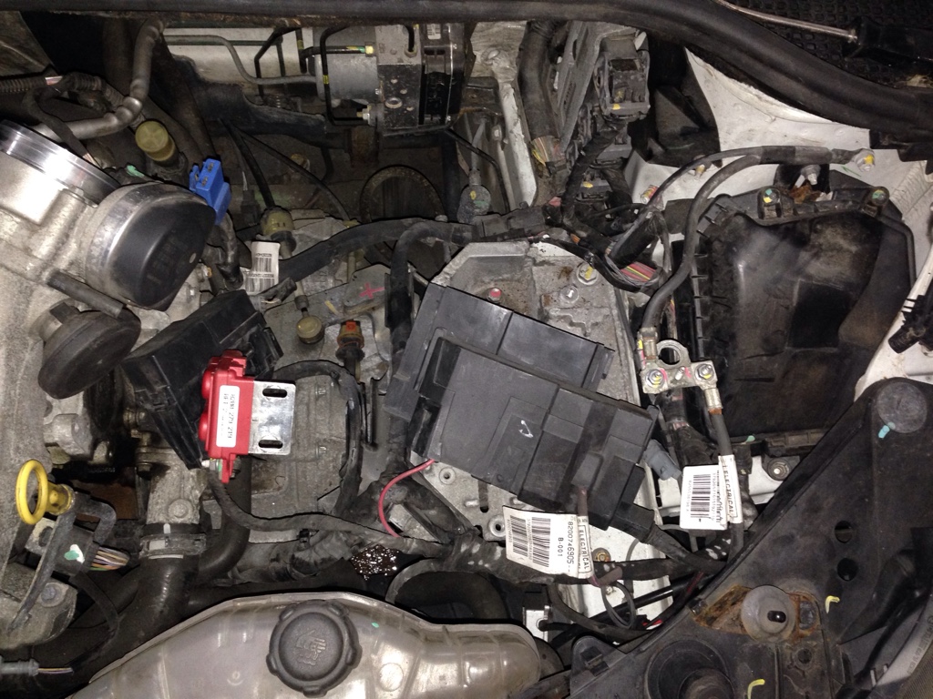

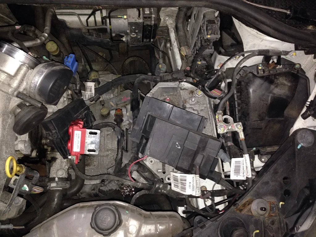

Had a root around under the bonnet and started removing the battery and box + air box and ridiculous amount of pipework, it all makes it so cluttered and hard to work on anything with that in place.
New battery and cut off are on order to replace the standard battery along with a basic induction hose and filter.

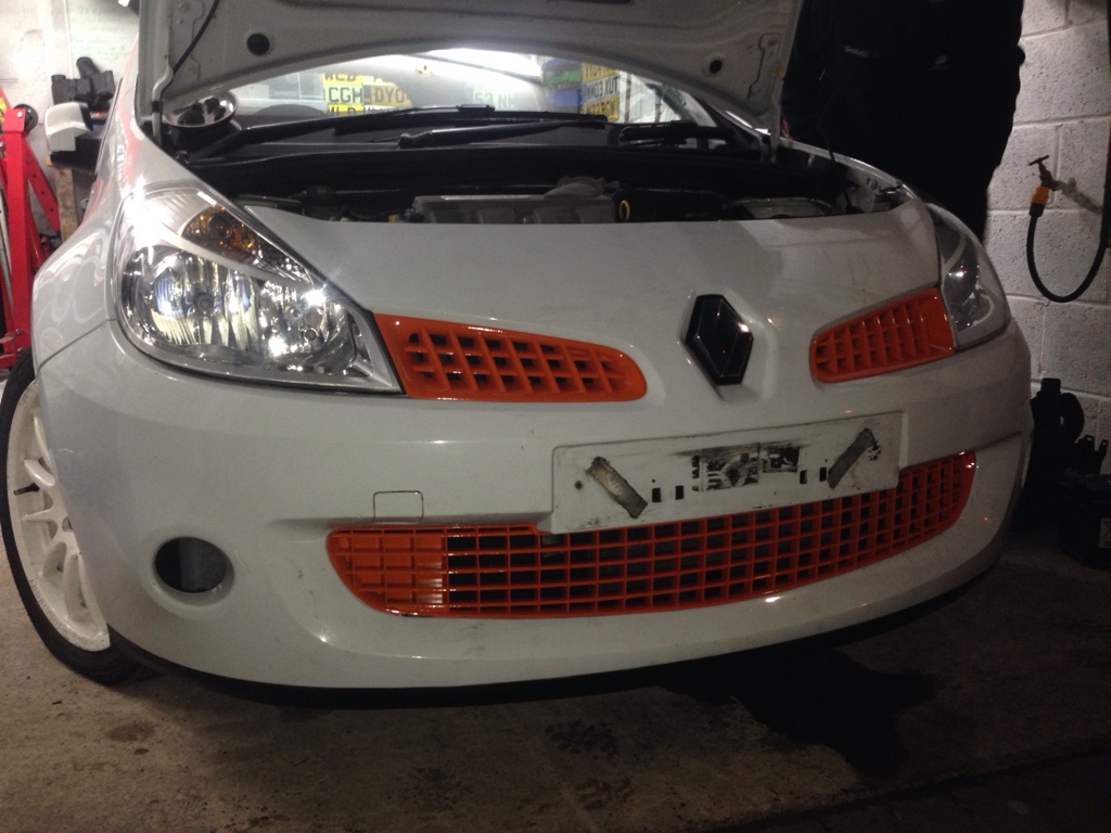

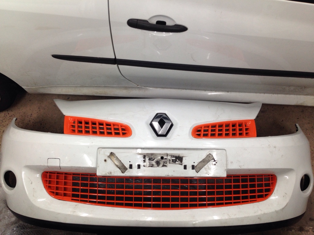

Had the front bumper off too.

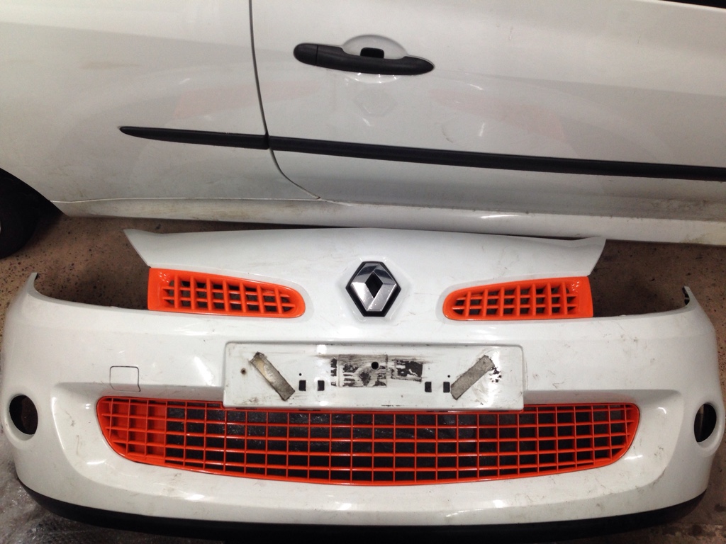

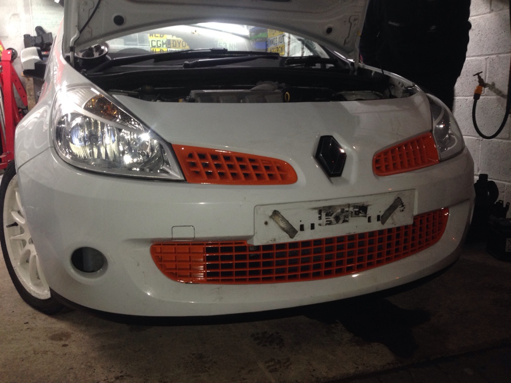

Stripped the fog lights and wiring out and fitted the grilles that have been painted. Probably gives you a clue as to what colour the cage and wheels are going to be!
Refitted it temporary just to see what it looked like!

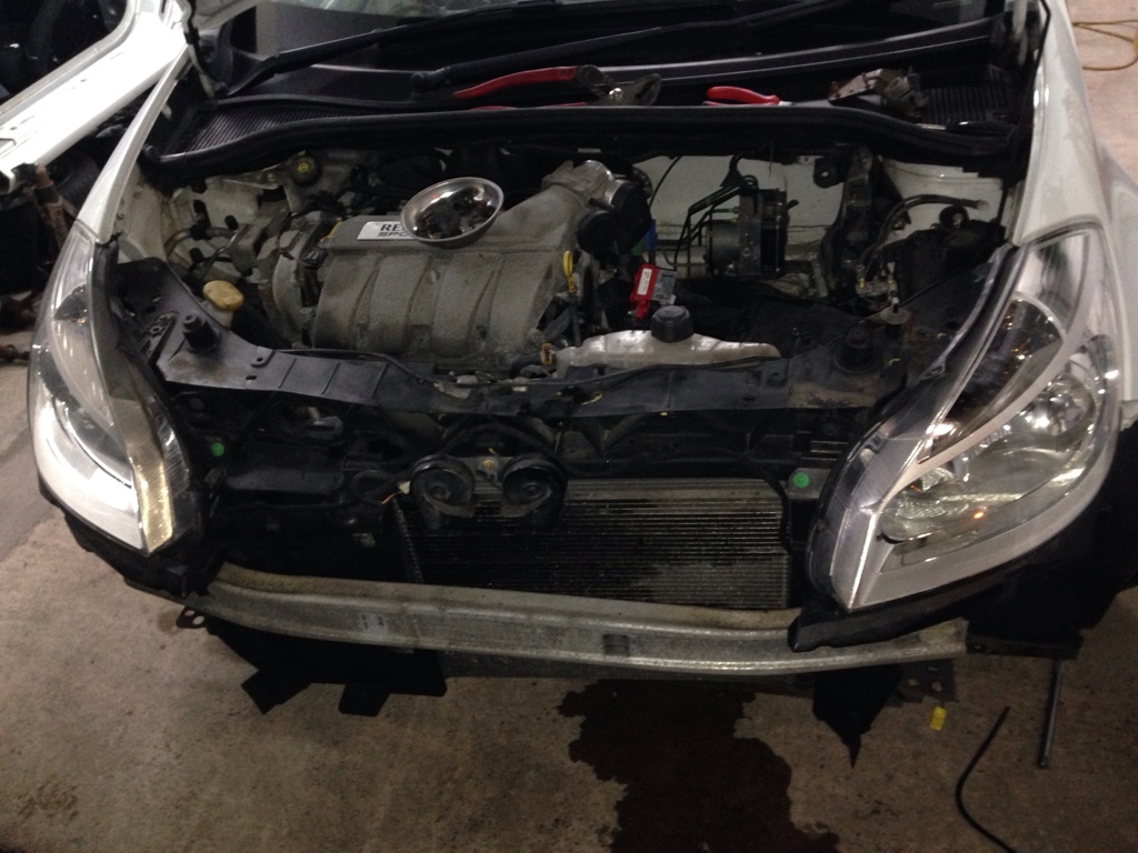

Bumper is back off so I can strip the bonnet release mech off and get some wires down for the transponder in the wheel arch.

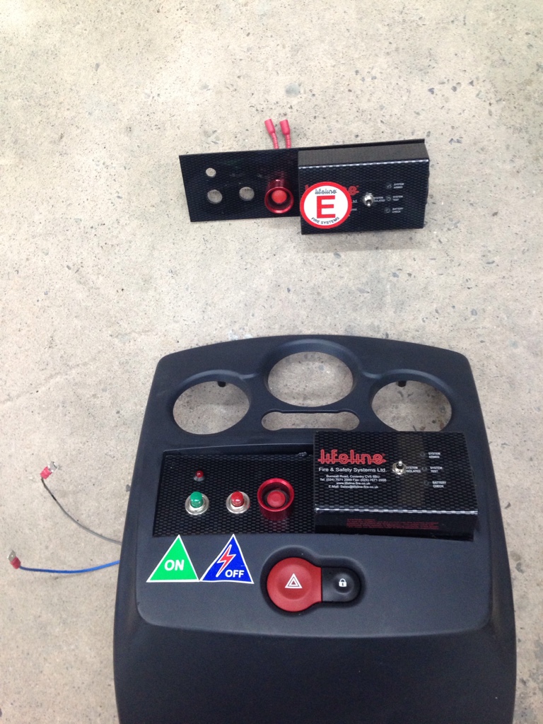

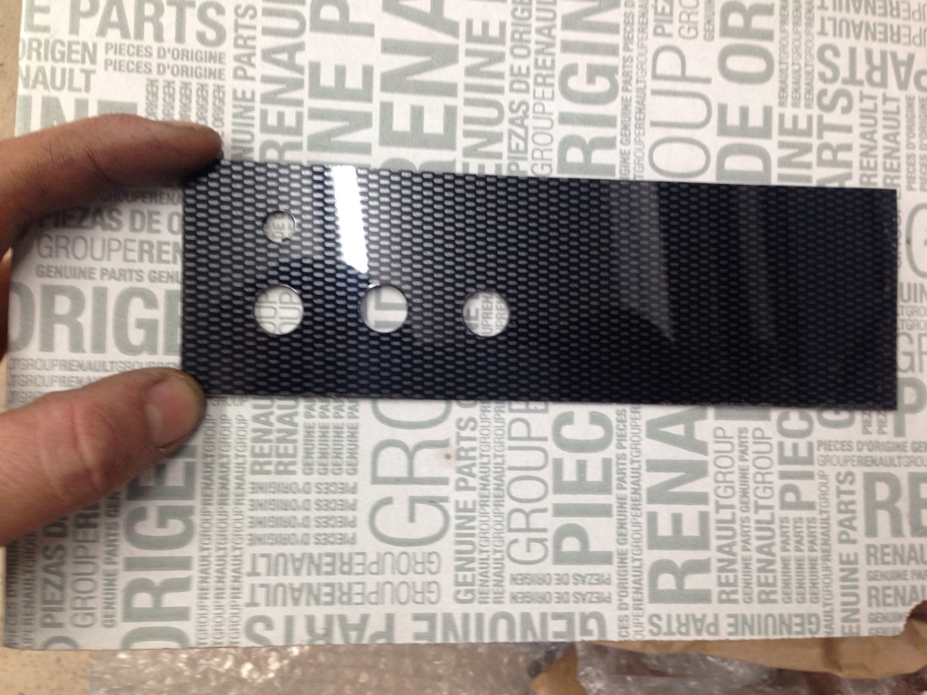

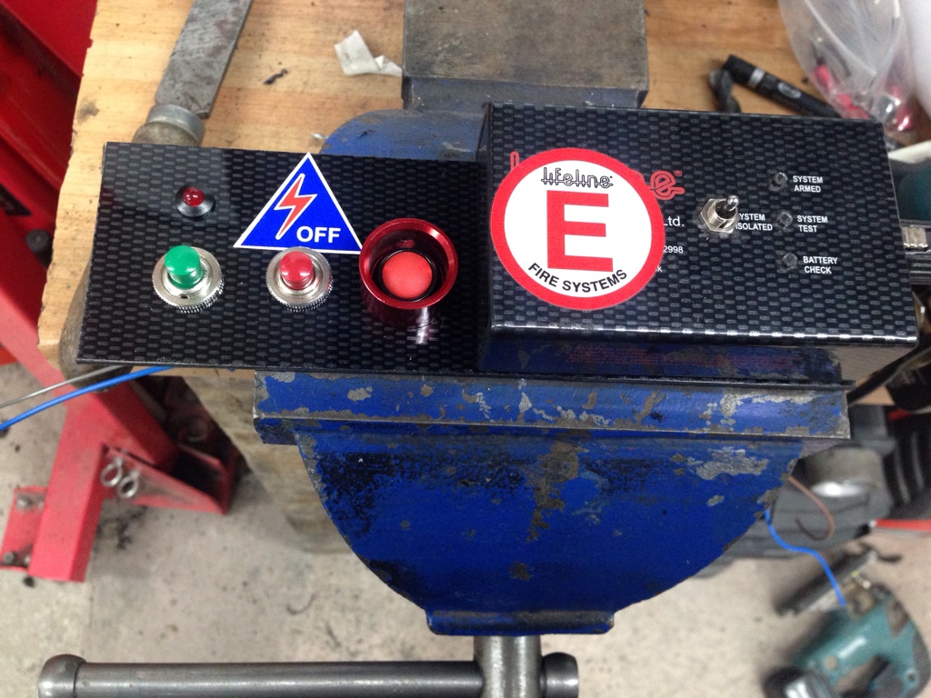

In the meantime made a blanking panel for the radio hole in the dash.
Will house the electrical extinguisher box and internal button + the battery isolator controls. (This pic is actually of mine for the 172 as I made them both today)
And fitted into the 197 facia, job done.
Russ

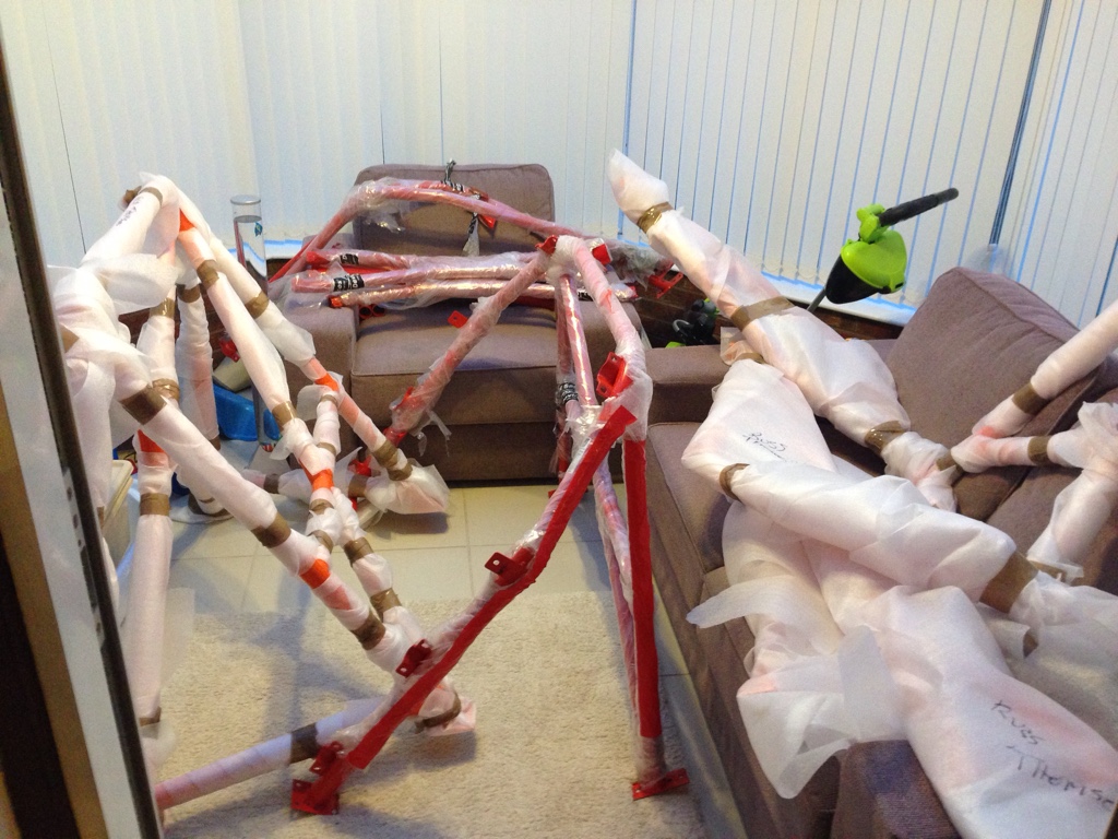

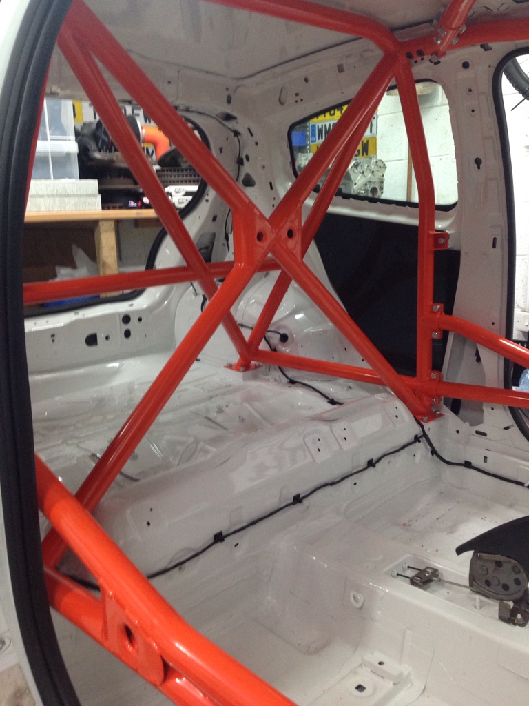

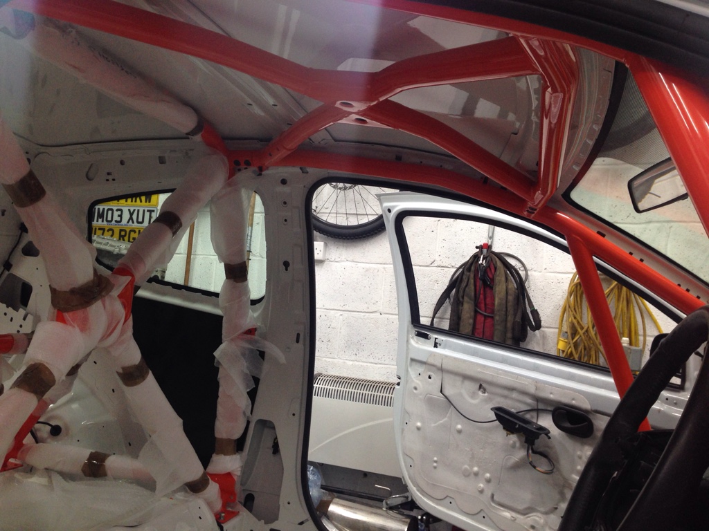

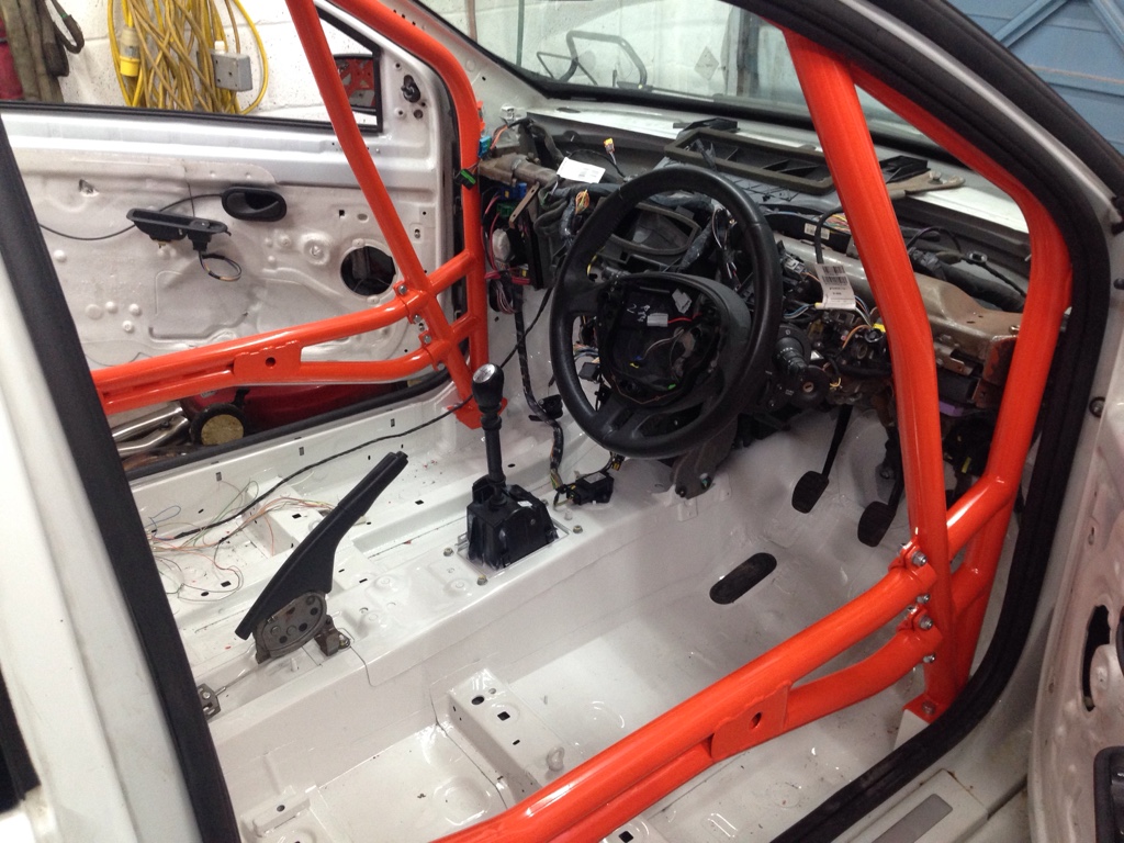

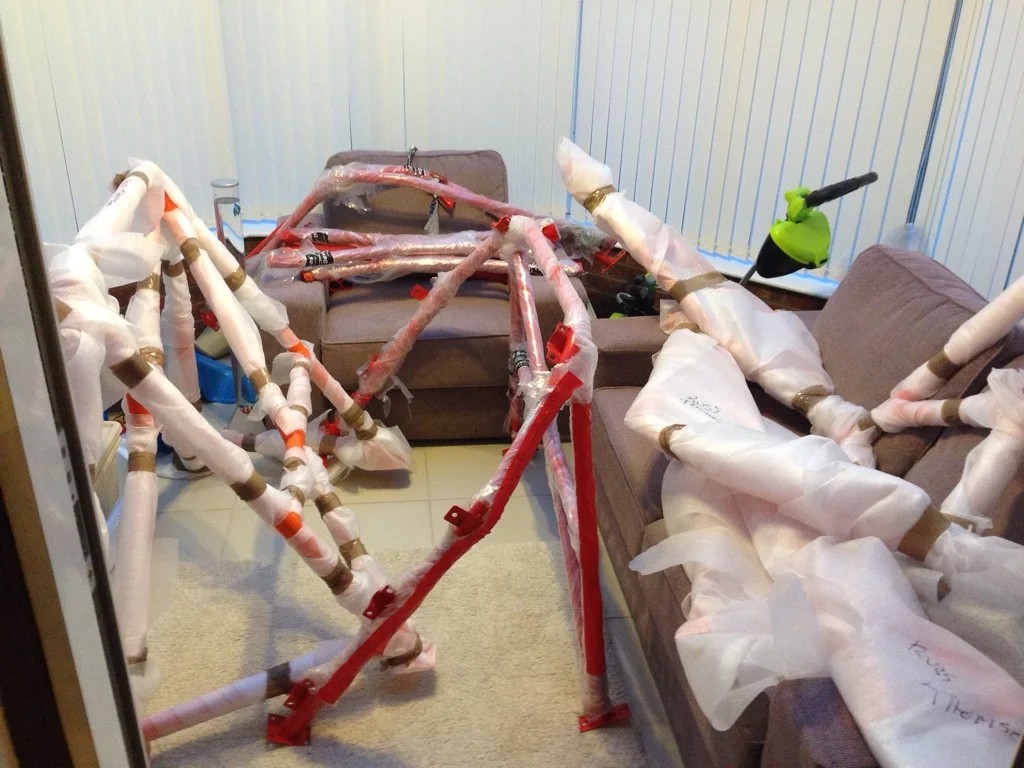

Got the car back from being painted and got the cage back at the same time from being powder coated.
Conservatory starting to look like Safety Devices warehouse with x2 full cages in there.

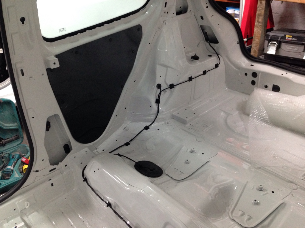

Got the rear door cards trimmed round the cage brackets and riveted them in. Got the rear loom tidied up too.
Cage part fitted.
And all in, fitted, unwrapped and all 54 bolts torqued up!
Hopefully get the dash, seats and belts etc in tomorrow.

Wow that some weight but absolutely no flex which is good hey.
